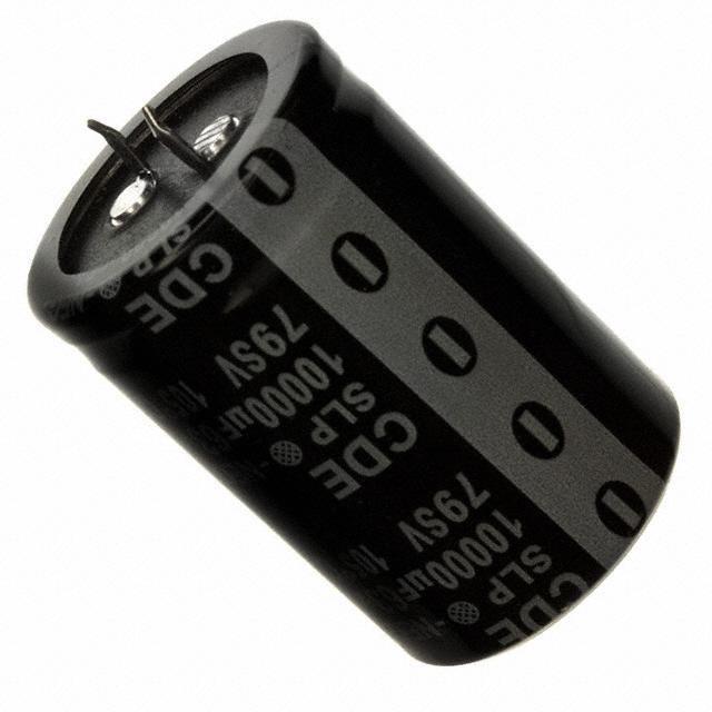

Type SLP 105 °C Snap-In Aluminum Electrolytic
Best Value 105 °C Snap-In Type
Type SLP is the best value package snap-in series for 105 ºC, 3000 h operation. This series is the most cost-effective choice for DC filtering and power supply applications where high temperature, long life and high ripple capability are needed.
Highlights
- 3000 h ripple load life at rated voltage - 105 ºC rated - Small case size with high capacitance - Best for switching power supplies - 22 mm to 35 mm diameter, 10 mm lead spacing - Best value snap-in type - High ripple current
–40 ºC to +105 ºC ≤ 100 Vdc –25 ºC to +105 ºC ≥ 160 Vdc 10 Vdc to 450 Vdc 47 µF to 56,000 µF ±20% ≤ 3 √CV µA at 5 minutes Ambient Temperature 20 ºC - 45 ºC 2.00 Frequency Voltage 10 - 100 Vdc 160 - 450 Vdc Low Temperature Characteristics 60 Hz 120 Hz 1 kHz 0.90 0.80 1.00 1.00 1.15 1.25 10 kHz & Up 1.25 1.47 65 ºC 1.89 85 ºC 1.52 105 ºC 1.00
Specifications
Temperature Range Rated Voltage Range Capacitance Range Capacitance Tolerance Leakage Current Ripple Current Multipliers
To apply multipliers, see ratings tables for ripple current values Impedance ratio: Z–20⁰C ∕ Z+25⁰C ≤ 10 (10 Vdc) ≤ 8 (16–50 Vdc) ≤ 4 (63–100 Vdc) ≤ 3 (150–450 Vdc) 3,000 h @ full load @ 105 ºC Δ Capacitance ±20% ESR ≤200% of limit DCL 100 % of limit 1,000 h @ full load @ 105 ºC Δ Capacitance ±20% ESR ≤150% of limit DCL 100 % of limit 10 Hz to 55 Hz , 0.06” and 10g max 2 h for each plane RoHS Compliant
