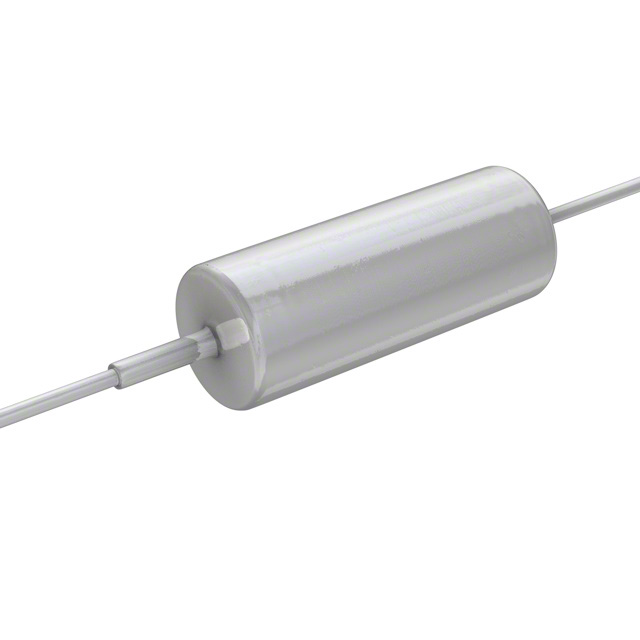

Type TAS Solid Tantalum Capacitors Hermetically Sealed Axial Lead Solid Tantalum Capacitors The Type TAS solid tantalum axial lead capacitor is constructed with a rugged hermetically sealed metal case with an outer polyester insulator wrap and is ideal for use in the harsh environments of military and industrial applications. The TAS assures a small case size for high capacitance, and is frequency and temperature stable. Highlights ♦ ♦ ♦ ♦ ♦ ♦ ♦ ♦ Hermetically Sealed High Capacitance Low DC Leakage Low Dissipation Factor Temperature and Frequency Stable Moisture & Solvent Resistant Miniature Size Long Shelf Life Specifications Capacitance Range 0.0047 µF to 330 µF Capacitance Tolerance ±10%, ±20% Rated Voltage 6 WVdc to 100 WVdc Operating Temperature Range –55 ºC to +125 ºC (with proper derating) Reverse Voltage 15% of rated voltage @ 25 ºC 5% of rated voltage @ 85 ºC 1% of rated voltage @ 125 ºC DC Leakage At +25 ºC - (See Ratings) At +85 ºC - 10 x Ratings limit At +125 ºC - 12.5 x Ratings limit Capacitance Change Maximum –10% @ –55 ºC +10% @ +85 ºC +12% @ +125 ºC Maximum Power Dissipation @ 25 ºC Case Code Watts A 0.090 C 0.100 F 0.125 G 0.180 7&8 500 per 12" Reel RoHS Compliant CDE Cornell Dubilier • 1605 E. Rodney French Blvd. • New Bedford, MA 02744 • Phone: (508)996-8561 • Fax: (508)996-3830 • www.cde.com Type TAS Solid Tantalum Capacitors Outline Drawing Dimensions - Inches (Millimeters) Uninsulated Insulated in. (mm) D L D L Case ±.005 ±.031 ±.010 ±.031 C ±.001 d Quantity Per Code (±.13) (±.79) (±.25) (±.79) Maximum (±.03) Reel A .125(3.18) .250(6.35) .135(3.43) .286(7.26) .422 (10.72) .020(51) 3,500 C .175(4.45) .438(11.13) .185(4.70) .474(12.04) .610(15.49) .020(.51) 2,500 F .279(7.09) .650(16.51) .289(7.34) .686(17.42) .822(20.88) .025(.64) 500 G .341(8.66) .750(19.05) .351(8.92) .786(19.96) .922(23.42) .025(.64) 400 Part Numbering System TAS 474 Series Capacitance TAS M 035 Tolerance Voltage P 1 A -F Polar Mylar Sleeve Case Code RoHS Compliant P = Polar 1 A 472 = 0.0047 µF J = ±5% 006 = 6 Vdc 474 = 0.47 µF K = ±10% 035 = 35 Vdc C 105 = 1.0 µF M = ±20% 100 = 100 Vdc F 225 = 2.2 µF Ratings G 106 = 10.0 µF Cap (µF) Case Code 2.2 2.7 3.3 3.9 4.7 5.6 6.8 8.2 10 12 15 18 22 27 33 39 47 56 68 100 120 150 180 220 270 330 A A A A A A A C C C C C C C C C C C F F F F F G G G Max DF Max DCL @ +25 ºC @ +25 ºC 120 Hz (µA) (%) 6 WVdc @ 85 ºC 4 WVdc @ 125 ºC 0.3 4 0.3 4 0.3 4 0.3 4 0.3 4 0.3 4 0.3 6 0.3 6 0.3 6 0.5 6 0.9 6 0.9 6 0.9 6 0.9 6 0.9 6 0.9 6 1.5 6 1.5 6 3.0 6 3.0 6 3.0 6 4.5 6 5.5 6 6.0 8 6.0 8 7.5 8 Catalog Part Number Cap (µF) Case Code TAS225K006P1A-F TAS275K006P1A-F TAS335K006P1A-F TAS395K006P1A-F TAS475K006P1A-F TAS565K006P1A-F TAS685K006P1A-F TAS825K006P1C-F TAS106K006P1C-F TAS126K006P1C-F TAS156K006P1C-F TAS186K006P1C-F TAS226K006P1C-F TAS276K006P1C-F TAS336K006P1C-F TAS396K006P1C-F TAS476K006P1C-F TAS566K006P1C-F TAS686K006P1F-F TAS107K006P1F-F TAS127K006P1F-F TAS157K006P1F-F TAS187K006P1F-F TAS227K006P1G-F TAS277K006P1G-F TAS337K006P1G-F 1.0 1.2 1.5 1.8 2.2 2.7 3.3 3.9 4.7 5.6 6.8 8.2 10 12 15 18 22 27 33 39 47 56 68 100 120 150 180 220 A A A A A A A A A C C C C C C C C C C C F F F F F G G G Max DF Max DCL @ +25 ºC @ +25 ºC 120 Hz (µA) (%) 10 WVdc @ 85 ºC 7 WVdc @ 125 ºC 0.3 3 0.3 4 0.3 4 0.3 4 0.3 4 0.3 4 0.3 4 0.3 4 0.4 4 0.4 4 1.0 6 1.0 6 1.0 6 1.0 6 1.0 6 1.0 6 2.0 6 2.0 6 2.0 6 2.0 6 3.0 6 3.0 6 3.0 6 5.0 6 5.0 6 9.0 6 9.0 6 10.0 8 Catalog Part Number TAS105K010P1A-F TAS125K010P1A-F TAS155K010P1A-F TAS185K010P1A-F TAS225K010P1A-F TAS275K010P1A-F TAS335K010P1A-F TAS395K010P1A-F TAS475K010P1A-F TAS565K010P1C-F TAS685K010P1C-F TAS825K010P1C-F TAS106K010P1C-F TAS126K010P1C-F TAS156K010P1C-F TAS186K010P1C-F TAS226K010P1C-F TAS276K010P1C-F TAS336K010P1C-F TAS396K010P1C-F TAS476K010P1F-F TAS566K010P1F-F TAS686K010P1F-F TAS107K010P1F-F TAS127K010P1F-F TAS157K010P1G-F TAS187K010P1G-F TAS227K010P1G-F CDE Cornell Dubilier • 1605 E. Rodney French Blvd. • New Bedford, MA 02744 • Phone: (508)996-8561 • Fax: (508)996-3830 • www.cde.com Type TAS Solid Tantalum Capacitors Cap (µF) Case Code 0.39 0.47 0.56 0.68 0.82 1.0 1.2 1.5 1.8 2.2 2.7 3.3 3.9 4.7 5.6 6.8 8.2 10 12 15 18 22 27 33 39 47 56 68 82 100 120 150 A A A A A A A A A A A A C C C C C C C C C C F F F F F F G G G G 0.047 0.056 0.068 0.082 0.10 0.12 0.15 0.18 0.22 0.27 A A A A A A A A A A Max DF Max DCL @ +25 ºC @ +25 ºC 120 Hz (µA) (%) 15 WVdc @ 85 ºC 10 WVdc @ 125 ºC 0.3 3 0.3 3 0.3 3 0.3 3 0.3 3 0.3 3 0.3 4 0.3 4 0.3 4 0.3 4 0.3 4 0.4 4 0.4 4 0.7 4 0.7 4 0.7 6 0.7 6 1 6 1 6 2 6 2 6 2 6 3 6 3 6 3 6 4 6 4 6 5 6 6 6 6 6 6 6 8 6 20 WVdc @ 85 ºC 13 WVdc @ 125 ºC 0.1 3 0.1 3 0.1 3 0.1 3 0.3 3 0.3 3 0.3 3 0.3 3 0.3 3 0.3 3 Catalog Part Number Cap (µF) Case Code TAS394K015P1A-F TAS474K015P1A-F TAS564K015P1A-F TAS684K015P1A-F TAS824K015P1A-F TAS105K015P1A-F TAS125K015P1A-F TAS155K015P1A-F TAS185K015P1A-F TAS225K015P1A-F TAS275K015P1A-F TAS335K015P1A-F TAS395K015P1C-F TAS475K015P1C-F TAS565K015P1C-F TAS685K015P1C-F TAS825K015P1C-F TAS106K015P1C-F TAS126K015P1C-F TAS156K015P1C-F TAS186K015P1C-F TAS226K015P1C-F TAS276K015P1F-F TAS336K015P1F-F TAS396K015P1F-F TAS476K015P1F-F TAS566K015P1F-F TAS686K015P1F-F TAS826K015P1G-F TAS107K015P1G-F TAS127K015P1G-F TAS157K015P1G-F 0.39 0.47 0.56 0.68 0.82 1.0 1.2 1.5 1.8 2.2 2.7 3.3 3.9 4.7 5.6 6.8 8.2 10 12 15 18 22 27 33 39 47 56 68 82 100 A A A A A A A A A A C C C C C C C C C C F F F F F F G G G G 0.0047 0.0056 0.0068 0.0082 0.01 0.012 0.015 0.018 0.022 0.027 A A A A A A A A A A TAS473K020P1A-F TAS563K020P1A-F TAS683K020P1A-F TAS823K020P1A-F TAS104K020P1A-F TAS124K020P1A-F TAS154K020P1A-F TAS184K020P1A-F TAS224K020P1A-F TAS274K020P1A-F Max DF Max DCL @ +25 ºC @ +25 ºC 120 Hz (µA) (%) 20 WVdc @ 85 ºC 13 WVdc @ 125 ºC 0.3 3 0.3 3 0.3 3 0.3 3 0.3 3 0.3 3 0.3 4 0.3 4 0.3 4 0.4 4 0.5 4 1.0 4 1.0 4 1.0 4 1.0 4 1.0 6 1.0 6 1.0 6 1.0 6 2.0 6 2.0 6 2.5 6 2.5 6 3.0 6 3.0 6 4.5 6 5.5 6 6.0 6 6.0 6 10.0 6 35 WVdc @ 85 ºC 23 WVdc @ 125 ºC 0.1 3 0.1 3 0.1 3 0.1 3 0.1 3 0.1 3 0.1 3 0.1 3 0.1 3 0.1 3 Catalog Part Number TAS394K020P1A-F TAS474K020P1A-F TAS564K020P1A-F TAS684K020P1A-F TAS824K020P1A-F TAS105K020P1A-F TAS125K020P1A-F TAS155K020P1A-F TAS185K020P1A-F TAS225K020P1A-F TAS275K020P1C-F TAS335K020P1C-F TAS395K020P1C-F TAS475K020P1C-F TAS565K020P1C-F TAS685K020P1C-F TAS825K020P1C-F TAS106K020P1C-F TAS126K020P1C-F TAS156K020P1C-F TAS186K020P1F-F TAS226K020P1F-F TAS276K020P1F-F TAS336K020P1F-F TAS396K020P1F-F TAS476K020P1F-F TAS566K020P1G-F TAS686K020P1G-F TAS826K020P1G-F TAS107K020P1G-F TAS472K035P1A-F TAS562K035P1A-F TAS682K035P1A-F TAS822K035P1A-F TAS103K035P1A-F TAS123K035P1A-F TAS153K035P1A-F TAS183K035P1A-F TAS223K035P1A-F TAS273K035P1A-F CDE Cornell Dubilier • 1605 E. Rodney French Blvd. • New Bedford, MA 02744 • Phone: (508)996-8561 • Fax: (508)996-3830 • www.cde.com Type TAS Solid Tantalum Capacitors Cap (µF) Case Code 0.033 0.039 0.047 0.056 0.068 0.082 0.10 0.12 0.15 0.18 0.22 0.27 0.39 0.47 0.56 0.68 0.82 1.0 1.2 1.5 1.8 2.2 2.7 3.3 3.9 4.7 5.6 6.8 8.2 10 12 15 18 22 27 33 39 47 A A A A A A A A A A A A A A A A A A C C C C C C C C C C F F F F F F G G G G 0.0047 0.0056 0.0068 0.0082 0.01 A A A A A Max DF Max DCL @ +25 ºC @ +25 ºC 120 Hz (µA) (%) 35 WVdc @ 85 ºC 23 WVdc @ 125 ºC 0.1 3 0.1 3 0.1 3 0.1 3 0.1 3 0.1 3 0.5 3 0.5 3 0.5 3 0.5 3 0.5 3 0.5 3 0.5 3 0.5 3 0.5 3 0.5 3 0.5 3 0.5 3 0.5 4 0.5 4 0.5 4 1.0 4 1.0 4 1.0 4 1.0 4 1.0 4 1.0 4 1.5 4 3.0 4 3.0 4 3.0 4 3.0 4 3.0 4 4.0 4 4.5 4 5.5 4 6.0 4 8.0 4 50 WVdc @ 85 ºC 33 WVdc @ 125 ºC 0.1 2 0.1 2 0.1 2 0.1 2 0.1 2 Catalog Part Number Cap (µF) Case Code TAS333K035P1A-F TAS393K035P1A-F TAS473K035P1A-F TAS563K035P1A-F TAS683K035P1A-F TAS823K035P1A-F TAS104K035P1A-F TAS124K035P1A-F TAS154K035P1A-F TAS184K035P1A-F TAS224K035P1A-F TAS274K035P1A-F TAS394K035P1A-F TAS474K035P1A-F TAS564K035P1A-F TAS684K035P1A-F TAS824K035P1A-F TAS105K035P1A-F TAS125K035P1C-F TAS155K035P1C-F TAS185K035P1C-F TAS225K035P1C-F TAS275K035P1C-F TAS335K035P1C-F TAS395K035P1C-F TAS475K035P1C-F TAS565K035P1C-F TAS685K035P1C-F TAS825K035P1F-F TAS106K035P1F-F TAS126K035P1F-F TAS156K035P1F-F TAS186K035P1F-F TAS226K035P1F-F TAS276K035P1G-F TAS336K035P1G-F TAS396K035P1G-F TAS476K035P1G-F 0.012 0.015 0.018 0.022 0.027 0.033 0.039 0.047 0.056 0.068 0.082 0.10 0.12 0.15 0.18 0.22 0.27 0.39 0.47 0.56 0.68 0.82 1.0 1.2 1.5 1.8 2.2 2.7 3.3 3.9 4.7 5.6 6.8 8.2 10 12 15 18 22 A A A A A A A A A A A A A A A A A A A A A A A C C C C C C C C F F F F F F F G 0.0047 0.0056 0.0068 0.0082 0.01 A A A A A TAS472K050P1A-F TAS562K050P1A-F TAS682K050P1A-F TAS822K050P1A-F TAS103K050P1A-F Max DF Max DCL @ +25 ºC @ +25 ºC 120 Hz (µA) (%) 50 WVdc @ 85 ºC 33 WVdc @ 125 ºC 0.1 2 0.1 2 0.1 2 0.1 2 0.1 2 0.1 2 0.1 2 0.1 2 0.1 2 0.1 2 0.1 2 0.3 2 0.3 2 0.3 2 0.3 2 0.3 2 0.3 2 0.3 2 0.3 2 0.3 2 0.3 2 0.3 2 0.4 2 0.4 4 0.5 4 0.5 4 0.8 4 0.8 4 1.2 4 1.5 4 1.7 4 2.2 4 2.2 4 2.5 4 2.5 4 3.0 4 4.0 4 4.5 4 5.5 4 75 WVdc @ 85 ºC 50 WVdc @ 125 ºC 0.3 2 0.3 2 0.3 2 0.3 2 0.3 2 Catalog Part Number TAS123K050P1A-F TAS153K050P1A-F TAS183K050P1A-F TAS223K050P1A-F TAS273K050P1A-F TAS333K050P1A-F TAS393K050P1A-F TAS473K050P1A-F TAS563K050P1A-F TAS683K050P1A-F TAS823K050P1A-F TAS104K050P1A-F TAS124K050P1A-F TAS154K050P1A-F TAS184K050P1A-F TAS224K050P1A-F TAS274K050P1A-F TAS394K050P1A-F TAS474K050P1A-F TAS564K050P1A-F TAS684K050P1A-F TAS824K050P1A-F TAS105K050P1A-F TAS125K050P1C-F TAS155K050P1C-F TAS185K050P1C-F TAS225K050P1C-F TAS275K050P1C-F TAS335K050P1C-F TAS395K050P1C-F TAS475K050P1C-F TAS565K050P1F-F TAS685K050P1F-F TAS825K050P1F-F TAS106K050P1F-F TAS126K050P1F-F TAS156K050P1F-F TAS186K050P1F-F TAS226K050P1G-F TAS472K075P1A-F TAS562K075P1A-F TAS682K075P1A-F TAS822K075P1A-F TAS103K075P1A-F CDE Cornell Dubilier • 1605 E. Rodney French Blvd. • New Bedford, MA 02744 • Phone: (508)996-8561 • Fax: (508)996-3830 • www.cde.com Type TAS Solid Tantalum Capacitors Cap (µF) Case Code 0.012 0.015 0.018 0.022 0.027 0.033 0.039 0.047 0.056 0.068 0.082 0.10 0.12 0.15 0.18 0.22 0.27 0.33 0.39 0.47 0.56 0.68 0.82 1.0 1.2 1.5 1.8 2.2 2.7 3.3 3.9 4.7 5.6 6.8 8.2 10.0 12.0 15.0 A A A A A A A A A A A A A A A A A A A A A A C C C C C C C C C F F F F F G G Max DF Max DCL @ +25 ºC @ +25 ºC 120 Hz (µA) (%) 75 WVdc @ 85 ºC 50 WVdc @ 125 ºC 0.3 2 0.3 2 0.3 2 0.3 2 0.3 2 0.3 2 0.3 2 0.3 2 0.3 2 0.3 2 0.3 2 0.3 2 0.3 2 0.3 2 0.3 2 0.3 2 0.3 2 0.3 2 0.3 2 0.3 2 0.3 2 0.3 2 0.3 2 0.3 2 0.3 4 0.6 4 0.7 4 0.8 4 1.0 4 1.2 4 1.5 4 3.0 4 3.0 4 5.0 4 5.0 4 5.0 4 5.0 4 7.0 4 Catalog Part Number Cap (µF) Case Code TAS123K075P1A-F TAS153K075P1A-F TAS183K075P1A-F TAS223K075P1A-F TAS273K075P1A-F TAS333K075P1A-F TAS393K075P1A-F TAS473K075P1A-F TAS563K075P1A-F TAS683K075P1A-F TAS823K075P1A-F TAS104K075P1A-F TAS124K075P1A-F TAS154K075P1A-F TAS184K075P1A-F TAS224K075P1A-F TAS274K075P1A-F TAS334K075P1A-F TAS394K075P1A-F TAS474K075P1A-F TAS564K075P1A-F TAS684K075P1A-F TAS824K075P1C-F TAS105K075P1C-F TAS125K075P1C-F TAS155K075P1C-F TAS185K075P1C-F TAS225K075P1C-F TAS275K075P1C-F TAS335K075P1C-F TAS395K075P1C-F TAS475K075P1F-F TAS565K075P1F-F TAS685K075P1F-F TAS825K075P1F-F TAS106K075P1F-F TAS126K075P1G-F TAS156K075P1G-F 0.0047 0.0056 0.0068 0.0082 0.010 0.012 0.015 0.018 0.022 0.027 0.033 0.039 0.047 0.056 0.068 0.082 0.10 0.12 0.15 0.18 0.22 0.27 0.33 0.39 0.47 0.56 0.68 0.82 1.0 1.2 1.5 1.8 2.2 2.7 3.3 3.9 4.7 5.6 6.8 8.2 10.0 A A A A A A A A A A A A A A A A A A A A A A A A A A C C C C C C C C F F F F F G G Max DF Max DCL @ +25 ºC @ +25 ºC 120 Hz (µA) (%) 100 WVdc @ 85 ºC 67 WVdc @ 125 ºC 0.3 2 0.3 2 0.3 2 0.3 2 0.3 2 0.3 2 0.3 2 0.3 2 0.3 2 0.3 2 0.3 2 0.3 2 0.3 2 0.3 2 0.3 2 0.3 2 0.3 2 0.3 2 0.3 2 0.3 2 0.3 2 0.3 2 0.3 2 0.3 2 0.3 2 0.3 2 0.3 2 0.4 2 0.5 2 0.5 3 0.7 3 0.7 3 0.9 3 1.1 3 1.5 3 1.5 3 2.5 3 2.5 3 2.5 3 5.0 3 5.0 3 Catalog Part Number TAS472K100P1A-F TAS562K100P1A-F TAS682K100P1A-F TAS822K100P1A-F TAS103K100P1A-F TAS123K100P1A-F TAS153K100P1A-F TAS183K100P1A-F TAS223K100P1A-F TAS273K100P1A-F TAS333K100P1A-F TAS393K100P1A-F TAS473K100P1A-F TAS563K100P1A-F TAS683K100P1A-F TAS823K100P1A-F TAS104K100P1A-F TAS124K100P1A-F TAS154K100P1A-F TAS184K100P1A-F TAS224K100P1A-F TAS274K100P1A-F TAS334K100P1A-F TAS394K100P1A-F TAS474K100P1A-F TAS564K100P1A-F TAS684K100P1C-F TAS824K100P1C-F TAS105K100P1C-F TAS125K100P1C-F TAS155K100P1C-F TAS185K100P1C-F TAS225K100P1C-F TAS275K100P1C-F TAS335K100P1F-F TAS395K100P1F-F TAS475K100P1F-F TAS565K100P1F-F TAS685K100P1F-F TAS825K100P1G-F TAS106K100P1G-F CDE Cornell Dubilier • 1605 E. Rodney French Blvd. • New Bedford, MA 02744 • Phone: (508)996-8561 • Fax: (508)996-3830 • www.cde.com Type TAS Solid Tantalum Capacitors Notice and Disclaimer: All product drawings, descriptions, specifications, statements, information and data (collectively, the “Information”) in this datasheet or other publication are subject to change. The customer is responsible for checking, confirming and verifying the extent to which the Information contained in this datasheet or other publication is applicable to an order at the time the order is placed. All Information given herein is believed to be accurate and reliable, but it is presented without any guarantee, warranty, representation or responsibility of any kind, expressed or implied. Statements of suitability for certain applications are based on the knowledge that the Cornell Dubilier company providing such statements (“Cornell Dubilier”) has of operating conditions that such Cornell Dubilier company regards as typical for such applications, but are not intended to constitute any guarantee, warranty or representation regarding any such matter – and Cornell Dubilier specifically and expressly disclaims any guarantee, warranty or representation concerning the suitability for a specific customer application, use, storage, transportation, or operating environment. The Information is intended for use only by customers who have the requisite experience and capability to determine the correct products for their application. Any technical advice inferred from this Information or otherwise provided by Cornell Dubilier with reference to the use of any Cornell Dubilier products is given gratis (unless otherwise specified by Cornell Dubilier), and Cornell Dubilier assumes no obligation or liability for the advice given or results obtained. Although Cornell Dubilier strives to apply the most stringent quality and safety standards regarding the design and manufacturing of its products, in light of the current state of the art, isolated component failures may still occur. Accordingly, customer applications which require a high degree of reliability or safety should employ suitable designs or other safeguards (such as installation of protective circuitry or redundancies or other appropriate protective measures) in order to ensure that the failure of an electrical component does not result in a risk of personal injury or property damage. Although all product-related warnings, cautions and notes must be observed, the customer should not assume that all safety measures are indicated in such warnings, cautions and notes, or that other safety measures may not be required. CDE Cornell Dubilier • 1605 E. Rodney French Blvd. • New Bedford, MA 02744 • Phone: (508)996-8561 • Fax: (508)996-3830 • www.cde.com

物料型号:Type TAS Solid Tantalum Capacitors
器件简介: - Type TAS固体钽轴向引线电容器采用坚固的密封金属外壳,外层包裹聚酯绝缘材料,适用于军事和工业等恶劣环境。 - 特点包括:密封、高电容、低直流泄漏、低耗散因子、温度和频率稳定、耐潮和耐溶剂、小型化、长货架寿命。
引脚分配:文档中未明确提供引脚分配信息。
参数特性: - 电容范围:0.0047 F至330 F - 电容公差:±10%, ±20% - 额定电压:6WVdc至100WVdc - 工作温度范围:-55°C至+125°C(适当降额) - 反向电压:额定电压的15%@25°C、5%@85°C、1%@125°C - 直流泄漏:+25°C时见额定值,+85°C时为额定值的10倍,+125°C时为额定值的12.5倍 - 电容变化最大值:-10%@-55°C、+10%@+85°C、+12%@+125°C - 最大功率耗散:根据外壳代码不同,瓦特数不同
功能详解:文档中未提供详细的功能解释。
应用信息:适用于需要高电容、稳定性和小型化的应用场景,特别是在恶劣环境下。
封装信息: - 提供了详细的尺寸图纸和封装信息,包括未绝缘和绝缘的尺寸。 - 提供了封装的公差信息。
RoHS合规性:符合RoHS标准。
