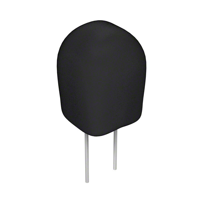

    钽电容 径向 270µF ±10% 6V - Ф10.16mm 14.22mm
TDL277K006M1E 数据手册
Type TDL Solid Tantalum Capacitors Dipped, Radial Leaded, Solid Tantalum Capacitors R EP LA C EM EN T The Type TDL, like the Type TDC, is a low cost alternative to molded solid tantalum capacitors, and is constructed in a tough, radial dipped flame retardant plastic case. It assures the user that it is a top performer with such attributes as low DCL, Low ESR, low impedance and a great value with low in-place cost. The 0.10” and 0.20” lead spacings of the TDL are what distinguishes it from the Type TDC. Highlights ♦ ♦ ♦ 0.10 µF to 330 µF 6 WVdc to 50 WVdc at 85 ºC ±10%, ±20% (±5% by Special Order) –55 ºC to +125 ºC (with proper derating) R Capacitance Range: Voltage Range: Tolerance: Operating Temperature Range: EQ U ♦ FO Specifications EN T ♦ AL ♦ Tough plastic case Low DCL Low ESR and impedance Low cost Temperature stable UL94VO flammability rating Resistant to shock and vibration IV ♦ KE M ET DC Leakage: TA C T Capacitance Change Maximum: Reel Packaging: D IS C O N TI N U ED C O N Reverse Voltage (Non-continuous): RoHS Compliant: +25 ºC - See ratings limit +85 ºC - 10 x Ratings limit +125 ºC - 12.5 x Ratings limit –10% @ –55 ºC +10% @ +85 ºC +12% @ +125 ºC 15% of rated voltage @ 25 ºC 5% of rated voltage @ 85 ºC 1% of rated voltage @ 125 ºC Case Quantity Code Per Reel A 1,500 B 1,500 C 1,500 D 1,000 E 1,000 F 1,000 Complies with the EU Directive 2002/95/EC requirement restricting the use of Lead (Pb), Mercury (Hg), Cadmium (Cd), Hexavalent chromium (Cr(VI)), PolyBrominated Biphenyls (PBB) and PolyBrominated Diphenyl Ethers (PBDE). CDE Cornell Dubilier • 1605 E. Rodney French Blvd. • New Bedford, MA 02744 • Phone: (508)996-8561 • Fax: (508)996-3830 • www.cde.com Type TDL Solid Tantalum Capacitors Dimensions - Inches (Millimeters) M H Max S A 0180 (4.57) .280 (7.11) .100 (2.54) (Standard) B 200 (5.08) .300 (7.62) .100 (2.54) (Standard) C .260 (6.60) .360 (9.14) .100 (2.54) (Standard) .200 (5.08) (Special) + + H (Max.) .200 (5.08) (Special) 226 10 226 10 H Max Leads D (Max.) .200 (5.08) (Special) .390 (10) Min D .020 (0.51) .187 ±.032 (4.75 ±0.81) S 1,500 M2 S1 1,500 M2 S1 1,000 M2 E .400 (10.16) .560 (14.22) .200 (5.08) (Standard) M1 1,000 F .440 (11.18) .680 (17.27) .200 (5.08) (Standard) M1 1,000 Lead DCL @ +25ºC Spacing @ +25ºC (S) 120 Hz Cap (%) (µF) (µA) 4 WVdc; 5 Vdc Surge @ 125 ºC 7 WVdc; 9 Vdc Surge @ 125 ºC 0.5 5 0.1 0.5 5 5 3.3 TDL335*010S1A A 0.1 0.5 5 5 3.9 TDL395*010S1A A 0.1 0.5 5 0.5 5 4.7 TDL475*010S1A A 0.1 0.5 5 0.5 6 5.6 TDL565*010S1A A 0.1 0.5 5 5.6 TDL565*006S1A A 0.1 0.5 6.8 TDL685*006S1A A 0.1 8.2 TDL825*006S1B B 0.1 ET 0.5 M 0.1 5 KE A 0.5 6 6.8 TDL685*010S1B B 0.1 0.5 5 0.6 6 8.2 TDL825*010S1B B 0.1 0.7 6 T C (%) 10 WVdc; 13 Vdc Surge @ 85 ºC 0.1 TDL475*006S1A 0.1 120 Hz (µA) A 4.7 0.1 (S) A 0.5 B @ +25ºC TDL275*010S1A 0.5 0.1 B DCL TDL225*010S1A 0.1 A TDL106*006S1B Lead Spacing @ +25ºC 2.7 A TDL395*006S1A TDL126*006S1B Case Code Max. DF 2.2 TDL335*006S1A 3.9 10 Catalog Part Number Max. 5 3.3 12 IV Max. DF R Case Code Max. 6.3 WVdc; 8 Vdc Surge @ 85 ºC 0.7 6 10 TDL106*010S1B B 0.1 0.8 6 0.9 6 12 TDL126*010S1C C 0.1 1.0 6 C 0.1 1.1 6 15 TDL156*010S1C C 0.1 1.2 6 C 0.1 1.3 6 18 TDL186*010S1C C 0.1 1.4 6 TDL226*010S1C C 0.1 1.8 6 B B 22 TDL226*006S1C 27 TDL276*006S1C TDL336*006S1C C 0.1 1.6 6 39 TDL396*006S1C C 0.1 1.9 6 27 TDL276*010S1C C 0.1 2.2 6 47 TDL476*006S1D D 0.1 2.3 6 33 TDL336*010S1D D 0.1 2.6 6 56 TDL566*006S1D D 0.1 2.7 6 39 TDL396*010S1D D 0.1 3.1 6 68 TDL686*006S1D D 0.1 3.3 6 47 TDL476*010S1D D 0.1 3.8 6 82 TDL826*006S1D D 0.1 3.9 8 56 TDL566*010S1D D 0.1 4.5 6 8 68 TDL686*010S1D D 0.1 5.4 6 TDL826*010M1E E 0.2 6.6 8 TI N ED 33 22 U C O N TDL156*006S1B TDL186*006S1B TA 0.1 0.1 15 18 TDL107*006S1D N 100 D 0.1 4.8 TDL127*006M1D D 0.2 5.8 8 150 TDL157*006M1E E 0.2 7.2 8 100 TDL107*010M1E E 0.2 8.0 8 180 TDL187*006M1E E 0.2 8.6 8 120 TDL127*010M1E E 0.2 9.6 8 220 TDL227*006M1E E 0.2 10 8 150 TDL157*010M1E E 0.2 10.0 8 270 TDL277*006M1E E 0.2 10 8 180 TDL187*010M1E E 0.2 10.0 8 8 220 TDL227*010M1F F 0.2 10.0 8 O 120 82 C IS .200 (5.08) (Special) FO Catalog Part Number (µF) D S1 Listed Catalog Numbers reflect standard lead forms as indicated below. M2 lead form and lead lengths of .500 (12.7) minumum are available by special order. Lead Form Code M2 Ratings Cap M2 AL Lead Form Codes S1, M1 1,500 EN T S .340 (8.64) .400 (10.16) .100 (2.54) (Standard) EQ U .020 (0.51) S1 R EP LA C .140 (3.56) Max Quantity Code Per Reel T D Max M D Max Case Code EM EN Capacitor Outline Drawing 330 TDL337*006M1F F 0.2 10 * Indicates capacitance tolerance: K = ±10%, M = ±20%, (J = ±5%, Special Order) CDE reserves the right to substitute a tighter tolerance, higher voltage capacitor within the same case size. CDE Cornell Dubilier • 1605 E. Rodney French Blvd. • New Bedford, MA 02744 • Phone: (508)996-8564 • Fax: (508)996-3830 • www.cde.com Type TDL Solid Tantalum Capacitors Ratings Case Code Lead DCL @ +25ºC Spacing @ +25ºC 120 Hz (µF) (S) (µA) Case Code (µF) (%) DCL @ +25ºC Lead Spacing @ +25ºC 120 Hz (S) (µA) (%) 0.1 0.5 5 0.1 0.5 5 0.1 0.5 5 0.1 0.5 5 0.1 0.5 5 0.1 0.6 5 0.1 0.8 5 10 WVdc; 12 Vdc Surge @ 125 ºC 13 WVdc; 16 Vdc Surge @ 125 ºC 0.1 0.5 5 1.5 TDL155*020S1A A 1.8 TDL185*016S1A A 0.1 0.5 5 1.8 TDL185*020S1A A 2.2 TDL225*016S1A A 0.1 0.5 5 2.2 TDL225*020S1A A 2.7 TDL275*016S1A A 0.1 0.5 5 2.7 TDL275*020S1A A 3.3 TDL335*016S1A A 0.1 0.5 5 3.3 TDL335*020S1A A 3.9 TDL395*016S1B B 0.1 0.5 5 3.9 TDL395*020S1B B 4.7 TDL475*016S1B B 0.1 0.6 5 4.7 TDL475*020S1B B 5.6 TDL565*016S1B B 0.1 0.7 5 5.6 TDL565*020S1B B 0.1 0.9 5 6.8 TDL685*016S1B B 0.1 0.9 5 6.8 TDL685*020S1B B 0.1 1.1 5 8.2 TDL825*016S1C C 0.1 1.0 6 8.2 TDL825*020S1B B 0.1 1.3 6 10 TDL106*016S1C C 0.1 1.3 6 10 TDL106*020S1C C 0.1 1.6 6 12 TDL126*016S1C C 0.1 1.5 6 12 TDL126*020S1C C 0.1 1.9 6 15 TDL156*016S1C C 0.1 1.8 6 15 TDL156*020S1C C 0.1 2.4 6 18 TDL186*016S1C C 0.1 2.2 6 18 TDL186*020S1C C 0.1 2.9 6 22 TDL226*016S1D D 0.1 2.6 6 22 TDL226*020S1C C 0.1 3.5 6 27 TDL276*016S1D D 0.1 3.2 6 27 TDL276*020M1E E 0.2 4.3 6 33 TDL336*016S1D D 0.1 4.0 33 TDL336*020M1E E 0.2 5.3 6 39 TDL396*016M1E E 0.2 4.7 6 39 TDL396*020M1E E 0.2 6.2 6 47 TDL476*016M1E E 0.2 5.6 6 47 TDL476*020M1E E 0.2 7.5 6 56 TDL566*016M1E E 0.2 6.8 6 56 TDL566*020M1E E 0.2 9 6 68 TDL686*016M1E E 0.2 8.2 6 68 TDL686*020M1E E 0.2 10 6 82 TDL826*016M1E E 0.2 9.8 8 82 TDL826*020M1F F 0.2 10 8 100 TDL107*016M1F F 0.2 10 8 100 TDL107*020M1F F 0.2 10 8 120 TDL127*016M1F F 0.2 10 8 25 WVdc; 32 Vdc Surge @ 85 ºC 150 TDL157*016M1F 0.2 10 8 16.5 WVdc; 21.5 Vdc Surge @ 125 ºC EN T AL IV EQ U FO ET M T C TA N C O F 6 R EP LA C A R 20 WVdc; 26 Vdc Surge @ 85 ºC KE 16 WVdc; 20 Vdc Surge @ 85 ºC TDL155*016S1A 1.0 TDL105*025S1A A 0.1 0.5 3 13 WVdc; 16 Vdc Surge @ 125 ºC 1.2 TDL125*025S1A A 0.1 0.5 5 ED 20 WVdc; 26 Vdc Surge @ 85 ºC TDL155*020S1A A 0.1 0.5 5 1.5 TDL155*025S1A A 0.1 0.5 5 1.8 TDL185*020S1A A 0.1 0.5 5 1.8 TDL185*025S1A A 0.1 0.5 5 TDL225*020S1A A 0.1 0.5 5 2.2 TDL225*025S1B B 0.1 0.5 5 2.7 TDL275*020S1A A 0.1 0.5 5 2.7 TDL275*025S1B B 0.1 0.5 5 3.3 TDL335*020S1A A 0.1 0.5 5 3.3 TDL335*025S1B B 0.1 0.7 5 3.9 TDL395*020S1B B 0.1 0.6 5 3.9 TDL395*025S1B B 0.1 0.8 5 4.7 TDL475*020S1B B 0.1 0.8 5 4.7 TDL475*025S1C C 0.1 0.9 5 5.6 TDL565*020S1B B 0.1 0.9 5 5.6 TDL565*025S1C C 0.1 1.1 5 6.8 TDL685*020S1B B 0.1 1.1 5 6.8 TDL685*025S1C C 0.1 1.4 5 8.2 TDL825*020S1B B 0.1 1.3 6 8.2 TDL825*025S1C C 0.1 1.6 6 O N TI N U 1.5 C IS Catalog Part Number Max. DF 1.5 2.2 D Cap Max. T Catalog Part Number Max. DF EM EN Cap Max. * Indicates capacitance tolerance: K = ±10%, M = ±20%, (J = ±5%, Special Order) CDE reserves the right to substitute a tighter tolerance, higher voltage capacitor within the same case size. CDE Cornell Dubilier • 1605 E. Rodney French Blvd. • New Bedford, MA 02744 • Phone: (508)996-8561 • Fax: (508)996-3830 • www.cde.com Type TDL Solid Tantalum Capacitors Ratings Code DCL @ +25ºC Spacing @ +25ºC (µF) (S) 120 Hz (µA) (%) Cap Lead 10 TDL106*025S1C C 0.1 2.0 6 (S) 12 TDL126*025S1C C 0.1 2.4 6 15 TDL156*025S1D D 0.1 3.0 6 18 TDL186*025S1D D 0.1 3.6 6 22 TDL226*025S1D D 0.1 4.4 6 27 TDL276*025M1E E 0.2 5.4 6 TDL186*035M1E E 22 TDL226*035M1E E 27 TDL276*035M1E E 33 TDL336*035M1F F 39 TDL396*035M1F F 47 TDL476*035M1F F 5.0 6 0.2 6.2 6 0.2 7.6 6 0.2 9.2 6 0.2 10.0 6 0.2 10.0 6 E 0.2 6.6 6 E 0.2 7.8 6 50 WVdc; 65 Vdc Surge @ 85 ºC 33 WVdc; 40 Vdc Surge @ 125 ºC 0.2 9.4 6 0.2 10.0 6 68 TDL686*025M1E F 0.2 10.0 6 .10 TDL104*050S1A A 0.1 0.5 3 .12 TDL124*050S1A A 0.1 0.5 3 .15 TDL154*050S1A A 0.1 0.5 3 .18 TDL184*050S1A A 0.1 0.5 3 .22 TDL224*050S1A A 0.1 0.5 3 .27 TDL274*050S1A A 0.1 0.5 3 .33 TDL334*050S1A A 0.1 0.5 3 .39 TDL394*050S1A A 0.1 0.5 3 .47 TDL474*050S1B B 0.1 0.5 3 .56 TDL564*050S1B B 0.1 0.5 3 TDL684*050S1B B 0.1 0.5 3 EQ U 35 WVdc; 46 Vdc Surge @ 85 ºC AL E E IV TDL476*025M1E EN T TDL336*025M1E TDL396*025M1E TDL566*025M1E 23 WVdc; 28 Vdc Surge @ 125 ºC 120 Hz 0.2 33 47 @ +25ºC (%) 39 56 DCL (µA) 23 WVdc; 28 Vdc Surge @ 125 ºC 18 Max. DF Spacing @ +25ºC 35 WVdc; 46 Vdc Surge @ 85 ºC 16.5 WVdc; 21.5 Vdc Surge @ 125 ºC TDL104*035S1A A 0.1 0.5 3 .12 TDL124*035S1A A 0.1 0.5 3 .15 TDL154*035S1A A 0.1 0.5 3 .18 TDL184*035S1A A 0.1 0.5 3 .22 TDL224*035S1A A 0.1 0.5 3 .27 TDL274*035S1A A 0.1 0.5 3 .33 TDL334*035S1A A 0.1 0.5 .39 TDL394*035S1A A 0.1 0.5 3 .68 .47 TDL474*035S1A A 0.1 0.5 3 .82 TDL824*050S1B B 0.1 0.5 3 .56 TDL564*035S1A A 0.1 0.5 3 1.0 TDL105*050S1C C 0.1 0.5 3 .68 TDL684*035S1A A 0.1 0.5 3 1.2 TDL125*050S1C C 0.1 0.5 5 .82 TDL824*035S1A A 0.1 0.5 3 1.0 TDL105*035S1B B 0.1 0.5 3 1.5 TDL155*050S1C C 0.1 0.6 5 1.2 TDL125*035S1B B 0.1 0.5 5 1.8 TDL185*050S1C C 0.1 0.7 5 1.5 TDL155*035S1B B 0.1 0.5 5 2.2 TDL225*050S1D D 0.1 0.9 5 1.8 TDL185*035S1B B 0.1 0.5 5 2.7 TDL275*050S1D D 0.1 1.1 5 2.2 TDL225*035S1C C 0.1 0.6 5 3.3 TDL335*050S1D D 0.1 1.3 5 2.7 TDL275*035S1C C 0.1 0.7 5 3.9 TDL395*050S1D D 0.1 1.6 5 3.3 TDL335*035S1C C 0.1 0.9 5 4.7 TDL475*050S1D D 0.1 1.9 5 3.9 TDL395*035S1C C 0.1 1.0 5 5.6 TDL565*050S1D D 0.1 2.2 5 TDL475*035S1D D 0.1 1.3 5 6.8 TDL685*050M1F F 0.2 2.7 5 TDL565*035S1D D 0.1 1.6 5 8.2 TDL825*050M1F F 0.2 3.3 6 6.8 TDL685*035S1D D 0.1 1.9 5 10 TDL106*050M1F F 0.2 4.0 6 8.2 TDL825*035S1D D 0.1 2.3 6 12 TDL126*050M1F F 0.2 4.8 6 10 TDL106*035S1D D 0.1 2.8 6 15 TDL156*050M1F F 0.2 6.0 6 18 TDL186*050M1F F 0.2 7.2 6 22 TDL226*050M1F F 0.2 8.8 6 C FO ET 3 M KE T C TA N O C ED U N TI O N 5.6 R .10 4.7 IS Case Code (µF) 25 WVdc; 32 Vdc Surge @ 85 ºC D Catalog Part Number Max. 12 TDL126*035M1E E 0.2 3.4 6 15 TDL156*035M1E E 0.2 4.2 6 T Part Number Lead EM EN Case Max. DF R EP LA C Cap Catalog Max. * Indicates capacitance tolerance: K = ±10%, M = ±20%, (J = ±5%, Special Order) CDE Cornell Dubilier • 1605 E. Rodney French Blvd. • New Bedford, MA 02744 • Phone: (508)996-8564 • Fax: (508)996-3830 • www.cde.com Type TDL Solid Tantalum Capacitors 050 M Lead Tolerance Voltage Spacing J = ±5% 006 = 6.3 Vdc S = .100 Series Capacitance TDL 104 = 0.10 µF K = ±10% 010 = 10 Vdc M = .200 M = ±20% 015 = 15 dc T = Tape & 020 = 20 Vdc Reel 025 = 25 Vdc 035 = 35 Vdc 050 = 50 Vdc F –F Lead Length Case Code A RoHS Compliant 1 = Straight .390 Long 2 = Straight .187 Long –F = Compliant B C D E F Blank= Not Compliant R EQ U IV AL 105 = 1.0 µF 225 = 2.2 µF 186 = 18 µF 107 = 100 µF 1 EM EN M R EP LA C 106 EN T TDL T Part Numbering System D IS C O N TI N U ED C O N TA C T KE M ET FO Notice and Disclaimer: All product drawings, descriptions, specifications, statements, information and data (collectively, the “Information”) in this datasheet or other publication are subject to change. The customer is responsible for checking, confirming and verifying the extent to which the Information contained in this datasheet or other publication is applicable to an order at the time the order is placed. All Information given herein is believed to be accurate and reliable, but it is presented without any guarantee, warranty, representation or responsibility of any kind, expressed or implied. Statements of suitability for certain applications are based on the knowledge that the Cornell Dubilier company providing such statements (“Cornell Dubilier”) has of operating conditions that such Cornell Dubilier company regards as typical for such applications, but are not intended to constitute any guarantee, warranty or representation regarding any such matter – and Cornell Dubilier specifically and expressly disclaims any guarantee, warranty or representation concerning the suitability for a specific customer application, use, storage, transportation, or operating environment. The Information is intended for use only by customers who have the requisite experience and capability to determine the correct products for their application. Any technical advice inferred from this Information or otherwise provided by Cornell Dubilier with reference to the use of any Cornell Dubilier products is given gratis (unless otherwise specified by Cornell Dubilier), and Cornell Dubilier assumes no obligation or liability for the advice given or results obtained. Although Cornell Dubilier strives to apply the most stringent quality and safety standards regarding the design and manufacturing of its products, in light of the current state of the art, isolated component failures may still occur. Accordingly, customer applications which require a high degree of reliability or safety should employ suitable designs or other safeguards (such as installation of protective circuitry or redundancies or other appropriate protective measures) in order to ensure that the failure of an electrical component does not result in a risk of personal injury or property damage. Although all product-related warnings, cautions and notes must be observed, the customer should not assume that all safety measures are indicated in such warnings, cautions and notes, or that other safety measures may not be required. CDE Cornell Dubilier • 1605 E. Rodney French Blvd. • New Bedford, MA 02744 • Phone: (508)996-8561 • Fax: (508)996-3830 • www.cde.com
