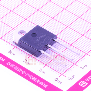

Continental Device India Limited An IS/ISO 9002 and IECQ Certified Manufacturer IS/ISO 9002 Lic# QSC/L- 000019.2 POWER TRANSISTORS CSA1301F PNP CSC3280F NPN TO- 3P Fully Isolated Plastic Package B C E Power Amplifier Applications. ABSOLUTE MAXIMUM RATINGS (Ta=25ºC unless specified otherwise ) VALUE DESCRIPTION SYMBOL VCBO 160 Collector -Base Voltage VCEO 160 Collector -Emitter Voltage VEBO 5.0 Emitter Base Voltage IC 12 Collector Current IB 1.2 Base Current Ptot 90 Total Power Dissipation up to Tc=25 ºC Tj 150 Junction Temperature Tstg - 55 to +150 Storage Temperature ELECTRICAL CHARACTERISTICS (Ta=25ºC unless specified otherwise) DESCRIPTION Collector Cut off Current Emitter Cut off Current Collector -Emitter Voltage Collector -Emitter Saturation Voltage SYMBOL ICBO IEBO VCEO VCE(sat) TEST CONDITION VCB=160V, IE=0 VEB =5V, IC =0 IC=50mA, IB =0 IC=0.8A, IB =0.8A CSA1301F CSC3280F IC=6A, VCE=5V IC=1A, VCE=5V * IC=6A, VCE=5V IE=0, VCB=10V ,f=1MHz CSA1301F CSC3280F IC=1A, VCE=5V R: 55 - 110 ; MIN TYP MAX 5.0 5.0 UNIT µΑ µΑ V V V UNIT V V V A A W ºC ºC 160 2.8 2.0 1.5 200 Base Emitter on Voltage DC Current Gain Collector Output Capacitance VBE (on) hFE Cob 55 28 480 220 30 pF MHz Transition Frequency * hFE Classification fT O : 80 - 200 Continental Device India Limited Data Sheet Page 1 of 3 CSA1301F PNP CSC3280F NPN TO- 3P Fully Isolated Plastic Package TO-3P (TO-218) Plastic Package A D B C DIM A B C MIN 15.80 5.20 3.80 Ø 3.30 14.50 33.25 20.75 11.50 1.00 18.75 0.40 3.15 MAX 16.40 5.70 4.20 Ø 3.60 15.10 36.75 21.25 12.25 1.30 21.65 0.60 3.45 G S E H D E F G H F 1 2 3 K P P M N L K L M N 5.21 5.72 P S 18.75 19.25 All diminsions in mm. 1 2 3 Pin Configuration 1. Base 2. Collector 3. Emitter Packing Detail PACKAGE TO-3P STANDARD PACK Details Net Weight/Qty 100 pcs/polybag 628 gm/100 pcs INNER CARTON BOX Size Qty 3" x 7.5" x 7.5" 0.3K Size OUTER CARTON BOX Qty Gr Wt 4.8K 42 kgs 17" x 15" x 13.5" Continental Device India Limited Data Sheet Page 2 of 3 Notes CSA1301F PNP CSC3280F NPN TO- 3P Fully Isolated Plastic Package Disclaimer The product information and the selection guides facilitate selection of the CDIL's Discrete Semiconductor Device(s) best suited for application in your product(s) as per your requirement. It is recommended that you completely review our Data Sheet(s) so as to confirm that the Device(s) meet functionality parameters for your application. The information furnished in the Data Sheet and on the CDIL Web Site/CD is believed to be accurate and reliable. CDIL however, does not assume responsibility for inaccuracies or incomplete information. Furthermore, CDIL does not assume liability whatsoever, arising out of the application or use of any CDIL product; neither does it convey any license under its patent rights nor rights of others. These products are not designed for use in life saving/support appliances or systems. CDIL customers selling these products (either as individual Discrete Semiconductor Devices or incorporated in their end products), in any life saving/support appliances or systems or applications do so at their own risk and CDIL will not be responsible for any damages resulting from such sale(s). CDIL strives for continuous improvement and reserves the right to change the specifications of its products without prior notice. CDIL is a registered Trademark of Continental Device India Limited C-120 Naraina Industrial Area, New Delhi 110 028, India. Telephone + 91-11-579 6150 Fax + 91-11-579 9569, 579 5290 www.cdil.com e-mail sales@cdil.com CSA1301F_CSC3280FRev201201E Continental Device India Limited Data Sheet Page 3 of 3

1. 物料型号: - CSA1301F(PNP型) - CSC3280F(NPN型)
2. 器件简介: - 这些是功率晶体管,适用于功率放大器应用。
3. 引脚分配: - 1. Base(基极) - 2. Collector(集电极) - 3. Emitter(发射极)
4. 参数特性: - 绝对最大额定值: - 集电极-基极电压VCBO:160V - 集电极-发射极电压VCEO:160V - 发射极-基极电压VEBO:5.0V - 集电极电流IC:12A - 基极电流IB:1.2A - 总功率耗散(Tc=25ºC)Ptot:90W - 结温Tj:150ºC - 存储温度Tstg:-55至+150ºC - 电学特性(Ta=25ºC): - 集电极截止电流ICBO(VCB=160V, IE=0):5.0µA - 发射极截止电流IEBO(VEB=5V, IC=0):5.0µA - 集电极-发射极电压VCEO(IC=50mA, IB=0):160V - 集电极-发射极饱和电压VCE(sat)(IC=0.8A, IB=0.8A): CSA1301F:2.8V CSC3280F:2.0V - 基极-发射极导通电压VBE(on)(IC=6A, VCE=5V):1.5V - DC电流增益hFE(IC=1A, VCE=5V):55至200 (IC=6A, VCE=5V):28 - 集电极输出电容Cob(IE=0, VCB=10V, f=1MHz): CSA1301F:480pF CSC3280F:220pF - 转换频率fT(IC=1A, VCE=5V):30MHz
5. 功能详解: - 这些晶体管被设计用于功率放大器应用,具有较高的电压和电流承受能力。
6. 应用信息: - 适用于功率放大器。
7. 封装信息: - TO-3P(TO-218)全绝缘塑料封装。 - 尺寸参数: - A:15.80至16.40mm - B:5.20至5.70mm - C:3.80至4.20mm - 更多尺寸参数在文档中详述。 - 包装细节: - 标准包装:100 pcs/polybag,628 gm/100 pcs - 内盒尺寸:3"x7.5"x7.5",0.3K - 外盒尺寸:17"x15"x13.5",4.8K,毛重42 kgs
