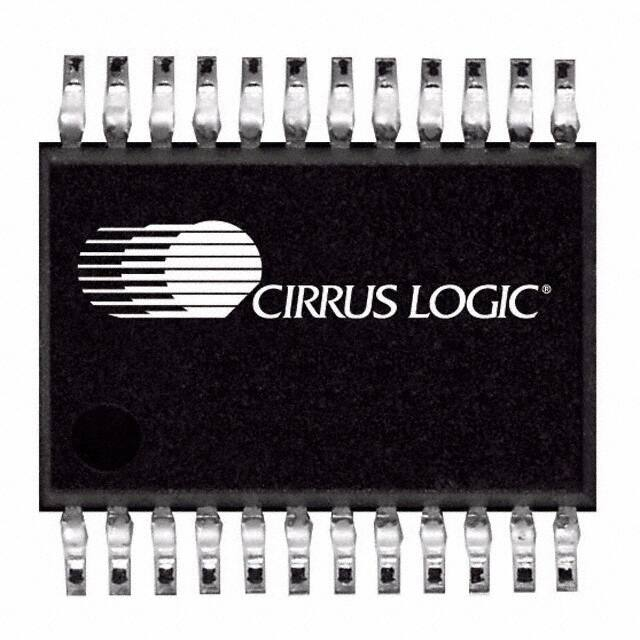

CS3302 High-Z, Programmable Gain, Differential Amplifier Features & Description Description z Signal The CS3302 is a high-input-impedance, differential input, differential output amplifier with programmable gain, optimized for amplifying signals from high-impedance sensors such as hydrophones. The gain settings are binary weighted (x1, x2, x4, x8, x16, x32, x64) and are selected using simple pin settings. Two sets of external inputs, INA and INB, simplify system design as inputs from a sensor and test DAC. An internal 800Ω termination can also be selected for noise tests. Bandwidth: DC to 2 kHz z Selectable Gain: x1, x2, x4, x8, x16, x32, x64 z Differential Inputs, Differential Outputs • • • • Multiplexed inputs: INA, INB, 800Ω termination Rough / fine charge outputs for CS5371/72 Max signal amplitude: 5 Vpp differential Ultra-low input bias: < 1 pA z Excellent Noise Performance • 1 µVp-p between 0.1 Hz and 10 Hz • 8.5 nV/ √Hz from 200 Hz to 2 kHz Amplifier input impedance is very high, requiring less than 1 pA of input current. Noise performance is very good at 1 µVp-p between 0.1 Hz and 10 Hz, and a noise density of 8.5 nV/ √Hz over the 200 Hz to 2 kHz bandwidth. Distortion performance is also extremely good, typically -118 dB THD. Low input current, low noise, and low total harmonic distortion make this amplifier ideal for high-impedance differential sensors requiring maximum dynamic range. z Low Total Harmonic Distortion • -118 dB THD typical (0.000126%) • -112 dB THD maximum (0.000251%) z Low Power Consumption • Normal / LPWR / PWDN: 5 mA, 3.3 mA, 10 µA z Single or Dual Power Supply Configurations • VA+ = +5 V; VA- = 0 V; VD = +3.3 V to +5 V • VA+ = +2.5 V; VA- = -2.5 V; VD = +3.3 V VA+ INA+ INB+ ORDERING INFORMATION See page 15. GUARD VD 640 Ω 500 + OUTR+ OUTF+ 400 Ω 500 640 Ω GAIN0 GAIN1 GAIN2 400 Ω MUX0 MUX1 500 640 Ω INAINB- 640 Ω 500 + VA- http://www.cirrus.com OUTFOUTR- - LPWR PWDN Copyright © Cirrus Logic, Inc. 2007 (All Rights Reserved) DGND DEC ‘07 DS596F3 CS3302 TABLE OF CONTENTS 1. CHARACTERISTICS AND SPECIFICATIONS........................................................................ 4 SPECIFIED OPERATING CONDITIONS ................................................................................ 4 ABSOLUTE MAXIMUM RATINGS .......................................................................................... 4 THERMAL CHARACTERISTICS ............................................................................................. 5 ANALOG CHARACTERISTICS ............................................................................................... 5 DIGITAL CHARACTERISTICS ................................................................................................ 8 POWER SUPPLY CHARACTERISTICS ................................................................................. 9 2. GENERAL DESCRIPTION..................................................................................................... 10 2.1. Analog Signals .............................................................................................................. 10 2.2.1.Analog Inputs ....................................................................................................... 10 2.3.2.Analog Outputs..................................................................................................... 10 2.4.3.Differential Signals ............................................................................................... 11 2.5.4.Guard Output........................................................................................................ 11 2.6. Digital Signals................................................................................................................ 11 2.7.1.Gain Selection ...................................................................................................... 11 2.8.2.Mux Selection ....................................................................................................... 11 2.9.3.Low Power Selection ............................................................................................ 11 2.10.4.Power Down Selection ....................................................................................... 11 2.11. Power Supplies ............................................................................................................. 11 2.12.1.Analog Power Supplies ...................................................................................... 11 2.13.2.Digital Power Supplies ....................................................................................... 12 2.14. Connection Diagram...................................................................................................... 13 3. PIN DESCRIPTION ................................................................................................................ 14 4. ORDERING INFORMATION ................................................................................................. 15 5. ENVIRONMENTAL, MANUFACTURING, & HANDLING INFORMATION............................ 15 6. PACKAGE DIMENSIONS ...................................................................................................... 16 2 DS596F3 CS3302 LIST OF FIGURES Figure 1. CS3302 Noise Performance ............................................................................................ 5 Figure 2. Digital Input Rise and Fall Times ..................................................................................... 8 Figure 3. System Architecture....................................................................................................... 10 Figure 4. CS3302 Amplifier Connections ...................................................................................... 13 Figure 5. CS3302 Pin Assignments .............................................................................................. 14 LIST OF TABLES Table 1. Digital Selection for Gain and Input Mux Control ............................................................. 8 Table 2. Pin Descriptions ............................................................................................................. 14 REVISION HISTORY Revision Date Changes PP2 JUL 2003 Final preliminary release. F1 AUG 2005 Updated legal notice. Added MSL data. F2 SEP 2005 Updated anti-alias resistor values, relative gain accuracy, input voltage noise, and CS4373A part number. F3 DEC 2007 Added watermark to indicate device is not recommended for new designs. Contacting Cirrus Logic Support For all product questions and inquiries contact a Cirrus Logic Sales Representative. To find one nearest you go to www.cirrus.com IMPORTANT NOTICE Cirrus Logic, Inc. and its subsidiaries (“Cirrus”) believe that the information contained in this document is accurate and reliable. However, the information is subject to change without notice and is provided “AS IS” without warranty of any kind (express or implied). Customers are advised to obtain the latest version of relevant information to verify, before placing orders, that information being relied on is current and complete. All products are sold subject to the terms and conditions of sale supplied at the time of order acknowledgment, including those pertaining to warranty, indemnification, and limitation of liability. No responsibility is assumed by Cirrus for the use of this information, including use of this information as the basis for manufacture or sale of any items, or for infringement of patents or other rights of third parties. This document is the property of Cirrus and by furnishing this information, Cirrus grants no license, express or implied under any patents, mask work rights, copyrights, trademarks, trade secrets or other intellectual property rights. Cirrus owns the copyrights associated with the information contained herein and gives consent for copies to be made of the information only for use within your organization with respect to Cirrus integrated circuits or other products of Cirrus. This consent does not extend to other copying such as copying for general distribution, advertising or promotional purposes, or for creating any work for resale. CERTAIN APPLICATIONS USING SEMICONDUCTOR PRODUCTS MAY INVOLVE POTENTIAL RISKS OF DEATH, PERSONAL INJURY, OR SEVERE PROPERTY OR ENVIRONMENTAL DAMAGE (“CRITICAL APPLICATIONS”). CIRRUS PRODUCTS ARE NOT DESIGNED, AUTHORIZED OR WARRANTED FOR USE IN PRODUCTS SURGICALLY IMPLANTED INTO THE BODY, AUTOMOTIVE SAFETY OR SECURITY DEVICES, LIFE SUPPORT PRODUCTS OR OTHER CRITICAL APPLICATIONS. INCLUSION OF CIRRUS PRODUCTS IN SUCH APPLICATIONS IS UNDERSTOOD TO BE FULLY AT THE CUSTOMER'S RISK AND CIRRUS DISCLAIMS AND MAKES NO WARRANTY, EXPRESS, STATUTORY OR IMPLIED, INCLUDING THE IMPLIED WARRANTIES OF MERCHANTABILITY AND FITNESS FOR PARTICULAR PURPOSE, WITH REGARD TO ANY CIRRUS PRODUCT THAT IS USED IN SUCH A MANNER. IF THE CUSTOMER OR CUSTOMER'S CUSTOMER USES OR PERMITS THE USE OF CIRRUS PRODUCTS IN CRITICAL APPLICATIONS, CUSTOMER AGREES, BY SUCH USE, TO FULLY INDEMNIFY CIRRUS, ITS OFFICERS, DIRECTORS, EMPLOYEES, DISTRIBUTORS AND OTHER AGENTS FROM ANY AND ALL LIABILITY, INCLUDING ATTORNEYS' FEES AND COSTS, THAT MAY RESULT FROM OR ARISE IN CONNECTION WITH THESE USES. Cirrus Logic, Cirrus, and the Cirrus Logic logo designs are trademarks of Cirrus Logic, Inc. All other brand and product names in this document may be trademarks or service marks of their respective owners. DS596F3 3 CS3302 1. CHARACTERISTICS AND SPECIFICATIONS • Min/Max characteristics and specifications are guaranteed over the Specified Operating Conditions. • Typical performance characteristics and specifications are derived from measurements taken at nominal supply voltages and TA = 25°C. • DGND = 0 V, all voltages with respect to 0 V. SPECIFIED OPERATING CONDITIONS Parameter Symbol Min Nom Max Unit Unipolar Power Supplies Positive Analog VA+ 4.75 5.0 5.25 V Negative Analog (Note 1) VA- -0.25 0 0.25 V Positive Digital (Note 2) VD 3.135 3.3 5.25 V Bipolar Power Supplies Positive Analog VA+ 2.375 2.5 2.625 V Negative Analog (Note 1) VA- -2.625 -2.5 -2.375 V Positive Digital (Note 2) VD 3.135 3.3 3.465 V Industrial (-IS, -ISZ) TA -40 - 85 °C Thermal Ambient Operating Temperature Notes: 1. VA- must be the most negative voltage to avoid potential SCR latch-up conditions. 2. VD must conform to Digital Supply Differential under Absolute Maximum Ratings. ABSOLUTE MAXIMUM RATINGS CS3302 Parameter DC Power Supplies Positive Analog Negative Analog Digital Symbol Min Max Unit VA+ VAVD -0.3 -6.8 -0.3 6.8 0.3 6.8 V V V Analog Supply Differential [(VA+) - (VA-)] VADIFF - 6.8 V Digital Supply Differential [(VD) - (VA-)] VDDIFF - 6.8 V Input Current, Any Pin Except Supplies (Note 3) IIN - +10 mA Input Current, Power Supplies (Note 3) IIN - +50 mA Output Current (Note 3) IOUT - +25 mA PDN - 500 mW Analog Input Voltages VINA (VA-)-0.5 (VA+)+0.5 V Digital Input Voltages VIND -0.5 (VD)+0.5 V TA -40 85 ºC TSTG -65 150 ºC Power Dissipation Ambient Operating Temperature (Power Applied) Storage Temperature Range WARNING: Operation at or beyond these limits may result in permanent damage to the device. Normal operation is not guaranteed at these extremes. Notes: 3. Transient currents up to 100mA will not cause SCR latch-up. 4 DS596F3 CS3302 THERMAL CHARACTERISTICS CS3302 Parameter Symbol Allowable Junction Temperature Min Typ Max Unit - - 135 ºC 65 - ºC / W - +85 ºC Junction to Ambient Thermal Impedance ΘJA - Ambient Operating Temperature (Power Applied) TA -40 ANALOG CHARACTERISTICS CS3302 Parameter Symbol Min Typ Max Unit Noise Performance, Normal Power Input Voltage Noise f0 = 0.1 Hz to 10 Hz VNPP - 1 3 µVpp Input Voltage Noise Density f0 = 200 Hz to 2 kHz VND - 8.5 12 nV/ Hz Input Current Noise Density (Note 4) IND - 20 - fA/ Hz Noise Performance, Low Power (LPWR=1) Input Voltage Noise f0 = 0.1 Hz to 10 Hz VNPP - 1 3 µVpp Input Voltage Noise Density f0 = 200 Hz to 2 kHz VND - 10 15 nV/ Hz Input Current Noise Density (Note 4) IND - 1 - fA/ Hz Total Harmonic Distortion (Note 5, 6) THD - -118 -112 dB Linearity (Note 5, 6) LIN - 0.000126 0.000251 % Distortion Performance, Normal Power Distortion Performance, Low Power (LPWR=1) Total Harmonic Distortion (Note 5, 6) THD - -118 -110 dB Linearity (Note 5, 6) LIN - 0.000126 0.000316 % Notes: 4. Guaranteed by design and/or characterization. 5. Tested with a full scale input signal of 31.25 Hz. 6. Noise in the harmonic bins dominates THD and linearity measurements for x16, x32, and x64 gains. CS3302 In-Band Noise CS3302 Wide Band Noise 300 Noise Density (nV/rtHz) Noise Density (nV/rtHz) 20 15 10 5 250 200 150 100 50 0 0 0 200 400 600 800 1000 1200 1400 1600 1800 2000 0.1 1 10 100 1000 10000 100000 1E+06 Frequency (Hz) Frequency (Hz) Figure 1. CS3302 Noise Performance DS596F3 5 CS3302 ANALOG CHARACTERISTICS (CONT.) CS3302 Parameter Symbol Min Typ Max GAIN x1 - x64 Unit Gain Gain, Differential Gain, Common Mode (Note 7) GAINCM - x1 - Gain Accuracy, Absolute (Note 8) GAINABS - +1 +2 (Note 9) GAINREL - +0.2 +0.5 % (Note 4, 10) GAINTC - 5 - ppm / ºC OFST - +250 +750 µV Gain Accuracy, Relative Gain Drift % Offset Offset Voltage, Input Referred (Note 11) Offset After Calibration, Absolute (Note 12) OFSTCAL - +1 - µV (Note 13) OFSTRNG (Note 4, 10) OFSTTC - 100 - % F.S. - 1 - µV / ºC Offset Calibration Range Offset Voltage Drift Notes: 7. Common mode signals pass through the differential amplifier architecture. 8. Absolute gain accuracy tests the matching of x1 gain across multiple CS3302 devices. 9. Relative gain accuracy tests the tracking of x1,x2, x4,x16,x32,x64 gain relative to x8 gain on a single CS3302 device. 10. Specification is for the parameter over the specified temperature range and is for the CS3302 device only. It does not include the effects of external components. 11. Offset voltage is tested with the amplifier inputs connected to the internal 800Ω termination. 12. The absolute offset after calibration specification applies to the effective offset voltage of the CS3302 output when used with the CS5371/72 modulator and CS5376A digital filter, and is measured from the digitally calibrated output codes of the CS5376A. 13. The CS3302 offset calibration is performed digitally with the CS5371/72 modulator and CS5376A digital filter and includes the full scale signal range. Calibration offsets of greater than + 5% of full scale will begin to subtract from system dynamic range. 6 DS596F3 CS3302 ANALOG CHARACTERISTIC (Cont.) CS3302 Parameter Symbol Min Typ Max Unit BW DC VIN (VA-)+0.7 (VA-)+0.7 - 2000 Hz - (VA+)-1.25 (VA+)-1.75 V VINFS - - 5 2.5 1.25 625 312.5 156.25 78.125 Vp-p Vp-p Vp-p mVp-p mVp-p mVp-p mVp-p Input Impedance, Differential ZINDIFF - 1, 20 - TΩ, pF Input Impedance, Common Mode ZINCM - 0.5, 40 - TΩ, pF Analog Input Characteristics Input Signal Frequencies Input Voltage Range (Signal + Vcm) (Note 14) Full Scale Input, Differential x1 x2 - x64 x1 x2 x4 x8 x16 x32 x64 Input Bias Current Crosstalk, Multiplexed Inputs Common to Differential Mode Rejection (Note 4) (Note 4, 15) IIN - 1 40 pA XT - -130 - dB CDMR 90 100 - dB Analog Output Characteristics Full Scale Output, Differential VOUT - - 5 Vpp Output Voltage Range (Signal + Vcm) VRNG (VA-)+0.5 - (VA+)-0.5 V Output Impedance (Note 16) ZOUT - 640 - Ω Output Impedance Drift (Note 16) ZTC - 0.38 - Ω/°C IOUT - - 3.33 mA CL - - 100 nF Guard Output Voltage VGUARD - Vcm - V Guard Output Impedance ZGOUT - 500 - Ω Guard Output Current IGOUT - 40 - µA CGL - - 100 pF Output Current Load Capacitance Guard Output Characteristics Guard Load Capacitance Notes: 14. No signal sources operating from external supplies should be applied to pins of the device prior to its own supplies being established. Connecting any terminal to voltages greater than VA+ or less than VAmay cause destructive latch-up. 15. Ratio of common mode input amplitude vs. differential mode output amplitude for a perfectly matched common mode input signal. Characterized with a 50 Hz, 500 mVpeak common mode sine wave applied to the analog inputs. 16. Output impedance characteristics are primarily determined by the integrated anti-alias resistors. Values are approximate and can vary +/- 10% depending on process parameters. DS596F3 7 CS3302 DIGITAL CHARACTERISTICS CS3302 Parameter Symbol Min Typ Max Unit Digital Characteristics High-level Input Drive Voltage (Note 17) VIH 0.6*VD - VD V Low-level Input Drive Voltage (Note 17) VIL 0.0 - 0.8 V IIN - +1 +10 µA Input Leakage Current Digital Input Capacitance CIN - 9 - pF Rise Times tRISE - - 100 ns Fall Times tFALL - - 100 ns Notes: 17. Device is intended to be driven with CMOS logic levels. t rise t fall 0.9 * VD 0.1 * VD Figure 2. Digital Input Rise and Fall Times Input Selection MUX1 MUX0 Gain Selection GAIN2 GAIN1 GAIN0 800 Ω termination 0 0 x1 0 0 0 INA only 1 0 x2 0 0 1 INB only 0 1 x4 0 1 0 INA + INB 1 1 x8 0 1 1 x16 1 0 0 x32 1 0 1 x64 1 1 0 Reserved 1 1 1 Table 1. Digital Selection for Gain and Input Mux Control 8 DS596F3 CS3302 POWER SUPPLY CHARACTERISTICS CS3302 Parameter Symbol Min Typ Max Unit Power Supply Current, Normal Mode Analog Power Supply Current (Note 18) IA - 5.0 5.75 mA Digital Power Supply Current (Note 18) ID - 0.1 0.2 mA Power Supply Current, Low Power Mode Analog Power Supply Current, LPWR = 1 (Note 18) IA - 3.4 4.0 mA Digital Power Supply Current, LPWR = 1 (Note 18) ID - 0.1 0.2 mA Analog Power Supply Current, PWDN = 1 (Note 18) IA - 9 11 µA Digital Power Supply Current, PWDN = 1 (Note 18) ID - 2 8 µA PSRR 95 120 - dB Power Supply Current, Power Down Mode Power Supply Rejection Power Supply Rejection Ratio (Note 4, 19) Notes: 18. All outputs unloaded. Analog inputs connected to the internal 800 Ω termination. Digital inputs forced to VD or DGND respectively. 19. Power supply rejection characterized with a 50 Hz, 400 mVpp sine wave applied separately to each supply. DS596F3 9 CS3302 2. GENERAL DESCRIPTION The CS3302 is a high-impedance, low-noise CMOS differential input, differential output amplifier for precision analog signals between DC and 2 kHz. It has multiplexed inputs, rough/fine charge outputs, and programmable gains of x1, x2, x4, x8, x16, x32, and x64. The amplifier’s performance makes it ideal for low-frequency, high-dynamic-range applications requiring low distortion and minimal power consumption. It’s optimized for use in acquisition systems designed around the CS5371/72 single/dual ∆Σ modulators and the CS5376A quad digital filter. Figure 3 shows the system-level architecture of a 4-channel acquisition system using four CS3302, two CS5372, one CS4373A, and one CS5376A. Geophone or Hydrophone Sensor Geophone or Hydrophone Sensor M U X CS3301 CS3302 AMP 2.1 Analog Signals 2.1.1 Analog Inputs The amplifier analog inputs are designed for highimpedance differential sensors. Input multiplexing simplifies system connections by providing separate inputs for a sensor and test DAC (INA, INB) as well as an internal termination for noise tests. The MUX0, MUX1 digital pins determine which multiplexed input is connected to the amplifier. 2.1.2 Analog Outputs The amplifier analog outputs are separated into rough charge / fine charge signals to easily connect to the CS5371/72 inputs. Each output also includes a series resistor, requiring only two differential capacitors to create the CS5371/72 input anti-alias filter. CS5371 CS5372 System Telemetry ∆Σ M odulator M U X CS3301 CS3302 AMP CS5376A µController or Configuration EEPROM Digital Filter Geophone or Hydrophone Sensor Geophone or Hydrophone Sensor M U X M U X CS3301 CS3302 CS5371 CS5372 AMP CS3301 CS3302 Communication Interface ∆Σ M odulator AMP CS4373A Switch Switch MUX MUX Test DAC Figure 3. System Architecture 10 DS596F3 CS3302 2.1.3 Differential Signals Analog signals into and out of the CS3302 are differential, consisting of two halves with equal but opposite magnitude varying about a common mode voltage. A full scale 5 Vpp differential signal centered on a -0.15 V common mode can have: the signal common mode varies. The GUARD output will not drive a significant load, it only provides a shielding voltage. 2.2 Digital Signals 2.2.1 Gain Selection SIG- = -0.15 V - 1.25 V = -1.4 V The CS3302 supports gain ranges of x1, x2, x4, x8, x16, x32, and x64. They are selected using the GAIN0, GAIN1, and GAIN2 pins as shown in Table 1 on page 8. SIG+ is +2.5 V relative to SIG- 2.2.2 SIG+ = -0.15 V + 1.25 V = 1.1 V For the reverse case: SIG+ = -0.15 V - 1.25 V = -1.4 V SIG- = -0.15 V + 1.25 V = 1.1 V SIG+ is -2.5 V relative to SIGThe total swing for SIG+ relative to SIG- is (+2.5 V) - (-2.5 V) = 5 Vpp. A similar calculation can be done for SIG- relative to SIG+. Note that a 5 Vpp differential signal centered on a -0.15 V common mode voltage never exceeds 1.1 V and never drops below -1.4 V on either half of the signal. By definition, differential voltages are to be measured with respect to the opposite half, not relative to ground. A multimeter differentially measuring between SIG+ and SIG- in the above example would properly read 1.767 Vrms, or 5 Vpp. 2.1.4 Guard Output The GUARD pin outputs the common mode voltage of the currently selected analog signal input. It can be used to drive the cable shield between a high-impedance sensor and the amplifier inputs. Driving the cable shield with the analog signal common mode voltage minimizes leakage and improves signal integrity from high-impedance sensors. The GUARD output is defined as the midpoint voltage between the + and - halves of the currently selected differential input signal, and will vary as DS596F3 Mux Selection The analog inputs to the amplifier are multiplexed, with external signals applied to the INA+, INA- or INB+, INB- pins. An internal termination is also available for noise tests. Input mux selection is made using the MUX0 and MUX1 pins as shown in Table 1 on page 8. Although a mux selection is provided to enable the INA and INB switches simultaneously, significant current should not be driven through them in this mode. The CS3302 mux switches will maintain good linearity only with minimal signal current. 2.2.3 Low Power Selection For applications where power is critical, a lowpower mode can be selected. This mode reduces amplifier power consumption at the expense of slightly degraded performance. Low power mode is selected using the LPWR pin, which is active high. 2.2.4 Power Down Selection A power-down mode is available to shut down the amplifier when not in use. When enabled, all internal circuitry is disabled, the analog inputs and outputs go high-impedance, and the device enters a micro-power state. Power down mode is selected using the PWDN pin, which is active high. 2.3 2.3.1 Power Supplies Analog Power Supplies The analog power pins of the CS3302 are to be supplied with a total of 5 V between VA+ and VA-. 11 CS3302 This voltage is typically from a bipolar ±2.5 V supply. When using bipolar supplies the analog signal common mode voltage should be biased to 0 V. The analog power supplies are recommended to be bypassed to system ground using 0.1 µF X7R type capacitors. the VA- supply before analog signals are applied to the device. It is recommended to clamp the VAsupply to system ground using a reverse biased Schottky diode to prevent possible latch-up conditions related to mismatched supply rail initialization. The VA- supply is connected to the CMOS substrate and as such must remain the most negative applied voltage to prevent potential latch-up conditions. Care should be taken to ensure analog input voltages do not drop more than -0.3 V below the VA- supply. Care should also be taken to establish 2.3.2 12 Digital Power Supplies The digital power supply across the VD and DGND pins is flexible and can be set to interface with 3.3 V or 5 V logic. The digital power supply should be bypassed to system ground using a 0.01 µF X7R type capacitor. DS596F3 CS3302 2.4 Connection Diagram Figure 4 shows a connection diagram for the CS3302 amplifier when used with the CS5372 dual ∆Σ modulator, the CS4373A test DAC and the CS5376A digital filter. The diagram shows differ- ential sensors, a test DAC, and analog outputs with anti-alias capacitors; power supply connections including recommended bypassing; and digital control connections back to the CS5376A GPIO pins. G PIO (x3) G PIO (x2) G PIO G PIO 3 2 G AIN M UX P W DN To CS 5376 A D igital C ontrol LPW R VA+ VD VA+ V A+ VD 0.1µF 0.01µF VD CS3302 D ifferential A m plifier 0.1µF 0.01µF VA+ VA- VA0.1µF IN A + VD DG ND IN A- G UARD IN B- IN B+ O U TR - O U TF- O UTF+ M D A TA1 M FLAG 1 PW DN1 O U TR+ IN R+ IN F+ 0.02µF C 0G 0.02µF C 0G IN FIN R- D ifferential S ensor M CLK M S YNC VRE F+ CS4373A Test D AC CS 5372 ∆Σ M odulator 2.5 V R eference VRE FD ifferential S ensor LP W R O FST IN RIN F0.02µF C 0G 0.02µF C 0G IN F+ IN R+ IN A + IN A- G UARD IN B- IN B+ O U TR - O U TF- O UTF+ M D A TA2 M FLAG 2 PW DN2 O U TR+ VA+ VD V A+ VD VACS3302 D ifferential A m plifier 0.1µF 0.01µF VA- VA0.1µF 0.1µF DGND G AIN M UX PW DN 2 3 D G ND V A- LPW R G PIO G PIO G PIO (x2) G PIO (x3) To CS 5376 A D igital C ontrol Figure 4. CS3302 Amplifier Connections DS596F3 13 CS3302 3. PIN DESCRIPTION Positive Analog Power Supply VA+ 1 24 MUX0 Input Mux Select Negative Analog Rough Output OUTR- 2 23 MUX1 Input Mux Select Negative Analog Fine Output OUTF- 3 22 GAIN0 Gain Range Select Negative Analog Power Supply VA- 4 21 GAIN1 Gain Range Select Non-Inverting Input A INA+ 5 20 GAIN2 Gain Range Select Inverting Input A INA- 6 19 PWDN Power Down Mode Enable Inverting Input B INB- 7 18 LPWR Low Power Mode Enable Non-Inverting Input B INB+ 8 17 TEST1 Test Mode Select Test Mode Output TESTOUT 9 16 VD Positive Digital Power Supply Positive Analog Fine Output OUTF+ 10 15 DGND Digital Ground Positive Analog Rough Output OUTR+ 11 14 TEST2 Test Mode Select Test Mode Select TEST0 12 13 GUARD Guard Voltage Output Figure 5. CS3302 Pin Assignments Pin Name VA+ Pin # I/O 1 I Pin Description Positive analog supply voltage. VA- 4 I Negative analog supply voltage. VD 16 I Positive digital supply voltage. DGND 15 I Digital ground. INA+, INA- 5, 6 I Channel A differential analog inputs. Selected via MUX pins. INB+, INB- 8, 7 I Channel B differential analog inputs. Selected via MUX pins. 13 O Guard voltage output. OUTR+, OUTR- 11, 2 O Rough charge differential analog outputs. OUTF+, OUTF- 10, 3 O Fine charge differential analog outputs. GAIN0, GAIN1, GAIN2 22, 21, 20 I Gain range select. See Gain Selection table in Digital Characteristics section. LPWR 18 I Low power mode enable. Active high. PWDN 19 I Power down mode enable. Active high. 24, 23 I Analog input select. See Input Selection table in Digital Characteristics section. GUARD MUX0, MUX1 TEST0 TEST1, TEST2 TESTOUT 12 I 17, 14 I Test mode select, factory use only. Connect to VA- during normal operation. Test mode select, factory use only. Connect to DGND during normal operation. 9 O Test mode output, factory use only. Connect to VA- during normal operation. Table 2. Pin Descriptions 14 DS596F3 CS3302 4. ORDERING INFORMATION Model CS3302-IS CS3302-ISZ (lead free) 5. Temperature Package -40 to +85 °C 24-pin SSOP ENVIRONMENTAL, MANUFACTURING, & HANDLING INFORMATION Model Number Peak Reflow Temp MSL Rating* Max Floor Life CS3302-IS 240 °C 2 365 Days CS3302-ISZ (lead free) 260 °C 3 7 Days * MSL (Moisture Sensitivity Level) as specified by IPC/JEDEC J-STD-020. DS596F3 15 CS3302 6. PACKAGE DIMENSIONS 24 PIN SSOP PACKAGE DRAWING N D E11 A2 E b2 e SIDE VIEW A A1 L END VIEW SEATING PLANE 1 2 3 TOP VIEW INCHES DIM A A1 A2 b D E E1 e L ∝ MIN -0.002 0.064 0.009 0.311 0.291 0.197 0.024 0.025 0° MAX 0.084 0.010 0.074 0.015 0.335 0.323 0.220 0.027 0.040 8° MILLIMETERS MIN MAX -2.13 0.05 0.25 1.62 1.88 0.22 0.38 7.90 8.50 7.40 8.20 5.00 5.60 0.61 0.69 0.63 1.03 0° 8° NOTE 2,3 1 1 Notes: 1. “D” and “E1” are reference datums and do not included mold flash or protrusions, but do include mold mismatch and are measured at the parting line, mold flash or protrusions shall not exceed 0.20 mm per side. 2. Dimension “b” does not include dambar protrusion/intrusion. Allowable dambar protrusion shall be 0.13 mm total in excess of “b” dimension at maximum material condition. Dambar intrusion shall not reduce dimension “b” by more than 0.07 mm at least material condition. 3. These dimensions apply to the flat section of the lead between 0.10 and 0.25 mm from lead tips. 16 DS596F3
