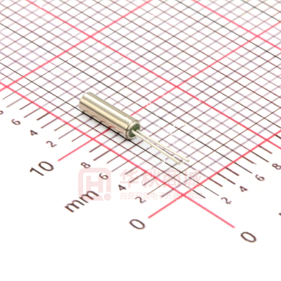

TUNING FORK CRYSTAL UNIT RoHS compliant / Pb free (Cylinder Type) CFS-206・ ・CFS-145 ■ FEATURES ● Frequency range : 32.768kHz ● External dimensions (mm)   CFS-206 Φ : 2.0 x L : 6.2 CFS-145 Φ : 1.5 x L : 5.1 ● Applications   Watch / Clock / Security devices / Consumer products ■ DIMENSION [mm] CFS-206 CFS-145 ■ STANDARD SPECIFICATIONS Item Nominal Frequency Model CFS-206 CFS-145 Conditions f0 32.768kHz Δf/f0 ±5ppm / ±10ppm / ±20ppm at 25℃ CL 6.0pF / 7.0pF / 8.0pF / 12.5pF Please specify your requirement Operating Temperature Range TOPR -20℃ ~ +70℃ Storage Temperature Range TSTR -40℃ ~ +85℃ Turnover Temperature TM 25℃±5℃ Temperature Coefficient β -0.034±0.006ppm/℃2 Motional (series) resistance R1 Level of drive DL 1μW Max. Δf/f0 ±3ppm Max. Frequency Tolerance Load capacitance Aging (first year) Shunt capacitance C0 35KΩ Max. 1.2pF Typ. http://cfd.citizen.co.jp/english/prod-tech/product/cvo_top.html 40KΩ Max. at 25℃ 25℃±3℃ 1.0pF Typ. ■ PART NUMBERING SYSTEM CFS-206 / CFS-145 32768 D Z F B - □□□ Frequency Tolerance (at 25℃) Frequency Frequency Tolerance over Operating Temp. Range Package specification B Please specify the frequency in Hz. D E H ±20ppm (STD) ±10ppm ±5ppm Z CITIZEN management code Only Bulk Standard Spec. Ref. Code for internal use. Load capacitance (CL) B F V Y 6.0pF 12.5pF (STD) 8.0pF 7.0pF *Please contact us for specifications available. ■ Part Marking [standard] CFS-206 CFS-145 22ym ##### 22 : Manufacture's ID Code No marking y : The last digit of production year m : Production month (See Table.1) # : Production Lot No. Table.1 Month Code Jan Feb 1 2 … … Sep Oct Nov Dec 9 X Y Z ■ Handling Notes Mounting Bending Lead Soldering the body of cylinder type crystal unit must be strictly avoided as it may cause significant deterioration in characteristics of the product. Hold the body of crystal unit by hand, and the part to be bent with tweezers leaving more than 1.5mm of lead from the body case. (3.0mm is recommended) Rubber adhesive is recommended for mounting. Bend the lead 90°holding with the tweezers. Pulling the lead strongly may crack the hermetic seal glass at the root of the lead and may cause the airtightness and the characteristics to deteriorate. Product specifications are subject to change without notice. http://cfd.citizen.co.jp/english/prod-tech/product/cvo_top.html Rev.2
CFS-20632768HZFB
- 物料型号:CFS-206和CFS-145。 - 器件简介:晶振单元适用于手表、时钟、安全设备和消费产品。 - 引脚分配:文档中未明确提供引脚分配信息。 - 参数特性: - 频率范围:32.768kHz。 - 外部尺寸:CFS-206直径2.0mm x 长度6.2mm,CFS-145直径1.5mm x 长度5.1mm。 - 频率容差:±5ppm、±10ppm、±20ppm(25°C时)。 - 负载电容:6.0pF、7.0pF、8.0pF、12.5pF(请指定要求)。 - 工作温度范围:-20°C至+70°C。 - 存储温度范围:-40°C至+85°C。 - 翻转温度:25°C±5°C。 - 温度系数:-0.034±0.006ppm/°C²。 - 动态(串联)电阻:CFS-206最大35KΩ,CFS-145最大40KΩ(25°C时)。 - 驱动电平:最大1W。 - 老化(第一年):±3ppm(25°C±3°C)。 - 并联电容:CFS-206典型值1.2pF,CFS-145典型值1.0pF。 - 功能详解:文档中未提供详细的功能解释。 - 应用信息:适用于手表、时钟、安全设备和消费产品。 - 封装信息:圆柱形封装,具体尺寸如上所述。
