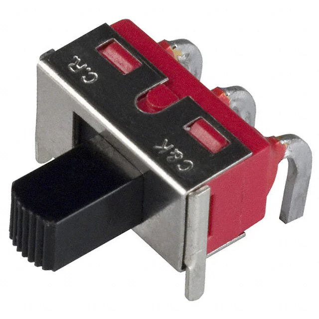

    SWITCH SLIDE MINI SP RT ANG PCB
1101M2S4AKE2 数据手册
1000 Series Miniature Slide Switches Features/Benefits • Variety of actuators and terminations • Panel mount tabs available • Epoxy terminal seal—compatible with bottom-wash cleaning Typical Applications • Test & measurement equipment • Telecommunications • Computer & peripherals • RoHS compliant Models Available Materials CONTACT RATING: B contact material: 0.4 VA max. @ 20 V AC or DC max. Q contact material: 6 AMPS @ 120 V AC or 28 V DC, 3 AMPS @ 250 V AC. See page I-16 for additional ratings. ELECTRICAL LIFE: 100,000 make-and-break cycles at full load on models with B, K or P contact material; 40,000 cycles on models with G, Q, L, M, S or R contact material. CONTACT RESISTANCE: Below 10 m Ω typ. initial @ 2-4 V DC, 100 mA, for both silver and gold plated contacts. INSULATION RESISTANCE: 109 Ω min. DIELECTRIC STRENGTH: 1,000 Vrms min. @ sea level. OPERATING TEMPERATURE: –30ºC to 65ºC SOLDERABILITY: Per MIL-STD-202F method 208D, or EIA RS-186E method 9 (1 hour steam aging). CASE: diallyl phthalate (DAP), (UL 94V-0). ACTUATOR: Nylon, black, standard. HOUSING: Stainless steel. SWITCH SUPPORT: Brass or steel, matte-tin plated. END CONTACTS: B contact material: Copper alloy, with gold plate over nickel plate. Q contact material: Coin silver, silver plated. See page I-16 for additional contact materials. CENTER CONTACT & ALL TERMINALS: B contact material: Copper alloy, with gold plate over nickel plate. Q contact material: Copper alloy, silver plated. See page I-16 for additional contact materials. TERMINAL SEAL: Epoxy. Refer to Soldering and Cleaning in Technical Data chapter NOTE: Any models supplied with Q, B, G, P, S or R contact material are RoHS compliant. NOTE: Specifications and materials listed above are for switches with standard options. For information on specific and custom switches, consult Customer Service Center. Build-A-Switch To order, simply select desired option from each category and place in the appropriate box. Available options are shown and described on pages I–12 through I­–16. For additional options not shown in catalog, consult Customer Service Center. All models have epoxy terminal seal and are compatible with all “bottom-wash” PCB cleaning methods. Switch Function 1101 SP On-None-On 1103 SP On-Off-On 1108 SP Mom-None-On 1201 DP On-None-On 1203 DP On-Off-On Mounting Style M2 PC mount without tabs M1 Panel mount with tabs Actuator S3 .200” high S1 .040” high S2 .140” high S4 .285” high S5 .370” high S6 .485” high T3 .200” high Terminations A Right angle, PC thru-hole C PC Thru-hole AV2 Vertical right angle, PC thru-hole Z Solder lug V3 V-bracket V4 V-bracket W .750” long, wire wrap Z3 Quick connect Contact Material B Gold Q Silver G Gold over silver P Gold, matte-tin S Silver, matte-tin R Gold over silver, matte-tin Seal E Epoxy D No epoxy seal I Epoxy potted base Actuator Color 2 Black 1 White 3 Red Dimensions are shown: Inches (mm) Specifications and dimensions subject to change 19 dec 18 I–11 www.ckswitches.com I Slide Specifications 1000 Series Miniature Slide Switches SWITCH FUNCTION SWITCH FUNCTION POS. 1 POS. 2 POS. 3 NO. POLES SP POS. 1 CONNECTED TERMINALS POS. 2 POS. 3 MODEL NO. SCHEMATIC 1101 ON NONE ON 1103 ON OFF ON 1108 MOM. NONE ON N/A 1-2 OPEN 2-3 SPDT N/A SPDT 0.95 (2,41) Slide I Part number shown: 1101M2S3CQE2 DP 1201 ON NONE ON 1203 ON OFF ON 2-1,5-4 OPEN 2-3,5-6 DPDT DPDT Actuator shown in position 1 Terminal Nos. For Reference Only Part number shown: 1201M2S3CQE2 MOM. = Momentary All models with all options when ordered with G, Q, S or R contact material. MOUNTING STYLE M2  PC MOUNTING WITHOUT TABS M1  PANEL MOUNTING WITH TABS NOTE: Available with C, W, Z, Z3 terminations only. No mounting hardware supplied. NOTE: Available with A, AV2, C, V3, V4, W terminations only. PANEL MOUNTING .275 (6,99) All actuators except T3. Single pole For T3 actuator only. Double pole Dimensions are shown: Inch (mm) Specifications and dimensions subject to change 19 dec 18 I–12 www.ckswitches.com 1000 Series Miniature Slide Switches ACTUATOR COLOR ACTUATOR S3  .200” HIGH ACTUATOR S2  .140” HIGH S1  .040” HIGH S4  .285” HIGH * * * * 110X models only. S5  .370” HIGH 120X models only. S6  .485” HIGH I T3  .200” HIGH * * * 120X models only. ACTUATOR COLOR 2 BLACK 1 WHITE 3 RED 7 BLUE 9 GRAY Other colors available, consult Customer Service Center. * Subtract .014 (0,36) from actuator height, all models with A, AV2 - 2 pole, V3, V4 terminations. TERMINATIONS Z  SOLDER LUG C  PC THRU-HOLE .075 EPOXY SEAL [1,91] .155 [3,92] .080 [2,03] .048 [1,22] DIM "B' .075 [1,91] EPOXY SEAL DIM "A" .188 [4,78] .188 [4,78] OPTION DIM "A" C .050 [0,76] Not available with P, S or R contact materials. SPDT & DPDT PC MOUNTING DIM "B" .250 [ 6,35] SPDT & DPDT Z3  QUICK CONNECT W  WIRE WRAP .750 (19,05) Not available with P, S or R contact materials. Mating quick connector available; order part number 530100000, page I-16­. SPDT & DPDT SPDT & DPDT Dimensions are shown: Inches (mm) Specifications and dimensions subject to change 19 dec 18 I–13 www.ckswitches.com Slide OPTION CODE 1000 Series Miniature Slide Switches TERMINATIONS A  RIGHT ANGLE, PC THRU-HOLE PC MOUNTING 1101M2S3ABE2 Horizontal Actuation SPDT Slide I SECTION A-A Actuator Shown In Pos. 1 Not available with M1 mounting style, I seal option. Terminal bend radii and lead-in manufacturing option. A  RIGHT ANGLE, PC THRU-HOLE PC MOUNTING 1201M2S3ABE2 Horizontal Actuation DPDT SECTION A-A Actuator Shown In Pos. 1 Not available with M1 mounting style, I seal option. Terminal bend radii and lead-in manufacturing option. AV2  VERTICAL RIGHT ANGLE, PC THRU-HOLE, .150” PITCH PC MOUNTING .200 (5,08) 1101M2S3AV2BE2 Vertical Actuation Actuator Shown In Pos. 1 SECTION A-A SPDT Not available with M1 mounting style, I seal option. Terminal bend radii and lead-in manufacturing option. Dimensions are shown: Inch (mm) Specifications and dimensions subject to change 19 dec 18 I–14 www.ckswitches.com 1000 Series Miniature Slide Switches TERMINATIONS AV2  VERTICAL RIGHT ANGLE, PC THRU-HOLE, .150” PITCH PC MOUNTING 1201M2S3AV2BE2 Vertical Actuation SECTION A-A Actuator Shown In Pos. 1 DPDT Slide Not available with M1 mounting style, I seal option. Terminal bend radii and lead-in manufacturing option. V3, V4  VERTICAL MOUNT, V-BRACKET PC MOUNTING OPTION CODE DIM ‘A’ V3 .350 (8,89) V4 .525 (13,34) 1101M2S3__BE2 SPDT Not available with M1 mounting style and I seal. Actuator Shown In Pos. 1 V3, V4  VERTICAL MOUNT, V-BRACKET PC MOUNTING OPTION CODE DIM ‘A’ V3 .400 (10,16) V4 .575 (14,61) I 1201M2S3__BE2 DPDT Actuator Shown In Pos. 1 Not available with M1 mounting style and I seal. Dimensions are shown: Inches (mm) Specifications and dimensions subject to change 19 dec 18 I–15 www.ckswitches.com 1000 Series Miniature Slide Switches CONTACT MATERIAL OPTION CODE CONTACT MATERIAL TERMINAL PLATING B GOLD 3 LOW LEVEL/ MATTE-TIN 6 DRY CIRCUIT GOLD 1 P Q SILVER 4,5 S G Slide I RATINGS SILVER 4 POWER MATTE-TIN 6 6 AMPS @ 120 V AC OR 28 V DC; 3 AMPS @ 250 V AC. GOLD OVER GOLD 3 LOW LEVEL/DRY SILVER 2,3 MATTE-TIN 6 CIRCUIT OR POWER R 0.4 VA MAX. @ 20 V AC OR DC MAX. 0 4 VA MAX @ 20 V AC OR DC MAX OR 6 AMPS @ 120 V AC OR 0.4 MAX. 28 V DC; 3 AMPS @ 250 V AC. * Note: See Technical Data section of this catalog for RoHS compliant and compatible definitions and specifications. 1 CONTACTS & TERMINALS: Copper alloy, with gold plate over nickel plate. 2 END CONTACTS: Coin silver, with gold plate over nickel plate. 3  ENTER CONTACTS & ALL TERMINALS: Copper alloy, with gold plate C over nickel plate. 4 END CONTACTS: Coin silver, silver plated. 5 CENTER CONTACT & ALL TERMINALS: Copper alloy, silver plated. 6 TERMINALS: Copper alloy, with matte-tin over nickel plate. All models contact material. with all options when ordered with G, Q, S or R B contact material standard with all terminations except C, Z, Z3.. Q contact material standard with C, Z, Z3 terminations. P, S or R contact materials not available with Z, Z3 terminations. NOTE: Any models supplied with Q, B, G, P, S or R contact material are RoHS compliant. SEAL E  EPOXY SEAL D  NO EPOXY SEAL I  EPOXY POTTED BASE NOTE: Available with C, W, W3, Z, Z3 terminations only. AVAILABLE HARDWARE Fits Z3 Termination female connector PART NO. 530100000 Available in loose pieces. Dimensions are shown: Inch (mm) Specifications and dimensions subject to change 19 dec 18 I–16 www.ckswitches.com
