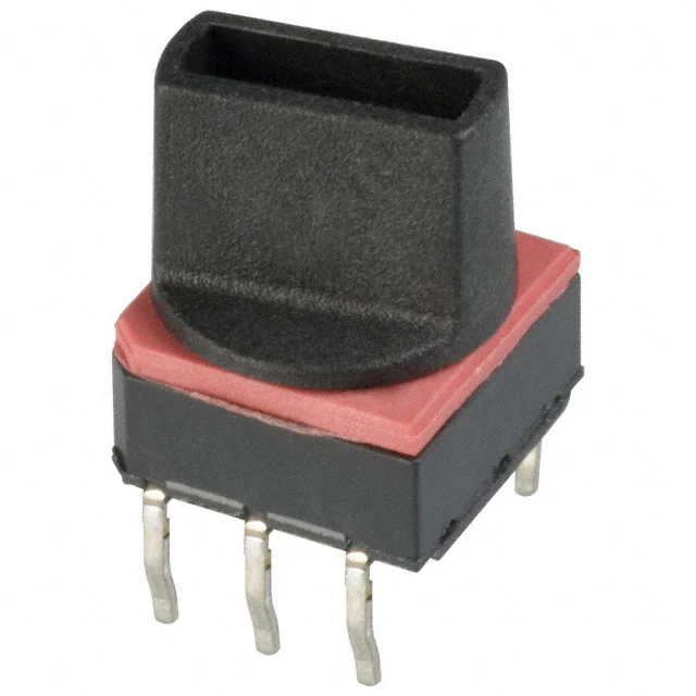

C&K CD Series 8mm DIP Coded Rotary Switches Features/Benefits Typical Applications • Process sealed – withstands soldering and cleaning • Thru-hole and surface mount models • Compact size saves space – 36% smaller than traditional 10mm DIP • Crisp, positive detent ensures actuation DIP H • • • • Address switching applications Data storage devices Computer and peripherals Instrumentation Specifications Materials CONTACT RATING: 0.4 VA max. @ 20 V AC or V DC max. MECHANICAL AND ELECTRICAL LIFE: CD10 & CD16: 20,000 actuations. CD08: 12,000 actuations. COVER & BASE: Glass filled nylon, flame retardant (UL 94V-0). ACTUATOR: LCP (UL 94V-0), internal o-ring seal standard with all actuators. KNOB: Glass filled nylon, flame retardant (UL 94V-0). CONTACT RESISTANCE: 50 milliohms max. initial. INSULATION RESISTANCE: 100 megohms min. @ 250 V AC min. DIELECTRIC STRENGTH: 250 V RMS min. @ sea level. MOVABLE CONTACTS: Copper alloy with gold plate over nickel plate. OPERATING TEMPERATURE: -25°C to 85°C. STORAGE TEMPERATURE: -40°C to 85°C. SOLDERABILITY: Per MIL-STD-202F method 208D or EIA RS186E, method 9 (1 hour steam aging). PACKAGING: Switches supplied in rigid tubes in full-tube quantities only: this may affect order quantity. Surface mount switches available in tape & reel packaging per EIA 481A, 800 per reel, “M0” actuator only. TERMINALS: Copper alloy with tin-lead alloy over nickel plate. All terminals are insert molded. STATIONARY CONTACTS: Copper alloy with gold plate over nickel plate. NOTE: Specifications and materials listed above are for switches with standard options. For information on specific and custom switches, consult Customer Service Center. How To Order Our easy Build-A Switch concept allows you to mix and match options to create the switch you need. Below is a complete listing of options shown in catalog. To order, simply select desired option from each category and place in the appropriate box. . C D K Switch Function CD08R 8 position, BCD Actuator CD08C 8 position, BCD complement M0 (STD.) Flush, screwdriver slot CD10R 10 position, BCD L1 Extended, screwdriver slot CD10C 10 position, BCD complement K1 Knob CD16R 16 position, Hexadecimal Terminations CD16C 16 position, Hexadecimal complement A Right Angle, PC Thru-hole C PC Thru-hole S Surface Mount Contact Material K (STD.) Gold Packaging NONE Tube R Tape & Reel (MO actuator only) Dimensions are shown in inch (mm ) Dimensions subject to change H-22 www.ittcannon.com C&K CD Series 8mm DIP Coded Rotary Switches SWITCHES WITH STANDARD OPTIONS PC Mount 60 1 10 60 16 60 .100 (2,54) 4 4 56 C .100 TYP. (2,54) 8 F01 CD AB E 8 H .100 (2,54) C 2 .200 .315 (5,08) (8,00) .032 TYP. (0,81) .300 (7,62) .025 TYP. (0,64) .315 (8,00) DIP QUANTITY PER TUBE 23 CD08RM0CK CD10RM0CK CD16RM0CK NO. POS. 78 9 PART NUMBER CD16RM0CK .168 (4,27) .025 TYP. (0,64) .125 TYP. (3,18) .010 TYP. (0,25) .305 (7,75) .020 TYP. (0,51) Right Angle Mount PART NUMBER CD08RM0AK CD10RM0AK CD16RM0AK NO. POS. QUANTITY PER TUBE 8 60 10 60 16 60 .050. (1,27) .100 TYP. (2,54) Ø.032 (0,81) TYP. .200 (5,08) .330 (8,36) .025 (0,64) .132 (3,34) .200 (5,08) 901 .183 (4,64) TYP. 1 .100 (2,54) 78 1 456 23 .025 TYP. (0,64) STAND-OFF 8 .010 (0,25) CD10RM0AK .315 (8,00) .099 (2,52) C 4 .200 (5,08) .315 (8,00) .025 (0,64) .020 TYP. (0,51) Surface Mount 8 60 .080 (2,03) 10 60 1 16 60 C 4 Note: For tape and reel packaging, add ‘R’ to end of part number. .100 (2,54) 8 901 78 QUANTITY PER TUBE 23 CD08RM0SK CD10RM0SK CD16RM0SK NO. POS. 456 PART NUMBER C 2 .100 TYP. (2,54) .200 .315 (5,08) (8,00) .050 (1,27) TYP. .315 (8,00) .430 (10,92) .200 (5,08) CD10RM0SK .010 THK. (0,25) .040 TYP. (1,02) .390 (9,90) .174 .006 (4,41) (0,15) .020 TYP. (0,51) Third Angle Projection Dimensions are shown inch (mm) Dimensions subject to change H-23 www.ittcannon.com C&K CD Series 8mm DIP Coded Rotary Switches SWITCH FUNCTION CD08R CD08C 8 POSITION, BCD ACTUATOR COLOR: WHITE 8 POSITION, BCD COMPLEMENT ACTUATOR COLOR: BLACK 10 POSITION, BCD COMPLEMENT ACTUATOR COLOR: BLACK PIN 1 INDICATOR POS. 0 1 2 3 4 5 6 7 8 9 4 4 8 8 901 78 2 CD16C 16 POSITION, HEXADECIMAL ACTUATOR COLOR: WHITE 16 POSITION, HEXADECIMAL COMPLEMENT ACTUATOR COLOR: BLACK PIN 1 INDICATOR POS. 0 1 2 3 4 5 6 7 8 9 A B C D E F 4 8 8 CD AB E 2 4 CD 2 F01 4 56 1 23 C 1 C&K C XXXX POS. 0 1 2 3 4 5 6 7 8 9 A B C D E F CD 1 2 23 C 1 C&K C XXXX POS. 0 1 2 3 4 5 6 7 8 9 CD16R 6 7 CD10C 10 POSITION, BCD ACTUATOR COLOR: WHITE 5 8 XXXX 4 8 78 9 4 0 456 2 CD 1 2 2 3 C 1 1 C CD10R PIN 1 INDICATOR POS. 0 1 2 3 4 5 6 7 4 POS. 0 1 2 3 4 5 6 7 C&K ACTUATOR M0 (STD.) FLUSH WITH SCREWDRIVER SLOT L1 K1 EXTENDED WITH SCREWDRIVER SLOT KNOB .060 (1,52) .100 (2,54) 9 01 78 2 3 78 0 2 3 9 01 456 456 DIP H .025 TYP. (0,64) FLUSH ACTUATOR .080 (2,03) .120 DIA. (3,05) .036 (0,91) .126 (3,20) .151 (3,84) .130 (3,30) .300 (7,62) DIA. .040 (1,02) .220 (5,59) NOTE: Designed for #0 Phillips screwdriver. Dimensions are shown in inch (mm ) Dimensions subject to change H-24 www.ittcannon.com C&K CD Series 8mm DIP Coded Rotary Switches TERMINATIONS A PC THRU-HOLE 2 .330 (8,36) 23 78 9 S .305 (7,75) 8 .010 (0,25) .020 TYP. (0,51) 1 .200 (5,08) .025 (0,64) .132 (3,34) .183 (4,64) TYP. 1 .100 (2,54) 456 .025 TYP. (0,64) .315 (8,00) .099 (2,52) .025 TYP. (0,64) STAND-OFF .168 (4,27) .125 TYP. (3,18) .010 TYP. (0,25) H .200 (5,08) .032 TYP. (0,81) .300 (7,62) .025 TYP. (0,64) .315 (8,00) Ø.032 (0,81) TYP. .200 .315 (5,08) (8,00) 901 CD AB E C 4 56 4 8 F01 23 .100 (2,54) .100 TYP. (2,54) DIP 1 .050. (1,27) .100 TYP. (2,54) .100 (2,54) C RIGHT ANGLE, PC THRU-HOLE 78 C C 4 .200 (5,08) .315 (8,00) .025 (0,64) .020 TYP. (0,51) SURFACE MOUNT .080 (2,03) 4 .100 (2,54) 78 23 C .100 TYP. (2,54) 8 901 456 1 C 2 .200 .315 (5,08) (8,00) .050 (1,27) TYP. .315 (8,00) .200 (5,08) .430 (10,92) .010 THK. (0,25) .040 TYP. (1,02) .390 (9,90) .174 .006 (4,41) (0,15) .020 TYP. (0,51) CONTACT MATERIAL OPTION CODE K CONTACT MATERIAL TERMINAL PLATING GOLD TIN-LEAD (STD.) RATING LOW LEVEL/DRY CIRCUIT 0.4 VC MAX. @ 20 V AC or DC MAX. TAPE & REEL For part number CDxxMOSK Reel Information Outside diameter Pilot hole 13.00 (333,0) .512 (13,0) Third Angle Projection Dimensions are shown inch (mm) Dimensions subject to change H-25 www.ittcannon.com
