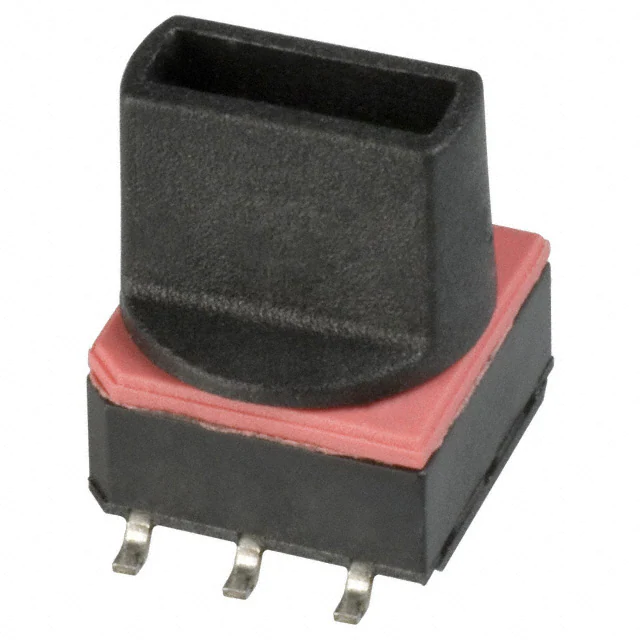

CD Series 8mm DIP Coded Rotary Switches Features/Benefits • Process sealed – withstands DIP H • • • • soldering and cleaning Thru-hole and surface mount models Compact size saves space – 36% smaller than traditional 10mm DIP Crisp, positive detent ensures actuation RoHS compliant Typical Applications • Address switching applications • Data storage devices • Computer and peripherals • Instrumentation Specifications Materials CONTACT RATING: 0.4 VA max. @ 20 V AC or V DC max. MECHANICAL AND ELECTRICAL LIFE: CD10 & CD16: 20,000 actuations. CD08: 12,000 actuations. CONTACT RESISTANCE: 50 milliohms max. initial. INSULATION RESISTANCE: 100 megohms min. @ 250 V AC min. DIELECTRIC STRENGTH: 250 V RMS min. @ sea level. OPERATING TEMPERATURE: -25°C to 85°C. COVER: PPS (UL94V-0), Color; Black. BASE: PPS (UL94V-0), Color; Black ACTUATOR: LCP (UL 94V-0), Color White (CDXXR) Color Black (CDXXC) Note: internal o-ring seal standard with all actuators. KNOB: Glass filled nylon, flame retardant (UL 94V-0). MOVABLE CONTACTS: Copper alloy with gold plate over nickel plate. STATIONARY CONTACTS: Copper alloy with gold plate over nickel plate. TERMINALS: Copper alloy with gold plate over nickel plate. STORAGE TEMPERATURE: -40°C to 85°C. SOLDERABILITY: Per MIL-STD-202F method 208D or EIA RS186E, method 9 (1 hour steam aging). PACKAGING: Switches supplied in rigid tubes in full-tube quantities only: this may affect order quantity. Tube quantity is 60 pieces per tube. Surface mount switches available in tape & reel packaging per EIA 481A, 800 per reel, “M0” actuator only. Note: Specifications and materials listed above are for switches with standard options. For information on specific and custom switches, consult Customer Service Center. How To Order Our easy Build-A Switch concept allows you to mix and match options to create the switch you need. Below is a complete listing of options shown in catalog. To order, simply select desired option from each category and place in the appropriate box. C D Switch Function CD08R 8 position, BCD Actuator CD08C 8 position, BCD complement M0 Flush, screwdriver slot CD10R 10 position, BCD L1 Extended, screwdriver slot CD10C 10 position, BCD complement K1 Knob CD16R 16 position, Hexadecimal Terminations CD16C 16 position, Hexadecimal complement A Right Angle, PC Thru-hole C PC Thru-hole S Surface Mount Contact/Terminal Material B Gold/Gold Packaging NONE Tube R Tape & Reel (MO actuator only) Dimensions are shown: Inch (mm) Specifications and dimensions subject to change H–28 www.ck-components.com CD Series 8mm DIP Coded Rotary Switches SWITCHES WITH STANDARD OPTIONS PC Mount PART NUMBER .100 (2,54) CD AB E 78 9 CD16RM0CB 4 56 4 23 .100 (2,54) 8 F01 .315 (8,0) C 2 .200 .315 (5,08) (8,0) 1 8 C C 4 2 .300 (7,62) .025 (0,6) CD08RM0CB CD10RM0CB CD16RM0CB QUANTITY PER TUBE 8 60 10 60 16 60 NO. POS. QUANTITY PER TUBE .032 TYP. (0.81) .168 (4,27) .125 TYP (3,18) .025 TYP (0,6) .305 (7,75) .020 TYP (0,51) .010 TYP (0,25) Right Angle Mount 1 8 PART NUMBER C C Ø.032 (0,81) TYP. CD08RM0AB CD10RM0AB CD16RM0AB 4 2 .200 (5,08) .330 (8,36) 1 .010 (0,25) .025 (0,6) .132 (3,3) .200 (5,08) 901 .183 (4,64) TYP. 1 .100 (2,54) 456 23 .025 TYP. (0,64) STAND-OFF 8 C 4 .200 (5,08) .080 (2,03) 78 456 4 .100 (2,54) 901 C 2 .200 .315 (5,08) (8,00) .050 (1,27) TYP. .315 (8,00) 60 NO. POS. QUANTITY PER TUBE .020 TYP. (0,51) .100 TYP. (2,54) 8 23 C 60 16 .025 (0,6) PART NUMBER CD10RM0SB 60 .315 (8,00) Surface Mount 1 8 10 .315 (8,0) .099 (2,52) 78 CD10RM0AB .050. (1,27) .100 TYP. (2,54) 1 8 C C 4 2 .430 (10,92) CD08RM0SB CD10RM0SB CD16RM0SB 8 60 10 60 16 60 Note: For tape and reel packaging, add ‘R’ to end of part number. .200 (5,08) .010 THK. (0,25) .040 TYP. (1,02) .390 (9,90) .168 .006 (4,27) (0,15) .020 TYP. (0,51) Dimensions are shown: Inch (mm) Specifications and dimensions subject to change H–29 www.ck-components.com H DIP 1 C .100 TYP. (2,54) NO. POS. CD Series 8mm DIP Coded Rotary Switches SWITCH FUNCTION CD08R CD08C 8 POSITION, BCD ACTUATOR COLOR: WHITE 8 POSITION, BCD COMPLEMENT ACTUATOR COLOR: BLACK 8 Switches ship and to be solder processed in position “0” Switches ship and to be solder processed in position “7” CD10C 10 POSITION, BCD COMPLEMENT ACTUATOR COLOR: BLACK PIN 1 INDICATOR POS. 0 1 2 3 4 5 6 7 8 9 4 8 8 78 2 4 XX 2 901 CD 1 23 C 1 C&K C 456 10 POSITION, BCD ACTUATOR COLOR: WHITE POS. 0 1 2 3 4 5 6 7 8 9 Switches ship and to be solder processed in position “7” CD16C 16 POSITION, HEXADECIMAL ACTUATOR COLOR: WHITE POS. 0 1 2 3 4 5 6 7 8 9 A B C D E F 16 POSITION, HEXADECIMAL COMPLEMENT ACTUATOR COLOR: BLACK PIN 1 INDICATOR POS. 0 1 2 3 4 5 6 7 8 9 A B C D E F 4 8 CD AB E 2 4 XX 2 F01 CD 1 4 56 1 23 C C&K C 78 9 Switches ship and to be solder processed in position “0” CD16R 6 7 4 8 5 2 4 XX 2 0 CD 1 2 3 C 1 1 C CD10R PIN 1 INDICATOR POS. 0 1 2 3 4 5 6 7 4 POS. 0 1 2 3 4 5 6 7 C&K 8 Switches ship and to be solder processed in position “F” Switches ship and to be solder processed in position “0” ACTUATOR M0 (STD.) FLUSH WITH SCREWDRIVER SLOT L1 K1 EXTENDED WITH SCREWDRIVER SLOT KNOB .060 (1,52) .100 (2,54) 9 01 78 2 3 78 0 2 3 9 01 456 456 DIP H .025 TYP. (0,64) FLUSH ACTUATOR .080 (2,03) .120 DIA. (3,05) .036 (0,91) .126 (3,2) .151 (3,84) .130 (3,3) .300 (7,62) DIA. .040 (1,02) .220 (5,59) NOTE: Designed for #0 Phillips screwdriver. Dimensions are shown: Inch (mm) Specifications and dimensions subject to change H–30 www.ck-components.com CD Series 8mm DIP Coded Rotary Switches TERMINATIONS .100 (2,54) 1 8 1 C C C 4 2 .200 .315 (5,08) (8,0) 2 8 1 8 Ø.032 (0,81) TYP. .032 TYP. (0.81) .300 (7,62) .025 (0,6) 78 9 .315 (8,0) .100 TYP. (2,54) 4 2 .200 (5,08) .330 (8,36) .305 (7,75) .010 TYP (0,25) .020 TYP (0,51) 8 78 901 456 4 .100 (2,54) C 2 .200 .315 (5,08) (8,00) .050 (1,27) TYP. .315 (8,00) .025 (0,6) .132 (3,3) 1 .100 (2,54) C .315 (8,00) 4 .200 (5,08) .025 (0,6) .020 TYP. (0,51) .100 TYP. (2,54) 8 23 C .080 (2,03) .183 (4,64) TYP. 1 .010 (0,25) SURFACE MOUNT 1 23 .025 TYP. (0,64) STAND-OFF .200 (5,08) S .315 (8,0) .099 (2,52) 456 .125 TYP (3,18) H C C .168 (4,27) .025 TYP (0,6) .050. (1,27) .100 TYP. (2,54) DIP 4 56 4 23 C .100 (2,54) CD AB E F01 RIGHT ANGLE, PC THRU-HOLE 901 A PC, THRU-HOLE 78 C 1 8 C C 4 2 .200 (5,08) .430 (10,92) .010 THK. (0,25) .040 TYP. (1,02) .168 .006 (4,27) (0,15) .390 (9,90) .020 TYP. (0,51) CONTACT MATERIAL OPTION CODE RoHS COMPLIANT * RoHS COMPATIBLE * B YES YES CONTACT MATERIAL GOLD TERMINAL PLATING RATING GOLD LOW LEVEL/DRY CIRCUIT 0.4 VC MAX. @ 20 V AC or DC MAX. * Note: See Technical Data section of this catalog for RoHS compliant and compatible definitions and specifications. TAPE & REEL For part number CDxxM0SB .157 (4,0) FEED DIRECTION .630 (16,0) .079 (2,0) .059 DIA (1,5Ø) .069 (1,8) .194 (4,9) Reel Information .945 (24,0) .335 (8,5) Outside diameter Pilot hole 13.00 (333,0) .512 (13,0) .403 (10,2) Dimensions are shown: Inch (mm) Specifications and dimensions subject to change H–31 www.ck-components.com
