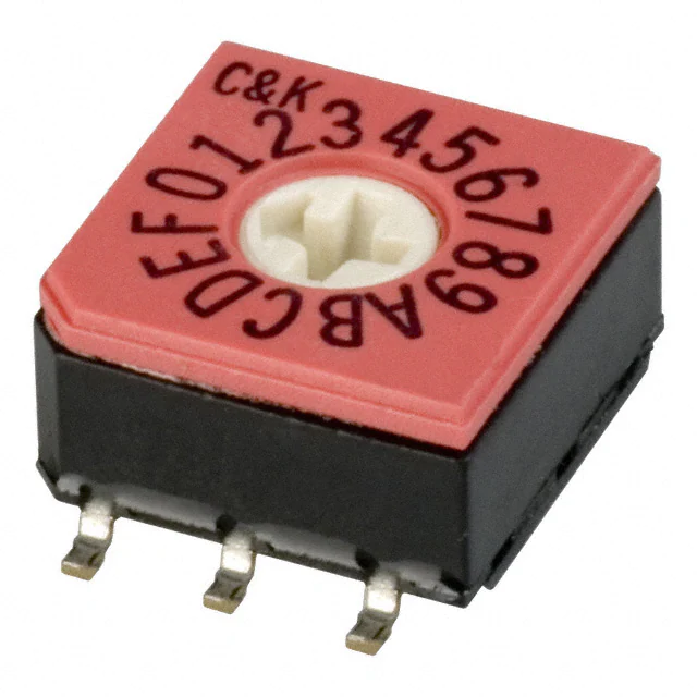

CD16RM0SBR 数据手册
CD Series 8mm DIP Coded Rotary Switches Features/Benefits •  Process sealed – withstands soldering and cleaning •  Thru-hole and surface mount models •  Compact size saves space – 36% H DIP smaller than traditional 10mm DIP •  Crisp, positive detent ensures actuation •  RoHS compliant •  IP65 Typical Applications •  Address switching applications •  Data storage devices •  Computer and peripherals •  Instrumentation Specifications Materials CONTACT RATING: 0.4 VA max. @ 20 V AC or V DC max. MECHANICAL AND ELECTRICAL LIFE: CD10 & CD16: 20,000 actuations. CD08: 12,000 actuations. CONTACT RESISTANCE: 50 milliohms max. initial. INSULATION RESISTANCE: 100 megohms min. @ 250 V AC min. DIELECTRIC STRENGTH: 250 V RMS min. @ sea level. OPERATING TEMPERATURE: -25°C to 85°C. STORAGE TEMPERATURE: -40°C to 85°C. SOLDERABILITY: Per MIL-STD-202F method 208D or EIA RS-186E, method 9 (1 hour steam aging). PACKAGING: Switches supplied in rigid tubes in full-tube quantities only: this may affect order quantity. Tube quantity is 60 pieces per tube. Surface mount switches available in tape & reel packaging per EIA 481A, 800 per reel, surface mount with “M0” actuator only. COVER: PPS (UL94V-0), Color; Black. BASE: PPS (UL94V-0), Color; Black ACTUATOR: LCP (UL 94V-0), Color White (CDXXR) Color Black (CDXXC) Note: internal o-ring seal standard with all actuators. MOVABLE CONTACTS: Copper alloy with gold plate over nickel plate. STATIONARY CONTACTS: Copper alloy with gold plate over nickel plate. TERMINALS: Copper alloy with gold plate over nickel plate. Note: Specifications and materials listed above are for switches with standard options. For information on specific and custom switches, consult Customer Service Center. How To Order The Build-A Switch concept allows you to mix and match options to create the switch you need. Below is a complete listing of options shown in catalog. To order, simply select desired option from each category and place in the appropriate box. C D Switch Function CD08R 8 position, BCD Actuator CD10R 10 position, BCD M0 Flush, screwdriver slot CD10C 10 position, BCD complement CD16R 16 position, Hexadecimal CD16C 16 position, Hexadecimal complement Terminations A Right Angle, PC Thru-hole C PC Thru-hole S Gull wing Contact/Terminal Material B Gold/Gold Packaging NONE Tube R Tape & Reel (SMT, M0 actuator only) Dimensions are shown: Inch (mm) Specifications and dimensions subject to change 12 Nov 20 H–37 www.ckswitches.com CD Series 8mm DIP Coded Rotary Switches SWITCHES WITH STANDARD OPTIONS PC Mount H PART NUMBER .100 (2,54) CD AB E 4 78 9 .100 (2,54) CD16RM0CB 4 56 C 8 F01 23 DIP 1 C 2 .200 .315 (5,08) (8,0) 8 C C 4 2 .100 TYP. (2,54) .032 TYP. (0.81) .300 (7,62) .025 (0,6) .315 (8,0) 1 NO. QUANTITY POS. PER TUBE CD08RM0CB 8 CD10RM0CB 10 CD10CM0CB 10 CD16RM0CB 16 CD16CM0CB 16 60 60 60 60 60 .168 (4,27) .305 (7,75) .025 TYP (0,6) .125 TYP (3,18) .300 (7,62) .010 TYP (0,25) .020 TYP (0,51) Right Angle Mount .050. (1,27) .100 TYP. (2,54) 1 8 PART NUMBER C C Ø.032 (0,81) TYP. CD08RM0AB 8 CD10RM0AB 10 CD10CM0AB 10 CD16RM0AB 16 CD16CM0AB 16 4 2 .200 (5,08) .330 (8,36) .315 (8,0) .099 (2,52) 8 1 .010 (0,25) .025 (0,6) .138 (3,51) .200 (5,08) 901 .183 (4,64) TYP. 1 456 23 .025 TYP. (0,64) STAND-OFF 78 CD10RM0AB C .100 (2,54) 4 .100 (2,54) 4 78 456 C 23 CD10RM0SB C 2 .200 .315 (5,08) (8,00) .050 (1,27) TYP. .315 (8,00) 60 60 60 .020 TYP. (0,51) .200 (5,08) .080 (2,03) 8 60 .025 (0,6) PART NUMBER 901 60 .315 (8,00) Surface Mount 1 NO. QUANTITY POS. PER TUBE 1 8 C C 4 2 .430 (10,92) .100 TYP. (2,54) NO. QUANTITY POS. PER TUBE CD08RM0SB 8 CD10RM0SB 10 CD10CM0SB 10 CD16RM0SB 16 CD16CM0SB 16 60 60 60 60 60 .200 (5,08) Note: For tape and reel packaging, add ‘R’ to end of part number. .010 THK. (0,25) .040 TYP. (1,02) .390 (9,90) .168 .006 (4,27) (0,15) .020 TYP. (0,51) Dimensions are shown: Inch (mm) Specifications and dimensions subject to change 12 Nov 20 H–38 www.ckswitches.com CD Series 8mm DIP Coded Rotary Switches SWITCH FUNCTION CD08R 8 POSITION, BCD ACTUATOR COLOR: WHITE H C&K C 0 5 XX 4 8 CD 4 2 3 2 1 6 7 1 DIP PIN 1 INDICATOR POS. 0 1 2 3 4 5 6 7 Switches ship and to be solder processed in position “0” 8 POS. 0 1 2 3 4 5 6 7 8 9 A B C D E F Switches ship and to be solder processed in position “7” CD16C 16 POSITION, HEXADECIMAL COMPLEMENT ACTUATOR COLOR: BLACK POS. 0 1 2 3 4 5 6 7 8 9 A B C D E F 2 4 4 CD 2 F01 4 56 1 23 C 1 C&K C PIN 1 INDICATOR CD AB E 16 POSITION, HEXADECIMAL ACTUATOR COLOR: WHITE 78 4 8 XX 2 4 CD 2 901 23 1 C&K C 1 CD16R PIN 1 INDICATOR POS. 0 1 2 3 4 5 6 7 8 9 C Switches ship and to be solder processed in position “0” 10 POSITION, BCD COMPLEMENT ACTUATOR COLOR: BLACK XX POS. 0 1 2 3 4 5 6 7 8 9 CD10C 78 9 10 POSITION, BCD ACTUATOR COLOR: WHITE 456 CD10R 8 8 Switches ship and to be solder processed in position “0” Switches ship and to be solder processed in position “F” ACTUATOR M0 (STD.) FLUSH WITH SCREWDRIVER SLOT .100 (2,54) 2 3 78 9 01 456 .025 TYP. (0,64) FLUSH ACTUATOR NOTE: Designed for #0 Phillips screwdriver. Dimensions are shown: Inch (mm) Specifications and dimensions subject to change 12 Nov 20 H–39 www.ckswitches.com CD Series 8mm DIP Coded Rotary Switches TERMINATIONS .100 (2,54) H 1 CD AB E 78 9 DIP 4 56 4 23 .100 (2,54) 8 F01 C C 2 .200 .315 (5,08) (8,0) 8 C .100 TYP. (2,54) 4 2 .300 (7,62) .025 (0,6) .315 (8,0) 1 C RIGHT ANGLE, PC THRU-HOLE 1 8 Ø.032 (0,81) TYP. .032 TYP. (0.81) C C 4 2 .200 (5,08) .330 (8,36) .025 TYP (0,6) S .125 TYP (3,18) .300 (7,62) .010 TYP (0,25) .020 TYP (0,51) SURFACE MOUNT 8 .010 (0,25) 78 456 .100 (2,54) 23 C 4 .080 (2,03) 8 901 C 2 .200 .315 (5,08) (8,00) .050 (1,27) TYP. .315 (8,00) 23 .025 TYP. (0,64) STAND-OFF 1 8 C C 4 2 .183 (4,64) TYP. 1 .200 (5,08) 1 .315 (8,0) .099 (2,52) .025 (0,6) .138 (3,51) 1 .100 (2,54) 456 .168 (4,27) .305 (7,75) .050. (1,27) .100 TYP. (2,54) 901 A PC, THRU-HOLE 78 C C 4 .200 (5,08) .315 (8,00) .025 (0,6) .020 TYP. (0,51) .100 TYP. (2,54) .200 (5,08) .430 (10,92) .010 THK. (0,25) .040 TYP. (1,02) .168 .006 (4,27) (0,15) .390 (9,90) .020 TYP. (0,51) CONTACT MATERIAL OPTION CODE RoHS COMPLIANT * RoHS COMPATIBLE * B YES YES CONTACT MATERIAL GOLD TERMINAL PLATING RATING GOLD LOW LEVEL/DRY CIRCUIT 0.4 VC MAX. @ 20 V AC or DC MAX. * Note: See Technical Data section of this catalog for RoHS compliant and compatible definitions and specifications. TAPE & REEL For part number CDxxM0SB .157 (4,0) FEED DIRECTION .630 (16,0) .079 (2,0) .059 DIA (1,5Ø) .069 (1,8) .194 (4,9) Reel Information .945 (24,0) .335 (8,5) Outside diameter 13.00 (333,0) Pilot hole .512 (13,0) .403 (10,2) Dimensions are shown: Inch (mm) Specifications and dimensions subject to change 12 Nov 20 H–40 www.ckswitches.com
CD16RM0SBR
物料型号: - CD08RMOCB:8位,BCD编码,白色 - CD10RMOCB:10位,BCD编码,白色 - CD10CMOCB:10位,BCD补码,黑色 - CD16RMOCB:16位,十六进制编码,白色 - CD16CMOCB:16位,十六进制补码,黑色
器件简介: CD系列是8mm的DIP编码旋转开关,具有以下特点: - 过程密封,可承受焊接和清洗 - 通孔和表面贴装型号 - 紧凑尺寸,比传统的10mm DIP小36% - 清晰、积极的触点确保动作 - 符合RoHS标准 - IP65防护等级
引脚分配: - 根据型号不同,引脚分配也不同,例如CD08R有8个位置,CD10R和CD10C有10个位置,CD16R和CD16C有16个位置。
参数特性: - 接触额定值:最大0.4 VA @ 20 V AC或最大V DC - 机械和电气寿命:CD10 & CD16:20,000次动作,CD08:12,000次动作 - 接触电阻:最大50毫欧姆 - 绝缘电阻:最小100兆欧姆 @ 250 V AC最小 - 工作温度:-25°C至85°C - 存储温度:-40°C至85°C
功能详解: - 用于地址切换应用、数据存储设备、计算机和外围设备、仪器仪表等。
应用信息: - 适用于地址切换、数据存储设备、计算机及其外围设备、仪表等。
封装信息: - 开关以硬管形式供应,每管60件。 - 表面贴装开关可按EIA 481A标准以胶带和卷轴包装,每卷800件,仅限M0型执行器。
订购信息: - 采用构建开关概念,允许混合和匹配选项以创建所需的开关。 - 提供了完整的选项列表,包括开关功能、执行器类型、接触/端子材料和包装选项。
