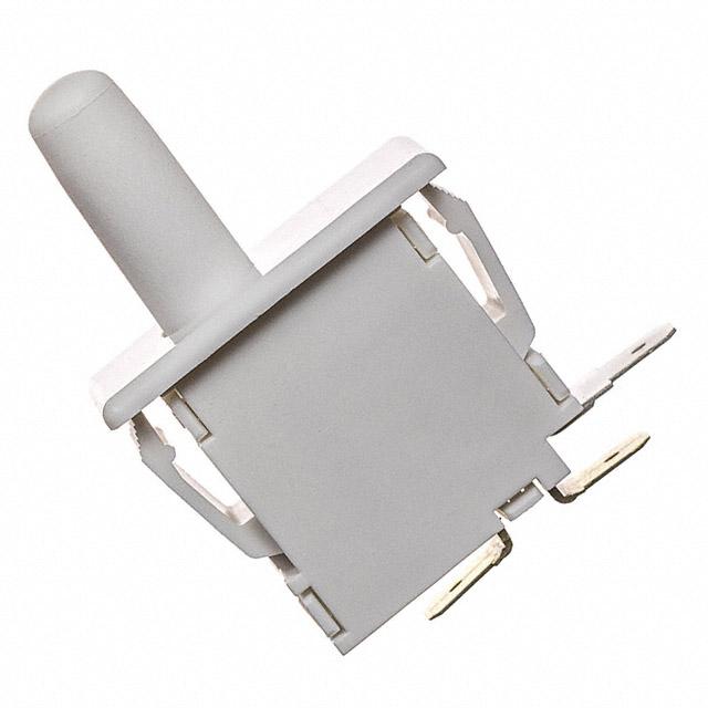

    SWITCH SNAP ACT SPDT 100MA 125V
DS1F5BQ2 数据手册
DS Series Interlock Pushbutton Switches Features/Benefits •  Snap-in mounting • Reliable snap action mechanism •  Latch or momentary •  RoHS compliant •  Halogen free material Typical Applications •  Interlock switch •  Detection switch •  Circuit interrupt UL61058-1 Materials Specifications FUNCTION: Single pole double throw / Double pole double throw HOUSING, COVER, ACTUATOR, KNOB: PA 66/6 halogen free, UL94V-0 MOUNTING TYPE: Snap in style NO & NC FIXED TERMINALS: Copper alloy COMMON TERMINALS: Copper alloy, silver plate Electrical CONTACTS: Silver alloy / F5 rating gold plated over silver alloy ELECTRICAL LIFE: see ratings chart below RETURN SPRINGS: Stainless steel DIELECTRIC STRENGTH: 1500 V (50-60 Hz @ sea level) INSULATION RESISTANCE: 100 M Ω min. INITIAL CONTACT RESISTANCE: 30 milli-ohms Operating Environment J OPERATING TEMPERATURE: -40˚C to +85˚C Build-A-Switch To order, simply select desired option from each category and place in the appropriate box. D S Designation DS DS Series Housing Color NONE White B Black Number of Poles 1 SPDT 2 DPDT Rating F5 F7 D6 D7* Terminals Q1 4.8 x 0.5 Q2 4.8 x 0.8 Q3 6.3 x 0.8 0.1 (0.5)A @ 125/250 V AC 50/60 Hz 50E3 0.1A G.P. @ 125/250 V AC 50/60 Hz 50E3 0.1 (0.5)A @ 125/250 V AC 50/60 Hz 10E4 0.1A G.P. @ 125/250 V AC 50/60 Hz 10E4 10 (4)A @125/250 V AC 50/60 Hz 50E3 10A G.P. @ 125 / 250 V AC 1/3HP @ 125/250 V AC 50/60 Hz 10E3 16A G.P. @125/250 V AC 3/4HP 125/250 V AC 50/60 Hz 10E3 16 (6) A @125/250 V AC 50/60 Hz 10E3 * Note - 16A version has Q3 terminals only Actuator Style A Momentary, Short button B Momentary, Long button C Momentary/Pulled out button (not available on D7 rating) International Rating Symbols 10E3 Cycles 10,000 10E4 Cycles 100,000 50E3 Cycles 50,000 Current rating: First number represents resistive rating. Second number represents inductive (motor) rating General purpose rating UL1054 10(4) GP Dimensions are shown: mm Specifications and dimensions subject to change 31 oct 16 J–85 www.ckswitches.com Snap-acting NOTE: Specifications and materials listed above are for switches with standard options. For information on specific and custom switches, please contact Customer Service. DS Series Interlock Pushbutton Switches NUMBER OF POLES 1 SPDT 31.75 NC COM NO SCHEMATIC 17.3 R1.5 DIM "A" 8.6 11.7 DIM "B" R1.27 MAX 1 2 3 4 5 PANEL MOUNTING PANEL THICKNESS 9.55 DIM "A" mm DIM "B" mm 28.32 13.97 2.54 28.58 13.97 MAX TRAVEL (PULL) 1.14 13.3 3.67 2X 80° 2.38 REF FREE POSITION ON AT REST NC N0 COM J OPERATING POSITION (PULL) 24.6 PUSH OVER TRAVEL MAX 15.54 OPERATING POSITION (PUSH) R1.5 21.35 Snap-acting 2 9.5 4.15 22.05 25.65 DPDT 39.9 NC2 NC1 NO2 NO1 COM1 COM2 17.3 SCHEMATIC DIM "A" 4X R1.5 DIM "B" 1 2 3 4 5 4X R1.27 PANEL MOUNTING MAX TRAVEL (PULL) FREE POSITION ON AT REST PUSH OVER TRAVEL MAX COM1 OPERATING POSITION (PULL) 0.8 TYP NC1 N0 1 N0 2 24.6 COM2 21.2 OPERATING POSITION (PUSH) PANEL THICKNESS NC2 2 DIM "A" mm DIM "B" mm 1.14 36.70 13.97 2.54 36.96 13.97 13.3 9.5 12.15 2X 4.95 26.4 35 MAX 39.8 31 oct 16 Dimensions are shown: mm Specifications and dimensions subject to change J–86 www.ckswitches.com DS Series Interlock Pushbutton Switches ACTUATOR STYLE / SPECIFICATIONS A B SHORT BUTTON C LONG BUTTON AT REST POSITION AT REST POSITION PULLED OUT AT REST POSITION LONG BUTTON SHORT BUTTON MOMENTARY/PULLED OUT PULLED OUT POSITION FREE POSITION SPDT Specification BUTTON STYLE A B OVER TRAVEL OVER TRAVEL OPERATING POSITION POSITION POSITION PUSH PUSH MAX PULL MAX 3.20 8.90 ± 1.25 NA 10.15 19.55 ± 1.25 NA OPERATING POSITION PULL FREE POSITION AT REST OPERATING FORCE NA NA 11.45 ± 0.75 22.25 ± 0.75 425 gf 425 gf 16.75 ± 1.25 21.60 ± 1.25 19.30 ± 0.75 385gf 475gf OVER TRAVEL OVER TRAVEL OPERATING POSITION POSITION POSITION PUSH PUSH MAX PULL MAX 3.20 8.90 ± 1.25 NA 10.15 19.55 ± 1.25 NA OPERATING POSITION PULL FREE POSITION AT REST OPERATING FORCE NA NA 11.45 ± 0.75 22.25 ± 0.75 680 gf 680gf 16.75 ± 1.25 21.60 ± 1.25 19.30 ± 0.75 J 13.20 24.90 Snap-acting PUSH PULL C DPDT Specification BUTTON STYLE A B PUSH PULL C 13.20 24.90 560gf 750gf TERMINALS Q1 Q2 Q3 4.8 x 0.5 6.3 x 0.8 4.8 x 0.8 4.8 Q1-0.5 THK Q2-0.8 THK 6.3 Q3-0.8 Third Angle Projection Dimensions are shown: mm Specifications and dimensions subject to change 31 oct 16 J–87 www.ckswitches.com
