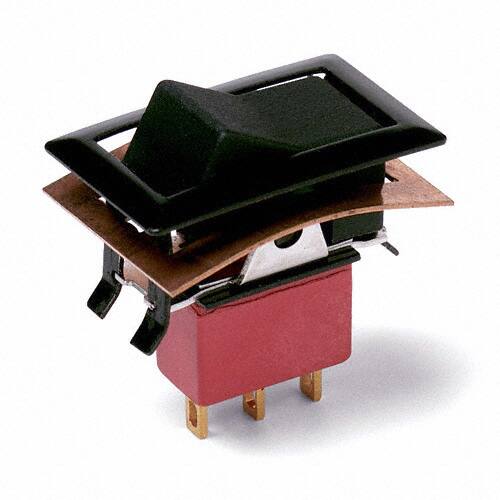

E Series Sealed Miniature Rocker and Lever Handle Switches Features/Benefits • Sealed against solder and cleaning process contaminants • ESD Resistance—all actuator options • Rocker, case & bushing UL 94V-0 • RoHS compliant Typical Applications • Telecommunications • Instrumentation • Computers & peripherals Specifications Materials CONTACT RATING: B contact material: 0.4 VA max. @ 20 V AC or DC max. Q contact material (E1XX & E2XX Models): 7.5 AMPS @125 V AC or 28 V DC; 3 AMPS @ 250 V AC. (E3XX Models): 5 AMPS @ 125 V AC or 28 V DC; 2 AMPS @ 250 V AC. See page G-36 for additional ratings. CASE & BUSHING: Glass filled nylon 6/6, flame retardant, heat stabilized (UL 94V-0). ACTUATOR: Nylon, black standard, internal o-ring seal standard with all actuators. FRAME: Spring steel, black standard. SWITCH SUPPORT: Brass or steel, matte-tin plated. ACTUATOR PIVOT & MOUNTING BRACKET: Nylon. ACTUATOR PIVOT RETAINER: Stainless steel. CONTACTS & TERMINALS: B contact material: Copper alloy, with gold plate over nickel plate. Q contact material: Copper alloy, silver plated. See page G-36 for additional contact materials. TERMINAL SEAL: Epoxy. HARDWARE: Nut, Screw & Lockwasher: Stainless steel. Standoff: Nylon standard, aluminum available, consult Customer Service Center. ELECTRICAL LIFE: E1XX and E2XX models: 40,000 make-and-break cycles at full load. E3XX models: 30,000 cycles. CONTACT RESISTANCE: Below 10 m Ω typ. initial @ 2-4 V DC, 100 mA, for both silver and gold plated contacts. INSULATION RESISTANCE: 109 Ω min. ELECTROSTATIC DISCHARGE (ESD) OPTION: All actuator options: 15,000 V DC max. @ sea level, actuator to terminals. DIELECTRIC STRENGTH: 1000 Vrms min. @ sea level. OPERATING TEMPERATURE: –30ºC to 85ºC. SOLDERABILITY: Per MIL-STD-202F method 208D, or EIA RS-186E method 9 (1 hour steam aging). NOTE: Any models supplied with Q, B, G, S, P & R contact material are RoHS compliant. NOTE: Specifications and materials listed above are for switches with standard options. For information on specific and custom switches, consult Customer Service Center. Build-A-Switch Rocker To order, simply select desired option from each category and place in the appropriate box. Available options are shown and described on pages G-26 through G-38. For additional options not shown in catalog, consult Customer Service Center. All models are process sealed to withstand machine soldering temperatures and pressure wash cleaning methods. Switch Function E101 SP On-None-On E103 SP On-Off-On E105 SP Mom.-Off-Mom. E107 SP On-Off-Mom. E108 SP On-None-Mom. E201 DP On-None-On E203 DP On-Off-On E205 DP Mom.-Off-Mom. E207 DP On-Off-Mom. E208 DP On-None-Mom. E211 DP On-On-On E213 DP On-On-Mom. E215 DP Mom.-On-Mom. E301 3P On-None-On Actuator J1 .531 long rocker J2 Lever J3 .906” long rocker J11 Rocker with frame J21 Lever with frame J50 .362” long rocker J60 Lever J90 Lever Terminations A Right angle, PC thru-hole AV2 Vertical right angle, PC thru-hole C PC Thru-hole Z Solder lug A3 Right angle, snap-in, PC thru-hole AV3 Vertical right angle, snap-in, PC thru-hole V3 .460” high, V-bracket V4 .630” high, V-bracket V5 Vertical right angle, PC thru-hole V6 .460” high, V-bracket V7 .630” high, V-bracket V8 .953” high, V-bracket V21 .555” high, V-bracket, snap-in V31 .460” high, V-bracket, snap-in Contact Material B Gold P Gold, matte tin Q Silver S Silver, matte-tin G Gold over silver R Gold over silver, matte-tin Seal E Epoxy Actuator Color 2 Black 3 Red Frame Color 2 Black NONE No frame color required Metal Frame Color (J11, J21 Actuators) 2 Black G Dimensions are shown: Inches (mm) Specifications and dimensions subject to change 15 Jan 21 G–26 www.ckswitches.com E Series Sealed Miniature Rocker and Lever Handle Switches SWITCH FUNCTION POS. 1 NO. POLES MODEL NO. E101 SP SWITCH FUNCTION POS. 2 POS. 3 C&K marking on opposite side ON NONE E103 ON OFF ON E105 MOM. OFF MOM. E107 ON OFF MOM. E108 ON NONE MOM. CONNECTED TERMINALS POS. 1 POS. 2 POS. 3 C&K marking on opposite side ON SCHEMATIC N/A 2-3 OPEN 2-1 SPDT N/A SPDT Terminal Nos. For Reference Only Part number shown: E101J1ZBE2 DP E201 ON NONE ON E203 ON OFF ON E205 MOM. OFF MOM. E207 ON OFF MOM. E208 ON NONE MOM. E211** ON ON ON E213** ON ON MOM. E215** MOM. ON MOM. N/A OPEN 2-3,5-6 2-1,5-4 N/A 2-3,5-4 DPDT DPDT MOM. = Momentary All models ** Wiring for 3-way switch, Hardware available seperately, see Technical Data section of this catalog. with all options when ordered with G, Q, R or S contact material. Dimensions are shown: Inches (mm) Specifications and dimensions subject to change 15 Jan 21 G–27 www.ckswitches.com Rocker Terminal Nos. For Reference Only Part number shown: E201J1ZBE2 G E Series Sealed Miniature Rocker and Lever Handle Switches SWITCH FUNCTION POS. 1 NO. POLES MODEL NO. C&K marking on opposite side E301 3P SWITCH FUNCTION POS. 2 POS. 3 ON NONE ON CONNECTED TERMINALS POS. 1 POS. 2 POS. 3 C&K marking on opposite side 2-3,5-6,8-9 N/A SCHEMATIC 2-1,5-4,8-7 3PDT 3PDT Terminal Nos. For Reference Only Part number shown: E301J1ZBE2 MOM. = Momentary ** Wiring for 3-way switch, see Technical Data section of this catalog. All models with all options when ordered with G, Q, R and S contact material. ACTUATOR COLOR ACTUATOR–PANEL REAR MOUNT OPTION CODE ACTUATOR COLOR 2 BLACK 3 RED ACTUATOR J1  LEVER Finish: Matte. Other colors, custom actuator markings and legends available, consult Customer Service Center. NOTE: Hardware: two each—mounting screws, nuts, lockwashers and standoffs for 1/8 inch thick panel are supplied standard on switches with panel mounting bracket. Internal o-ring actuator seal standard. Actuators available separately, see page G-36. Hardware available seperately, see Technical Data section of this catalog. J1, J2 actuators available with C, Z or Z3 terminations. J2  LEVER PANEL MOUNTING Rocker J1 & J2 Actuators G J8 Actuator Dimensions are shown: Inches (mm) Specifications and dimensions subject to change 15 Jan 21 G–28 www.ckswitches.com E Series Sealed Miniature Rocker and Lever Handle Switches ACTUATOR COLOR ACTUATOR–REAR MOUNT ACTUATOR FRAME COLOR J11  ROCKER WITH FRAME OPTION CODE ACTUATOR COLOR 2 BLACK 3 RED OPTION CODE FRAME COLOR 2 BLACK NOTE: This option has reduced anti-static capability. J21  LEVER WITH FRAME Actuator finish: Matte, frame finish: gloss. Other colors, custom actuator markings and legends available, consult Customer Service Center. NOTE: Internal o-ring actuator seal standard. Actuators & frames available separately, see page G-36. Hardware available seperately, see Technical Data section of this catalog. J11 & J21 actuators available with C, Z & Z3 terminations. PANEL MOUNTING NOTE: This option has reduced anti-static capability. ACTUATOR COLOR ACTUATOR–PC MOUNT ACTUATOR J1  ROCKER OPTION CODE ACTUATOR COLOR 2 BLACK 3 RED Finish: Matte. Other colors, custom actuator markings and legends available, consult Customer Service Center. J2  LEVER Dimensions are shown: Inches (mm) Specifications and dimensions subject to change 15 Jan 21 G–29 www.ckswitches.com Rocker NOTE: Hardware: two each—mounting screws, nuts, lockwashers and standoffs for 1/8 inch thick panel are supplied standard on switches with panel mounting bracket. Internal o-ring actuator seal standard. Actuators available separately, see page G-36. Hardware available seperately, see Technical Data section of this catalog. J1, J2 actuators available with A, A3, AV2, AV3, V2-V61 terminations. G E Series Sealed Miniature Rocker and Lever Handle Switches ACTUATOR COLOR ACTUATOR–PC MOUNT ACTUATOR J3  ROCKER OPTION CODE ACTUATOR COLOR 2 BLACK 3 RED Finish: Matte. Other colors, custom actuator markings and legends available, consult Customer Service Center. NOTE: Hardware: two each—mounting screws, nuts, lockwashers and standoffs for 1/8 inch thick panel are supplied standard on switches with panel mounting bracket. Internal o-ring actuator seal standard. Actuators available separately, see page G-36. Hardware available seperately, see Technical Data section of this catalog. J50  ROCKER J60  LEVER J3 actuators available with AV2, AV3 & V2-V61 terminations. Some permissible actuator/termination combinations may lack clearance between actuator and PC board, and care must be exercised to accommodate this condition. J50, J60 & J90 actuators available with A, AV2, AV3, V2 – V61 terminations. J90  LEVER TERMINATIONS Z  SOLDER LUG C  PC THRU-HOLE Rocker PC MOUNTING SPDT thru 3PDT G SPDT thru 3PDT Not available with P, S, & R contact materials. Available actuators, see page G-27-28. Dimensions are shown: Inches (mm) Specifications and dimensions subject to change 15 Jan 21 G–30 www.ckswitches.com E Series Sealed Miniature Rocker and Lever Handle Switches TERMINATIONS Z3  QUICK CONNECT SPDT thru 3PDT Not available with P, S, & R contact materials. Available actuators, see pages G-27 thru G-28. Mating quick connector available; order part number 530100000, page G-37. A  RIGHT ANGLE, PC THRU-HOLE E101J1ABE2 Horizontal Actuation SPDT Actuator Shown In Pos. 1 SECTION A-A A3  RIGHT ANGLE, SNAP-IN, PC THRU-HOLE PC MOUNTING NOTE: Not available with J3, J50, J60 and J90 actuators. Available actuators, see pages G-27 thru G-29. Terminal bend radii and lead-in manufacturing option. NOTE: PC mounting pattern must clear switch support leg. A  RIGHT ANGLE, PC THRU-HOLE E201J1ABE2 Horizontal Actuation DPDT Actuator Shown In Pos. 1 SECTION A-A PC MOUNTING A3  RIGHT ANGLE, SNAP-IN, PC THRU-HOLE Rocker NOTE: Not available with J3 actuator. Available actuators, see pages G-27 thru G-29. Terminal bend radii and lead-in manufacturing option. Dimensions are shown: Inches (mm) Specifications and dimensions subject to change 15 Jan 21 G–31 www.ckswitches.com G E Series Sealed Miniature Rocker and Lever Handle Switches TERMINATIONS A  RIGHT ANGLE, PC THRU-HOLE E301J1ABE2 Horizontal Actuation 3PDT Actuator Shown In Pos. 1 SECTION A-A PC MOUNTING NOTE: Terminal bend radii and lead-in manufacturing option. Available actuators, see pages G-27 thru G-29. AV2  VERTICAL RIGHT ANGLE, PC THRU-HOLE, .150” PITCH Actuator Shown In Pos. 1 SECTION A-A E101J1AV2BE2 Vertical Actuation SPDT AV3  VERTICAL RIGHT ANGLE, SNAP-IN, PC THRU-HOLE, .150” PITCH Rocker PC MOUNTING NOTE: Terminal bend radii and lead-in manufacturing option. Available actuators, see pages G-27 thru G-29. G Dimensions are shown: Inches (mm) Specifications and dimensions subject to change 15 Jan 21 G–32 www.ckswitches.com E Series Sealed Miniature Rocker and Lever Handle Switches TERMINATIONS AV2  VERTICAL RIGHT ANGLE, PC THRU-HOLE, .150” PITCH E201J1AV2BE2 Vertical Actuation DPDT SECTION A-A Actuator Shown In Pos. 1 AV3  VERTICAL RIGHT ANGLE, SNAP-IN, PC THRU-HOLE, PC MOUNTING .150” PITCH NOTE: Terminal bend radii and lead-in manufacturing option. Available actuators, see pages G-27 thru G-29. AV2  VERTICAL RIGHT ANGLE, PC THRU-HOLE, .150” PITCH E301J1AV2BE2 Vertical Actuation 3PDT SECTION A-A Actuator Shown In Pos. 1 AV3  VERTICAL RIGHT ANGLE, SNAP-IN, PC THRU-HOLE, PC MOUNTING .150” PITCH Rocker NOTE: Terminal bend radii and lead-in manufacturing option. Available actuators, see pages G-27 thru G-29. Dimensions are shown: Inches (mm) Specifications and dimensions subject to change 15 Jan 21 G–33 www.ckswitches.com G E Series Sealed Miniature Rocker and Lever Handle Switches TERMINATIONS V5  VERTICAL RIGHT ANGLE, PC THRU-HOLE, .150” PITCH PC MOUNTING Actuator Shown In Pos. 1 E101J1V5BE2 Vertical Actuation SPDT SECTION A-A NOTE: Terminal bend radii and lead-in manufacturing option. Available actuators, see pages G-27 thru G-29. V5  VERTICAL RIGHT ANGLE, PC THRU-HOLE, .150” PITCH PC MOUNTING SECTION A-A Actuator Shown In Pos. 1 E201J1V5BE2 Vertical Actuation DPDT Rocker NOTE: Terminal bend radii and lead-in manufacturing option. Available actuators, see pages G-27 thru G-29. G Dimensions are shown: Inches (mm) Specifications and dimensions subject to change 15 Jan 21 G–34 www.ckswitches.com E Series Sealed Miniature Rocker and Lever Handle Switches TERMINATIONS V6, V7, V8  VERTICAL MOUNT, V-BRACKET V21  VERTICAL MOUNT, V-BRACKET, SNAP-IN PC MOUNTING OPTION CODE E101J1__BE2 SPDT NOTE: Available actuators, see pages G-27 thru G-29. DIM ‘A’ V21 .555 (14, 10) V6 .460 (11, 68) V7 .630 (16, 00) V8 .953 (24, 21) V6, V7, V8  VERTICAL MOUNT, V-BRACKET V21  VERTICAL MOUNT, V-BRACKET, SNAP-IN PC MOUNTING OPTION CODE E201J1__BE2 DPDT NOTE: Available actuators, see pages G-27 thru G-29. DIM ‘A’ V21 .555 (14, 10) V6 .460 (11, 68) V7 .630 (16, 00) V8 .953 (24, 21) V7, V8  VERTICAL MOUNT, V-BRACKET V21  VERTICAL MOUNT, V-BRACKET, SNAP-IN PC MOUNTING DIM ‘A’ V21 .555 (14, 10) V7 .630 (16, 00) V8 .953 (24, 21) Rocker OPTION CODE E301J1__BE2 3PDT NOTE: Available actuators, see pages G-27 thru G-29. Dimensions are shown: Inches (mm) Specifications and dimensions subject to change 15 Jan 21 G–35 www.ckswitches.com G E Series Sealed Miniature Rocker and Lever Handle Switches TERMINATIONS V3, V4  VERTICAL MOUNT, V-BRACKET V31  VERTICAL MOUNT, V-BRACKET, SNAP-IN PC MOUNTING E101J1__BE2 SPDT OPTION CODE DIM ‘A’ V3, V31 .460 (11,68) .630 (16,00) V4 NOTE: Available actuators, see pages G-27 thru G-29. V3, V4  VERTICAL MOUNT, V-BRACKET V31  VERTICAL MOUNT, V-BRACKET, SNAP-IN PC MOUNTING E201J1__BE2 DPDT OPTION CODE DIM ‘A’ V3, V31 .460 (11,68) .630 (16,00) V4 NOTE: Available actuators, see pages G-27 thru G-29. V4  VERTICAL MOUNT, V-BRACKET VERTICAL MOUNT, V-BRACKET, SNAP-IN PC MOUNTING Rocker E301J1__BE2 3PDT OPTION CODE V41 DIM ‘A’ .630 (16,00) NOTE: Available actuators, see pages G-27 thru G-29. G Dimensions are shown: Inches (mm) Specifications and dimensions subject to change 15 Jan 21 G–36 www.ckswitches.com E Series Sealed Miniature Rocker and Lever Handle Switches CONTACT MATERIAL CONTACT MATERIAL OPTION CODE B P Q S GOLD 1 TERMINAL PLATING RATINGS GOLD 1 LOW LEVEL/ MATTE-TIN 7 DRY CIRCUIT SILVER 4,5 SILVER 5 R E1XX & E2XX MODELS: 7.5 AMPS @125 V AC OR 28 V DC; 3 AMPS @250 V AC. E3XX MODELS: 5 AMPS @ 125 V AC OR 28 V DC; 2 AMPS @ 250 V AC. POWER MATTE-TIN 6 G 0.4 VA MAX. @ 20 V AC OR DC MAX. GOLD OVER GOLD 3 LOW LEVEL/DRY SILVER 2,3 MATTE-TIN 6 CIRCUIT OR POWER E1XX AND E2XX MODELS: 0.4 VA MAX @20 V AC OR DC MAX. OR 7.5 AMPS @125 V AC OR 28 V DC; 3 AMPS @ 250 V AC. DC E3XX MODELS: 0.4 VA MAX. @ 20 V AC OR DC MAX. OR 5 AMPS @ 125 V AC OR 28 V DC; 2 AMPS @ 250 V AC. * Note: See Technical Data section of this catalog for RoHS compliant and compatible definitions and specifications. 1 CONTACTS & TERMINALS: Copper alloy, with gold plate over nickel plate. 2 END CONTACTS: Coin silver, with gold plate over nickel plate. 3C  ENTER CONTACTS & ALL TERMINALS: Copper alloy, with gold plate over nickel plate. 4 END CONTACTS: Coin silver, silver plated. 5 CENTER CONTACT & ALL TERMINALS: Copper alloy, with gold flash over silver plate. Or copper alloy, silver plated. NOTE: Any models supplied with Q, B, G, S P & R contact material are RoHS compliant. All models with all options when ordered with G, Q, S & R contact material. B contact material standard with all terminations. P R & S contact materials not available with Z terminations. 6 TERMINALS: Copper alloy, with matte-tin over nickel plate. SEAL E  EPOXY SEAL AVAILABLE HARDWARE J3 Actuator J1, J11 Actuators PART NO. PART NO. PART NO. 760502263 BLACK 760503000 RED 766602263 BLACK 766603000 RED 776A02263 BLACK 776A03000 RED Material: Nylon Finish: Matte Material: Nylon Finish: Matte Material: Nylon Finish: Matte J50 Actuator J60 Actuator J90 Actuator PART NO. PART NO. PART NO. 775A02263 BLACK 775A03000 RED 613802263 BLACK 598103000 RED 598002263 BLACK 598003000 RED Material: Nylon Finish: Matte Material: Nylon Finish: Matte Material: Nylon Finish: Matte Rocker J2, J21 Actuators NOTE: Additional nuts, screws and lockwashers available separately, see Technical Data section of this catalog. Other colors available, consult Customer Service Center. Dimensions are shown: Inches (mm) Specifications and dimensions subject to change 15 Jan 21 G–37 www.ckswitches.com G E Series Sealed Miniature Rocker and Lever Handle Switches AVAILABLE HARDWARE Fits Z3 Termination female connector Frame for J11, J21 Actuators J50, J60 & J90 Actuators MATTE GLOSS PART NO. PART NO. PART NO. 486702000 486802000 BLACK PART NO. 764500746 BLACK ENAMEL 764601106 RETAINING SPRING 530100000 Material: Spring Steel Material: Nylon Finish: Matte or Gloss Available in loose pieces. NOTE: Additional nuts, screws and lockwashers available separately, see Technical Data section of this catalog. Other colors available, consult Customer Service Center. Frames snap into panel opening and are independent from switch mounting. Accurate positioning of the PC mounted switch relative to the panel opening is necessary to provide proper clearance between actuator and frame. Available in two basic styles and four panel thicknesses .047-.125 in. Material: Nylon. Finish: Matte. TYPICAL APPLICATION J1 & J2 Actuators .047” (1,19) PANEL THK. .062” (1,57) PANEL THK. .090” (2,29) PANEL THK. .125” (3,18) PANEL THK. PART NO. PART NO. PART NO. PART NO. 452902263 452903000 452702263 452703000 452802263 452803000 452602263 BLACK 452603000 RED .047” (1,19) PANEL THK. .062” (1,57) PANEL THK. .090” (2,29) PANEL THK. .125” (3,18) PANEL THK. PART NO. PART NO. PART NO. PART NO. 432502263 432503000 432602263 432603000 432702263 432703000 432802263 BLACK 432803000 RED J50, J60 & J90 Actuators Rocker PANEL MOUNTING For part numbers 4529xxxxx, 4527xxxxx, 4528xxxxx, 4526xxxxx .005 R. MAX. (0,13) TYP. For part numbers 4325xxxxx, 4326xxxxx .495 – .505 (12,57 – 12,83) .797 – .803 (20,24 – 20,40) G .005 R. .495 – .505 (0,13) (12,57 – 12,83) MAX. TYP. .595 – .605 (15,11 – 15,37) For part numbers 4327xxxxx, 4328xxxxx .005 R. (0,13) MAX. TYP. .495 – .505 (12,57 – 12,83) .620 – .625 (15,75 – 15,88) Dimensions are shown: Inches (mm) Specifications and dimensions subject to change 15 Jan 21 G–38 www.ckswitches.com E Series Sealed Miniature Rocker and Lever Handle Switches AVAILABLE HARDWARE Panel Inserts Will fit separate snap-in frames for J50, J60, J90 actuators. Above frames (part nos. 432XXXXXX) are also available with insert which accepts LED for indicator light assembly. Order insert separately from frame. Blank insert panel (without hole for LED) also available. LED not included. PANEL INSERT WITH HOLE FOR LED BLANK PANEL INSERT WITHOUT HOLE FOR LED PART NO. PART NO. 894902000 894903000 476602000 BLACK 476603000 RED NOTE: Special colors, custom markings available, consult Customer Service Center. Rocker Dimensions are shown: Inches (mm) Specifications and dimensions subject to change 15 Jan 21 G–39 www.ckswitches.com G

物料型号: - 该文档描述了C&K公司的E系列密封微型摇臂和杠杆手柄开关。
器件简介: - 这些开关适用于电信、仪器仪表、计算机及外围设备等领域。 - 开关提供多种材料选项,包括阻燃尼龙、弹簧钢、黄铜或钢等。
引脚分配: - 文档提供了详细的引脚分配图和说明,包括SPDT、DPDT、3PDT等不同配置。
参数特性: - 接触材料包括金、银、金镀银等,具有不同的电气特性和额定值。 - 电气寿命为E1XX和E2XX型号40,000次全负载开合周期,E3XX型号为30,000次。 - 绝缘电阻至少为10^9欧姆,抗静电放电能力最高可达15,000V DC。
功能详解: - 开关功能包括On-None-On、On-Off-On、Mom.-Off-Mom.等,具体功能取决于开关型号和配置。
应用信息: - 开关适用于需要密封防护、抗静电、符合RoHS标准的多种应用场景。
封装信息: - 提供了详细的尺寸图和安装说明,包括面板安装和PCB安装选项。 - 有多种颜色和样式可供选择,以适应不同的设计需求。
