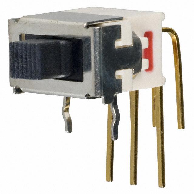

ES Series Sealed Tiny Slide Switches Features/Benefits • Process compatible—internal o-ring and epoxy base seal Typical Applications • Computer peripherals & network products • Thru-hole & surface mount models • Reliable contact design ensures long electrical life • Test & measurement equipment • Telephone & cable modems • Robust actuator for easy actuation • RoHS compliant Patent No. 6,008,458 I Slide Specifications CONTACT RATING: 0.4 VA max. @ 20 V AC or DC max. MECHANICAL & ELECTRICAL LIFE: 40,000 make-and-break cycles at full load. CONTACT RESISTANCE: 50 m Ω max. initial @ 2-4 V DC, 100 mA. INSULATION RESISTANCE: 109 Ω min. DIELECTRIC STRENGTH: 500 Vrms min. OPERATING TEMPERATURE: –30ºC to 85ºC. SOLDERABILITY: Per MIL-STD-202F method 208D, or EIA RS-186E method 9. DEGREE OF PROTECTION: IP57; Protection against harmful dust deposit, full-scale voltage protection, temporary immersion. ESD ENDURANCE: 8kv min. (EIA 545). PACKAGING: Thru-hole switches supplied in anti-static trays. Surface mount switches available in tape and reel packaging. Materials HOUSING & BASE: Nylon (UL 94V-0). ACTUATOR: LCP (UL 94V-0) black, standard. SURFACE PLATE: Stainless steel with tin plate. MOVABLE CONTACT: Bronze with gold plate over nickel plate. STATIONARY CONTACTS: Copper alloy, with gold plate over nickel plate. TERMINALS: Copper alloy, with gold over nickel plate. All terminals insert molded. BASE & TERMINAL SEAL: Epoxy. NOTE: All models RoHS compliant and compatible with all options. NOTE: Specifications and materials listed above are for switches with standard options. For information on specific and custom switches, consult Customer Service Center. How To Order Complete part numbers for ES Series Sealed Tiny Slide Switches are shown on pages I-5 through I-7. These unique tiny slide switches are process compatible. An internal o-ring and epoxy base seal protects the switch from wave and reflow soldering, as well as cleaning processes. PC MOUNTING SWITCH FUNCTION POS. 1 POS. 2 POS. 3 PART NUMBER ES01MCBE ES03MCBE CONN. TERMINALS SCHEMATIC ON ON 2-3 NONE OFF OPEN ON ON 2-1 ES01MCBE ES02 Models: omit hole 2. SPDT SPDT ES02MCBE CONN. TERMINALS SCHEMATIC OFF OPEN NONE N/A ON 3-1 ES02 Models: omit terminal 2. SPST Dimensions are shown: Inch (mm) Specifications and dimensions subject to change I–4 www.ck-components.com ES Series Sealed Tiny Slide Switches PC MOUNTING SWITCH FUNCTION POS. 1 POS. 2 POS. 3 PART NUMBER ES21MCBE ES02 Models: omit holes 2 & 5. ON ON 2-3, 5-6 NONE OFF OPEN ON ON 2-1, 5-4 ES23MCBE CONN. TERMINALS SCHEMATIC ES21MCBE DPDT DPDT I OFF OPEN NONE N/A ON ES22MCBE CONN. TERMINALS ES02 Models: omit terminals 2 & 5. Slide 3-1, 6-4 SCHEMATIC DPST PC MOUNTING SWITCH FUNCTION POS. 1 POS. 2 POS. 3 PART NUMBER ES21MABE ES23MABE CONN. TERMINALS SCHEMATIC ES02 Models: omit holes 2 & 5. ON ON 2-3, 5-6 NONE OFF OPEN ON ON 2-1, 5-4 ES21MABE DPDT DPDT ES22MABE CONN. TERMINALS SCHEMATIC OFF OPEN NONE N/A ON 3-1 DPST ES22 Models: omit terminals 2 & 5. Dimensions are shown: Inches (mm) Specifications and dimensions subject to change I–5 www.ck-components.com ES Series Sealed Tiny Slide Switches PC MOUNTING SWITCH FUNCTION POS. 1 POS. 2 POS. 3 PART NUMBER ES01MAVBE ES03MAVBE CONN. TERMINALS ON ON 2-3 NONE OFF OPEN ON ON 2-1 ES02 Models: omit hole 2. I Slide SCHEMATIC ES01MAVBE SPDT ES02 Models: omit terminal 2. PC MOUNTING SWITCH FUNCTION POS. 1 POS. 2 POS. 3 PART NUMBER SMT ES01MSABE ES03MSABE CONN. TERMINALS SCHEMATIC ON ON 2-3 NONE OFF OPEN ON ON 2-1 ES02 Models: omit pad 2. ES01MSABE Horizontal Actuation SPDT SPDT OFF OPEN NONE N/A ON 3-1 ES02MSABE CONN. TERMINALS SCHEMATIC SPST ES02 Models: omit terminal 2. Dimensions are shown: Inch (mm) Specifications and dimensions subject to change I–6 www.ck-components.com ES Series Sealed Tiny Slide Switches TAPE & REEL For part numbers ESXXMSABE REEL INFORMATION OUTSIDE DIAMETER PILOT HOLE QUANTITY PER REEL 13.00 (330,0) .512 (13,0) I Slide 300 Dimensions are shown: Inches (mm) Specifications and dimensions subject to change I–7 www.ck-components.com
