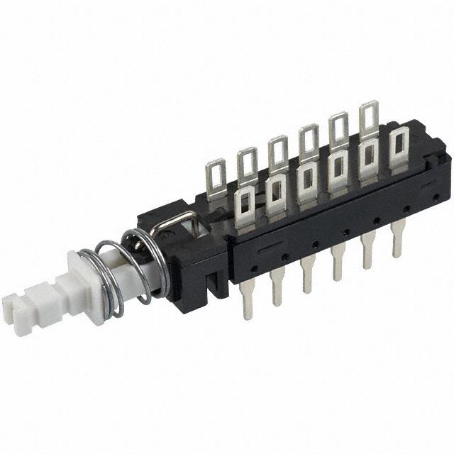

F4UEE 数据手册
F Series Pushbutton Switches Pushbutton A Features/Benefits • Up to 10 poles per module • Various contact terminals • Various mounting & switch Typical Applications • Audio selection • Digital equipment interface • Medical equipment interface ganging configurations • Mechanical indicator buttons • RoHS compliant Specifications SWITCHING POWER: F module max. AC/DC: Silver: 50 VA/15W, Gold: 1 VA/300 mW. TYPICAL F OPERATING FORCE: 2U: 6.5N (650 grams); 4U: 6.5N (650 grams); 6U: 7.5N (750 grams); 8U: 9.0N (900 grams); 10U: 9.0N (900 grams). SWITCHING VOLTAGE: F module max. AC/DC: Silver: 125/30V, Gold: 50/30 V. SWITCHING CURRENT: F module max. AC/DC: Silver: 0.5A/0.5A, Gold: 0.04A/0.01A. CARRYING CURRENT: Max at du = 20C: Silver: < 2A, Gold: 105 operations “GR”: >3.5 x 104 operations. EUROPEAN TYPICAL SF OPERATING FORCE: 2U: 3.5N±0.5N (350 grams±100 grams); 4U: 5N±1N (500 grams±100 grams); 6U: 6.5N±1N (650 grams±100 grams); 8U: 9.0N±1N (900 grams±100 grams). OPERATING TEMPERATURE RANGE: -40˚C to 70˚C. Materials HOUSING: Polycarbonate UL 94V-0 or polyester UL 94V-0. ACTUATOR: Polyester UL 94V-0. CONTACT RESISTANCE: Initial: Typical %10 mΩ, max. 20 mΩ After operating life: %100 mΩ INSULATION RESISTANCE: ^109 Ω between open contacts, ^109 Ω between chassis and contacts. MOVABLE CONTACTS: Bimetal brass, silver plated, gold plate over nickel. CAPACITANCE (at f = 10 kHz): %0.7 pF between 2 contacts. TERMINAL BOARD: Polyester UL 94V-0. TOTAL TRAVEL/LATCHING TRAVEL: 4.7mm/3.3mm (.185 inch/ .130 inch). RETURN SPRING: Music wire. All models and options are RoHS compliant and compatible. CHASSIS: Steel. STATIONARY CONTACTS & TERMINALS: Brass, silver plated, gold plated. TERMINAL SEAL: RTV adhesive sealant. NOTE: All models and options are RoHS compliant and compatible. LOCKOUT PIN: Steel. NOTE: Specifications and materials listed above are for switches with standard options. For information on specific and custom switches, consult Customer Service Center. BLOCKERS: Steel. Build-A-Switch To order, simply select desired option from each category and place in the appropriate box. Available options are shown and described on pages A-89 thru A-97. For additional options not shown in catalog, consult Customer Service Center. If requesting only a switch, select either a North American or European switch as noted below. Chassis and buttons are sold separately. If multiple stations are selected, we will assume all switches are the same unless noted otherwise. North American Order Code - Switch Only Designation F F Series FLT Light touch F series ZF Central mounted F series Contact Arrangement 2U 2PDT Mechanical Function 4U 4PDT OA Momentary 6U 6PDT EE Alternate (push-push) 8U SPDT GR Interlock 10U 1OPDT AOR Central release OASP Momentary with lockout GRSP Interlock with lockout Terminal Sealing (NONE) None TB Top/bottom Terminal Style (NONE) Solder lugs & PC pins 01A Cut solder lugs 01B Cut PC pins, for other configurations, consult factory Electrical Function (NONE) BBM Break-Before-Make M MBB (special) Make-Before-Break Contact Material (NONE) Silver, AG AU Gold Dress nut* *Central mounted F series only (NONE) No dress nut B Black C Chrome Dimensions are shown: Inches (mm) Specifications and dimensions subject to change A-88 www.ck-components.com F Series Pushbutton Switches A Designation SF F Series ZF Central mounted F series Contact Arrangement 2U 2PDT Mechanical Function 4U 4PDT OA Momentary 6U 6PDT EE Alternate (push-push) 8U SPDT GR Interlock Terminal Style (NONE) Solder lugs & PC pins LB Cut solder lugs PB Cut PC pins, for other configurations, consult factory Pushbutton European Order Code - Switch Only Contact Material (NONE) Silver, AG P Gold Electrical Function (NONE) BBM Dress nut* *Central mounted F series only (NONE) No dress nut B Black C Chrome *Minimum order quantities apply. Order Code - Buttons Solid Buttons Style F01 FMR F02 FG* F12 FSC F13 FSD F14 FU12 F15 FSB F16 FE F19 FA F21 F001 Mechanical Indicator Buttons Button Color 01 Black 02 White 03 Red 04 Light gray Style F01 FA100 F02 FA101 F07 FA120 F08 FA2O1 F11 FA200* Shell Color 01 Black Out Position Color 01 Black In Position Color 02 White 06 Yellow 07 Blue 08 Green 12 Orange *Button options for central mounting configurations, use ‘FG’ for central mount with chrome dress nut, use ‘FA200’ for central mount with black dress nut. BUTTON REMOVAL A button of a push-push switch should only be removed in the “OFF” non-latching position. Dimensions are shown: Inches (mm) Specifications and dimensions subject to change A-89 www.ck-components.com F Series Pushbutton Switches Pushbutton A Order Code - Chassis To order a switch with chassis, create the switch part number listed above and add the Chassis part number configurator information at the end of the part number. Note: We do not guarantee or recommend interlocking beyond 10 stations. C No. of Stations 01 thru 23 Comes with standard .094 (2,4mm) mounting holes Note: Single station chassis available with special mounting configurations, consult factory. *Minimum order quantities apply. Spacing 00 10 12.5 15 17.5 20 between Stations Single station 10mm 12.5mm 15mm 17.5mm 20mm Special Acknowledgements See note SWITCHES WITH STANDARD OPTIONS F2UEE CONTACT ARRANGEMENT LENGTH DIM ‘L’ 2U 0.827 (21,00) 4U 1.300 (33,00) 6U 1.770 (45,00) 8U 2.240 (57,00) 10U 2.720 (69,00) ZF2UEEBF11010108 CONTACT ARRANGEMENT LENGTH DIM ‘L’ 2U 0.827 (21,00) 4U 1.300 (33,00) 6U 1.770 (45,00) 8U 2.240 (57,00) 10U 2.720 (69,00) Third Angle Projection Dimensions are shown: Inches (mm) Specifications and dimensions subject to change A-90 www.ck-components.com F Series Pushbutton Switches DESIGNATION A Designation, Europe SF F Series ZF Central mounted F series Pushbutton Designation, North America F F Series FLT Light touch F series ZF Central mounted F series CONTACT ARRANGEMENT PC MOUNTING OPTION CODE NO. OF POLES SCHEMATIC 2U 2PDT 4U 4PDT 2X 6U 6PDT 3X 8U 8PDT 4X 10U 10PDT 5X MECHANICAL FUNCTION North America Europe OPTION CODE FUNCTION OPTION CODE OA Momentary OA Momentary EE Alternate (push-push) EE Alternate (push-push) GR Interlock GR Interlock AOR Central release OASP Momentary with lockout GRSP Interlock with lockout FUNCTION TERMINAL SEALING (NONE) TB NO SEAL TOP & BOTTOM F2UEE shown in example above. NOTE: Available for North America only Third Angle Projection Dimensions are shown: Inches (mm) Specifications and dimensions subject to change A-91 www.ck-components.com F Series Pushbutton Switches TERMINAL STYLE Pushbutton A (NONE) 01A LB SOLDER LUGS & PC PINS CUT SOLDER LUGS (North America) CUT SOLDER LUGS (Europe) 01B PB CUT PC PINS (North America) CUT PC PINS (Europe) .067 (1.70) .079 (2.01) ELECTRICAL FUNCTION OPTION CODE FUNCTION (NONE) BBM Non-shorting M MBB Shorting (North America only) CONTACT MATERIAL NORTH AMERICA OPTION CODE EUROPE OPTION CODE RoHS COMPLIANT * RoHS COMPATIBLE * MATERIAL (NONE) (NONE) YES YES SILVER, AG AU P YES YES GOLD RATING 50 VA/15 W; 125/30 V; 0.5/0.5 A 1 VA/300mW; 50/30 V; 0.04 A/0.01 A * Note: See Technical Data section of this catalog for RoHS compliant and compatible definitions and specifications. DRESS NUT (NONE) NO DRESS NUT FOR F & F/LT B C BLACK CHROME DESIGNATIONS PANEL CUTOUT PANEL CUTOUT NOTE: Available with ZF designation and FG button. NOTE: Available with ZF designation and FA200 buttons. Third Angle Projection Dimensions are shown: Inches (mm) Specifications and dimensions subject to change A-92 www.ck-components.com F Series Pushbutton Switches COLOR SOLID BUTTON A STYLE F01 FMR F02 FG F13 FSD F14 FU12 F12 Pushbutton STYLE FSC OPTION CODE COLOR 01 BLACK 02 WHITE 03 RED 04 LT. GRAY Dimensions are shown: Inches (mm) Specifications and dimensions subject to change A-93 www.ck-components.com F Series Pushbutton Switches COLOR SOLID BUTTON Pushbutton A STYLE STYLE F15 F19 FSB FA F16 F21 FE F001 SHELL COLOR OPTION CODE COLOR 01 BLACK 02 WHITE 03 RED 04 LT. GRAY IN POSITION COLOR MECHANICAL BUTTON OUT POSITION COLOR STYLE STYLE F01 F02 FA100 FA101 Third Angle Projection Dimensions are shown: Inches (mm) Specifications and dimensions subject to change A-94 www.ck-components.com F Series Pushbutton Switches SHELL COLOR IN POSITION COLOR MECHANICAL BUTTON STYLE A OUT POSITION COLOR F07 F11 FA120 F08 Pushbutton STYLE FA201 SHELL COLOR FA200 01 BLACK OUT POSITION COLOR 01 BLACK IN POSITION COLOR OPTION CODE COLOR 02 WHITE 06 YELLOW 07 BLUE 08 GREEN 12 ORANGE Third Angle Projection Dimensions are shown: Inches (mm) Specifications and dimensions subject to change A-95 www.ck-components.com F Series Pushbutton Switches SPACING CHASSIS Pushbutton A NO. OF STATIONS NUMBER OF STATIONS C00 Thru C10 Comes with standard 0.094 (2,44mm) mounting holes NOTE: Single station chassis available with mounting configurations, consult factory. SPACING 00 SINGLE STATION 10 10mm .394 (10,0) 12.5 12.5mm .492 (12,5) No. of Stations Dim. ‘A’ Dim. ‘B’ Tolerance 2 1.182 (30,02) 1.418 (36,02) 0.005 3 1.575 (40,01) 1.811 (46,00) 0.010 4 1.969 (50,01) 2.205 (56,01) 0.010 5 2.363 (60,02) 2.599 (66,01) 0.010 6 2.757 (70,03) 2.993 (76,02) 0.015 7 3.150 (80,01) 3.386 (86,00) 0.015 8 3.544 (90,02) 3.780 (96,01) 0.015 9 3.938 (100,03) 4.174 (106,02) 0.015 10 4.331 (110,01) 4.567 (116,00) 0.015 No. of Stations Dim. ‘A’ Dim. ‘B’ Tolerance 2 1.200 (30,48) 1.436 (36,47) 0.005 3 1.692 (42,98) 1.928 (48,97) 0.010 4 2.184 (55,47) 2.420 (61,47) 0.010 5 2.676 (67,97) 2.912 (73,96) 0.010 6 3.169 (80,49) 3.405 (86,49) 0.015 7 3.661 (92,99) 3.897 (98,98) 0.015 8 4.153 (105,49) 4.389 (111,48) 0.015 9 4.645 (117,98) 4.881 (123,98) 0.015 10 5.137 (130,48) 5.373 (136,47) 0.015 Third Angle Projection Dimensions are shown: Inches (mm) Specifications and dimensions subject to change A-96 www.ck-components.com F Series Pushbutton Switches SPACING CHASSIS A NO. OF STATIONS 15 Pushbutton SPACING 15mm No. of Stations Dim. ‘A’ Dim. ‘B’ Tolerance 2 1.374 (34,90) 1.615 (41,02) 0.005 3 1.969 (50,01) 2.205 (56,01) 0.010 4 2.560 (65,02) 2.796 (71,02) 0.010 5 3.150 (80,01) 3.386 (86,00) 0.010 6 3.741 (95,02) 3.977 (101,02) 0.015 7 4.332 (110,03) 4.568 (116,03) 0.015 8 4.922 (125,02) 5.158 (131,01) 0.015 9 5.513 (140,03) 5.749 (146,02) 0.015 10 6.103 (155,02) 6.339 (161,01) 0.015 17.5 17.5mm No. of Stations Dim. ‘A’ Dim. ‘B’ Tolerance 2 1.477 (37,52) 1.713 (43,51) 0.005 3 2.166 (55,02) 2.402 (61,01) 0.010 4 2.855 (75,52) 3.091 (78.51) 0.010 5 3.544 (90,02) 3.780 (96,01) 0.010 6 4.233 (107,52) 4.469 (113,51) 0.015 7 4.922 (125,02) 5.158 (131,01) 0.015 8 5.611 (142,52) 5.847 (148.51) 0.015 9 6.300 (160,02) 6.536 (166,01) 0.015 10 6.989 (177,52) 7.225 (183,52) 0.015 No. of Stations Dim. ‘A’ Dim. ‘B’ Tolerance 2 1.575 (40,01) 1.811 (46,00) 0.005 3 2.363 (60,02) 2.599 (66,01) 0.010 4 3.150 (80,01) 3.386 (86,00) 0.010 5 3.938 (100,03) 4.174 (106,02) 0.010 6 4.725 (120,02) 4.961 (126,01) 0.015 7 5.512 (140,00) 5.748 (146,00) 0.015 8 6.300 (160,02) 6.536 (166,01) 0.015 9 7.087 (180,01) 7.323 (186,00) 0.015 10 7.875 (200,03) 8.111 (206,02) 0.015 20 .591 (15,0) 20mm Third Angle Projection Dimensions are shown: Inches (mm) Specifications and dimensions subject to change A-97 www.ck-components.com
