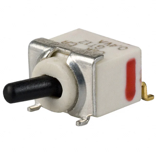

GT Series Sealed Ultraminiature Toggle Switches Features/Benefits • Sealed against solder and cleaning process contaminants • Ultraminiature size, smallest Typical Applications • Hand-held telecommunications • Small instrumentation footprint available • Thru-hole and surface mount models • High temperature materials (UL 94V-0) • RoHS  compliant and compatible Specifications Materials CONTACT RATING: 0.4 VA max. @ 20 V AC or DC max. MECHANICAL & ELECTRICAL LIFE: 40,000 make-and-break cycles at full load. CONTACT RESISTANCE: Below 50 m Ω typ. initial @ 2-4 V DC, 100 mA. INSULATION RESISTANCE: 109 Ω min. DIELECTRIC STRENGTH: 500 Vrms min. @ sea level. OPERATING TEMPERATURE: –30ºC to 85ºC. SOLDERABILITY: Per MIL-STD-202F method 208D, or EIA RS-186E method 9 (1 hour steam aging). PACKAGING: Surface mount switches shipped in anti-static tape and reel packaging per EIA 481-3, see page F-47 for drawings and reel information. Tape and cover strip are conductive for use near statically sensitive components, consult Customer Service Center. HOUSING AND BASE: Glass filled nylon 4/6, flame retardant, heat stabilized (UL 94V-0). ACTUATOR: Glass filled nylon 4/6, flame retardant, heat stabilized (UL 94V-0), with standard internal o-ring seal. SWITCH SUPPORT: Brass, tin plated. MOVABLE CONTACTS: Copper alloy, with gold plate over nickel plate. STATIONARY CONTACTS: Copper alloy, with gold plate over nickel plate. TERMINALS: Gold. TERMINAL SEAL: Epoxy. All terminals insert molded. NOTE: Specifications and materials listed above are for switches with standard options. For information on specific and custom switches, consult Customer Service Center. How To Order Our easy build-a-switch concept allows you to mix and match options to create the switch you need. To order, select desired option from each category and place it in the appropriate box. G T M B E T R Packaging TR Tape & Reel Pole 1 1 2 2 Seal E Epoxy Function 1 On-None-On 2 Off-None-On 3 On-Off-On Actuator M Contact Material B Gold Termination C PC thru-hole A Right angle, PC thru-hole AV Vertical right angle, PC thru-hole V3 PC thru-hole, V-bracket SA Right angle, surface mount SC Vertical, surface mount F Toggle Dimensions are shown: Inches (mm) Specifications and dimensions subject to change 4 Mar 22 F–43 www.ckswitches.com GT Series Sealed Ultraminiature Toggle Switches Complete part numbers for GT Series Sealed Ultraminiature Toggle Switches are shown on following pages. SWITCH FUNCTION POS.1 POS. 2 POS. 3 .100 (2,54) PART NUMBER GT11MCBE SPDT GT11MCBE GT13MCBE ON NONE ON OFF ON Conn. Terms. 2-3 OPEN 2-1 ON 4 Schematic .170 DIA. SPDT Conn. Terms. OFF NONE ON OPEN N/A 3-1 .020 TYP. (0,51) .066 DIA. .063 (1,60) Note: Pins 4 and 6 not connected GT12MCBE C&K MARKING ON .015 TYP. (0,38) OPPOSITE SIDE .100 (2,54) 6 .150 (3,81) .160 (4,06) .228 (5,79) Schematic EPOXY SEAL 3 2 1 .276 (7,01) .177 (4,50) .130 TYP. (3,30) ACTUATOR SHOWN IN POS. 1 TERMINAL NOS. FOR SPST Note: Pins 4 and 6 not connected REFERENCE ONLY PC MOUNTING GT12-omit hole 2. 6 3 4 1 GT12 MODEL TERMINALS 1,3,4 & 6 ONLY .100 (2,54) C&K MARKING ON OPPOSITE SIDE .150 (3,81) .160 (4,06) .170 DIA. .020 TYP. (0,51) .066 DIA. .063 (1,60) .228 (5,79) EPOXY SEAL .015 TYP. (0,38) .100 (2,54) 6 5 4 3 2 1 PART NUMBER .276 (7,01) .177 (4,50) PC MOUNTING GT21MCBE GT23MCBE Conn. Terms. ON NONE ON ON OFF ON 2-3, 5-6 OPEN 2-1, 5-4 Schematic .130 TYP. (3,30) ACTUATOR SHOWN IN POS. 1 SWITCH FUNCTION POS.1 POS. 2 POS. 3 TERMINAL NOS. FOR REFERENCE ONLY 6 3 4 1 GT22 MODEL TERMINALS 1,3,4 & 6 ONLY GT21MCBE DPDT DPDT GT22MCBE Conn. Terms. OFF NONE OPEN N/A ON 3-1, 6-4 Schematic DPST GT22-omit holes 2 & 5. SWITCH FUNCTION POS.1 POS. 2 POS. 3 GT11MABE GT13MABE ON NONE ON ON OFF ON Conn. Terms. 2-3 OPEN Schematic 4 Mar 22 F–44 SPDT 2-1 Dimensions are shown: Inches (mm) Specifications and dimensions subject to change www.ckswitches.com Toggle PART NUMBER F GT22MCBE GT Series Sealed Ultraminiature Toggle Switches Conn. Terms. OPEN N/A 3-1, 6-4 Schematic DPST SWITCH FUNCTION POS.1 POS. 2 POS. 3 PART NUMBER Actuator Shown In Pos. 1 GT11MABE GT13MABE ON NONE ON ON OFF ON Conn. Terms. 2-3 OPEN 2-1 Schematic PC MOUNTING GT11MABE Horizontal Actuation SPDT SPDT GT12MABE GT12 Models Conn. Terms. OFF NONE ON OPEN N/A 3-1 Schematic SPST GT12-omit hole 2. SWITCH FUNCTION POS.1 POS. 2 POS. 3 PART NUMBER GT21MABE GT23MABE Conn. Terms. ON NONE ON ON OFF ON 2-3, 5-6 OPEN 2-1, 5-4 GT21MABE Horizontal Schematic Actuation Actuator Shown In Pos. 1 DPDT DPDT GT22MABE PC MOUNTING Conn. Terms. OFF NONE ON OPEN N/A 3-1, 6-4 Schematic DPST GT22 Models GT22-omit holes 2 & 5. Toggle F Dimensions are shown: Inches (mm) Specifications and dimensions subject to change 4 Mar 22 F–46 www.ckswitches.com GT Series Sealed Ultraminiature Toggle Switches SWITCH FUNCTION POS.1 POS. 2 POS. 3 PART NUMBER GT11MAVBE GT13MAVBE ON NONE ON OFF ON Conn. Terms. 2-3 OPEN 2-1 OFF NONE ON OPEN N/A 3-1 ON Schematic GT11MAVBE Vertical Actuation SPDT SPDT GT12MAVBE Conn. Terms. Schematic Actuator Shown In Pos. 1 PC MOUNTING GT12 omit hole 2. SPST GT12 Models SWITCH FUNCTION POS.1 POS. 2 POS. 3 PART NUMBER GT21MAVBE GT23MAVBE Conn. Terms. ON NONE ON ON OFF ON 2-3, 5-6 OPEN 2-1, 5-4 OFF NONE ON OPEN N/A 3-1, 6-4 Schematic GT21MAVBE Vertical Actuation DPDT DPDT GT22MAVBE Conn. Terms. Actuator Shown In Pos. 1 PC MOUNTING Schematic GT22 omit holes 2 & 5. DPST GT22 Models: 1, 3, 4 & 6 terminals only. SWITCH FUNCTION POS.1 POS. 2 POS. 3 PART NUMBER GT11MV3BE SPDT GT11MV3BE GT13MV3BE ON NONE ON OFF ON Conn. Terms. 2-3 OPEN 2-1 ON Schematic SPDT GT12MV3BE Conn. Terms. Note: Pins 4 and 6 not connected OFF NONE ON OPEN N/A 3-1 Actuator Shown In Pos. 1 F PC MOUNTING Schematic GT12 Models Toggle SPST Note: Pins 4 and 6 not connected GT12 omit hole 2. Dimensions are shown: Inches (mm) Specifications and dimensions subject to change 4 Mar 22 F–47 www.ckswitches.com GT Series Sealed Ultraminiature Toggle Switches SWITCH FUNCTION POS.1 POS. 2 POS. 3 PART NUMBER GT21MV3BE GT23MV3BE Conn. Terms. GT21MV3BE GT22 Models: 1, 3, 4 & 6 terminals only. DPDT ON NONE ON ON OFF ON 2-3, 5-6 OPEN 2-1, 5-4 OFF NONE ON OPEN N/A 3-1, 6-4 Schematic DPDT GT22MV3BE Actuator Shown In Pos. 1 Conn. Terms. PC MOUNTING Schematic DPST .150 (3,81) .273 (6,93) .066 DIA. PART NUMBER 1 2 3 GT11MSABE Horizontal .200 (5,08) .020 TYP. (0,51) .109 (2,77 ) Actuation SPDT .053 (1,35) .340 (8,64) SWITCH FUNCTION POS.1 POS. 2 POS. 3 .276 (7,01) .215 (5,46) GT11MSABETR GT13MSABETR .015 X.020TYP. (0,38) (0,51) X .100 TYP. Conn. Terms. (2,54) Schematic TERM NOS. FOR REFEREN CE ONLY .050 TYP. (1,27) ACTUA TOR SHO WN IN POS.1 ON NONE ON ON OFF ON 2-3 OPEN 2-1 OFF NONE ON OPEN N/A 3-1 SPDT PC MOUNTING GT12MSABETR EPO XY SEA L 1 3 GT12 MODE L TERM S.1 & 3 NLY O Conn. Terms. Schematic SPST Standard with tape & reel packaging, see page F-47. GT12-omit pad 2. SWITCH FUNCTION POS.1 POS. 2 POS. 3 PART NUMBER PC MOUNTING SPDT NONE ON ON OFF ON Conn. Terms. 2-3 OPEN 2-1 SPDT Note: Pins 4 and 6 not connected GT12MSCBETR Conn. Terms. F Toggle ON Schematic Actuator Shown In Pos. 1 GT11MSCBE GT11MSCBETR GT13MSCBETR OFF NONE ON OPEN N/A 3-1 Schematic GT12 Models Standard with tape & reel packaging, see page F-47. SPST Note: Pins 4 and 6 not connected GT12-omit pad 2. Dimensions are shown: Inches (mm) Specifications and dimensions subject to change 4 Mar 22 F–48 www.ckswitches.com GT Series Sealed Ultraminiature Toggle Switches SWITCH FUNCTION POS.1 POS. 2 POS. 3 PART NUMBER GT21MSCBETR GT23MSCBETR Conn. Terms. GT21MSCBE DPDT ON NONE ON OFF ON ON 2-3, 5-6 OPEN 2-1, 5-4 Actuator Shown In Pos. 1 Schematic PC MOUNTING DPDT GT22MSCBETR Conn. Terms. OFF NONE ON OPEN N/A 3-1, 6-4 Schematic GT22 Models DPST GT22-omit pads 2 & 5. Standard with tape & reel packaging TAPE & REEL For part numbers GT11MSABE, GT12MSABE, GT13MSABE REEL INFORMATION OUTSIDE DIAMETER PILOT HOLE 13.00 (330,0) .512 (13,0) QUANTITY PER REEL 600 For part numbers GT11MSCBE, GT12MSCBE, GT13MSCBE, GT21MSCBE, GT22MSCBE, GT23MSCBE, REEL INFORMATION OUTSIDE DIAMETER PILOT HOLE QUANTITY PER REEL 13.00 (330,0) .512 (13,0) 200 F Toggle Dimensions are shown: Inches (mm) Specifications and dimensions subject to change 4 Mar 22 F–49 www.ckswitches.com
GT12MSABE
物料型号:GT系列
器件简介:GT系列提供密封超小型切换开关,具有以下特点: - 防焊剂和清洁过程中的污染物 - 超小型尺寸,最小的占用空间 - 提供通孔和表面贴装型号 - 高温材料(UL 94V-0) - 符合RoHS标准和兼容
引脚分配:文档中提供了多种型号的开关,包括SPDT、DPDT、SPST和DPST等,具体的引脚分配和连接方式在文档中有详细的图示和说明。
参数特性: - 接触额定值:最大0.4 VA @ 20 V AC或DC - 机械和电气寿命:在全负载下40,000次开关循环 - 接触电阻:初始时典型值低于50 mΩ @ 2-4 V DC, 100 mA - 绝缘电阻:最小10^9 Ω - 介电强度:最小500 Vrms @ 海平面 - 工作温度:-30ºC至85ºC - 可焊性:符合MIL-STD-202F方法208D或EIA RS-186E方法9(1小时蒸汽老化)
功能详解:文档详细描述了不同型号开关的功能,例如SPDT(单极双掷)、DPDT(双极双掷)、SPST(单极单掷)等,以及它们的不同位置(POS.1、POS.2、POS.3)的开关状态。
应用信息:适用于手持通信设备、小型仪器等。
封装信息:提供详细的封装尺寸和材料信息,包括外壳和底座材料、执行器、开关支撑、活动和固定接触点、端子和端子密封等。
如何订购:文档提供了一个易于使用的构建开关概念,允许用户混合和匹配选项以创建所需的开关。用户可以根据每个类别选择所需的选项并将其放置在适当的框中。
