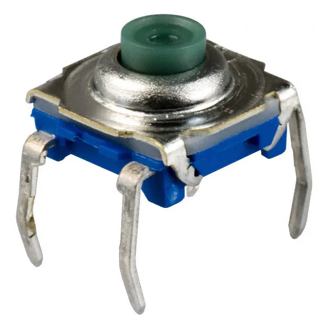

KSA0M310 数据手册
KSA & KSL Series Sealed Tact Switch Features/Benefits Typical Applications • Designed for automatic or manual insertion • Cambered terminals to ensure self retention • Top or side actuated • Washable option available • Large choice of caps • Automotive • Industrial • Telecommunication networks Electrical CONTACT ARRANGEMENT: SPST, N.O. DOUBLE OVERMOLDING ON TERMINAL MEMBRANE SEALING TERMINALS: PC pins, ground pin optional MAXIMUM POWER: MAXIMUM VOLTAGE: MINIMUM VOLTAGE: MAXIMUM CURRENT: MINIMUM CURRENT: Mechanical Type KSA0M211 KSA0M311 KSA0M411 KSA0M511 KSA0M911 KSL0M211 KSL0M311 KSL0M411 KSL0M511 KSL0M911 Actuation force N (grams) 1.3 (130) 1.3 (130) 3.0 (300) 5.0 (500) 3.0 (300) 1.3 (130) 1.3 (130) 3.0 (300) 5.0 (500) 3.0 (300) Operating life (operations) 500,000 1,000,000 100,000 100,000 500,000 500,000 1,000,000 100,000 100,000 500,000 Silver 1 VA 50 VDC 20 mV 50 mA 1 mA Gold 0.2 VA 50 VDC 20 mV 10 mA 1 mA DIELECTRIC STRENGTH: 300 Vrms CONTACT RESISTANCE: < 50 mΩ INSULATION RESISTANCE (100 V): > 1011 Ω BOUNCE TIME: < 1 ms Travel to make 0,5 ± 0,2 0,5 ± 0,2 0,6 ± 0,2 0,7 ± 0,2 0,6 ± 0,2 0,5 ± 0,2 0,5 ± 0,2 0,6 ± 0,2 0,7 ± 0,2 0,6 ± 0,2 Environmental OPERATING TEMPERATURE: STORAGE TEMPERATURE: Silver -40˚C to 90˚C -40˚C to 90˚C Gold -40˚C to 125˚C -55˚C to 125˚C Process Wave soldering EIA-RS448-2 Packaging Can be delivered in tubes of 65 pieces for automatic insertion or in boxes of 500 pieces for manual insertion (250 pieces for KSL, KSLV, KSAV). NOTE: Part numbers listed above do not represent all possible configurations.For information on specific and custom switches, consult Customer Service Center. How To Order Our easy build-a-switch concept allows you to mix and match options to create the switch you need. To order, select desired option from each category and place it in the appropriate box. K SWITCH S Sealing 0 Sealed against flux 1 Totally sealed Actuator Type A Short hard plastic L Long hard plastic Ground Terminal 0 Without Contact Material 1 Silver contacts 3 Gold contacts Insertion M Manual (bulk packaging) A Automatic (tube packaging) V Vertical BUTTONS Operation Force 2 1.3 N (130 grams), 100,000 operations 3 1.3 N (130 grams), 1,000,000 operations 4 3 N (300 grams), 100,000 operations 5 5 N (500 grams), 100,000 operations 9 3 N (300 grams), 500,000 operations Buttons must be ordered separately and will be supplied in bulk. B T Button Style K01 10 mm square snap-on K02 ø8 mm round snap-on K03 8,5 x 3,8 mm single floating K04 18,5 x 3,8 mm double floating K05 5 mm square N K06 K07 K08 K09 K 0 10 x 2,5 mm snap-on handle 5 mm square 9,9 x 5 mm rectangular ø6,2 mm round Button Color 10 Dark gray 20 Light gray 30 Yellow 40 Red 50 Green 60 70 80 90 Blue Gray-blue Ivory Black Dimensions are shown: mm (inch) Dimensions subject to change B-39 www.ittcannon.com B Tactile Switches Specification KSA & KSL Series Sealed Tact Switch ACTUATOR TYPE KSA & KSL 1,2 (.047) 1,1 (.043) 2,6 (.102) 1,06±0,1 (.042±.004) ø3,0 (.118) 2,6 (.102) 2,1±0,1 (.083±.004) 4,2 (.165) 0,45 (.018) Tactile Switches ø4,8 (.189) KSA: 4,7 (.185) KSL: 9,9 (.390) 8,2 (.322) B 1,1 (.043) ø3,5 min. (.138) Shape of button Washing Stud 0,5 x 0,3 (.020 x .012) 7,62 (.30) 7,4 (.291) 9,0 (.354) Type KSA KSL Electrostatic Shield 5,08 (.20) H mm 4,7 9,9 inch (.185) (.390) 7,4 (.291) GROUND TERMINAL 0 WITHOUT First Angle Projection Dimensions are shown: mm (inch) Dimensions subject to change B-40 www.ittcannon.com KSA & KSL Series Sealed Tact Switch INSERTION M MANUAL (bulk packaging) A AUTOMATIC (tube packaging, 65 pieces per tube) PCB LAYOUT 8,2 (.322) 4,2 (.165) 2,6 (.102) 7,62 (.30) 5,08 (.20) 9,0 (.354) 8,0 (.315) VERTICAL PCB LAYOUT ø1,2 (.047) 2,54 (.100) 5,25 (.207) 3,52 (.128) 7,62 (.300) 4,85 (.191) V B Tactile Switches 0,5 x 0,3 (.020 x .012) 7,62 (.30) 5,08 (.20) ø0,9+0,1/-0,0 (.035+.004/-.000) 0,45 (.018) Ground terminal (option) ø0,9 (.035) 5,08 (.200) 0,8 x 0,3 0,5 x 0,3 (.020 x .012) (.031 x .012) 0,4 (.016) 5,08 (.20) Dimension L 7,8 (.307) 9,5 (.374) 2,54 (.10) 3,0 (.118) L Type KSAOV KSLOV L mm 5,8 11,1 inch .228 .437 OPERATING FORCE OPTION CODE 2 OPERATING FORCE 1.3 N (130 grams) 100,000 operations 3 1.3 N (130 grams) 1,000,000 operations 4 3.0 N (300 grams) 100,000 operations 5 5.0 N (500 grams) 100,000 operations 9 3.0 N (300 grams) 500,000 operations First Angle Projection Dimensions are shown: mm (inch) Dimensions subject to change B-41 www.ittcannon.com KSA & KSL Series Sealed Tact Switch CONTACT MATERIAL OPTION CODE CONTACT MATERIAL 1 Silver contacts 3 Gold contacts B Tactile Switches SEALING OPTION CODE SEALING 0 1 Sealed against flux Totally sealed BUTTONS Buttons must be ordered separately and will be supplied in bulk. BUTTON TYPE KSA K01 K02 K03 K04 K05 K06 K07 K08 K09 KSAV KSLV X X X X X X X X X X X X X X X X X 1,0 (.039) 4,4±0,1 (.173±.004) 8,0 (.315) 0,8 (.031) 3,5±0,05 (.138±.002) 3,7±0,1 (.146±.004) 4,5±0,1 (.177±.004) 3,7 (.146) 4,5 (.177) 8,0 (.315) 1,0 (.039) 1,0 (.039) R 0,5 (.020) 10,0 (.394) 10±0,1 (.394±.004) ø8,0+0,0/-0,2 (.315+.000/-.008) 0,5 (.020) 4,4 (.173) 10,0 (.394) 8,0 (.315) 1,0 (.039) K02 0,5+0,1/-0,0 (.020+.004/-.000) X 0,3 ) R 012 (. K01 KSL X 10±0,1 (.394±.004) 5 0, ) R 020 (. 8,0 (.315) Dimensions are shown: mm (inch) Dimensions subject to change B-42 www.ittcannon.com KSA & KSL Series Sealed Tact Switch K04 K03 3,8 (.150) 9,5±0,1 (.374±.004) 19,5 (.768) 1,0+0,05/-0,0 5,6±0,1 (.220±.004) (.039+.002/-.000) R (.0 0,2 08 ) 18,5 (.728) 3,0±0,1 (.118±.004) 4,0 (.157) 4,0 (.157) 3,0 (.118) 4,5 (.177) 4,5 (.177) 3,7 (.146) 4,5 (.177) 15,6 (.614) R (.0 0,3 12 ) K06 B 1,0 (.039) 2,5 (.098) 4,4 (.173) 10,0 (.394) 10,0 (.394) 8,74 (.344) 1,0 (.039) 5,0 (.197) K07 K08 4,5 (.177) 9,4 (.370) 5,0 (.197) 10,0 (.394) 9,0 (.354) 5,0 (.197) 5,0 (.197) 9,0 (.354) K09 8,992 (.354) ø4,318 (.17) ø6,223 (.245) Dimensions are shown: mm (inch) Dimensions subject to change B-43 www.ittcannon.com Tactile Switches K05 5,6 (.220) 1,0 (.039)
