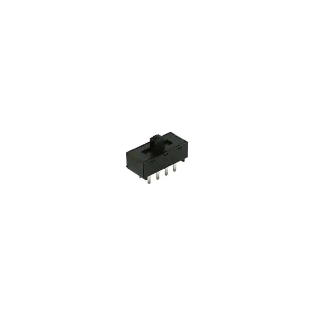

    滑动开关 插件 单刀双掷 直插
L102021ML04B 数据手册
L Series Miniature Slide Switches Features/Benefits • Positive detent • Enclosed housing • Maintained and momentary functions • PC and panel mounting • RoHS compliant Typical Applications • Communications equipment • Lighting devices Models Available Materials CONTACT RATING: Q contact material (LX0X, LX1X Models): 4 AMPS @ 125 V AC or 28 V DC; 2 AMPS @ 250 V AC; 0.5 AMP @ 125 V DC (UL). See page I-23 for additional ratings. ELECTRICAL LIFE: 10,000 make-and-break cycles at full load. CONTACT RESISTANCE: Below 10 m Ω typ. initial @ 2-4 V DC, 100 mA, for both silver and gold plated contacts. INSULATION RESISTANCE: 109 Ω min. DIELECTRIC STRENGTH: 1,000 Vrms min. @ sea level. OPERATING TEMPERATURE: -30ºC to +65ºC STORAGE TEMPERATURE: -30ºC to +85ºC HOUSING: 6/6 nylon (UL94V-2), black. ACTUATOR: 6/6 nylon (UL94V-2), black. ‘13’ actuator, natural (standard). CONTACTS: Q contact material: Copper, silver plated. See page I-23 for additional contact materials. TERMINALS: Q contact material: Copper, silver plated. See page I-23 for additional contact materials. CONTACT SPRING: Music wire or stainless steel. TERMINAL SEAL: Epoxy. NOTE: Any models supplied with Q, B or G contact material are RoHS compliant. NOTE: Specifications and materials listed above are for switches with standard options. For information on specific and custom switches, consult Customer Service Center. Build-A-Switch To order, simply select desired option from each category and place in the appropriate box. Available options are shown and described on pages I-20 through I-24. For additional options not shown in catalog, consult Customer Service Center. Switch Function L202 DPDT L203 DP3T L101 SPST L102 SPDT L103 SP3T L104 SP4T L112 SPDT, mom. L113 SP3T, mom. to one end L123 SP3T, mom. to both ends L201 DPST L204 DP4T L212 DPDT, mom. Actuator 01 .200” high 02 .335” high 03 .375” high 05 .312” high 11 .100” high 12 Screwdriver slot 13 Plunger without cap 14 Plunger with .200” dia. cap 15 Plunger with .310” dia. cap 17 Plunger with .458” dia. cap 19 Plunger with .590” dia. cap Detent 1 With detent 2 Without detent Mounting Style MS PC Thru-hole MA Right angle, PC thru-hole ML Right angle, PC thru-hole MV Right angle, PC thru-hole SS Panel with mounting ears TS Panel with integral mounting ears Terminations 02 PC Thru-hole 01 Solder lug with notch 03 Solder lug with hole 04 PC Thru-hole 10 PC Thru-hole 06 Wire wrap 12 PC Thru-hole Contact Material B Gold Q Silver G Gold over silver Seal NONE No seal E Epoxy seal Cap Color 2 Black NONE No cap Dimensions are shown: Inches (mm) Specifications and dimensions subject to change 19 Mar 2019 I–19 www.ckswitches.com I Slide Specifications L Series Miniature Slide Switches SWITCH AND LOCK FUNCTION NO. POLES SP Slide I MODEL NO. SWITCH FUNCTION AVAILABLE MOUNTING STYLES SCHEMATIC L101 SPST ML, MS, SS L102 SPDT ML, MS, SS L112 SPDT-MOM. L103 SP3T MA, MS, TS L113 SP3T-MOM. to one end MA, MS, TS L123 SP3T-MOM. to both ends MA, MS, TS 1 2 3 NO. POLES ML, MS, MV, SS­ DP L104 SP4T MODEL NO. SWITCH FUNCTION AVAILABLE MOUNTING STYLES SCHEMATIC L201 DPST MA, MS, SS L202 DPDT MA, MS, SS L212 DPDT-MOM. MV L203 DP3T MS, TS MS L204 DP4T NOTE: MS and MOM. in table indicates momentary action. All models with all options when ordered with ‘G’ or ‘Q’ contact material. Contacts make on side actuator thrown. CAP COLOR ACTUATOR ACTUATOR ACTUATOR OPTIONS FOR ‘MS, MA, ML, SS, & TS’ MOUNTING STYLES 01  .200” HIGH 02  .335” HIGH 03  .375” HIGH 05  .312” HIGH 11  .100” HIGH 12 SCREWDRIVER SLOT .200 5,08 NOTE: No actuator color option code is required. Standard actuator color is black, other colors and heights available, consult Customer Service Center. See pages I-20 and I-22 for available mounting styles. ACTUATOR OPTIONS FOR ‘MV’ MOUNTING STYLE 13  PLUNGER WITHOUT CAP 14  PLUNGER WITH CAP 15  PLUNGER WITH CAP Cap part number 7089 17  PLUNGER WITH CAP Cap part number 8018 19  PLUNGER WITH CAP ACTUATOR CAP COLORS OPTION CODE 2 BLACK NONE 01-13 ACTUATORS Other colors available, consult Customer Service Center. Cap part number 7982 Cap part number 8940 ACTUATOR CAPS Caps supplied are not installed standard. To order actuator options ‘14 thru 19,’ select desired cap color from chart and place option code in last box of ordering format. Leave box empty for all other actuator options. Caps may also be ordered separately and user installed, see pages I-23 and I-24. Specify the four digit part number and desired cap color. For switches without caps, order ‘13’ or ‘23’ actuator option. Cap finish: gloss (excluding square cap part number 7982, finish: matte). Dimensions are shown: Inch (mm) Specifications and dimensions subject to change 19 Mar 2019 I–20 www.ckswitches.com L Series Miniature Slide Switches DETENT 1  WITH DETENT Standard with all maintained models: L101, L102, L103, L104, L113, L201, L202, L203 and L204. 2  WITHOUT DETENT Standard with all momentary models: L112, L123, and L212. MOUNTING STYLE MS  PC THRU-HOLE, 2 POSITION MODELS .425 (10,79) .225 TYP (5,71) .050 X .020 TYP (1,27) X (0,51) 6 5 4 .181 TYP (4,60) .150 TRAVEL (3,81) .200 (5,08) .070 TYP .125 TYP (1,78) (3,18) .221 TYP (5,61) .225 TYP (5,70) 3 2 1.181 TYP (4,60) .065 DIA (1,65) TYP TERMINAL NOS. FOR REFERENCE ONLY AVAILABLE WITH: I Models: L101, L102, L112, L103, L113 L123, L201, L202, L203, L104 and L204 Terminations: 02, 06, 10 and 12 Actuators: 01, 02, 03, 05, 11 and 12 PC MOUNTING For mounting information, see TERMINATIONS section, page I-23. L203011MS02Q DP3T PC THRU-HOLE, 3 POSITION MODELS PC THRU HOLE, 4 POSITION MODELS .425 (10,79) .288 (7,32) .200 (5,08) .170 TRAVEL (4,32) TYP .050 X .020 TYP (1,27) X (0,51) 1.122 (28,50) .181 TYP (4,60) .070 TYP (1,78) .232 TYP (5,89) .225 TYP (5,71) 10 9 8 7 6 .181 TYP (4,60) .050 TYP (1,27) .225 TYP (5,70) 5 4 3 2 1 TERMINAL NOS. FOR REFERENCE ONLY .065 DIA (1,65) TYP MA  RIGHT ANGLE, PC THRU-HOLE AVAILABLE WITH: Models: L103, L201, L202, L113 and L123 Terminations: 04 Actuators: 02 and 12 PC MOUNTING For mounting information, see TERMINATIONS section, page I-23. DPDT RIGHT ANGLE, PC, SP-3 POSITION MODELS .400 (10,16) 0.941 (23,90) .335 (8,51) .412 (10,46) .140 (4,06) TRAVEL .200 (5,08) 0.125 (3,18) L202021MA04Q Horizontal Actuation .100 TYP (2,54) 4 3 2 1 .181 TYP (4,60) TERM. NOS. FOR REFERENCE ONLY 4 3 2 1 .100 TYP (2,54) .256 (6,50) .215 (5,46) Dimensions are shown: Inches (mm) Specifications and dimensions subject to change 19 Mar 2019 I–21 www.ckswitches.com Slide .752 (19,10) .288 (7,32) .200 (5,08) L Series Miniature Slide Switches MOUNTING STYLE ML  RIGHT ANGLE, PC THRU-HOLE AVAILABLE WITH: Models: L101, L102, L112 Terminations: 04 Actuators: 01, 02, 05, 11 and 12 PC MOUNTING For mounting information, see TERMINATIONS section, page I-23. L102021ML04Q Horizontal Actuation SPDT MV  RIGHT ANGLE, PC THRU-HOLE Slide AVAILABLE WITH: Models: L112 and L212 Terminations: 02, 06, 10 and 12 Actuators: 13 thru 19 PC MOUNTING For mounting information, see TERMINATIONS section, page I-23. L212132MV02Q DPDT SS  PANEL WITH MOUNTING EARS PANEL MOUNTING .425 (10,60) L202011SS03Q ø .100 (2,54) 1.200 (30,48) 1.000 (25,40) .150 (3,81) TRAVEL .125 (3,18) DPDT .358 (9,09) .181 TYP (4,60) 6 5 4 .200 (5,08) .135 (3,43) .225 (5,72) .760 (19,30) 6 3 5 2 4 1 1.000 (25,40) .360 (9,14) .110 DIA (2,79ø) TYP .070 TYP (1,78) .240 .050 (6,10) (1,27) .200 (5,08) AVAILABLE WITH: Models: L101, L102, L112, L201 and L202 Terminations: 01, 02, 03, 06, 10, 12 Actuators: 01, 02, 03, 05, 11 and 12 TS  PANEL WITH INTEGRAL MOUNTING EARS ø .070 TYP (1,78) .240 (6,10) ø 0.100 TYP (2,54) 0.100 (2,54) L203011TS03Q 1.000 (25,40) .941 (23,90) DP3T 7 6 .160 TYP (4,06) TRAVEL 5 .200 (5,08) .181 (4,60) TYP .125 (3,18) .200 (5,08) .358 (9,09) FULL R TYP. 2X 0.218 (5,53) 1.000 (25,40) 2X 0.050 (1,27) .425 (10,80) PANEL MOUNTING 0.250 (6,35) CAVITY I.D. 0.0625 HIGH X 0.010 RAISED I .135 (3,43) 1.000 (25,40) 2X 0.050 (1,27) 0.080 (2,03) AVAILABLE WITH: .530 (13,46) .110 DIA (2,79ø) Models: L103, L113, L123 and L203 Terminations: 01, 02, 03, 06, 10, 12 Actuators: 01, 02, 03, 05, 11 and 12 Dimensions are shown: Inch (mm) Specifications and dimensions subject to change 19 Mar 2019 I–22 www.ckswitches.com L Series Miniature Slide Switches TERMINATIONS ‘MS, MV, SS & TS’ Mounting Styles Only 02  PC THRU-HOLE 01  SOLDER LUG WITH NOTCH .226 (5,74) .060 (1,52) .050 (1,27) .085 (2,16) .240 (6,10) .062 (1,57) .080 (2,03) 03  SOLDER LUG WITH HOLE .028 (0,71) 12  PC THRU-HOLE .065 DIA (1,65ø TYP. All 2 position models, except ‘04’ and ‘10’ terminations. All models with ‘04’ terminations and ‘ML’ mounting style. .445 (11,30) .050 (1,27) .020 THK. (0,51) .181 TYP. (4,60) .272 (6,91) .065 DIA (1,65ø) TYP. All 2 position models with ‘04’ and ‘10’ terminations. .065 DIA (1,65ø) TYP. All 3 position models except ‘04’ and ‘10’ terminations. .050 (1,27) .020 THK. (0,51) .181 TYP. (4,60) .272 (6,91) .181 TYP. (4,60) .225 (5,72) .065 DIA (1,65ø) TYP. I .256 (6,50) .085 (2,16) .080 (2,03) Slide .181 TYP. (4,60) .225 (5,72) .065 DIA (1,65ø) TYP. 04  PC THRU-HOLE .065 (1,65) .080 (2,03) .020 THK. (0,51) .187 TYP. (4,75) ‘MA & ML’ Mounting Styles Only 06  WIRE WRAP .050 (1,27) .272 (6,91) .050 (1,27) .020 THK. (0,51) .080 (2,03) .046 (1,17) .020 THK. (0,51) .419 (10,64) .080 (2,03) .226 (5,74) .240 (6,10) .080 (2,03) .080 (2,03) .020 THK. (0,51) .020 THK. (0,51) 10  PC THRU-HOLE .181 TYP. (4,60) .181 TYP. (4,60) .225 (5,72) .065 DIA (1,65ø) TYP. All 3 position models, with ‘10’ termination. .272 (6,91) .065 DIA (1,65ø) TYP. All 4 position models, with ‘10’ terminations. All 4 position models, except ‘04’ and ‘10’ terminations. CONTACT MATERIAL OPTION CODE CONTACT MATERIAL B GOLD 1 Q SILVER 2 G GOLD OVER LOW LEVEL/DRY SILVER 3 CIRCUIT OR POWER RATINGS LOW LEVEL/DRY CIRCUIT POWER 0.4 VA MAX. @20 V AC OR DC max. LX0X, LX1X MODELS: 4 AMPS @ 125 V AC or 28 V DC; 2 AMPS @ 250 V AC; 0.5 AMP @ 125 V DC (UL). LX6X MODELS: 4 AMPS @ 125 V AC or 28 V DC; 2 AMPS @ 250 V AC (UL). LX0X, LX1X MODELS: 0.4 VA MAX. @ 20 V AC or DC MAX. or 4 AMPS @ 125 V AC or 28 V DC; 2 AMPS @ 250 V AC; 0.5 AMP @ 125 V DC (UL). LX6X MODELS: 0.4 VA MAX. @ 20 V AC or DC MAX. or 4 AMPS @ 125 V AC or 28 V DC; 2 AMPS @ 250 V AC (UL). * Note: See Technical Data section of this catalog for RoHS compliant and compatible definitions and specifications. 1 CONTACTS & TERMINALS: Copper, with gold plate over nickel plate. NOTE: Any models supplied with B, Q or G contact material are RoHS compliant. 2 CONTACTS & TERMINALS: Copper, silver plated (standard with all termination options). All models 3 CONTACTS & TERMINALS: Copper, with gold plate over nickel plate over silver plate. NOTE: ‘G’ contact material is equivalent to both ‘B’ and ‘Q’ contact materials. with all options when ordered with ‘G’ or ‘Q’ contact material. SEAL NONE  NO SEAL E  EPOXY SEAL EPOXY .075 MAX. (1,91) Dimensions are shown: Inches (mm) Specifications and dimensions subject to change 19 Mar 2019 I–23 www.ckswitches.com L Series Miniature Slide Switches AVAILABLE HARDWARE Cap Compatible with 13-19 actuators Cap Compatible with 13-19 actuators .120 (3,05) Slide .310 DIA. (7,87 ) .375 DIA. (9,53 ) .200 DIA. (5,08 ) .138 (3,51) .250 (6,35) .250 (6,35) .120 (3,05) .155 (3,94) I Cap Compatible with 13-19 actuators PART NO. PART NO. PART NO. 708902000 BLACK 708903000 RED 752702000 BLACK 752703000 RED 801802000 BLACK 801803000 RED Material: Nylon Finish: Gloss Material: Nylon Finish: Gloss Material: Nylon Finish: Gloss Cap Compatible with 13-19 actuators Cap Compatible with 13-19 actuators Cap Compatible with 13-19 actuators .450 SQ. (11,43) .195 (4,95) .240 (6,10) PART NO. PART NO. PART NO. PART NO. 452D02000 BLACK 452D03000 RED 894102000 BLACK 894103000 RED 484602000 BLACK 484603000 RED 798202263 BLACK 798203000 RED Material: Nylon Finish: Gloss Material: Nylon Finish: Gloss Material: Nylon Finish: Gloss Material: Nylon Finish: Matte Cap Compatible with 01-05 actuators NOTE: Other colors available, consult Customer Service Center. PART NO. 120100602 BLACK Material: Nylon Finish: Matte Dimensions are shown: Inch (mm) Specifications and dimensions subject to change 19 Mar 2019 I–24 www.ckswitches.com

物料型号:文档中提到了多种型号,例如L101 SPST, L102 SPDT, L103 SP3T, L104 SP4T, L112 SPDT-MOM., L113 SP3T-MOM. to one end, L123 SP3T-MOM. to both ends, L201 DPST, L202 DPDT, L203 DP3T, L204 DP4T, L212 DPDT-MOM.
器件简介:L系列微型滑动开关具有正向定位、封闭外壳、维持和瞬时功能、PC和面板安装以及符合RoHS标准的特点。
引脚分配:文档中提供了不同型号的开关功能和电路图,例如DPST、DPDT、DP3T和DP4T等。
参数特性:接触额定值为Q接触材料,电气寿命为10,000次全负载开关周期,接触电阻通常低于10 mΩ,绝缘电阻至少为10^9 Ω,介电强度至少为1,000 Vrms,工作温度范围为-30ºC至+65ºC,存储温度范围为-30ºC至+85ºC。
功能详解:文档详细描述了开关的功能,包括不同型号的开关功能,如单极单掷(SS)、双极单掷(DPST)、双极双掷(DPDT)、双极三掷(DP3T)和双极四掷(DP4T)等。
应用信息:适用于通信设备和照明设备等。
封装信息:外壳、执行器、接触材料和端子材料的详细信息,例如6/6尼龙(UL94V-2)、黑色,Q接触材料为铜上镀银等。
