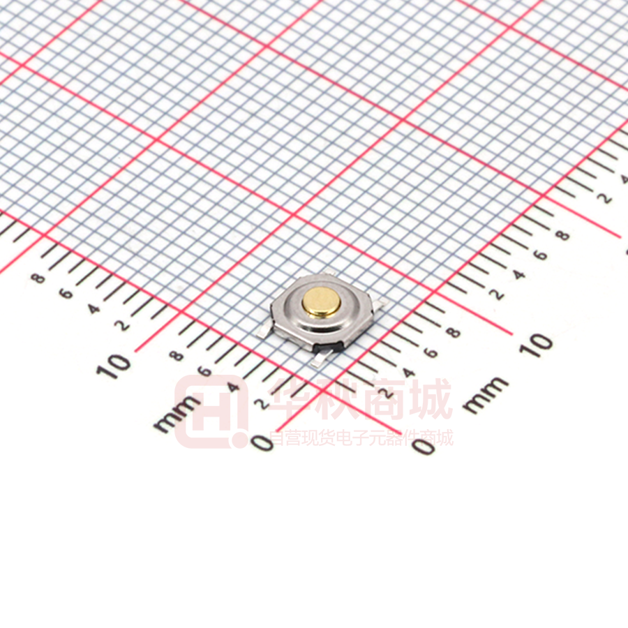

PTS525SM15SMTR2LFS 数据手册
PTS525 Series Microminiature Tact Switch for SMT Features/Benefits • 0.8 & 1.5 mm actuator height • Ruggedized package in a Typical Applications • Consumer products • Instrumentation • Remote controls compact size • High number of cycles B Process FUNCTION: Momentary action CONTACT ARRANGEMENT: 1 make contact = SPST, N.O. SOLDERING: This component is suited to the following methods: Infrared Reflow Soldering in accordance with IEC61760-1 Electrical Packaging MAXIMUM VOLTAGE: 15 VDC MAXIMUM CURRENT DC: 20 mA DIELECTRIC STRENGTH: 250 VA C (1mn) CONTACT RESISTANCE: ≤ 100 mΩ INSULATION RESISTANCE: ≥ 100 MΩ BOUNCE TIME: ≤ 10 ms Switches in reels of: 5,000 pieces in 0.8 mm height 4,000 pieces in 1.5 mm height Dimensions of reels according to EIA 481B External diameter 330 mm Environmental NOTE: OPERATING TEMPERATURE: -20˚C to 70˚C • Specifications listed above are for switches with standard options. For information on specific and custom switches, consult Customer Service Center. • The PTS series is not certified for using in Automotive application and no PPAP. However, in the case of some automotive accessories and specific applications for 2 and 3 wheeled vehicles the PTS is widely used and very suitable. Please contact your local C&K representative to discuss your application and the best switch solution. How To Order Please see chart below for full part numbers. Part Number Height (mm) Leads Shape Ground Pin Force Travel (mm) Operating Life PTS525 SM08 SMTR 2 LFS 0.8 G No 160 gf ± 50 gf 0.25 ± 0.2 1,000,000 PTS525 SK08 SMTR 2 LFS 0.8 G No 260 gf ± 50 gf 0.25 ± 0.2 200,000 PTS525 SM15 SMTR 2 LFS 1.5 G No 160 gf ± 50 gf 0.25 ± 0.2 1,000,000 PTS525 SK15 SMTR 2 LFS 1.5 G No 260 gf ± 50 gf 0.25 ± 0.2 500,000 PTS525 SMG15 SMTR 2 LFS 1.5 G Yes 160 gf ± 50 gf 0.25 ± 0.2 1,000,000 PTS525 SKG15 SMTR 2 LFS 1.5 G Yes 260 gf ± 50 gf 0.25 ± 0.2 500,000 PTS525 SMG15J SMTR 2 LFS 1.5 J Yes 160 gf ± 50 gf 0.25 ± 0.2 1,000,000 PTS525 SKG15J SMTR 2 LFS 1.5 J Yes 260 gf ± 50 gf 0.25 ± 0.2 500,000 Dimensions are shown: mm Specifications and dimensions subject to change 1 Apr 22 B–29 www.ckswitches.com Tactile Switches Specification PTS525 Series Microminiature Tact Switch for SMT 0,08 Max PTS525 SM08 SMTR2 LFS PTS525 SK08 SMTR2 LFS 2 1 5,8 6,4 4 3 SCHEMATIC 8 4,8 4 0,85 PTS525 SM15 SMTR2 LFS PTS525 SK15 SMTR2 LFS 1 2 3 4 4,8 2,8 0,5 3 5 2,6 2 5,2 1 3,7 ± 0,1 0,1 5,2 2,8 DIA. 3 RECOMMENDED PCB LAYOUT Ø 2 2 1,5+0,1 0 1 6,4 4 3 SCHEMATIC 0,5 8 4,8 3 1 2 3 4 2,8 4 4,8 2,6 5,1 2 3,7± 0,05 1 2,6 5,1 RECOMMENDED PCB LAYOUT PTS525 SMG15 SMTR2 LFS PTS525 SKG15 SMTR2 LFS 5,8 Ø2 6 2 1,2 1,5 1 0,8 3 SCHEMATIC 8 5,8 4,6 3 6 6,4 3 6 1 4 SEE DETAIL B 5,6 4,7 2 4,8 2,8 4,9 3,7 ` 0,1 2 0,5 1 0,1 5,1 2,6 4 5 4 3 5 0,05 DETAIL B SCALE 20 1,6 0,8 (5,4) 5,1 2,6 Tactile Switches B Prohibited area for run 5 1,4 RECOMMENDED PCB LAYOUT Dimensions are shown: mm Specifications and dimensions subject to change 1 Apr 22 B–30 www.ckswitches.com PTS525 Series Microminiature Tact Switch for SMT PTS525 SMG15J SMTR2 LFS PTS525 SKG15J SMTR2 LFS 1 1,5` 0,2 0,8 1,1 Ø2 6 3 2 B 4 5 SCHEMATIC Tactile Switches 5,4 5,2 3,4 4,9 6 1 1 2 3 4,6 5,6 3 4,4 2 3,7 4,9 5,2 0,5 6 4 3 4 5 0,7 5 RECOMMENDED PCB LAYOUT TAPE & REEL 0.8 mm height Cover tape (Polyester) 5,000 pieces per reel Reel (Polystyrene) Carrier tape (Polystyrene) Cover tape CARRIER TAPE 14 Max +2 10 0 8 12` 0,3 2 5,5 n 1,5 1,75 4 NOTE: n 330 n 13` 0,5 2` 0,5 n 21` 0,8 SEE DETAIL A REEL DETAIL A SCALE 0,5 Dimensions are shown: mm Specifications and dimensions subject to change 1 Apr 22 B–31 www.ckswitches.com PTS525 Series Microminiature Tact Switch for SMT TAPE & REEL 1.5 mm height 4,000 pieces per reel Cover tape (Polyester) Tactile Switches B Reel (Polystyrene) Carrier tape (Polystyrene) Cover tape CARRIER TAPE 14 Max 10+2 0 12` 0,3 2 5,5 n 1,5 1,75 4 8 n 330 n 13` 0,5 2` 0,5 n 21` 0,8 SEE DETAIL A REEL DETAIL A SCALE 0,5 Dimensions are shown: mm Specifications and dimensions subject to change 1 Apr 22 B–32 www.ckswitches.com
