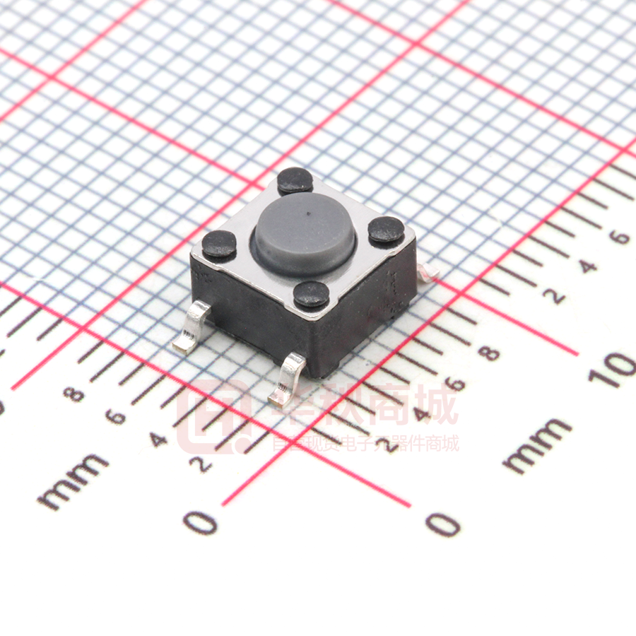

PTS645SH43SMTR92LFS 数据手册
PTS645 Series 6 mm Tact Switches Features/Benefits • Compact size 6 x 6 mm • Variety of actuator lengths • Choice of actuation force • RoHS compliant and compatible Typical Applications • Consumer products • Instrumentation • Computer products • Industrial B Process FUNCTION: Momentary action CONTACT ARRANGEMENT: SPST, N.O. TERMINALS: PC pins SOLDERING: Preheating to 100˚C for 45 sec. max. Keep flux flush with top surface of PCB; do not apply to component side of PCB and area where terminals are located. Soldering to 255˚C for 5 sec. max. Clean by brushing on solder surface. Do not clean switch with solvents. Mechanical LIFE EXPECTANCY: 100,000 operations. Packaging Electrical Bulk packaging CONTACT RATING: 50 mA @ 12 V DC. DIELECTRIC STRENGTH: 250 V AC min. CONTACT RESISTANCE: 100 mΩ max. initial. INSULATION RESISTANCE: 1011 Ω min. Tape & reel for the SMT type: Reels of 1,000 pieces for 4.3 and 5.0 mm height Reels of 700 pieces for 7.0 mm height Reels of 700 pieces for 7.3 mm height Reels of 500 pieces for 9.5 mm height Reels of 400 pieces for 13.0 mm height Environmental OPERATING TEMPERATURE: -40˚C to 85˚C STORAGE TEMPERATURE: -40˚C to 85˚C NOTE: • Specifications listed above are for switches with standard options. For information on specific and custom switches, consult Customer Service Center. • The PTS series is not certified for using in Automotive application and no PPAP. However, in the case of some automotive accessories and specific applications for 2 and 3 wheeled vehicles the PTS is widely used and very suitable. Please contact your local C&K representative to discuss your application and the best switch solution. How To Order Our easy build-a-switch concept allows you to mix and match options to create the switch you need. To order, select desired option from each category and and place it in the appropriate box. P T S 6 4 L 5 Termination S Straight T Straight with ESD pin V Vertical THT Actuator Shape NONE Round actuator, All versions J Square actuator, 2.4 mm side (available for Straight 7.3 mm and Vertical 6.15 mm) Actuation Force N 100 gf L 130 gf M 160 gf H 200 gf K 260 gf P 320 gf *Only the straight type termination without ESD pin is available in SMT type * Long life version has to be created case by case as special part number F S Insertion Type 2 Thru hole SMTR92* Surface mount G-type, tape & reel JSMTR92* Surface mount J-type, tape & reel RoHS compliant and compatible. Silver plated. Switch height from PCB for S and T only (H dimension see actuator height drawings) 43 4.3 (.169), thru-hole and SMT 50 5.0 (.197), thru-hole and SMT 70 7.0 (.275), thru-hole and SMT 73 7.3 (.287), thru-hole and SMT, square actuator 2.4 mm side only 95 9.5 (.374), thru-hole and SMT 13 13.0 (.512) SMT only 11 11.0 (.433) SMT only Switch length from front leads for V only (H dimension see actuator height drawings) 31 3.15 (.124), vertical 39 3.85 (.151), vertical 58 5.85 (.230), vertical 61 6.15 (.242), vertical, square actuator 2.4 mm side only 83 8.35 (.329), vertical Dimensions are shown: mm Specifications and dimensions subject to change 14 Apr 22 B–141 www.ckswitches.com Tactile Switches Specification PTS645 Series 6 mm Tact Switches TERMINATION 1 2 3 4 3,45 0,7 6,5 7,9 PCB LAYOUT 6 1 4 3 2 4,5 4,5 0,7 ± 0,1 2 6 1 4x Ø 1 4 3 6,5 Ø 3,5 STRAIGHT WITH ESD PIN 3,45 1,8 2 3 4 3,0 1 0,7 0,3 0,7 SCHEMATIC 4,3 ± 0,1 0,5 Max T 6,5 7,9 PCB LAYOUT 4 ± 0,1 4 3 4,1 4,5 4,5 2 2 4,1 0,3 1 6 1 5 5 0,7± 0,1 6 1,5 4x Ø 1 3 4 6,5  Ø 3,5 VERTICAL THT SCHEMATIC Push 2 1 2,55 ± 0,05 7,5 2x Ø 1,3 4,5± 0,05 4,05 6,2 Ø 3,5 2 1 0,7 4,5 ± 0,15 7±0,05 3,95 4,3 V 4,95 Tactile Switches B SCHEMATIC 3,0 1,8 0,3 4,3 ± 0,1 STRAIGHT 0,5 Max S 2x Ø 1 0,3 1 4,2 PCB LAYOUT 2,55± 0,1 3,9± 0,1 7 8,5 Dimensions are shown: mm Specifications and dimensions subject to change 14 Apr 22 B–142 www.ckswitches.com PTS645 Series 6 mm Tact Switches TERMINATION SMT G Type (0,3) 9,5 6,4 3 4 2 3 4 3,2 2 5,8 3,45 9 1 1 PCB LAYOUT 3 4 6 2 4,5 1 0,7± 0,1 6 Ø 3,5 SMT J Type PCB LAYOUT Dimensions are shown: mm Specifications and dimensions subject to change 14 Apr 22 B–143 B Tactile Switches 0 0,3 -0,02 4,3 ±0,1 SCHEMATIC www.ckswitches.com PTS645 Series 6 mm Tact Switches ACTUATOR SHAPE J SQUARE ACTUATOR VERTICAL THT - FOR 6.15MM LENGTH ONLY Ø 3,5 3,85 B SCHEMATIC Push 2 1 2,55 ±0,05 7,5 4,3 4x Ø 0,9 2x Ø 1,3 4,5 ±0,05 0,4 2 1 7 ± 0,05 3,95 4,3 4,95 4,05 4,3 2,4 6,2 Ø 3,5 2x Ø 1 0,3 1 0,7 4,2 4,5 6,2 2,55 ±0,1 RECOMMENDED PCB LAYOUT 6,2 7 ± 0,2 8,5 ±0,2 STRAIGHT THT - FOR 7.3MM HEIGHT ONLY SCHEMATIC 1 2 3 4 3,0 0,3 Max 7,3 1,4 1,6 3,85 1,8 2,4 0,3 6,5 7,9 6 4,3 RECOMMENDED PCB LAYOUT 2 4,5 2,4 6 4,3 2 0,7 ± 0,1 1 1 4,5 Tactile Switches 1,4 1,8 2,4 4x Ø 1 4 3 4 3 Ø 1,15 6,5 Ø 3,5 Dimensions are shown: mm Specifications and dimensions subject to change 14 Apr 22 B–144 www.ckswitches.com PTS645 Series 6 mm Tact Switches ACTUATOR SHAPE STRAIGHT SMT G TYPE - FOR 7.3MM HEIGHT ONLY 1,8 2,4 SCHEMATIC 0,05 0 0,3-0,02 1 2 3 4 B Tactile Switches 3,45 7,3 0,1 1,4 (0,3) 1,6 RECOMMANDED PCB LAYOUT 9 0,2 9,5 6 1 2 3 4 3,2 4 5,8 3 6 2 4,5 1 0,7 0,1 6,4 STRAIGHT SMT J TYPE - FOR 7.3MM HEIGHT ONLY Dimensions are shown: mm Specifications and dimensions subject to change 14 Apr 22 B–145 www.ckswitches.com PTS645 Series 6 mm Tact Switches ACTUATOR SHAPE STRAIGHT SMT - FOR 7.3MM HEIGHT ONLY B SCHEMATIC 0 0,3-0,02 0,05 3,45 7,3 0,1 1,4 (0,3) 1,6 1 2 3 4 RECOMMANDED PCB LAYOUT 9 0,2 9,5 6 4 1 2 3 4 3,2 3 5,8 2 6 1 0,7 0,1 6,4 4,5 Tactile Switches 1,8 2,4 Dimensions are shown: mm Specifications and dimensions subject to change 14 Apr 22 B–146 www.ckswitches.com PTS645 Series 6 mm Tact Switches ACTUATION FORCE OPTION CODE B FORCE L M H K 130 grams Black 160 grams Blue 200 grams Gray 260 grams Red B Tactile Switches ACTUATOR HEIGHT Switch height from PCB for S and T only OPTION SCHEMATIC CODE DIMENSION H TERMINATION Without EMC pin With EMC pin (0,3) H ± 0.1 3,45 0 0,3-0,02 43 50 70 95 13 4,3 (.169) 5,0 (.197) Thru-hole and SMT Thru-hole and SMT 1 2 7,0 (.275) Thru-hole and SMT 3 4 9,5 (.374) Thru-hole and SMT 13,0 (.512) SMT 1 2 3 4 4,05 Switch length from front leads for V only OPTION SCHEMATIC CODE DIMENSION H TERMINATION Without EMC pin With EMC pin 3,95 0,3 Vertical Vertical 5,85 (.230) Vertical 8,35 (.329) Vertical 1 3 2,55± 0,1 H ± 0,1 TAPE & REEL FOR SMT G TYPE VERSIONS Cover tape (Polyester) Carrier tape (Polystyrene) H 2±0,1 OPTION CODE 16±0,3 4±0,1 7,4 1,5+0,1 0 1,75±0,1 Reel (Polystyrene) 13 Cover tape POCKET HEIGHT 16 ± 0.3 16 ± 0.3 5.3 5.3 16 ± 0.3 7.3 16 ± 0.3 7.6 24 ± 0.3 10.3 24 ± 0.3 13.3 2 0,1 24 0,3 4 0,1 1,5+0,1 0 43 50 70 73 95 13 WIDTH TAPE 1,75 0,1 12±0,1 10,25 4,2 3,15 (.124) 3,85 (.151) 20 Cover tape 1 31 39 58 83 Dimensions are shown: mm Specifications and dimensions subject to change 12 0,1 14 Apr 22 B–147 www.ckswitches.com PTS645 Series 6 mm Tact Switches TAPE & REEL FOR SMT J TYPE VERSIONS ~ Tactile Switches B Dimensions are shown: mm Specifications and dimensions subject to change 14 Apr 22 B–148 www.ckswitches.com
PTS645SH43SMTR92LFS
物料型号:PTS645 Series
器件简介:PTS645系列提供了6毫米x 6毫米的紧凑尺寸,多种执行器长度选择,以及不同的操作力度。这些开关符合RoHS标准,兼容且具有银镀层。
引脚分配:文档中提到了PC pin作为接触终端的配置,具体为SPST, N.O.(单极单掷,常开)。
参数特性: - 机械寿命:100,000次操作 - 电气特性:接触额定值50 mA @ 12 V DC,介质耐压至少250 V AC,接触电阻最大100 mΩ,绝缘电阻至少10^11 Ω - 环境温度:操作温度范围-40˚C至85˚C,存储温度范围相同
功能详解:文档详细描述了不同高度和形状的执行器选项,以及它们的操作力度和PCB布局要求。
应用信息:适用于消费产品、仪器仪表、计算机产品和工业产品。
封装信息:提供了散装包装和SMT类型(带胶带和卷轴)的包装信息,包括卷轴上不同高度的开关数量。
注意:PTS系列未认证用于汽车应用,没有PPAP(生产部件批准流程)。但对于某些汽车配件和2轮或3轮车辆的特定应用,PTS系列被广泛使用且非常适合。如需订购,可以根据需要选择不同类别的选项。
