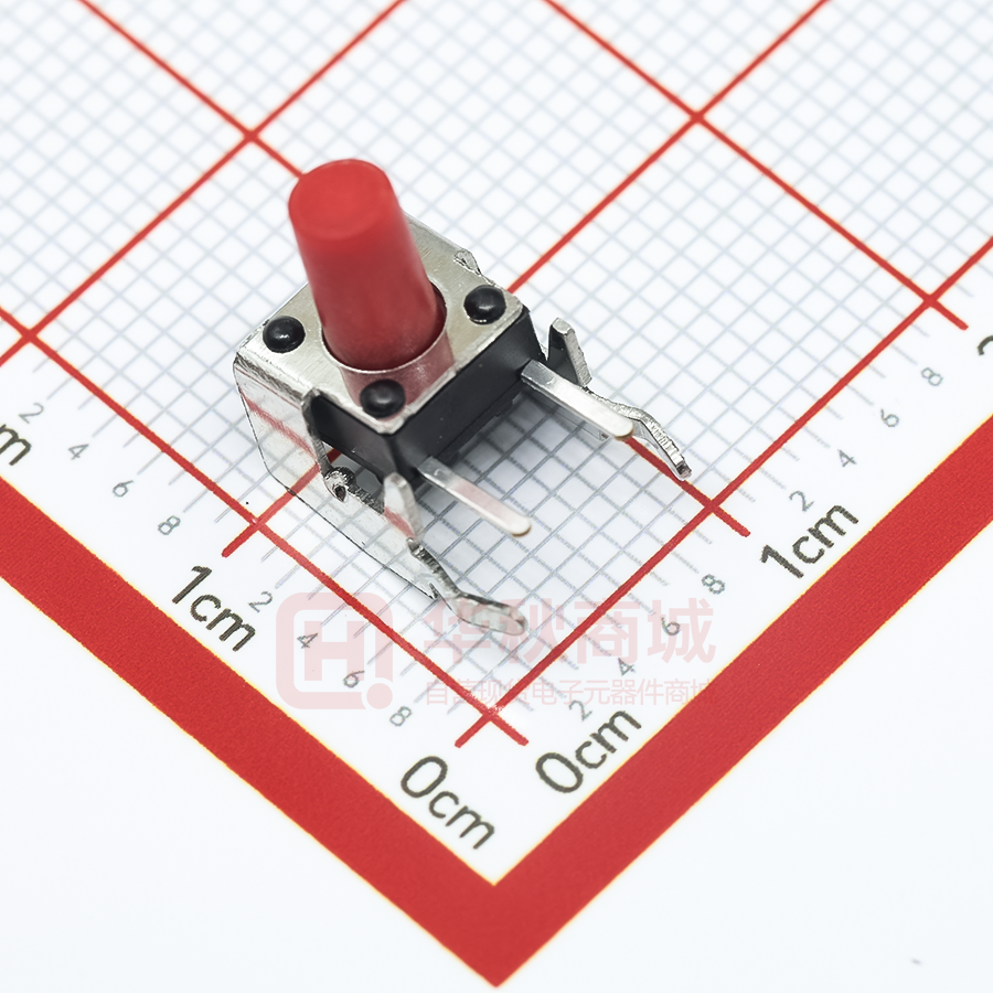

    轻触开关 直插
PTS645VK83-2 LFS 数据手册
PTS645 Series 6 mm Tact Switches Features/Benefits • Compact size 6 x 6 mm • Variety of actuator lengths • Choice of actuation force • RoHS compliant and compatible Typical Applications • Consumer products • Instrumentation • Computer products • Industrial Tactile Switches B Specification Process FUNCTION: Momentary action CONTACT ARRANGEMENT: SPST, N.O. TERMINALS: PC pins SOLDERING: Preheating to 100˚C for 45 sec. max. Keep flux flush with top surface of PCB; do not apply to component side of PCB and area where terminals are located. Soldering to 255˚C for 5 sec. max. Clean by brushing on solder surface. Do not clean switch with solvents. Mechanical ACTUATION FORCE: 130 grams, 160 grams, 200 grams, 260 grams LIFE EXPECTANCY: 100,000 operations. Electrical CONTACT RATING: 50 mA @ 12 V DC. DIELECTRIC STRENGTH: 250 V AC min. CONTACT RESISTANCE: 100 mΩ max. initial. INSULATION RESISTANCE: 1011 Ω min. Environmental OPERATING TEMPERATURE: -40˚C to 85˚C STORAGE TEMPERATURE: -40˚C to 85˚C Packaging Bulk packaging Tape & reel for the SMT type: Reels of 1,000 pieces for 4.3 and 5.0 mm height Reels of 700 pieces for 7.0 mm height Reels of 700 pieces for 7.3 mm height Reels of 500 pieces for 9.5 mm height Reels of 400 pieces for 13.0 mm height NOTE: Specifications listed above are for switches with standard options. For information on specific and custom switches, consult Customer Service Center. How To Order Our easy build-a-switch concept allows you to mix and match options to create the switch you need. To order, select desired option from each category and and place it in the appropriate box. P T S 6 4 L 5 Termination S Straight T Straight with ESD pin V Vertical Actuator Shape NONE Round actuator, All versions J Square actuator, 2.4 mm side (available for Straight 7.3 mm and Vertical 6.15 mm) Actuation Force L 130 grams M 160 grams H 200 grams K 260 grams *Only the straight type termination without ESD pin is available in SMT type. F S Insertion Type 2 Thru hole SMTR92* Surface mount G-type, tape & reel JSMTR92* Surface mount J-type, tape & reel RoHS compliant and compatible. Silver plated. Switch height from PCB for S and T only (H dimension see actuator height drawings) 43 4.3 (.169), thru-hole and SMT 50 5.0 (.197), thru-hole and SMT 70 7.0 (.275), thru-hole and SMT 73 7.3 (.287), thru-hole and SMT, square actuator 2.4 mm side only 95 9.5 (.374), thru-hole and SMT 13 13.0 (.512) SMT only Switch length from front leads for V only (H dimension see actuator height drawings) 31 3.15 (.124), vertical 39 3.85 (.151), vertical 58 5.85 (.230), vertical 61 6.15 (.242), vertical, square actuator 2.4 mm side only 83 8.35 (.329), vertical Dimensions are shown: mm Specifications and dimensions subject to change 7 Apr 21 B–136 www.ckswitches.com PTS645 Series 6 mm Tact Switches TERMINATION 3,45 SCHEMATIC 1 2 3 4 3,5 1,8 0,7 0,3 4,3 ± 0,1 STRAIGHT 0,5 Max S B 6,5 7,9 1 4 3 2 4,5 4,5 0,7 ± 0,1 2 6 1 4x Ø 1 4 3 6,5 Ø 3,5 STRAIGHT WITH ESD PIN 3,45 1,8 3,5 1 2 3 4 0,7 0,3 0,7 SCHEMATIC 4,3 ± 0,1 0,5 Max T Tactile Switches PCB LAYOUT 6 6,5 7,9 PCB LAYOUT 4 ± 0,1 4 3 2 4,5 4,1 1 4,1 0,3 4,5 2 6 1 5 5 0,7± 0,1 6 1,5 4x Ø 1 3 4 6,5 Ø 3,5 VERTICAL SCHEMATIC Push 2 1 2,55 ± 0,05 7,5 2x Ø 1,3 4,5± 0,05 2 1 7±0,05 3,95 4,3 4,05 6,2 Ø 3,5 4,95 V 2x Ø 1 0,3 1 0,7 4,5 ± 0,15 4,2 PCB LAYOUT 2,55± 0,1 3,9± 0,1 7 8,5 Dimensions are shown: mm Specifications and dimensions subject to change 7 Apr 21 B–137 www.ckswitches.com PTS645 Series 6 mm Tact Switches TERMINATION SMT G Type (0,3) 9,5 6,4 2 3 4 1 2 3 4 3,2 1 5,8 4,3 ±0,1 3,45 0 0,3 -0,02 9 PCB LAYOUT 2 3 4 6 1 0,7± 0,1 6 4,5 Tactile Switches B SCHEMATIC Ø 3,5 SMT J Type PCB LAYOUT Dimensions are shown: mm Specifications and dimensions subject to change 7 Apr 21 B–138 www.ckswitches.com PTS645 Series 6 mm Tact Switches ACTUATOR SHAPE J SQUARE ACTUATOR VERTICAL THT - FOR 6.15MM LENGTH ONLY Ø 3,5 3,85 1,4 1,8 2,4 B Push 2 1 2,55 ±0,05 7,5 4,3 4x Ø 0,9 2x Ø 1,3 4,5 ±0,05 0,4 2 1 7 ± 0,05 3,95 4,3 4,95 4,05 4,3 2,4 6,2 Ø 3,5 2x Ø 1 0,3 1 0,7 4,2 4,5 6,2 2,55 ±0,1 RECOMMENDED PCB LAYOUT 6,2 7 ± 0,2 8,5 ±0,2 VERTICAL THT - FOR 7.3MM HEIGHT ONLY 1,8 SCHEMATIC 1 2 3 4 3,5 0,3 Max 7,3 1,4 1,6 3,85 2,4 0,3 6,5 7,9 6 4,3 RECOMMENDED PCB LAYOUT 2 4,5 2,4 6 4,3 4,5 2 0,7± 0,1 1 1 4x Ø1 4 3 4 3 Ø 1,15 6,5 Ø 3,5 Dimensions are shown: mm Specifications and dimensions subject to change 7 Apr 21 B–139 www.ckswitches.com Tactile Switches SCHEMATIC PTS645 Series 6 mm Tact Switches ACTUATOR SHAPE STRAIGHT SMT G TYPE - FOR 7.3MM HEIGHT ONLY 1,8 2,4 SCHEMATIC 0 0,3-0,02 0,05 3,45 7,3 0,1 1,4 (0,3) B 1 2 3 4 RECOMMANDED PCB LAYOUT 9 0,2 9,5 6 4 1 2 3 4 3,2 3 5,8 2 6 1 0,7 0,1 6,4 4,5 Tactile Switches 1,6 STRAIGHT SMT J TYPE - FOR 7.3MM HEIGHT ONLY Dimensions are shown: mm Specifications and dimensions subject to change 7 Apr 21 B–140 www.ckswitches.com PTS645 Series 6 mm Tact Switches ACTUATOR SHAPE VERTICAL THT - FOR 7.3MM HEIGHT ONLY 1,8 SCHEMATIC 2 3 4 B Tactile Switches 1 3,5 0,3 Max 7,3 1,4 1,6 3,85 2,4 0,3 6,5 7,9 6 4,3 RECOMMENDED PCB LAYOUT 2 4,5 2,4 6 4,3 4,5 2 0,7± 0,1 1 1 4x Ø1 4 3 4 3 Ø 1,15 6,5 Ø 3,5 STRAIGHT SMT - FOR 7.3MM HEIGHT ONLY 1,8 2,4 SCHEMATIC 0 0,3-0,02 0,05 3,45 7,3 0,1 1,4 (0,3) 1,6 1 2 3 4 RECOMMANDED PCB LAYOUT 9 0,2 9,5 6 1 2 3 4 3,2 4 5,8 3 6 2 4,5 1 0,7 0,1 6,4 Dimensions are shown: mm Specifications and dimensions subject to change 7 Apr 21 B–141 www.ckswitches.com PTS645 Series 6 mm Tact Switches ACTUATION FORCE OPTION CODE B B FORCE L M H K 130 grams Black 160 grams Blue 200 grams Gray 260 grams Red Tactile Switches ACTUATOR HEIGHT Switch height from PCB for S and T only OPTION SCHEMATIC CODE DIMENSION H TERMINATION Without EMC pin With EMC pin (0,3) H ± 0.1 3,45 0 0,3-0,02 43 50 70 95 13 4,3 (.169) 5,0 (.197) Thru-hole and SMT Thru-hole and SMT 1 2 7,0 (.275) Thru-hole and SMT 3 4 9,5 (.374) Thru-hole and SMT 13,0 (.512) SMT 1 2 3 4 4,05 Switch length from front leads for V only OPTION SCHEMATIC CODE DIMENSION H TERMINATION Without EMC pin With EMC pin 3,95 0,3 Vertical Vertical 5,85 (.230) Vertical 8,35 (.329) Vertical 1 3 2,55± 0,1 H ± 0,1 TAPE & REEL FOR SMT G TYPE VERSIONS Cover tape (Polyester) Carrier tape (Polystyrene) H 2±0,1 OPTION CODE 16±0,3 4±0,1 7,4 1,5+0,1 0 1,75±0,1 Reel (Polystyrene) 13 Cover tape POCKET HEIGHT 16 ± 0.3 16 ± 0.3 5.3 5.3 16 ± 0.3 7.3 16 ± 0.3 7.6 24 ± 0.3 10.3 24 ± 0.3 13.3 2 0,1 24 0,3 4 0,1 1,5+0,1 0 43 50 70 73 95 13 WIDTH TAPE 1,75 0,1 12±0,1 10,25 4,2 3,15 (.124) 3,85 (.151) 20 Cover tape 1 31 39 58 83 Dimensions are shown: mm Specifications and dimensions subject to change 12 0,1 7 Apr 21 B–142 www.ckswitches.com PTS645 Series 6 mm Tact Switches TAPE & REEL FOR SMT J TYPE VERSIONS B ~ Tactile Switches Dimensions are shown: mm Specifications and dimensions subject to change 7 Apr 21 B–143 www.ckswitches.com
