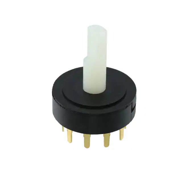

R Series ROTA-SLIDE® Rotary Switches Features/Benefits • Multi-pole and multi-position • Positive detent • Panel and PCB mounting • Enclosed • RoHS Compliant Typical Applications • Ceiling fans • Industrial equipment • Portable tools Models Available Specifications Materials CONTACT RATING: Q contact material: 5 AMPS @ 125 V AC; 2.5 AMPS @ 250 V AC; 0.5 AMP @ 125 V DC; 1/8 HP @ 125 and 250 VAC (UL/CSA). See page K-20 for additional ratings. ELECTRICAL LIFE: 10,000 make-and-break cycles at full load. CONTACT RESISTANCE: Below 10 m Ω typ. initial @ 2-4 V DC, 100 mA, for both silver and gold plated contacts. INSULATION RESISTANCE: 109 Ω min. DIELECTRIC STRENGTH: 1,000 Vrms min. @ sea level. INDEXING: 36º-one contact models, 10 position max.; two contact models, 5 position max. OPERATING & STORAGE TEMPERATURE: -30ºC to 95ºC HOUSING & BUSHING: 6/6 nylon (UL 94V-2). ACTUATOR: 6/6 nylon (UL 94V-2). CONTACTS & TERMINALS: Q contact material: Copper, silver plated. See page K-20 for additional contact materials. CONTACT SPRING: Music wire or stainless steel. MOUNTING NUT: Steel, zinc plated. TERMINAL SEAL: Epoxy. NOTE: Any models supplied with Q or B contact material are RoHS compliant. NOTE: Specifications and materials listed above are for switches with standard options. For information on specific and custom switches, consult Custome Service Center. Build-A-Switch To order, simply select desired option from each category and place in the appropriate box. Available options are shown and described on pages K-19 and K-20. For additional options not shown in catalog, consult Customer Service Center. Rotary K Switch Function R100 SP, 36° Index, 10 pos. no stops R103 SP, 36° Index, 3 pos. R104 SP, 36° Index, 4 pos. R108 SP, 36° Index, 8 pos. R203 DP, 36° Index, 3 pos. R204 DP, 36° Index, 4 pos. R205 DP, 36° Index, 5 pos. Actuator 07 .500” high with .156” flat 05 .375” high with .156” flat 15 Screwdriver slot without bushing Mounting Style RR 3/8-32 threaded bushing RN PC without bushing RS PC without bushing Terminations 03 Solder lug with hole 01 Solder lug with notch 02 PC Thru-hole WC Wire Lead Contact Material Q Silver B Gold Seal NONE No seal E Epoxy seal Dimensions are shown: Inch (mm) Specifications and dimensions subject to change K–18 www.ckswitches.com R Series ROTA-SLIDE Rotary Switches ® SWITCH FUNCTION SP MODELS 36º INDEXING NO. POLES SP MODELS 36º INDEXING SCHEMATIC MODEL NO. SWITCH FUNCTION R100 10 Position No Stops All Terminals R103 3 Position 10-1-2-3 R104 4 Position 10-1-2-3-4 R108 8 Position 10-1-2-3-4-5-6-7-8 NO. POLES TERMINALS DP SP All models with all options when ordered with ‘Q’ contact material. DP MODELS 36º INDEXING MODEL NO. SWITCH FUNCTION R203 3 Position 10-1-2-3,5-6-7-8 R204 4 Position All Terminals R205 5 Position All Terminals TERMINALS DP MODELS 36º INDEXING SCHEMATIC NOTE: Break-before-make contacts. Actuators and contacts are shown in position 1. No common terminal is present. Switching function is provided by movable contacts shorting adjacent pairs of stationary contacts. K Rotary Part number show: R10007RR03Q ACTUATOR 07  .50019” HIGH WITH .156” FLAT Shown with ‘RR’ mounting style. For mounting styles without bushing, add .250 (6,35) to actuator length. 05  .375”19 HIGH WITH .156” FLAT Shown with ‘RN’ mounting style. 15  SCREWDRIVER SLOT Arrow on actuator marked red (std.). Shown with ‘RS’ mounting style. Third Angle Projection Dimensions are shown: Inch (mm) Specifications and dimensions subject to change K–19 www.ckswitches.com R Series ROTA-SLIDE® Rotary Switches MOUNTING STYLE RR  3/8-32 THREADED BUSHING RN  PC WITHOUT BUSHING RS PC SCREWDRIVER SLOT WITHOUT BUSHING PANEL MOUNTING Position numbers and characters are molded on housing. Mounting nut included (part number 175000100). TERMINATIONS 03 SOLDER LUG WITH HOLE 01 SOLDER LUG WITH NOTCH 02 PC THRU-HOLE WC WIRE LEAD PC MOUNTING 22 AWG INSULATED WIRE 6.00 (152,4) .50 (12,7) K Rotary CONTACT MATERIAL OPTION CODE CONTACT AND TERMINAL MATERIAL Q SILVER 2 B GOLD 1 RATING 5 AMPS @ 125 V AC; 2.5 AMPS @ 250 V AC; 0.5 AMP @ 125 V DC (UL/CSA); 1/8 HP @ 125 and 250 VAC (UL/CSA). POWER LOW LEVEL/DRY CIRCUIT 0.4 VA MAX. @ 20 V AC or DC MAX. * Note: See Technical Data section of this catalog for RoHS compliant and compatible definition and specifications. 1 2 CONTACTS & TERMINALS: Copper, with gold plate over nickel plate. CONTACTS & TERMINALS: Copper, silver plated. (Standard with all termination options.) NOTE: Any models supplied with Q, B or G contact material are RoHS compliant. All models with all options when ordered with ‘Q’ contact material. SEAL NONE  NO SEAL E  EPOXY SEAL Third Angle Projection Dimensions are shown: Inch (mm) Specifications and dimensions subject to change K–20 www.ckswitches.com
