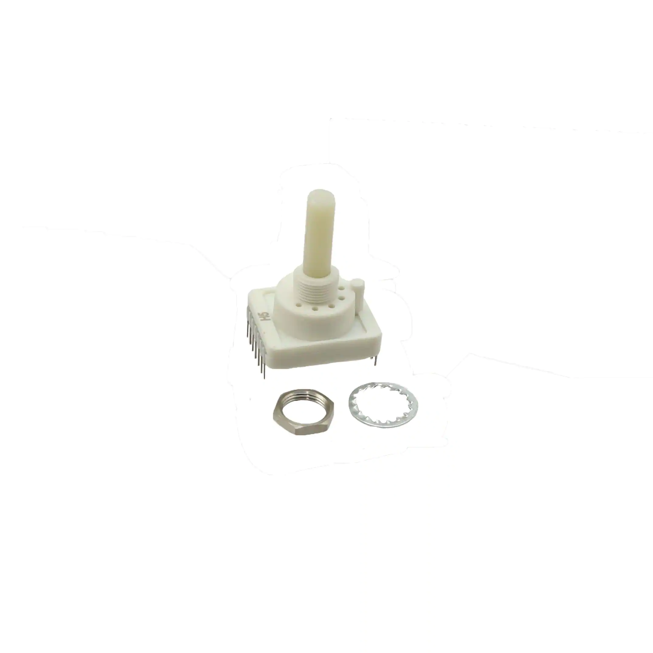

RTA Series 1–4 Poles Coded Rotary Switches Features/Benefits • PCB or hand soldering versions • Bushing mounting • Multiple poles • Decimal and hexadecimal codes • Screwdriver slot or extended actuator • RoHS Compliant Electrical Data Silver Mechanical Data Gold SWITCHING MODE: BBM MAX. SWITCHING POWER 5 VA MAX. SWITCHING CURRENT: 150 mA 5A MAX. CARRYING CURRENT: NOMINAL VOLTAGE AT 50 Hz 60 V CONTACT RESISTANCE: < 150 mΩ DIELECTRIC STRENGTH AT 50 Hz BETWEEN CONTACTS AND GROUND TERMINALS: 500 V r INSULATION RESISTANCE BETWEEN CONTACTS OR CONTACTS AND FRAME (500 V =): 109 Ω NO. OF OPERATIONS: 10,000 BOUNCE: < 5 ms BBM 0.5 VA 20 mA 1A 25 V < 150 mΩ MAX. NO. OF BANKS: 1. OPERATING TORQUE: 5 Ncm±20%. END STOP TORQUE: < 60 Ncm. STOP: With/without or adjustable MOUNTING: By fixed index 9.5 mm (0.374) of center, for bushing mount only Materials 500 V r BUSHING/HOUSING: PETP Thermoplastic STATIONARY CONTACTS & TERMINALS: Nickel Plated Brass with additional plating of Gold or Silver. ROTOR: Gold or Silver plated Brass or PCB. CODING PLATE: PA thermoplastic ACTUATOR: Polysulfon thermoplastic HARDWARE: Stop pin: Aluminum. Ball & Spring: Stainless steel. Washer: PA. Nut: Brass. 109 Ω 10,000 < 5 ms Environmental Data K OPERATING TEMPERATURE: –20ºC to + 70ºC –20ºC to + 70ºC STORAGE TEMPERATURE: –40ºC to + 85ºC –40ºC to + 85ºC Typical Applications • Appliances • Electronic alarm systems • Medical • Building automation • HVAC air conditioning NOTE: Specifications and materials listed above are for switches with standard options. For information on specific and custom switches, consult Customer Service Center. Rotary Build-A-Switch To order, simply select desired option from each category and place in the appropriate box. Available options are shown and described on pages K-9 thru K-12. For additional options not shown in catalog, consult Customer Service Center. Designation RTA Indexing 2 22.5 index (coded only) 3 30° index (12 positions max.) 4 36° index (10 positions max.) Termination P With PC Thru-hole Switch Function H Horizontal with 1W12 SP, 30° Index, 12 pos. no stop PC Thru-hole 1W10 SP, 36° Index, 10 pos. no stop 1S02 SP, 30° /36° Index, 2 pos. 1S03 SP, 30° /36° Index, 3 pos. 1S04 SP, 30° /36° Index, 4 pos. 1S05 SP, 30° /36° Index, 5 pos. 1S06 SP, 30° /36° Index, 6 pos. 1S07 SP, 30° /36° Index, 7 pos. 1S08 SP, 30° /36° Index, 8 pos. 1S09 SP, 30° /36° Index, 9 pos. 1S10 SP, 30° /36° Index, 10 pos. 1S11 SP, 30° Index, 11 pos. 1S12 SP, 30° Index, 12 pos. 2S02 DP, 30° /36° Index, 2 pos. 2S03 DP, 30° /36° Index, 3 pos. 2S04 DP, 30° /36° Index, 4 pos. 2S05 DP, 30° /36° Index, 5 pos. 2S06 DP, 30° Index, 6 pos. 3S02 3P, 30° /36° Index, 2 pos. Contact Material S Silver plated, matte-tin terminal P Gold plated, matte-tin terminal 3S03 4S02 EW10 3P, 30° /36° Index, 3 pos. 4P, 30° /36° Index, 2 pos. Direct + complement, 36º Index, no stop EW12 Direct + complement, 30º Index, no stop DW16 Direct, 22.5º Index, no stop ES—— Direct + complement, 30º/36º Index, with stop (specify stop position) DS—— Direct, 22.5º Index, with stop (specify stop position) Mounting Style W Without bushing R 3/8-32 Threaded Bushing M M10x.75 Metric Threaded Bushing A 3/8-32 Threaded Bushing with Offset Bracket B M10x.75 Metric Threaded Bushing with Offset Bracket Actuator (max.) 25N .984 (25,0) with screwdriver slot 50N 1.97 (50,0) with screwdriver slot FLS Flush shaft with screwdriver slot and position indicator 25F .984 (25,0) Shaft with flat 06F .236 (6,0) Shaft with flat C D 3/8-32 Threaded Bushing with Straight Bracket M10x.75 Metric Threaded Bushing with Straight Bracket Dimensions are shown: Inch (mm) Specifications and dimensions subject to change 7 nov 16 K–8 www.ck-components.com RTA Series 1-4 Poles Coded Rotary Switches DESIGNATION RTA TERMINATION P WITH PC PINS .016 (0,4) 1.016 (25,8) .600 (15,2) 1.000 (25,4) .866 (22,0) H .028 TYP. (0,7) .100 TYP. (2,5) .150 (3,8) Horizontal with PC Thru-hole Note: “H” termination only available with the following options: 1. With A or B mounting styles 2. 36º degree indexing 3. Up to 5 positions max .618 ( 15,7 ) Rotary 7X .028 ( 0,7 ) 6X .100 ( 2,54 ) .302 ( 7,67 ) .600 ( 15,24 ) INDEXING 2 22.5 index, 16 positions max. 3 30 index, 12 positions max. 4 36 index, 10 positions max. K Both commons must be connected by user to ground. Third Angle Projection Dimensions are shown: Inch (mm) Specifications and dimensions subject to change 7 nov 16 K–9 www.ck-components.com RTA Series 1-4 Poles Coded Rotary Switches SWITCH FUNCTION NO. POLES MODEL NO. SWITCH FUNCTION 1W12 30º 1W10 12 Positions No Stop 10 Positions No Stop 1S02 2 Positions 30º/36º 1S03 3 Positions 30º/36º 1S05 5 Positions 30º/36º 1S06 6 Positions 30º/36º 1S08 8 Positions 30º/36º 1S09 9 Positions 30º/36º 3P MODELS SCHEMATIC C1 C2 C3 SP MODELS SCHEMATIC INDEX C0 36º Pos. Pos. 1 1 21 31 DP MODELS SCHEMATIC C1 SP 1S11 1S12 30º/36º 10 Positions MODEL NO. 30º 11 Positions 30º 12 Positions Rotary 13 2 3 3 3 C1 Pos. 1 1 21 C2 12 2 2 C3 13 2 3 SWITCH FUNCTION MODEL NO. SWITCH FUNCTION 2W05 2W06 5 Positions No Stop 6 Positions No Stop 2S02 2 Positions 30º/36º 2S03 3 Positions 30º/36º 2S04 4 Positions 30º/36º 2S05 5 Positions 30º/36º 2S06 6 Positions 30º 3S02 2 Positions 30º/36º 3S03 3 Positions 30º/36º 4S02 2 Positions 30º/36º INDEX 30º/36º 30º DP C4 3P 14 2 4 INDEX 4P 36º Direct + complement, No stop EW10 EW12 Direct + complement, No stop 30º DW16 Direct, No stop 22.5º ES—— DS—— K 12 22 32 4P MODELS SCHEMATIC C2 Pos. 11 21 31 41 51 61 12 22 32 42 52 62 1S10 NO. POLES Direct + complement, with stop (specify stop position) 30º & 36º 22.5º Direct, with stop (specify stop position) 22.5º 30º 36º Term. Term. Term. Pos. 1 2 3 4 5 6 7 8 9 10 11 12 13 14 15 16 E,J M,N L,N C • • • • • • • • • • • • • • • • • • • • • • • • • • • • F,I H D 1 D,K D B 2 A,N A I 4 B J J 8 — C K 1 • — K H 2 • • — B A 4 • • • • — I C 8 • • • • Indexing Option Code 2, 22.5 INDEXING ANGLE PCB LAYOUT • • • • • • • • • • • • • • • • • • • • • • • • • • • • • • • • • • • • • • • Indexing Option Code 3, 30 INDEXING ANGLE PCB LAYOUT 1 POLE BCD ONLY • • 2 POLES 3 POLES 4 POLES BCD + COMPLEMENTS Indexing Option Code 4, 36 INDEXING ANGLE PCB LAYOUT NOTE: Layout view from component side. Common terminals that are in locations A-G are not connected to common terminals that are in locations H-N. For 7-12 position output customer must tie these commons together. 1 POLE 2 POLES 3 POLES 4 POLES BCD + COMPLEMENTS Third Angle Projection Dimensions are shown: Inch (mm) Specifications and dimensions subject to change 7 nov 16 K–10 www.ck-components.com RTA Series 1-4 Poles Coded Rotary Switches MOUNTING STYLE W M WITHOUT BUSHING M10 x .75 MERTIC THREADED BUSHING .60 ( 15,2 ) .60 ( 15,2 ) 14X ø.04 ( 0,9 ) 6X .10 ( 2,5 ) N ML K J I H 14X ø.04 ( 0,9 ) 6X .10 ( 2,5 ) .495 (12,6) 1.00 ( 25,4 ) .732 (18,6) Note: M mounting style not available with H termination. A 3/8-32 THREADED BUSHING 3/8-32 THREADED BUSHING WITH BRACKET PANEL MOUNTING .385 DIA (9.8 Ø) .874 ( 22,2 ) PANEL MOUNTING .134 (3.4Ø) .338 ( 8,59 ) .385 DIA (9.8 Ø) .374 (9.5) 3/8 - 32 UNEF .338 ( 8,59 ) .618 ( 15,7 ) .19 ( 4,8 ) .60 ( 15,2 ) .60 ( 15,2 ) .874 ( 22,2 ) 14X ø.04 ( 0,9 ) 7X ø.04 ( 0,9 ) 1.00 ( 25,4 ) .071 ( 1,8 ) 2X ø.08 ( 2,1 ) G F E DC B A N ML K J I H .600 ( 15,2 ) .031 ( 0,8 ) .188 ( 4,8 ) 6X .10 ( 2,5 ) .30 ( 7,6 ) G F E DC B A Note: A mounting style only available with H termination. Note: R mounting style not available with H termination. B .134 DIA. (3,4ø) .374 (9,5) G F E DC B A Note: W mounting style not available with H termination. 6X .10 ( 2,5 ) .402 DIA. (10,2ø) 1.00 ( 25,4 ) G F E DC B A R PANEL MOUNTING N ML K J I H M10 METRIC C M10 x .75 METRIC THREADED BUSHING WITH BRACKET 3/8-32 THREADED BUSHING WITH STRAIGHT BRACKET .874 ( 22,2 ) .735 (18,67) PANEL MOUNTING PANEL MOUNTING .385 DIA (9.8 Ø) .618 (15,7) .19 ( 4,8 ) .60 ( 15,2 ) .031 (0,8) .188 (4,77) .600 (15,24) 2X ø.08 ( 2,1 ) G F E DC B A 7X ø.04 ( 0,9 ) .071 (1,8) .32 ( 8,1 ) 6X .10 ( 2,5 ) 7X ø .04 ( 0,9 ) .30 ( 7,6 ) .600 ( 15,24 ) .318 ( 8,07 ) .60 ( 15,2 ) 2X ø.08 (2) G F E DC B A 6X.10 ( 2,5 ) .30 ( 7,6 ) Note: B mounting style only available with H termination. D .031 ( 0,8 ) .071 ( 1,8 ) M10 x .75 METRIC THREADED BUSHING WITH STRAIGHT BRACKET PANEL MOUNTING .618 ( 15,7 ) .32 ( 8,1 ) 7X ø .04 ( 0,9 ) .735 ( 18,67 ) .60 ( 15,2 ) 2X ø.08 (2) G F E DC B A 6X.10 ( 2,5 ) .30 ( 7,6 ) .071 ( 1,8 ) .031 0,8 () .600 ( 15,24 ) .318 ( 8,07 ) Third Angle Projection Dimensions are shown: Inch (mm) Specifications and dimensions subject to change 7 nov 16 K–11 K Rotary .618 ( 15,7 ) www.ck-components.com RTA Series 1-4 Poles Coded Rotary Switches ACTUATOR 25N 50N .984 (25,0) WITH SCREWDRIVER SLOT .177 ( 4,5 ) 1.97 (50,0) WITH SCREWDRIVER SLOT .177 ( 4,5 ) .039 (1) .039 ( 1) Ø.236 (6) Ø.236 (6 ) 1.969 ( 50 ) .984 ( 25 ) FLS 25F FLUSH SHAFT WITH SCREWDRIVER SLOT AND POSITION INDICATOR .984 (25,0) SHAFT WITH FLAT .984 (25,0) .091 (2,3) .945 (24,0) .220 DIA. (5,6Ø) .039 (1,0) .157 (4,0) 30 Note: only available with “W” Mounting Style 06F Note: only available with “W” Mounting Style .236 (6,0) SHAFT WITH FLAT .197 ( 5,0 ) .157 ( 4,0 ) K Rotary .236 ( 6,0 ) Note: only available with “W” Mounting Style CONTACT MATERIAL OPTION CODE CONTACT AND TERMINAL MATERIAL RATING S SILVER LOW LEVEL/DRY CIRCUIT SWITCH: 150 mA MAXIMUM, 60 V NOMINAL. POWER: 5 VA MAXIMUM. CARRY-5 AMPS MAXIMUM. P GOLD LOW LEVEL/DRY CIRCUIT OR POWER SWITCH: 20 mA MAXIMUM, 25 V NOMINAL. POWER: 0.5 VA MAXIMUM. CARRY: 1 AMP MAXIMUM. * Note: See Technical Data section of this catalog for RoHS compliant and compatible definition and specifications. AVAILABLE HARDWARE Mounting Nuts Stop pins Lockwasher PART NO. PART NO. PART NO. PART NO. 472706201 Standard 495100201 Metric Y200300200PCH 472800202 NOTE: Additional nuts and lockwashers available separately, see section “Technical Data and Additional Hardware”. Third Angle Projection Dimensions are shown: Inch (mm) Specifications and dimensions subject to change 7 nov 16 K–12 www.ck-components.com
