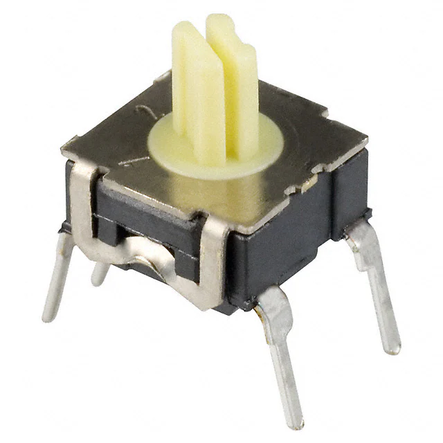

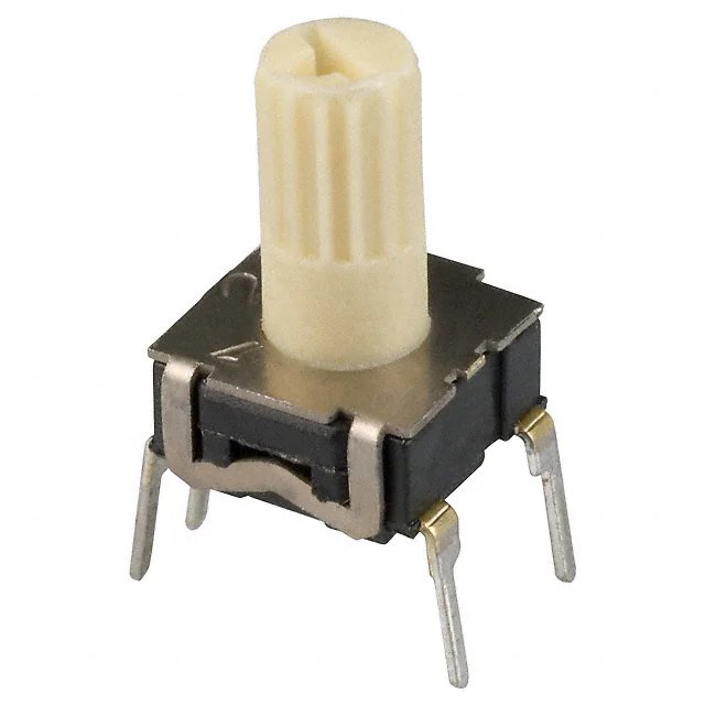

C&K RTE Series Low Profile Rotary DIP Switches Features/Benefits Typical Applications • Process-sealed - withstands soldering and cleaning • Thru-hole and surface mount models • Miniature size with robust stainless steel cover DIP H • Timers, automation components • Computer and peripherals • Alarms, access control • Instrumentation • Rotary SPDT, SP3T, SP4T functions • Rotary binary-decimal and hexadecimal coding Specifications CONTACT RATING: Gold: 100 mA max. 10µ A min. 30 V DC max. Silver: 100 mA max. 1 mA min. 50 V DC max. MECHANICAL LIFE: RTE02/03: 1,500 actuations; RTE04/10/16: 20,000 actuations CONTACT RESISTANCE: 100 mΩ max. intial; 150 mΩ after life INSULATION RESISTANCE: RTE02/03: 1013 Ω min. RTE04/10/16: 1010 Ω min. intial DIELECTRIC STRENGTH: RTE 02/03: 500 Vrms; RTE 10/16; 300 Vrms OPERATING TEMPERATURE: -25°C to 85°C. STORAGE TEMPERATURE: -40°C to 85°C. SEALING: Totally sealed PACKAGING: N or R terminations in tube. V termination in box. G termination in reel, 750 pieces per reel. G termination with flush actuator, 1250 pieces per reel. DAMP HEAT RESISTANCE: 21 days at 40°C, 93% RH SALT MIST RESISTANCE: 96 hours Materials COVER & BASE: Thermoplastic PPS ACTUATOR: PA Thermoplastic KNOB: Thermoplastic MOVABLE CONTACTS: Brass, gold or silver plated. STATIONARY CONTACTS: Brass, gold or silver plated. TERMINALS: Totally sealed (insert molded) O-RING: Silicone NOTE: Specifications and materials listed above are for switches with standard options. For information on specific and custom switches, consult Customer Service Center. How To Order Our easy Build-A Switch concept allows you to mix and match options to create the switch you need. Below is a complete listing of options shown in catalog. To order, simply select desired option from each category and place in the appropriate box. R T E Number of Positions RTE02 2 position RTE03 3 position RTE04 4 position* RTE10 10 position RTE16 16 position ESD Protection 0 without 1 with** Actuator 0 Flush, screwdriver slot 1 Extended shaft **** 2 Shaft for button *** Terminations N Thru-hole V Right angle, thru-hole R Reverse, thru-hole G Surface mount Switch Function 0 Single pole 1 BCD code 2 BCD complement code 3 Gray code 4 Hexadecimal code Contact Material 3 (STD), Gold 1 Silver * RTE04 version only available with screw driver slot acuator "0" ** ESD protection only available with N or R terminations. *** Buttons ordered separately. **** Not available in surface mount. Dimensions are shown in inch (mm ) Dimensions subject to change H-16 www.ittcannon.com C&K RTE Series Low Profile Rotary DIP Switches SWITCHES WITH STANDARD OPTIONS PC Mount 2 SPDT 65 3 SP3T 65 4 SP4T 65 10 BCD 65 H QTY PER TUBE 10 GRAY 65 10 HEXADECIMAL 65 .315 (8,0) .291 (7,4) .291 (7,4) FUNCTION .167 (4,25) RTE0210N03 RTE0310N03 RTE0400N03 RTE1010N13 RTE1010N33 RTE1610N43 NO. POS. DIP RTE0200N03 RTE0300N03 RTE0400N03 RTE1000N13 RTE1000N33 RTE1600N43 WITH ESD PIN .144 (3,65) PART NUMBER WITHOUT ESD PIN .283 (7,2) .041±.004 (1,05±0,1) .368 (9,35) .10 (2,54) .10 (2,54) Right Angle Mount FUNCTION 4 SP4T 150 per box 10 BCD 150 per box QUANTITY GRAY 150 per box 16 HEXADECIMAL 150 per box .177 (4,5) 10 .335 (8,5) 45˚0' .039 (1,0) .314 (7,975) .218 (5,53) RTE0400V03 RTE1000V13 RTE1000V33 RTE1600V43 NO. POS. .157 (4,0) PART NUMBER .20 (5,08) .25 (6,34) .114 (2,9) .020 (0,5) .10 (2,54) .10 (2,54) .041±.004 (1,05±0,1) Surface Mount QUANTITY PER REEL 1250 SPDT 1250 04 SP4T 1250 10 BCD 1250 10 GRAY 1250 16 HEXADECIMAL 1250 .291 (7,4) .315 (8,0) .020 (0,50) SPDT 03 .283 (7,2) .033 (0,85) .100 (2,54) .100 (2,54) .024 (0,6) .197 (5,0) .148 (3,75) 02 .004 (0,10) FUNCTION .144 (3,65) RTE0200G03 RTE0300G03 RTE0400G03 RTE1000G13 RTE1000G33 RTE1600G43 NO. POS. .167 (4,25) PART NUMBER .197 (5,0) Dimensions are shown inch (mm) Dimensions subject to change H-17 www.ittcannon.com C&K RTE Series Low Profile Rotary DIP Switches NUMBER OF POSITIONS RTE02 RTE03 2 POSITION RTE04 3 POSITION 120˚0' 3 C C 60˚0'C 2 1 3 1 C C 60˚0' 2 DIP H 4 POSITION RTE10 RTE16 10 POSITION 1 C 1 4 1 36˚0' 22˚30' 8 2 8 2 4 16 POSITION C 4 2 ESD PROTECTION 1 WITHOUT WITH .291 (7,4) .167 (4,25) .291 (7,4) .144 (3,65) 0.368 (9,35) .10 (2,54) C 1 C 2 m .30 (7,62) 4 .10 (2,54) 1 4 .035 TYP. (ø0,9) 2 .035 TYP. (ø0,9) 8 .10 (2,54) 8 .10 (2,54) ACTUATOR 1 EXTENDED SHAFT (not available in surface mount) 2 SHAFT FOR BUTTON .291 (7,4) .154 (3,9) FLUSH, SCREWDRIVER SLOT .157 (ø4,0) .167 (4,25) 0 .295 (7,5) 0 .041 (1,05 ± 0,1) .10 .10 (2,54) (2,54) Dimensions are shown in inch (mm ) Dimensions subject to change H-18 www.ittcannon.com C&K RTE Series Low Profile Rotary DIP Switches TERMINATIONS N V THRU-HOLE RIGHT ANGLE, THRU-HOLE H .335 (8,5) .315 (8,0) 45˚0' .314 (7,975) .218 (5,53) .368 (9,35) .039 (1,0) .10 (2,54) .177 (4,5) .291 (7,4) .167 (4,25) .157 (4,0) DIP .041±.004 (1,05±0,1) .10 (2,54) .20 (5,08) .25 (6,34) 2,54 4 .114 (2,9) .041±.004 (1,05±0,1) 2,54 C .020 (0,5) .10 (2,54) .10 (2,54) 1 8 .30 (7,62) 2 8 .035 TYP. (ø0,9) 1 .10 (2,54) G 4 .10 (2,54) SURFACE MOUNT .148 (3,75) .041±.004 (1,05±0,1) .451±.008 (11,45±0,2) .020 (0,5) .024 (0,6) .033 (0,85) .100 (2,54) .309 (7,85) .126±.008 (3,2±0,2) REVERSE, THRU-HOLE .185±.006 (4,7±0,15) R C .100 (2,54) .197 (5,0) .197 (5,0) .004 (0,10) 2 ø0,9 .366 (9,3) RTE03/04/10/16 RTE02 2 .063 4x (1,6) 8 .110 (2,8) ø 0,9 (X5) 4 C 2,54 2,54 .110 (2,8) 1 .100 (2,54) .106 4x (2,7) .100 (2,54) .063 5x (1,6) .106 5x (2,7) .110 (2,8) .110 (2,8) .100 (2,54) .100 (2,54) PCB layout seen component side Third Angle Projection Dimensions are shown inch (mm) Dimensions subject to change H-19 www.ittcannon.com C&K RTE Series Low Profile Rotary DIP Switches SWITCH FUNCTION 0 H 1 SINGLE POLE POS. 1 2 3 4 C C 1 DIP 1 2 2 4 3 8 4 2 3 BCD COMPLEMENT CODE POS. 0 1 2 3 4 5 6 7 8 9 4 BCD CODE POS. 0 1 2 3 4 5 6 7 8 9 GRAY CODE POS. 1 2 3 4 5 6 7 8 9 10 C C 1 1 2 2 4 4 8 8 HEXADECIMAL CODE Other codes available by request. POS. 0 1 2 3 4 5 6 7 8 9 10 11 12 13 14 15 C 1 2 4 8 CONTACT MATERIAL OPTION CODE 3 (STD.) 1 CONTACT MATERIAL TERMINAL PLATING RATING GOLD TIN 100 mA max. 10µ A min. 30 V DC max. SILVER TIN 100 mA max. 1 mA min. 50 V DC max. Buttons Available BTN RTE 40 BTN RTE 50 BTN RTE 90 Green Red 3˚ .23 (6) .15 (4) .06 (1,6) Color .028 (0,7) Part Number .185 (4,7) Buttons are ordered separately, shipped in bulk. .118 (3,0) .118 (3,0) Black .059 (1,5) ø.283 (7,2) .11 (3) Third Angle Projection Dimensions are shown in inch (mm ) Dimensions subject to change H-20 www.ittcannon.com C&K RTE Series Low Profile Rotary DIP Switches TAPE AND REEL H .472±.004 (12±0,1) .079±.002 (2±0,05) .079±.002 (2±0,05) .472±.004 (12±0,1) E .307+.008/-.000 (7,8+0,2/-0,0) .409+.008/-.000 (10,4+0,2/-0,0) .945±.012 (24,0±0,3) .453±.004 (11,5±0,1) .157±.004 (4±0,1) .157±.004 (4±0,1) DIP .012±.002 (0,3±0,05) .069±.004 (1,75±0,1) Tape and reel for RTExx02Gxx 750 pieces per reel. .303+.008/-.000 (7,7+0,2/-0,0) E ø.059+.008/-.000 (1,5+0,2/-0,0) Direction of feed .157±.004.157±.004 (4±0,1) (4±0,1) .079±.002 (2±0,05) .179+.007 (4,5 +0,2) .472±.004 (12±0,1) .472±.004 (12±0,1) .079±.002 (2±0,05) .295 ±.003 (7,5 ± 0,1) .012 ± 0.002 (0,3± 0,05) .069±.004 (1,75±0,1) Tape and reel for RTExx00Gxx 1,250 pieces per reel. .629 ± .011 (16 ± 0,3) D .303+.008/-.000 (7,7+0,2/-0,0) D ø.059+.008/-.000 (1,5+0,2/-0,0) Direction of feed Third Angle Projection Dimensions are shown inch (mm) Dimensions subject to change H-21 www.ittcannon.com
