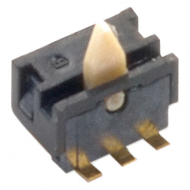

    SWITCH DETECT MICRO-MINI SMD
SDT001 数据手册
SDT Series Micro Mini Pendulum Surface Mount Detect Switches Features/Benefits • Low profile package sits just • • • • Typical Applications • Consumer electronics • Computers • Medical devices • ATCA or MicroTCA devices 3,30 mm off PCB Design allows top or side actuation Low actuation force, 30 grams max. Pick and place compatible, available in tape & reel packaging RoHS compliant and compatible AdvancedTCA R Specifications Materials CONTACT RATING: 1 mA 5 VDC BASE: LCP MECHANICAL AND ELECTRICAL LIFE: 100,000 cycles min. COVER: PA 46 CONTACT RESISTANCE: 1 Ω max. initial. ACTUATOR: LCP INSULATION RESISTANCE: 10 M Ω min. between adjacent contacts. MOVABLE BLADE: Stainless steel, gold over nickel plate. TERMINALS: Phosphor bronze, gold over nickel plate. OPERATING TEMPERATURE: -200C to +700C STORAGE TEMPERATURE: -300C to +800C NOTE: Specifications and materials listed above are for switches with standard options. For information on specific and custom switches, consult Customer Service Center. PACKAGING: Tape & reel, 2,200 per reel. Build-A-Switch Complete part numbers for SDT Series are shown below. SDT001 RECOMMENDED STROKE PART NUMBER PACKAGING SDT001 TAPE & REEL SCHEMATIC a 0.018 (0,45) 0.118 (3,00) A B C b 0.071 (1,8) AD BE C F R 0 O E 30 OR M 0.035 (0,9) 3 MO0 0O RE R 0.053 0.071 (1,35)(1,80) CIRCUIT DIAGRAM D ON Starting Position 200+100/-50 0.033 (0,85) E 0.020 0.047 (0,5) (1,2) F 0.130 (3,30) 0.093 (2,35)0.079 (2,0) 6X 0.016 (0,4) 0.033 (0,85) 0.024 (0,6) 0.157 (4,0) 0.079 (2,0) ø0.059 (ø1,5) 0.102 (2,6) 0.033 (0,85) PCB LAYOUT TOTAL TRAVEL ø0.028 (0,7) 0.020 (0,5) 0.033 (0,85) F A 0.069 (1,75) 0.020 (0,5) 0.130 (3,30) ø15" REF (ø380mm REF) 0.089 (2,25) B ø0.039 (0,1) 0.087 (2,2) 6X 0.024 (0,6) 0.033 (0,85) 0.015 (0,39) 0.055 (1,4) 0.083 (2,1) 0.295 (7,5) B 0.031 (0,8) 5 0.630 (16,00) 0.124 (3,15) .315 8,0 A CARRIER TAPE NO SCALE FEED DIRECTION Dimensions are shown: Inches (mm) Specifications and dimensions subject to change F-10 www.ck-components.com Detect 0.018 (0,45) ON Starting Position 200+100/-50 R 0.004 R (0,11) TAPE & REEL 0.112 (2,85) 0.077 (1,95) ø0.030 (0,75ø) Scale 15:1 b a
