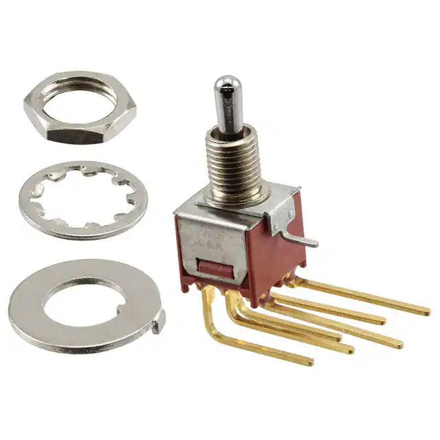

    钮子开关 双刀双掷 3万次 弯插 400mA 20V -30℃~+85℃
T203MYAVBE 数据手册
T Series Subminiature Toggle Switches Features/Benefits • Compact size—small footprint • Single and double pole models • PC and panel mount options available Typical Applications • Hand-held telecommunications • Instrumentation • Medical equipment • RoHS compliant models available Specifications Materials CONTACT RATING: B contact material: 0.4 VA max. @ 20 V AC or DC max. Q contact material (TX01 models): 3 AMPS @ 120 V AC or 28 V DC. All other models: 2 AMPS @ 120 V AC or 28 V DC. See page F-42 for additional ratings. ELECTRICAL LIFE: TX01 models: 60,000 make-and-break cycles at full load. All other models: 30,000 cycles. CONTACT RESISTANCE: Below 20 m Ω typ. initial @ 2-4 V DC, 100 mA, for both silver and gold plated contacts. INSULATION RESISTANCE: 109 Ω min. DIELECTRIC STRENGTH: 1000 Vrms min. @ sea level. OPERATING TEMPERATURE: –30ºC to 85ºC. SOLDERABILITY: Per MIL-STD-202F method 208D, or EIA RS-186E method 9 (1 hour steam aging). CASE: Glass filled nylon 6/6, flame retardant, heat stabilized or diallyl phthalate (DAP), (UL 94V-0) or glass filled nylon 4/6, flame retardant, heat stabilized. ACTUATOR: Brass, chrome plated. BUSHING: Brass, nickel plated. HOUSING: Stainless steel. SWITCH SUPPORT: Brass, matte-tin plated. END CONTACTS: B contact material: Copper alloy, with gold plate over nickel plate. Q contact material: Coin silver, silver plated. See above for additional contact materials. CENTER CONTACTS & TERMINALS: B contact material: Copper alloy, with gold plate over nickel plate. Q contact material: Copper alloy, silver plated. See page F-42 for additional contact materials. TERMINAL SEAL: Epoxy. HARDWARE: Nut & Locking Ring: Brass, nickel plated. Lockwasher: Steel, nickel plated. Additional hardware available separately, see Section N. NOTE: Any models supplied with P, R, Q, B or G contact material are RoHS compliant and compatible. NOTE: Specifications and materials listed above are for switches with standard options. For information on specific and custom switches, consult Customer Service Center. Build-A-Switch To order, simply select desired option from each category and place in the appropriate box. Available options are shown and described on pages F-38 thru F-42. For additional options not shown in catalog, consult Customer Service Center. All models have epoxy terminal seal and are compatible with all “bottom-wash” PCB cleaning methods. Switch Function T101 SPDT On-None-On T102 SPDT Off-None-On T103 SPDT On-Off-On T105 SPDT Mom.-Off-Mom. T107 SPDT On-Off-Mom. T108 SPDT On-None-Mom. T201 DPDT On-None-On T203 DPDT On-Off-On T205 DPDT Mom.-Off-Mom. T207 DPDT On-Off-Mom. T208 DPDT On-None-Mom. T211 DPDT On-On-On. Actuator P3  Flatted, anti-rotation, .490” high S .370” high K Locking lever, round tip L1 .640” high M1 .220” high S1 .410” high M .210” high L .290” high Bushing H .220” high, threaded, flat H9 .220” high, unthreaded, flat CF Splashproof, .310” high, threaded, flat D9 .260” high, unthreaded, keyway T .310” high, threaded, flat T9 .310” high, unthreaded, flat TD .260” high, threaded, keyway TK .310” high, threaded, keyway Y .220” high, threaded, keyway Y9 .220” high, unthreaded, keyway Terminations A Right angle, PC thru-hole AV Vertical right angle, PC thru-hole C PC Thru-hole V3 Vertical mount V-bracket Z Solder lug W Wire wrap Seal E Epoxy Dimensions are shown: Inches (mm) Specifications and dimensions subject to change 15 Jan 21 F–37 www.ckswitches.com F Toggle Contact Material B Gold P Gold, matte tin Q Silver G Gold over silver R­ Gold over silver, matte-tin T Series Subminiature Toggle Switches SWITCH FUNCTION SWITCH FUNCTION POS. 1 NO. POLES SP MODEL NO. POS. 2 CONNECTED TERMINALS POS. 3 POS. 1 C&K marking on opposite side T101 ON NONE ON T103 ON OFF ON T105 MOM. OFF MOM. T107 ON OFF MOM. T108 ON NONE T102 OFF NONE POS. 2 POS. 3 C&K marking on opposite side SCHEMATIC 2-3 N/A 2-1 2-3 OPEN 2-1 MOM. 2-3 NA 2-1 SPDT ON OPEN N/A 3-1 SPST SPDT .338 (8,57) Part number shown: T101SHZQE SWITCH FUNCTION POS. 1 POS. 2 POS. 3 NO. POLES DP MODEL NO. POS. 1 C&K marking on opposite side T201 ON NONE ON T203 ON OFF ON T205 MOM. OFF MOM. T208 ON NONE T211* ON ON CONNECTED TERMINALS POS. 2 POS. 3 SCHEMATIC C&K marking on opposite side 2-3,5-6 N/A 2-1,5-4 2-3,5-6 OPEN 2-1,5-4 MOM. 2-3,5-6 N/A 2-1,5-4 ON. 2-3,5-6 2-3,5-4 2-1,5-4 DPDT DPDT .338 (8,57) Toggle F Terminal Nos. For Reference Only Part number shown: T201SHZQE MOM. = Momentary * Wiring for 3-way switch All models with all options when ordered with G, L, R or Q contact material. Third Angle Projection Dimensions are shown: Inches Dimensions are shown:(mm) IN (mm) Specifications and and dimensions subject to change Specifications dimensions subject to change 15 Jan 21 F–38 G–37 www.ckswitches.com www.ittcannon.com T Series Subminiature Toggle Switches ACTUATOR M  .210” HIGH S  .370” HIGH M1  .220” HIGH S1  .410” HIGH (with “T” bushing) (with “T” bushing) 2 1 1 2 .214 (5,44) Standard with A, AV or V3 terminations. L  .290” HIGH Standard with Z, C or W terminations. L1  .640” HIGH P3  ANTI-ROTATION, FLATTED, .450” HIGH 2 1 Actuator shown with standard H bushing. Subtract .040 (1,02) for TD and D9 bushings, subtract .090 (2,29) for T, T9, TK, K9 & CF bushings. 1 2 Actuators shown with T, T9, TK & CF bushings, add .050 (1,27) for TD and D9 bushings, add .090 (2,29) for H, H9, Y & Y9 bushings. All actuators have chrome finish (except K). Available with T & T9 bushings only. Dress nut part number 709901201 supplied standard with threaded bushing. K  LOCKING LEVER Locking Positions –01 & –02 Models 2 Position lock –03 & –11 Models 3 Position lock –08 Models 1 Position lock K actuators have natural aluminum finish. Not available with CF bushing option. Bushing option code not required. Not available with TX05 & TX07 models. Keyway on right side. To prevent accidental actuation, toggles must be lifted before being actuated. When released, toggles again lock in place. Overtightening mounting nut may cause actuator to bind. BUSHING H  .220” HIGH THREADED, FLAT Y  .220” HIGH THREADED, KEYWAY T  .310” HIGH THREADED, FLAT H9  .220” HIGH UNTHREADED, FLAT Y9  .220” HIGH UNTHREADED, KEYWAY T9  .310” HIGH UNTHREADED, FLAT F Toggle H standard with C, W & Z terminations. H9 standard with A, AV & V3 terminations. Dimensions are shown: Inches (mm) Specifications and dimensions subject to change 15 Jan 21 F–39 www.ckswitches.com T Series Subminiature Toggle Switches BUSHING TK  .310” HIGH THREADED, KEYWAY TD  .260” HIGH THREADED, KEYWAY CF  SPLASHPROOF, .310” HIGH THREADED, FLAT D9  .260” HIGH UNTHREADED, KEYWAY IP67 Degree of protection. Internal o-ring actuator seal and external bushing seal washer standard. Not available with K locking lever option. 10-48 BUSHING With Standard Locking Ring Without Locking Ring 1/4 IN. BUSHING PANEL MOUNTING Without Locking Ring Without Locking Ring Without Locking Ring With Small Locking Ring With Standard Locking Ring TERMINATIONS Z  SOLDER LUG C  PC THRU-HOLE SP SP DP DP PC MOUNTING Not available with P or R contact materials. T102 – omit center hole. W  WIRE WRAP SP DP Toggle F Dimensions are shown: Inches (mm) Specifications and dimensions subject to change 15 Jan 21 F–40 www.ckswitches.com T Series Subminiature Toggle Switches TERMINATIONS A  RIGHT ANGLE, PC THRU-HOLE PC MOUNTING .214 (5,44) .022 (0,56) .128 (3,25) T101MH9ABE Horizontal Actuation Actuator Shown In Pos. 1 SPDT Not available with T102 model. A  RIGHT ANGLE, PC THRU-HOLE PC MOUNTING .214 (5,44) .022 (0,56) .128 (3,25) T201MH9ABE Horizontal Actuation DPDT Actuator Shown In Pos. 1 AV  VERTICAL RIGHT ANGLE, PC THRU-HOLE PC MOUNTING .214 (5,44) .026 (0,66) Actuator Shown In Pos. 1 .153 (3,89) T101MH9AVBE Vertical Actuation SPDT T102 Models: Omit terminal 2 NOTE: Terminal bend radii and lead-in manufacturing option. AV  VERTICAL RIGHT ANGLE, PC THRU-HOLE PC MOUNTING .214 (5,44) .022 (0,56) Actuator Shown In Pos. 1 .153 (3,89) T201MH9AVBE Vertical Actuation DPDT NOTE: Terminal bend radii and lead-in manufacturing option. V3  VERTICAL MOUNT, V-BRACKET PC MOUNTING .214 (5,44) Actuator Shown In Pos. 1 F T102 Models: Omit center hole. T101MH9V3BE SPDT T102 Models: Omit terminal 2 Dimensions are shown: Inches (mm) Specifications and dimensions subject to change 15 Jan 21 F–41 www.ckswitches.com Toggle .358 (9,08) T Series Subminiature Toggle Switches TERMINATIONS V3  VERTICAL MOUNT, V-BRACKET .214 (5,44) PC MOUNTING T201MH9V3BE DPDT Actuator Shown In Pos. 1 CONTACT MATERIAL OPTION CODE B CONTACT MATERIAL G R RATINGS GOLD 1 LOW LEVEL/ MATTE-TIN 6 DRY CIRCUIT SILVER 4,5 SILVER 5 POWER GOLD OVER GOLD 3 LOW LEVEL/DRY SILVER 2,3 MATTE-TIN 6 CIRCUIT OR POWER GOLD 1 P Q TERMINAL PLATING 0.4 VA MAX. @ 20 V AC OR DC MAX. TX01 MODELS: 3 AMPS @ 120 V AC OR 28 V DC. ALL OTHER MODELS: 2 AMPS @ 120 V AC OR 28 V DC. TX01 MODELS: 0.4 VA MAX @ 20 V AC OR DC MAX. OR 3 AMPS @ 120 V AC OR 28 V DC. ALL OTHER MODELS: 0.4 VA MAX @ 20 V AC OR DC MAX. OR 2 AMPS @ 120 V AC OR 28 V DC. * Note: See Technical Data section of this catalog for RoHS compliant and compatible definitions and specifications. 1 CONTACTS & TERMINALS: Copper alloy, with gold plate over nickel plate. 2 END CONTACTS: Coin silver, with gold plate over nickel plate. 3 CENTER CONTACTS & ALL TERMINALS: Copper alloy, with gold plate over nickel plate. All models with all options when ordered with R, G, or Q contact material. B contact material standard with A, AV, V3 & W terminations. Q contact material standard with C & Z terminations. 4 END CONTACTS: Coin silver, silver plated. 5 CENTER CONTACT & ALL TERMINALS: Copper alloy, silver plated. 6 TERMINALS: Copper alloy, with matte-tin over nickel plate. SEAL E  EPOXY SEAL AVAILABLE HARDWARE 759D02000  SEALING BOOT .658 (16,7) .204 (5,2) Toggle F * Note: For use with S1 actuator style when combined with T, TK, and CF bushings. .524 (13,3) 1/4-40 uns-2A nut Dimensions are shown: Inches (mm) Specifications and dimensions subject to change 15 Jan 21 F–42 www.ckswitches.com

物料型号: T系列切换开关,包括SPDT和DPDT类型。
器件简介: - 紧凑尺寸,小占用空间。 - 提供单极和双极型号。 - 有PC和面板安装选项。 - 提供符合RoHS标准的型号。
引脚分配: 提供了详细的引脚分配图和模型编号,例如T101SHZQE和T201SHZQE。
参数特性: - 接触材料包括金、银、金镀银等。 - 电气寿命:TX01型号为60,000次全负载开断周期,其他型号为30,000次。 - 接触电阻:通常在20 mΩ以下。 - 绝缘电阻:至少10^9 Ω。 - 耐电压:至少1000 Vrms。 - 工作温度范围:-30ºC至85ºC。
功能详解: - 提供了开关功能的详细描述,如SPDT的T101至T108型号和DPDT的T201至T211型号。 - 描述了各种开关配置,如常开、常闭、瞬时等。
应用信息: - 主要应用于手持通信设备、仪器仪表、医疗设备等。
封装信息: - 提供了详细的尺寸信息和安装选项,包括面板安装和PCB安装。 - 描述了不同终止方式,如直角、垂直安装、焊盘等。
