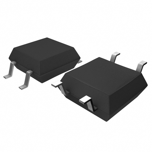

CPC1016N 4 Pin SOP OptoMOS® Relay CPC1016N 100 100 16 Units V mA Ω Description CPC1016N is a miniature low voltage, low on resistance 1-Form-A solid state relay in a 4 pin SOP package. The relay uses optically coupled MOSFET technology to provide 1500V of input to output isolation. The efficient MOSFET switches and photovoltaic die use Clare’s patented OptoMOS® architecture. The optically-coupled input is controlled by a highly efficient GaAIAs infrared LED. The CPC1016N uses Clare’s state of the art double molded vertical construction packaging to produce the world’s smallest relay. The CPC1016N is ideal for replacing larger less reliable reed and electromechanical relays. Load Voltage Load Current Max RON Features • Small 4 Pin SOP Package • Low Drive Power Requirements (TTL/CMOS Compatible) • No Moving Parts • High Reliability • Arc-Free With No Snubbing Circuits • 1500VRMS Input/Output Isolation • FCC Compatible • No EMI/RFI Generation • Machine Insertable, Wave Solderable • Tape & Reel Version Available Approvals • UL/C-UL Recognized Component File #: E76270 • BSI Certified - Certificate #: 8416 Ordering Information Applications • Instrumentation • Multiplexers • Data Acquisition • Electronic Switching • I/O Subsystems • Meters (Watt-Hour, Water, Gas) • Medical Equipment—Patient/Equipment Isolation • Security Systems • Aerospace • Industrial Controls • Reed Relay Replacement Part # Description CPC1016N 4 Pin SOP (100/Tube) CPC1016NTR 4 Pin SOP (2,000/Reel) Pin Configuration CPC1016N Pinout 1 2 + Control Ð Control 4 3 Load Load 10ms CONTROL LOAD 10%+ +90% 10%+ TON TOFF DS-CPC1016N-R1 www.clare.com 1 CPC1016N Absolute Maximum Ratings (@ 25˚ C) Parameter Input Power Dissipation Min 1500 -40 -40 Typ Max Units 1 70 50 1 5 4001 +85 +125 +220 mW mA A V mW pF VRMS °C °C °C Input Control Current Peak (10ms) Reverse Input Voltage Total Power Dissipation Capacitance Input to Output Isolation Voltage Input to Output Operational Temperature Storage Temperature Soldering Temperature (10 Seconds Max.) 1 Derate Linearly 3.33 mw / oC Absolute Maximum Ratings are stress ratings. Stresses in excess of these ratings can cause permanent damage to the device. Functional operation of the device at these or any other conditions beyond those indicated in the operational sections of this data sheet is not implied. Exposure of the device to the absolute maximum ratings for an extended period may degrade the device and effect its reliability. Electrical Characteristics Parameter Output Characteristics @ 25°C Load Voltage (Peak) Load Current (Continuous)1 10ms IL=100mA VL=100V IF=5mA, VL=10V IF=5mA, VL=10V 50V; f=1MHz IL=100mA IF=5mA VR=5V Peak Load Current On-Resistance 2 Off-State Leakage Current Switching Speeds Turn-On Turn-Off Output Capacitance Input Characteristics @ 25°C Input Control Current Input Dropout Current Input Voltage Drop Reverse Input Voltage Reverse Input Current 2 Measurement taken within 1 second of on time. Conditions - Symbol VL IL ILPK RON ILEAK TON TOFF COUT IF IF VF VR IR Min 2 0.3 0.9 - Typ 25 0.9 1.2 - Max 100 100 350 16 1 2 0.5 50 1.4 5 10 Units V mA mA Ω µA ms ms pF mA mA V V µA 1 Load current derates linearly from 100mA @ 25oC to approximately 85mA @ 85oC. 2 www.clare.com Rev. 1 CPC1016N PERFORMANCE DATA* CPC1016N Typical LED Forward Voltage Drop (Ambient Temperature = 25 C) IF = 5mADC o CPC1016N Typical On-Resistance Distribution (Ambient Temperature = 25 C) (Load Current = 100mA) o 35 30 35 30 35 30 Device Count (N) CPC1016N Typical Blocking Voltage Distribution (Ambient Temperature = 25oC) Device Count (N) Device Count (N) 25 20 15 10 5 0 1.17 1.19 1.21 1.23 1.25 25 20 15 10 5 0 6.8 6.9 7.0 7.1 7.2 7.3 7.4 25 20 15 10 5 0 106 109 112 115 118 121 124 LED Forward Voltage Drop (V) On-Resistance (Ω) Blocking Voltage (V) CPC1016N Typical IF for Switch Operation (Ambient Temperature = 25 C) (Load Current = 100mA) o CPC1016N Typical IF for Switch Dropout (Ambient Temperature = 25 C) (Load Current = 100mA) o CPC1016N Typical Turn-On Time (Ambient Temperature = 25 C) (Load Current = 100mA; IF = 5mA) o 25 25 25 Device Count (N) Device Count (N) 15 15 Device Count (N) 20 20 20 15 10 10 10 5 5 5 0 0.70 0.75 0.80 0.85 0.90 0.95 1.0 0 0.75 0.80 0.85 0.90 0.95 1.00 1.05 0 0.25 0.30 0.35 0.40 0.45 0.50 0.55 LED Current (mA) LED Current (mA) Turn-On (ms) CPC1016N Typical Turn-Off Time (Ambient Temperature = 25 C) (Load Current = 100mA; IF = 5mA) o 25 Load Current (mA) Device Count (N) 20 15 10 5 0 0.21 0.22 0.23 0.24 0.25 0.26 0.27 120 115 110 105 100 95 90 85 80 75 CPC1016N Typical MaximumLoad Current vs. Temperature 0.016 0.014 0.012 0.010 0.008 0.006 0.004 0.002 0 CPC1016N Typical Leakage vs. Temperature (Measured across Pins 3 & 4) IL = max rated IF =10mA IF =5mA -40 -20 0 Turn-Off (ms) Temperature (oC) 20 40 60 80 100 120 Leakage (µA) -40 -20 0 20 40 60 80 100 Temperature (oC) 122 121 120 119 118 117 116 115 CPC1016N Typical Blocking Voltage vs. Temperature -40 -20 0 Temperature (oC) 20 40 60 80 100 5.000 4.500 4.000 3.500 3.000 2.500 2.000 1.500 1.000 0.500 0 CPC1016N Typical Turn-On vs. Temperature (Load Current = 80mA) 5mA 10mA -40 -20 0 Temperature (o C) 20 40 60 80 100 1.000 0.900 0.800 0.700 0.600 0.500 0.400 0.300 0.200 0.100 0 CPC1016N Typical Turn-Off vs. Temperature (Load Current = 80mA) Blocking Voltage (VRMS) Turn-Off (ms) Turn-On (ms) 10mA -40 -20 0 Temperature (oC) 20 40 60 80 5mA 100 The Performance data shown in the graphs above is typical of device performance. For guaranteed parameters not indicated in the written specifications, please contact our application department. Rev. 1 www.clare.com 3 CPC1016N PERFORMANCE DATA* CPC1016N Typical LED Forward Voltage Drop vs. Temperature LED Forward Voltage Drop (V) 1.8 1.6 1.4 50mA 10mA 5mA 1.2 1.0 0.8 -40 -20 0 20 40 60 80 100 120 2.0 1.8 1.6 1.4 1.2 1.0 0.8 0.6 0.4 0.2 0 CPC1016N Typical Turn-On vs. LED Forward Current (Load Current = 80mA) 0 5 10 15 20 25 30 35 40 45 50 LED Forward Current (mA) 0.7 0.6 0.5 0.4 0.3 0.2 0.1 0 CPC1016N Typical Turn-Off vs. LED Forward Current (Load Current = 80mA) Turn-On (ms) Turn-Off (ms) 0 5 10 15 20 25 30 35 40 45 50 LED Forward Current (mA) Temperature (oC) 14 12 On-Resistance () CPC1016N Typical On-Resistance vs. Temperature (Load Current = max rated @ temperature) IF = 5mA LED Current (mA) CPC1016N Typical IF for Switch Operation vs. Temperature (Load Current = 80mA) 3.0 2.5 2.0 1.5 1.0 .5 3.000 LED Current (mA) CPC1016N Typical IF for Switch Dropout vs. Temperature (Load Current = 80mA) 10 8 6 4 2 -40 IF = 10mA Steady State Instantaneous IF = 5mA 2.500 2.000 1.500 1.000 0.500 0 -40 -20 0 Temperature (oC) -20 0 Temperature (oC) 20 40 60 80 100 0 -40 -20 0 20 40 o 60 80 100 20 40 60 80 100 Temperature ( C) 150 Load Current (mA) CPC1016N Typical Load Current vs. Load Voltage (Ambient Temperature = 25oC) IF = 5mA Load Current (A) 100 50 0 -50 -100 -150 -1.5 -1.0 -0.5 0 0.5 1.0 1.5 1.0 0.9 0.8 0.7 0.6 0.5 0.4 0.3 0.2 0.1 0 10µs 100µs 1ms 10ms 100ms 1s Time CPC1016N Energy Rating Curve 10s 100s Load Voltage (V) *The Performance data shown in the graphs above is typical of device performance. For guaranteed parameters not indicated in the written specifications, please contact our application department. 4 www.clare.com Rev. 1 CPC1016N Mechanical Dimensions 4 Pin SOIC Narrow (“N” Suffix) 6.09 ± .25 (.240 ± .010) .38 x 45 (.015 x 45 ) .38 TYP. (.015 TYP.) 3.81 ± .13 (.150 ± .005) 1.01 ± .025 (.040 ± .001) 0.432 ± 0.127 (.017 ± .005) .20 ± .025 (.008 ± .001) 2.18 MAX. (.086) 2.54 TYP. (.100 TYP.) 4.09 ± 0.20 (0.161 ± 0.008) PC Board Pattern (Top View) 2.54 ± 0.127 (0.100 ± 0.005) 5.66 ± 0.14 (0.223 ± 0.005) 1.448 (0.057) 0.889 (0.035) Dimensions mm (inches) Rev. 1 www.clare.com 5 Worldwide Sales Offices CLARE LOCATIONS Clare Headquarters 78 Cherry Hill Drive Beverly, MA 01915 Tel: 1-978-524-6700 Fax: 1-978-524-4900 Toll Free: 1-800-27-CLARE Clare Micronix Division 145 Columbia Aliso Viejo, CA 92656-1490 Tel: 1-949-831-4622 Fax: 1-949-831-4628 EUROPE European Headquarters CP Clare nv Bampslaan 17 B-3500 Hasselt (Belgium) Tel: 32-11-300868 Fax: 32-11-300890 France Clare France Sales Lead Rep 99 route de Versailles 91160 Champlan France Tel: 33 1 69 79 93 50 Fax: 33 1 69 79 93 59 Germany Clare Germany Sales ActiveComp Electronic GmbH Mitterstrasse 12 85077 Manching Germany Tel: 49 8459 3214 10 Fax: 49 8459 3214 29 Italy C.L.A.R.E.s.a.s. Via C. Colombo 10/A I-20066 Melzo (Milano) Tel: 39-02-95737160 Fax: 39-02-95738829 Sweden Clare Sales Comptronic AB Box 167 S-16329 Spånga Tel: 46-862-10370 Fax: 46-862-10371 United Kingdom Clare UK Sales Marco Polo House Cook Way Bindon Road Taunton UK-Somerset TA2 6BG Tel: 44-1-823 352541 Fax: 44-1-823 352797 ASIA PACIFIC Asian Headquarters Clare Room N1016, Chia-Hsin, Bldg II, 10F, No. 96, Sec. 2 Chung Shan North Road Taipei, Taiwan R.O.C. Tel: 886-2-2523-6368 Fax: 886-2-2523-6369 SALES OFFICES AMERICAS Americas Headquarters Clare 78 Cherry Hill Drive Beverly, MA 01915 Tel: 1-978-524-6700 Fax: 1-978-524-4900 Toll Free: 1-800-27-CLARE Eastern Region Clare P.O. Box 856 Mahwah, NJ 07430 Tel: 1-201-236-0101 Fax: 1-201-236-8685 Toll Free: 1-800-27-CLARE Central Region Clare Canada Ltd. 3425 Harvester Road, Suite 202 Burlington, Ontario L7N 3N1 Tel: 1-905-333-9066 Fax: 1-905-333-1824 Western Region Clare 1852 West 11th Street, #348 Tracy, CA 95376 Tel: 1-209-832-4367 Fax: 1-209-832-4732 Toll Free: 1-800-27-CLARE Canada Clare Canada Ltd. 3425 Harvester Road, Suite 202 Burlington, Ontario L7N 3N1 Tel: 1-905-333-9066 Fax: 1-905-333-1824 http://www.clare.com Clare cannot assume responsibility for use of any circuitry other than circuitry entirely embodied in this Clare product. No circuit patent licenses nor indemnity are expressed or implied. Clare reserves the right to change the specification and circuitry, without notice at any time. The products described in this document are not intended for use in medical implantation or other direct life support applications where malfunction may result in direct physical harm, injury or death to a person. Specification: DS-CPC1016N-R1 ©Copyright 2000, Clare, Inc. OptoMOS® is a registered trademark of Clare, Inc. All rights reserved. Printed in USA. 1/12/01
