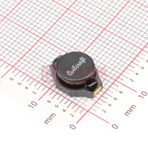

Document 114 Fixed RF Inductors – 132 Series These fixed RF coils are part of Coilcraft’s series of insert molded inductors. This precision construction technique ensures constant winding pitch, long-term stability and tight tolerance (±5%) on inductance. These high Q fixed inductors are available in standard values from 14.0 nH to 709 nH. Coilcraft Designer’s Kit M304 contains three samples each of 20 standard values plus 13 values from the 148 Series. To order, please contact Coilcraft or visit http://order.coilcraft.com. 0.380 max 9,65 0.230 max 5,84 0.260 max 6,60 0.187 ±0.030 4,75 ±0,76 0.290 ±0.005 7,37 ±0,13 Weight: 245 – 510 mg A See table for lead diameter and spacing Part number 132-01L 132-02L 132-03L 132-04L 132-05L 132-06L 132-07L 132-08L 132-09L 132-10L 132-11L 132-12L 132-13L 132-14L 132-15L 132-16L 132-17L 132-18L 132-19L 132-20L L2 ±5% (nH) 14.0 21.0 28.0 37.5 49.0 61.5 83 98 120 140 180 220 246 276 333 397 460 505 571 709 Q min2 60@ 50 MHz 64@ 50 MHz 68@ 50 MHz 72@ 50 MHz 75@ 50 MHz 80@ 50 MHz 66@ 25 MHz 68@ 25 MHz 68@ 25 MHz 68@ 25 MHz 66@ 25 MHz 72@ 25 MHz 70@ 25 MHz 70@ 25 MHz 72@ 25 MHz 72@ 25 MHz 66@ 25 MHz 66@ 25 MHz 68@ 25 MHz 66@ 25 MHz SRF min3 (MHz) 2500 2000 1700 1550 1240 1160 900 800 700 615 525 480 440 410 390 365 340 325 310 275 DCR max4 (mOhms) 2.1 3.0 3.8 4.7 5.7 6.6 7.4 8.0 9.0 10.0 13.7 19.0 20.3 22.5 30.6 40.3 43.1 57.3 61.2 82.7 Irms5 (A) 4.0 4.0 4.0 4.0 4.0 4.0 3.5 3.5 3.5 3.0 3.0 3.0 3.0 3.0 3.0 2.5 2.5 2.0 2.0 1.5 Color Brown Red Orange Yellow Green Blue Violet Gray White Black Brown Red Orange Yellow Green Blue Violet Gray White Black Turns 1½ 2½ 3½ 4½ 5½ 6½ 7½ 8½ 9½ 10½ 11½ 12½ 13½ 14½ 15½ 16½ 17½ 18½ 19½ 20½ Lead gauge (AWG) 22 22 22 22 22 22 22 22 22 22 23 24 24 24 25 26 26 27 27 28 Dim A6 (in/mm) 0.148/3,76 0.148/3,76 0.148/3,76 0.148/3,76 0.148/3,76 0.148/3,76 0.148/3,76 0.148/3,76 0.148/3,76 0.148/3,76 0.148/3,76 0.153/3,89 0.153/3,89 0.153/3,89 0.154/3,91 0.156/3,96 0.156/3,96 0.156/3,96 0.156/3,96 0.160/4,06 L7 ±5% (nH) 31.5 36.5 44.0 53.5 64.0 79.0 99.0 117 138 158 197 235 260 290 345 410 475 550 600 720 1. When ordering, please specify termination code: 132-20 L Termination: L = RoHS compliant tin-silver over copper. Special order: T = RoHS tin-silver-copper (95.5/4/0.5) or S = non-RoHS tin-lead (63/37). 2. Inductance and Q measured with leads connected directly to the Agilent/ HP 4287A. 3. SRF measured using the Agilent/HP 8753D. 4. DCR measured using the Cambridge Technology Model 510 Micro Ohmmeter. 5. Average current for a 20°C temperature rise from 25°C ambient. 6. Tolerance ±0.005″/0,13 mm. 7. The inductance values in column two are more accurate measurements taken on a contemporary meter. The old values in this column are for reference by existing users of these parts and were measured with leads connected directly to a Boonton 260-A. 8. Operating temperature range -40°C to 85°C. 9. Electrical specifications at 25°C. Specifications subject to change without notice. Please check our website for latest information. Document 114 Revised 03/23/06 © Coilcraft, Inc. 2006
