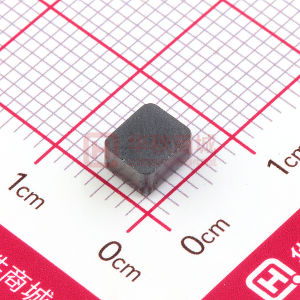

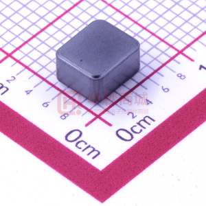

Document 252-1 Power Chip Inductors – 1812PS Series • Economical alternative to larger shielded power inductors. • Ferrite cover provides magnetic shielding For new designs, we recommend the LPS4018 or LPS5030 as an alternative to this series. They offer better current handling, lower DCR, a lower profile and a smaller footprint. We will continue to manufacture and support the 1812PS. Part L2 number1 (µH) 1812PS-102_L_ 1.0 1812PS-122_L_ 1.2 1812PS-152_L_ 1.5 1812PS-222_L_ 2.2 1812PS-272_L_ 2.7 1812PS-332_L_ 3.3 1812PS-392_L_ 3.9 1812PS-472_L_ 4.7 1812PS-562_L_ 5.6 1812PS-682_L_ 6.8 1812PS-103_L_ 10 1812PS-153_L_ 15 1812PS-223_L_ 22 1812PS-333_L_ 33 1812PS-393_L_ 39 1812PS-473_L_ 47 1812PS-683_L_ 68 1812PS-823_L_ 82 1812PS-104_L_ 100 1812PS-124_L_ 120 1812PS-154_L_ 150 1812PS-224_L_ 220 1812PS-334_L_ 330 1812PS-474_L_ 470 1812PS-564_L_ 560 1812PS-684_L_ 680 1812PS-824_L_ 820 1812PS-105_L_ 1000 DCR SRF % Q max5 typ6 3 4 tol min (Ohms) (MHz) 10,5 35 0.05 685 10,5 38 0.06 460 10,5 38 0.06 460 10,5 38 0.07 270 10,5 40 0.08 265 10,5 40 0.09 225 10,5 40 0.11 170 10,5 40 0.11 165 10,5 40 0.12 155 10,5 40 0.13 140 10,5 40 0.17 120 10,5 40 0.26 100 10,5 40 0.33 45 10,5 40 0.40 30 10,5 48 0.56 30 10,5 50 0.87 28 10,5 50 1.08 17 10,5 55 1.25 17 10,5 60 1.32 14 10,5 60 1.45 12 10,5 60 2.20 11 10,5 60 2.65 7 10,5 60 4.85 5.5 10,5 50 5.85 4.0 10,5 40 6.10 2.6 10,5 40 6.60 2.3 10,5 30 7.35 1.8 10,5 28 10.00 1.8 Isat7 (A) 2.50 2.00 2.00 1.70 1.40 1.40 1.20 1.15 1.10 1.00 0.90 0.70 0.54 0.46 0.40 0.35 0.32 0.28 0.27 0.23 0.20 0.17 0.15 0.12 0.11 0.10 0.09 0.08 Irms8 (A) 2.70 2.60 2.60 2.40 2.30 2.30 2.20 2.10 2.10 1.90 1.70 1.45 1.20 1.10 1.00 0.80 0.67 0.65 0.65 0.60 0.51 0.47 0.31 0.31 0.28 0.28 0.25 0.22 1. When ordering, specify tolerance, termination and packaging codes: 1812PS-105JLC J = 5% K = 10% (Table shows stock tolerances in bold.) Termination: L = RoHS compliant silver-palladium-platinum-glass frit. Special order: T = RoHS tin-silver-copper (95.5/4/0.5) or S = non-RoHS tin-lead (63/37). Packaging: C = 7″ machine-ready reel. EIA-481 embossed plastic tape (600 parts per full reel). B = Less than full reel. In tape, but not machine ready. To have a leader and trailer added ($25 charge), use code letter C instead. D = 13″ machine-ready reel. EIA-481 embossed plastic tape. Factory order only, not stocked (2200 parts per full reel). 2. Inductance measured at 100 kHz, 0.1 Vrms, using aCoilcraft SMD-A fixture in an Agilent/HP 4263B LCR meter. 3. Tolerances in bold are stocked for immediate shipment. 4. Q measured at 1 MHz on an Agilent/HP 4291 with an Agilent/HP 16193 test fixture. 5. DCR measured on micro-ohmmeter and a Coilcraft CCF840 test fixture. 6. SRF measured using an Agilent/HP 8753D network analyzer and a Coilcraft SMD-D test fixture. 7. DC current at which the inductance drops 10% (typ) from its value without current. 8. Current that causes a 40°C temperature rise from 25°C ambient. 9. Electrical specifications at 25°C. Refer to Doc 362 “Soldering Surface Mount Components” before soldering. Tolerance: Specifications subject to change without notice. Please check our website for latest information. Document 252-1 Revised 08/17/09 © Coilcraft, Inc. 2009 Document 252-2 Power Chip Inductors - 1812PS Series Typical L vs Frequency 10000 1000 µH Typical L vs Current 10000 1000 µH 1000 1000 Inductance (µH) Inductance (µH) 100 100 µH 100 100 µH 10 10 µH 10 10 µH 1 1 µH 1 1 µH 0.1 0.01 0.1 1 10 0.1 0.01 0.1 1 10 Frequency (MHz) B E Current (A) C D Irms Derating 120 110 100 AF 0.120 3,05 0.045 1,14 0.118 3,00 Percent of rated Irms 90 80 70 60 50 40 30 20 10 0 -40 -20 0 20 40 60 80 100 120 140 160 G Recommended Land Pattern A max 0.231 5,87 25°C B max 0.196 4,98 C max 0.150 3,81 D ref 0.107 2,72 E ref 0.100 2,54 F ref 0.178 4,52 G 0.025 0,64 inches mm Ambient temperature (°C) Core material Ceramic/Ferrite Core and winding loss See www.coilcraft.com/coreloss Terminations RoHS compliant silver-palladium-platinum-glass frit. Other terminations available at additional cost. Weight 286 – 323 mg Ambient temperature –40°C to +105°C with Irms current, +105°C to +145°C with derated current Storage temperature Component: –40°C to +145°C. Packaging: –40°C to +80°C Resistance to soldering heat Max three 40 second reflows at +260°C, parts cooled to room temperature between cycles Temperature Coefficient of Inductance (TCL) +200 to +700 ppm/°C Moisture Sensitivity Level (MSL) 1 (unlimited floor life at
