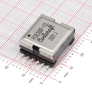

Document 522 -1 PoE Plus Transformers For 30 Watt Applications • Designed to meet 30 W PoE objectives of IEEE 802.3at. • Operates at 250 kHz with 36 – 72 Volts input • Isolation: 1500 Vrms pri to sec; 500 Vrms pri to aux Designer’s Kit C398 contains three samples of each part. Core material Ferrite Terminations RoHS tin-silver over tin over nickel over phos bronze. Other terminations available at additional cost. Weight 11.9 g Ambient temperature –40°C to +125°C Storage temperature Component: –40°C to +125°C. Packaging: –40°C to +80°C Resistance to soldering heat Max three 40 second reflows at +260°C, parts cooled to room temperature between cycles Moisture Sensitivity Level (MSL) 1 (unlimited floor life at

物料型号: - POE300F-33L - POE300F-50L - POE300F-12L - POE300F-19L - POE300F-24L
器件简介: PoEPlus变压器设计用于满足IEEE 802.3at标准的30W PoE目标,工作在250kHz,输入电压为36-72V。提供隔离:主副边1500Vrms,主辅边500Vrms。Designer’s Kit C398包含每种型号三个样本。材料为铁氧体,端接材料为锡银镀锡镀镍镀磷青铜。其他端接材料可额外成本提供。
引脚分配: - 主边(pri) - 副边(sec) - 辅助边(aux)
参数特性: - 零电流下的电感值(Inductance at 0A2 ±10%(H)) - 峰值电流下的最小电感值(Inductance at Ipk3 min(uH)) - 最大直流电阻(DCR max (Ohms)) - 漏感(Leakage inductance5 max(H)) - 匝数比(Turns ratio6) - 峰值电流(Ipk3 (A)) - 输出电压和电流(Output7)
功能详解: PoEPlus变压器用于30W应用,满足IEEE 802.3at标准。在PCB板上,主副边绕组需要并联连接。辅助绕组输出为12V。
应用信息: 适用于需要30W PoE的应用场合,如网络设备等。
封装信息: - 包装代码:POE300F-50LD,13英寸卷轴包装,EIA-481压花塑料胶带(每卷175件)。 - 塑料胶带:44毫米宽,0.4毫米厚,32毫米口袋间距,11.9毫米口袋深度。
