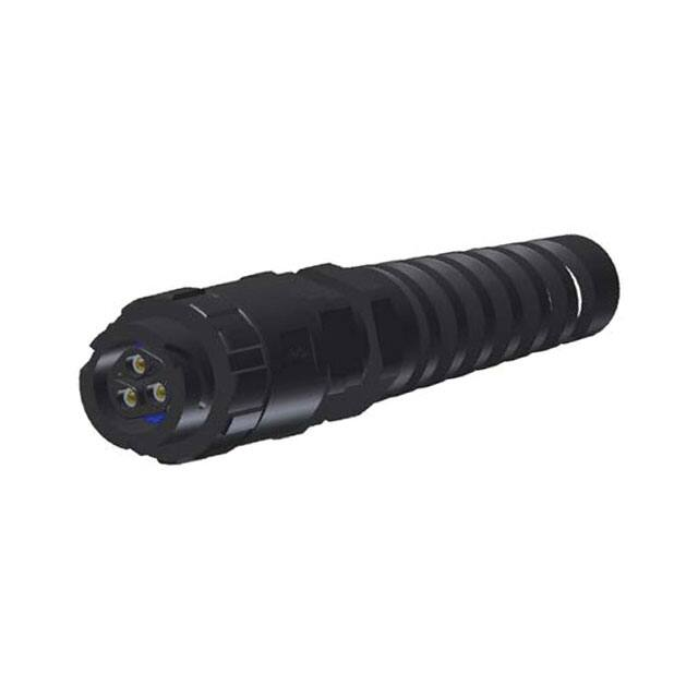

F E D C B A d Technical specification: Technische Daten: Working voltage/ max. 250 V AC/DC Betriebsspannung: Degree of protection/ IP67, rated when covered or fully mated with the appropriate mating connector/ Schutzart: IP67 bei Verwendung mit Kappe oder passenden Gegenstecker D Temperature range/ D -40 °C ... +100 °C Temperaturbereich: Current rating/ High power contact crimp; 20 A/ Strombelastbarkeit: Hochstromkontakt crimp; 20 A can be crimped with stranded copper wires: AWG 12-14/ crimpbar an Kupferlitze: AWG 12-14 UL-listed, File No./ E318363 UL- gelistet: 9,8 Materials/ Werkstoffe: Coupler ring/ PA GF (black/schwarz); UL 94 V-0; UL (f1) rated PA GF (black/schwarz); UL 94 V-0; UL (f1) rated PA (black/schwarz); UL 94 V-0; UL (f1) rated NBR, black/schwarz 11,4 Kupplungsring: Socket Housing/ Buchsengehäuse: 20 Cable gland/ Kabelanschluss: Cable gland rubber ring/ Kabelanschluss Gummidichtung: Cable fitting/ C Interfacial seal/ PA (black/schwarz); UL 94 V-0; UL (f1) rated Silicone, blue/ Stirnflächendichtung: Silikon, blau Retaining ring/ Stainless steel/ Haltering: Edelstahl High power contact/ Cu alloy, Au over Ni 152 Kabelverschraubung: C Hochstromkontakt: Installation specifiation/ Montagedaten: 3 x Conductor AWG 12, Type SJOOW / Connector kit is recommended for use with following cable type/ Stecker wird für die Verwendung mit folgenden Kabeltypen empfohlen: 3 x Leiter AWG 12, Typ SJOOW Crimp-Tool/ 360X21079X Tool insert/ 36-000430 Selector settings/ 8 for AWG 12 7 for AWG 14 12 Crimp-Werkzeug: Werkzeugeinsatz: Selektor Einstellungen: Turret Position/ B B Kopfposition: cable/Kabel n10-14 Al-5054-Power Assembly instruction/ Montageanleitung: Stripping Dimensions/ 3 Contacts will be supplied loose/ Kabelvorbereitung: The reproduction, distribution and utilization of this document as well as the communication of its contents to others without express authorization is prohibited. Offenders will be held liable for the payment of damages. All rights reserved in the event of the grant of a patent, utility model or design. Weitergabe sowie Vervielfältigung dieses Dokuments, Verwertung und Mitteilung seines Inhalts sind verboten, soweit nicht ausdrücklich gestattet. Zuwiderhandlungen verpflichten zu Schadenersatz. Alle Rechte für den Fall der Patent-, Gebrauchsmuster- oder Geschmacksmustereintragung vorbehalten. 3 Kontakte werden lose geliefert 8 n2,6 23,44 7,8 Part no. / Part marked Contact plating/ Art.-Nr./ Bedruckung: Kontakt Veredelung: 17-400313 Power Contact 20 A/ Plating, mating area: Gold flash over Nickel Hochstromkontakt 20 A: Veredelung Steckbereich: Gold über Nickel Plating, termination side: Veredelung Anschluss Seite: Plating, protection sleeve: Veredelung Schutzhülse Tin over Nickel Zinn über Nickel Nickel plated vernickelt A A dim. in mm drawn/ gez. appd./ gepr.. Index: d Ä6469 13.02.17 K.H. Status: InBearbeitung Date/Datum Name 02.10.13 Schmidt 02.10.13 Koch IP67 Power Bayonet 3pos. Socket Kit / crimp cable mount n10-14 mm IP67 Power-Bajonett 3pol. Buchsen-Kit / crimp Kabelmontage n10-14 mm scale/Maßstab: R 1:1 dwg no / Z.-nr.: DINA3 17K1A445 1/1 RoHS compliant/konform F E D C B A
