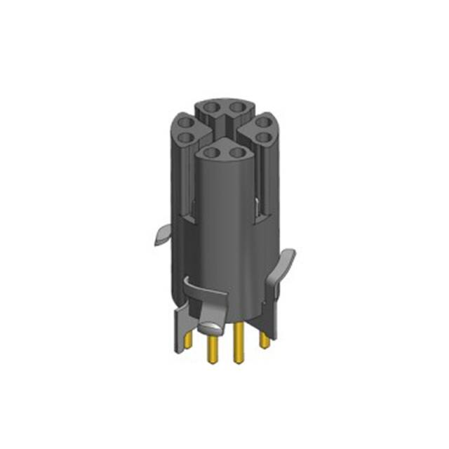

    CONN FMALE INSERT 8P GOLD SOLDER
43-02363 数据手册
Technical specification: 9,7 6,4 Sealing 17 Sealing surface 6,3 PCB surface Recommend flange height: 6,0 0,7 2,9 Ø0,75 1,3 0,9 8pos 48 V Current rating: IEC 61076-2-109 8pos 0,5 A at 40°C Transfer properties: IEC 61076-2-109 CAT 6A / 10 GBit/s Insulation resistance: IEC 60512 >=100 M Pollution degree: IEC 60664-1 3 Degree of protection: IEC 60529 IP 67, in mated condition Temperature range: EN 60512-11-10 EN 60512-11-4 -25°C ... +95°C -40°C -40°C ... +85°C Mating cycles: IEC 60512-9a >=100 Ω 4,8 Ø8,25 Rated voltage: IEC 61076-2-109 Spring force axial flange height 6,0mm: 3-4N Total spring force with case diameter 11,4mm: max 10N Materials: Ø10 Recommend case diameter: Ø11,4 Contact: CuZn, Ni b / Au 0,2 gal. Contact carrier: LCP GF Shielding cross: CuSn, Ni / sel. Sn Suitable for reflow soldering max. 60s / 250°C ,4 12 PCB layout proposal 5,6 2,8 Ø10 `0,03 5 3 6 7 2 1 8 Ø1 (8x) Coding Ø11,5 drawn 17.03.16 appd. general tolerance: 0 0,0 0,00 ∢ ± ± ± ± 0,50mm 0,25mm 0,10mm 1,5° THIS DRAWING MAY NOT BE COPIED OR REPRODUCED IN ANY WAY, AND MAY NOT BE PASSED ON TO A THIRD PARTY WITHOUT WRITTEN PERMISSION. OWNERSHIP AND COPYRIGHT OF CONEC GmbH 17.03.16 Ø1,3 (8x) Part no. packing unit Tape & Reel: Part no. packing unit in bulk: Description: Pos 43-02363TR 43-02363 SAL - 12X - IK8 / THR 8 title: dim. in mm RoHS & REACH compliant DO NOT ALTER CAD DRAWING BY HAND Ø0,8 (3x) date 5,6 4 Tape & Reel - parts with adhesive pad Ø11mm 2,8 1,7 Insulating body female M12x1 THR, X-Cod. name Brüntrup dwg no: Willer 43K1A2869 R part no: see table
