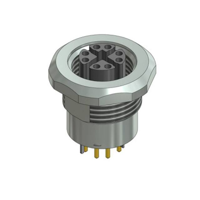

    CONN PLUG FMALE 8POS GOLD SOLDER
43-02760 数据手册
n8,25 Rated voltage: IEC 61076-2-109 8pos 48 V Current rating: IEC 61076-2-109 8pos 0,5 A at 40°C Transfer properties: IEC 61076-2-109 CAT 6A / 10 GBit/s Insulation resistance: IEC 60512 >=100 M Pollution degree: IEC 60664-1 3 Degree of protection: IEC 60529 IP 67, in mated condition Temperature range: EN 60512-11-10 EN 60512-11-4 -25°C ... +95°C -40°C -40°C ... +85°C Mating cycles: IEC 60512-9a >=100 Total spring force: max 10N 17 Technical specification: 1,3 6,9 1 PCB surface 2,9 13 Sealing 0,9 0,7 Ø0,75 Ø10 n12,5 Ω M12x1 Materials: M14x1 Width across flats 18 Ø19 Contact: CuZn, Ni b / Au 0,2 gal. Contact carrier: LCP GF, UL 94 V-0 Shielding cross: CuSn, Ni / sel. Sn Socket housing: CuZn, Ni Sealing: FPM Coplanarity of all contacts max 0,1mm Suitable for reflow soldering max. 60s / 250°C PCB layout proposal 5,6 2,8 4 12,6 +0,1 Ø10 `0,03 Cut-Out Front Panel RoHS & REACH compliant DO NOT ALTER CAD DRAWING BY HAND date drawn 23.03.16 general tolerance: 0,50mm 0,25mm 0,10mm 1,5° THIS DRAWING MAY NOT BE COPIED OR REPRODUCED IN ANY WAY, AND MAY NOT BE PASSED ON TO A THIRD PARTY WITHOUT WRITTEN PERMISSION. OWNERSHIP AND COPYRIGHT OF CONEC GmbH 7 2 23.03.16 8 Ø1 (8x) Ø0,8 (3x) Ø11,5 Ø1,3 (8x) Part no. packing unit Tape & Reel: Part no. packing unit in bulk: Description: Pos 43-02760TR 43-02760 SAL - 12X - FK8 - X13 / SMT 8 title: dim. in mm ± ± ± ± 6 Coding Mininum wall thickness 1,5mm, alternativ panel cut-out d=14,1 0 0,0 0,00 ∢ 3 1 n 14,1+0,1 appd. 5 5,6 Tape & Reel - parts with adhesive pad Ø11mm 2,8 1,7 Female socket M12x1 THR, X-Cod., frontmounting, X13 name Brüntrup dwg no: Willer 43K1A3043 R part no: see table
