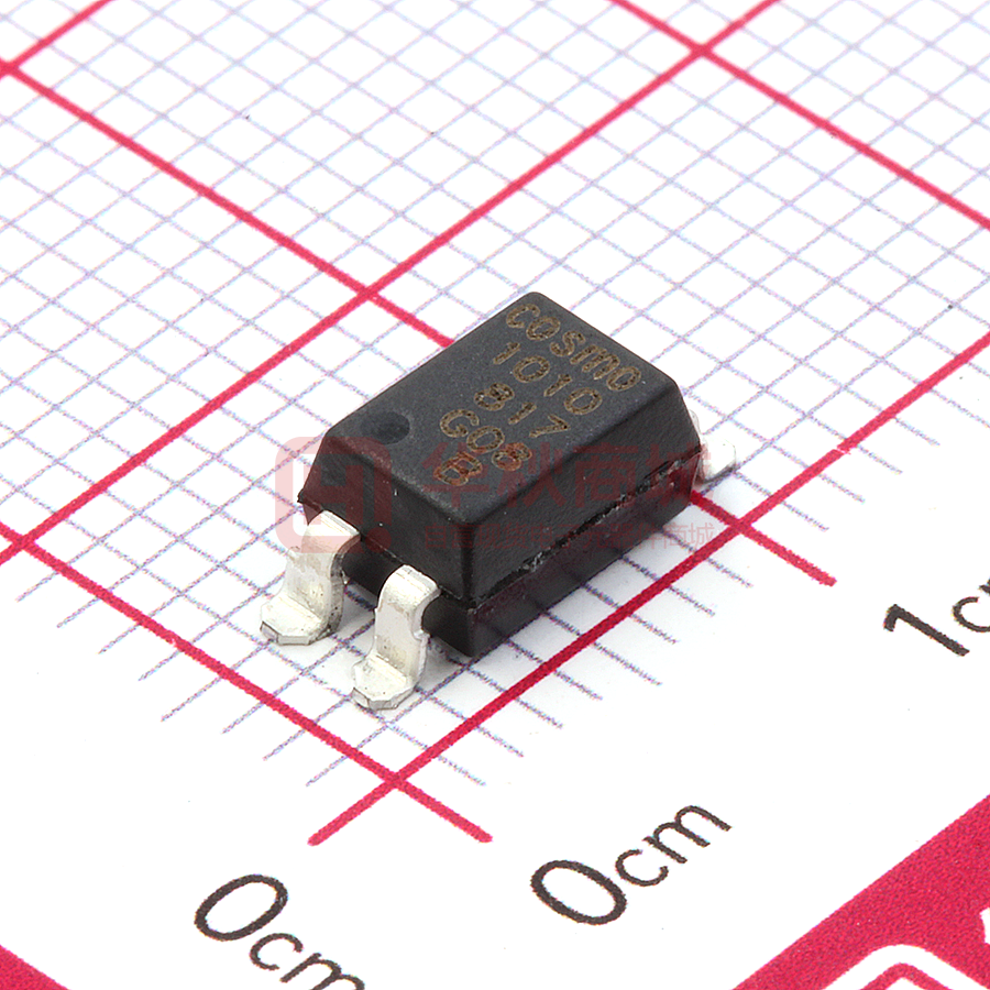

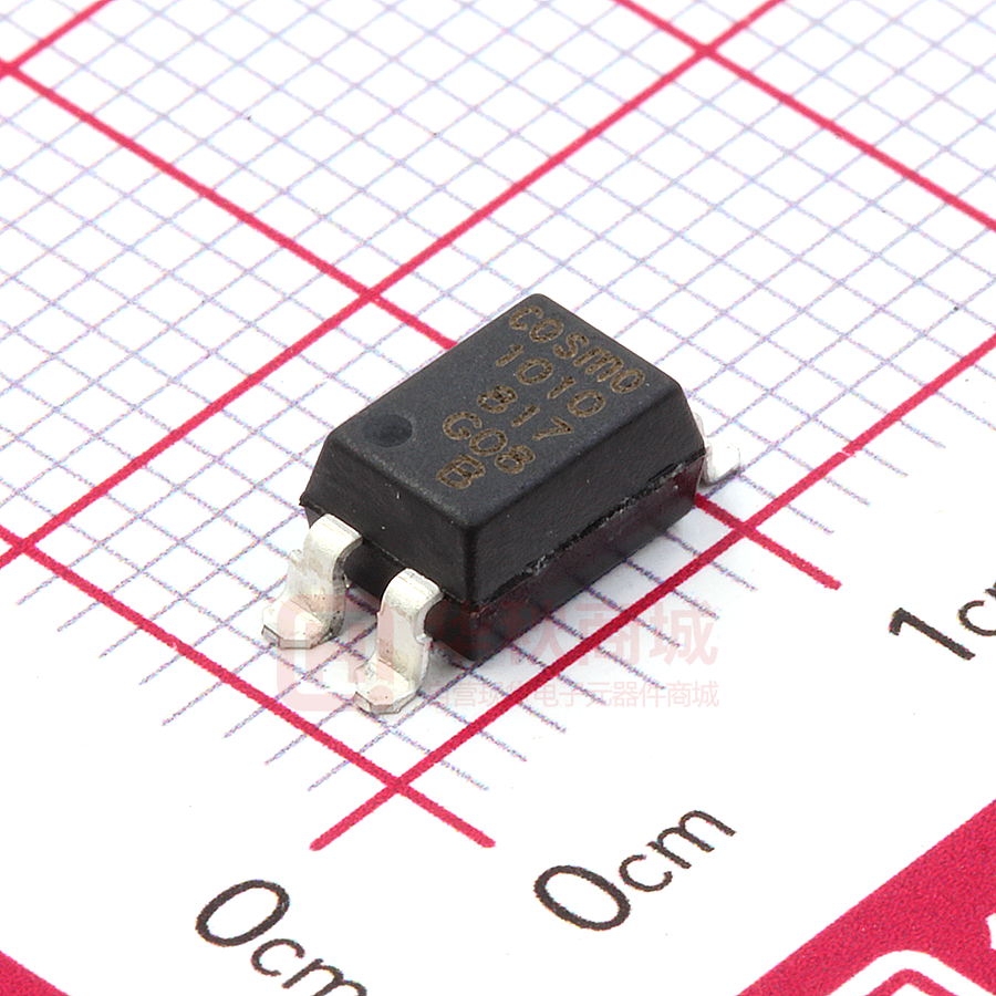

    单向光耦 Viso=5000Vrms VF(typ)=1.2V IF=50mA Vo=80V CTR=130~260%
K10104BTLD 数据手册
K1010 Series 4PIN PHOTOTRANSISTOR PHOTOCOUPLER cosmo   Schematic Description The K1010 series consist of an infrared emitting diode, optically coupled to a phototransistor detector. They are packaged in a 4-pin DIP package and available in wide-lead spacing and SMD option. 1. Anode 2. Cathode 3. Emitter 4. Collector  Features 1. Current transfer ratio ( CTR:Min. 50% at IF=5mA VCE=5V ) 2. High isolation voltage between input and output ( Viso:5000Vrms ) 3. Pb free and RoHS compliant 4. Agency Approvals • UL1577 / CUL C22.2 No.1 & NTC No.5, File No. E169586 • VDE EN60747, File No.101347 • FIMKO EN60065, File No. NCS/FI23149 A2 • FIMKO EN60950, File No. NCS/FI24584 A1 • SEMKO EN60065, File No. FI016484 • SEMKO EN60950, File No. FI016433 • CQC GB4943/GB8898-2011, File No.CQC10001049555 / CQC08001023986  Applications • System appliances • Measuring instruments • Computer terminals • Programmable controllers • Medical instruments • Physical and chemical equipment • Signal transmission between circuits of different potentials and impedances Cosmo Electronics Corp. Document No. 69P00001.1 -1- http://www.cosmo-ic.com K1010 Series 4PIN PHOTOTRANSISTOR PHOTOCOUPLER cosmo  Outside Dimension Unit : mm 1.Dual-in-line type. 2.Surface mount type. K10101X K10104X 7.62 7.62 4.60 6.50 6.50 0.25 3.50 2.70 0.25 1.00 10.00±0.4 0.50 1.20 0.10±0.1 0~10° 0.40 3.00 3.50 4.60 1.20 2.54 2.54 13.00° 13.00° 4.Long creepage distance for surface mount type. 3.Long creepage distance type K10106X K10103X 10.16 7.62 7.62 4.60 3.50 0.30 0.25 2.70 1.20 0~10° 1.20 2.54 0.50 TOLERANCE:±0.2mm 2.54  0.90±0.25 11.80+0.2 -0.5 0.25 3.50 10.16±0.50 3.00 0.90±0.25 0.25 4.60 6.50 6.50 Device Marking Notes: cosmo 1010 817 YWW cosmo 1010 817 YWW □ Cosmo Electronics Corp. Document No. 69P00001.1 -2- Y: Year code / WW: Week code □: CTR rank http://www.cosmo-ic.com K1010 Series 4PIN PHOTOTRANSISTOR PHOTOCOUPLER cosmo  Absolute Maximum Ratings (Ta=25℃) Parameter Input Output  Symbol Rating Unit Forward current IF 50 mA Peak forward current IFM 1 A Reverse voltage VR 6 V Power dissipation PD 70 mW Collector-emitter voltage VCEO 80 V Emitter-collector voltage VECO 6 V Collector current IC 50 mA Collector power dissipation PC 150 mW Total power dissipation Ptot 200 mW Isolation voltage 1 minute Viso 5000 Vrms Operating temperature Topr -55 to +115 ℃ Storage temperature Tstg -55 to +125 ℃ Soldering temperature 10 seconds Tsol 260 ℃ Electro-optical Characteristics Parameter Symbol Forward voltage VF Peak forward voltage VFM Input Output (Ta=25℃) Conditions Min. Typ. Max. Unit IF=20mA - 1.2 1.4 V IFM=0.5A - - 3.0 V Reverse current IR VR=4V - - 10 μA Terminal capacitance Ct V=0, f=1KHz - 30 - pF Collector dark current ICEO VCE=20V, IF=0 - - 0.1 μA Current transfer ratio CTR IF=5mA, VCE=5V 50 - 600 IF=1mA, VCE=5V 15 - - Collector-emitter saturation Transfer Isolation resistance characteristics Floating capacitance VCE(sat) IF=20mA, IC=1mA Riso DC500V - 0.1 10 5x10 11 10 % 0.2 V - Ω Cf V=0, f=1MHz - 0.6 1.0 pF Cut-off frequency fC VCC=5V, IC=2mA, RL=100Ω - 80 - KHz Response time (Rise) tr - 4 18 μs Response time (Fall) tf - 3 18 μs Cosmo Electronics Corp. Document No. 69P00001.1 VCE=2V, IC=2mA, RL=100Ω -3- http://www.cosmo-ic.com K1010 Series 4PIN PHOTOTRANSISTOR PHOTOCOUPLER cosmo Fig.1 Current Transfer Ratio vs. Forward Current 500 K1010 Model No. K1010 A K1010 B K1010 C K1010 D K1010 E Current Transfer Ratio CTR ( % ) Classification table of current transfer ratio is shown below. CTR ( % ) 80 ~ 160 130 ~ 260 200 ~ 400 300 ~ 600 50 ~ 600 VCE =5V Ta=25℃ 450 400 350 300 250 200 150 100 50 0 0 0.5 1 2 5 10 20 50 Forward Current IF (mA) Fig.2 Collector Power Dissipation Fig.3 Collector Dark Current vs. Ambient Temperature -5 250 10 200 10-6 Collector Dark Current ICEO ( A ) Collector Power Dissipation PC ( mW ) vs. Ambient Temperature 150 100 50 0 -55 10 10 10 VCE=20V -7 -8 -9 -10 10 -11 10 0 25 50 75 -55 115 125 Ambient Temperature Ta (℃) 75 115 Fig.5 Forward Current vs. Ambient Temperature vs. Forward Voltage 60 500 Forward Current IF ( mA ) Forward Current IF ( mA ) 50 Ambient Temperature Ta (℃) Fig.4 Forward Current 50 40 30 20 10 0 -55 25 0 0 25 50 75 100 50 Ta=75° C 50° C 25° C 0° C 20 -25° C 10 5 2 1 1.0 115 125 Ambient Temperature Ta (℃) Cosmo Electronics Corp. Document No. 69P00001.1 200 1.2 1.4 1.6 1.8 2.0 2.2 2.4 Forward Voltage VF (V) -4- http://www.cosmo-ic.com K1010 Series 4PIN PHOTOTRANSISTOR PHOTOCOUPLER cosmo Fig.6 Collector Current vs. Collector-Emitter Voltage Fig.7 Relative Current Transfer Ratio vs. Ambient Temperature 30 25 150 Ta=25°C 20mA Relative Current Transfer Ratio ( % ) Collector Current IC (mA) IF =30mA 20 15 10mA 10 5mA 5 IF =5mA VCE=5V 100 50 0 -55 0 0 1 2 3 4 5 6 7 8 9 Fig.8 Collector-Emitter Saturation Voltage 75 115 7 IF = 20m A Ic=1 m A 0 .1 4 Collector-Emitter Saturation Voltage VCE ( V ) Collector-Emitter Saturation Voltage VCE ( V ) 50 Voltage vs. Forward Current 0 .1 6 0 .1 2 0 .1 0 0 .0 8 0 .0 6 0 .0 4 0 .0 2 T a=25° C 6 Ic=0.5 mA 5 Ic=1 mA 4 Ic= 3m A 3 -5 5 0 25 50 75 Ic=7 mA 1 11 5 Ambient Temperature Ta (℃) Fig.11 Response Time (Fall) vs. Load Resistance Response Fall Time ( us ) 100 tr 20 10 5 0 Forward Current IF (mA) Fig.10 Response Time (Rise) vs. Load Resistance VCE =2V Ic = 2 m A T a=25 °C Ic=5m A 2 0 0 Response Rise Time ( us ) 25 Fig.9 Collector-Emitter Saturation vs. Ambient Temperature 50 0 Ambient Temperature Ta (℃) Collector-Emitter Voltage VCE (V) 100 -25 10 5 2 1 0 .5 0 .2 50 VC E = 2 V Ic= 2 m A T a = 2 5 °C tf 20 10 5 2 1 0 .5 0 .2 0 .1 0 .1 0 .1 1 0 .1 10 Load Resistance RL (KΩ) Cosmo Electronics Corp. Document No. 69P00001.1 1 10 Load Resistance RL (KΩ) -5- http://www.cosmo-ic.com K1010 Series 4PIN PHOTOTRANSISTOR PHOTOCOUPLER cosmo  Test Circuit for Response Time Vcc IF RL 1 4 2 3 Vce IF Vce 90% 10% tr Cosmo Electronics Corp. Document No. 69P00001.1 -6- tf http://www.cosmo-ic.com K1010 Series 4PIN PHOTOTRANSISTOR PHOTOCOUPLER cosmo  Recommended Soldering Conditions (a) Infrared reflow soldering:  Peak reflow soldering: 260℃ or below (package surface temperature)  Time of peak reflow temperature: 10 sec  Time of temperature higher than 230℃: 30-60 sec  Time to preheat temperature from 180~190℃: 60-120 sec  Time(s) of reflow: Two  Flux: Rosin flux containing small amount of chlorine (The flux with a maximum chlorine content of 0.2 Wt% is recommended.) Recommended Temperature Profile of Infrared Reflow 10 se c M ax. temperature 260℃ 230℃ 190℃ 3 0 -6 0 s e c 180℃ 6 0 -1 2 0 se c t (s ) (b) Wave soldering:  Temperature: 260℃ or below (molten solder temperature)  Time: 10 seconds or less  Preheating conditions: 120℃ or below (package surface temperature)  Time(s) of reflow: One  Flux: Rosin flux containing small amount of chlorine (The flux with a maximum chlorine content of 0.2 Wt% is recommended.) (c) Cautions:  Fluxes: Avoid removing the residual flux with freon-based and chlorine-based cleaning solvent.  Avoid shorting between portion of frame and leads. Cosmo Electronics Corp. Document No. 69P00001.1 -7- http://www.cosmo-ic.com K1010 Series 4PIN PHOTOTRANSISTOR PHOTOCOUPLER cosmo ● Numbering System K1010 X Y (Z) Notes: K1010 = Part No. X = Lead form option (1,3,4,6) Y = CTR rank option (A ~ E) Z = Tape and reel option (TLD, TRU) Option Description Packing quantity 4 (TLD) surface mount type package + TLD tape & reel option 2000 units per reel 4 (TRU) surface mount type package + TRU tape & reel option 2000 units per reel 6 (TLD) 6 (TRU) long creepage distance for surface mount type package + TLD tape & reel option long creepage distance for surface mount type package + TRU tape & reel option 2000 units per reel 2000 units per reel ● Recommended Pad Layout for Surface Mount Lead Form 2.Long creepage distance for surface mount type. 4 pin L 1.Surface mount type. 4 pin SMD Unit : mm Cosmo Electronics Corp. Document No. 69P00001.1 -8- http://www.cosmo-ic.com K1010 Series 4PIN PHOTOTRANSISTOR PHOTOCOUPLER cosmo ● 4-pin SMD Carrier Tape & Reel TOLERANCE:±0.2mm Cosmo Electronics Corp. Document No. 69P00001.1 -9- http://www.cosmo-ic.com K1010 Series 4PIN PHOTOTRANSISTOR PHOTOCOUPLER cosmo 參考用 ● 4-pin L Carrier Tape & Reel TOLERANCE:±0.2mm Cosmo Electronics Corp. Document No. 69P00001.1 - 10 - http://www.cosmo-ic.com K1010 Series 4PIN PHOTOTRANSISTOR PHOTOCOUPLER cosmo  Application Notice The content of datasheet is the guidance for product use only. cosmo takes no responsibility to the accuracy of the information provided here. For continuously improving all of products, including quality, reliability, function...etc., cosmo reserves the right to change the specification, characteristics, data, materials, and structure of products without notice. Please contact with cosmo to obtain the latest specification. It would be required to comply with the absolute maximum ratings listed in the specification. cosmo has no liability and responsibility to the damage caused by improper use of the products. cosmo products are intended to be designed for use in general electronics application list below: a. Personal computer b. OA machine c. Audio / Video d. Instrumentation e. Electrical application f. Measurement equipment g. Consumer electronics h. Telecommunication cosmo devices shall not be used or related with equipment requiring higher level of quality / reliability, or malfunction, or failure which may cause loss of human life, bodily injury, includes, without limitation: a. Medical and other life supporting equipments b. Space application c. Telecommunication equipment (trunk lines) d. Nuclear power control e. Equipment used for automotive vehicles, trains, ships...etc. This publication is the property of cosmo. No part of this publication may be reproduced or copied in any form or any means electronically or mechanically for any purpose, in whole or in part without any written permission expressed from cosmo. Cosmo Electronics Corp. Document No. 69P00001.1 - 11 - http://www.cosmo-ic.com
