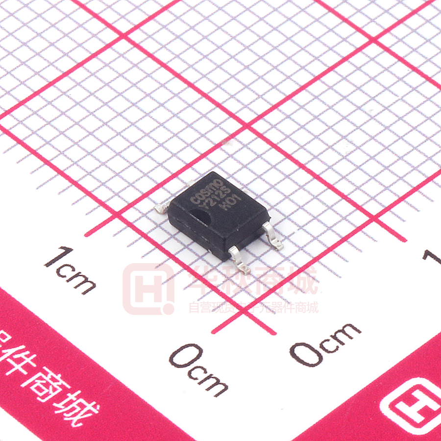

KAQY212 Series 4PIN 60V N.O TYPE SOLID STATE RELAY-MOSFET OUTPUT cosmo z Schematic z Description The KAQY212 series is robust, ideal for telecom and ground fault applications. It is a SPST normally open switch (1 4 3 1 2 Form A) that replaces electromechanical relays in many applications. It is constructed using a GaAlAs LED for actuation control and an integrated monolithic die for the switch output. The die, fabricated in a high-voltage dielectrically isolated technology, is comprised of a photodiode array, switch control circuitry and MOSFET 1 FORM A NORMALLY OPEN switches. 4 3 1 2 z Features 1. Normally open, single pole single throw 2. Control 60V AC or DC voltage 3. Switch 400mA loads 4. Controls low-level analog signals 5. High sensitivity, low ON resistance 6. Low-level off-state leakage current 7. High isolation voltage 5KV (DIP / SMD) 8. Pb free and RoHS compliant 9. MSL class 1 10. Agency Approvals: • UL Approved (No. E108430): UL508 • C-UL Approved (No. E108430) • FIMKO Approved: EN60065, EN60950 z Application • Telecommunications (PC, electronic notepad) • Modem • Telephone equipment • Security equipment • Sensors • Measuring and testing equipment • Factory automation equipment • High speed inspection machines Cosmo Electronics Corp. Document No. 69M00001.7 -1- http://www.cosmo-ic.com KAQY212 Series 4PIN 60V N.O TYPE SOLID STATE RELAY-MOSFET OUTPUT cosmo z Outside Dimension Unit:mm z Device Marking Notes: cosmo □ Y212 YWW Cosmo Electronics Corp. Document No. 69M00001.7 cosmo Y212□ □(Blank):DIP or SMD Y212S YWW S : SOP -2- Y:Year code / W:Week code http://www.cosmo-ic.com KAQY212 Series 4PIN 60V N.O TYPE SOLID STATE RELAY-MOSFET OUTPUT cosmo z Absolute Maximum Ratings (Ta=25℃) Item Input Symbol Rating Unit Continuous forward current IF 50 mA Peak forward current IFP 1 A Reverse voltage VR 5 V Power dissipation Pin 100 mW - 1.3 mW/℃ Breakdown voltage VB 60 V Continuous load current IL 400 mA Pout 500 mW KAQY212S KAQY212 1500Vrms 5000Vrms Derate linearly from 25℃ Output Power dissipation Isolation voltage Viso Isolation resistance (Vio=500V) Riso ≧10 10 Ω Total power dissipation Pt 550 mW Derate linearly from 25℃ - 2.5 mW/℃ Operating temperature Topr -40 to +85 ℃ Storage temperature Tstg -40 to +125 ℃ Junction temperature Tj 100 ℃ Tsot 260 ℃ Soldering temperature 10 seconds z Electro-optical Characteristics Parameter Input Output (Ta=25℃) Symbol Conditions Min. Typ. Max. Unit Forward voltage VF IF=10mA - 1.2 1.5 V Operation input current IFON VL=20V, IL=100mA - - 3.0 mA Recovery input current IFOFF VL=20V, IL≦5μA 0.2 - - mA IB=50μA 60 - - V Breakdown voltage VB Off-state leakage current ILEAK VL=60V, IF=0mA - 0.2 1.0 μA I/O capacitance Ciso VB=0V, f=1MHz - 6 - pF ON resistance RON IF=10mA, IL=100mA - 0.83 2.5 Ω Turn-on time TON IF=10mA, VL=20V - 0.3 1.5 ms Turn-off time TOFF IL=100mA, t=10ms - 0.1 1.5 ms z Turn-on / Turn-off Time In p u t 90% 10% O u tp u t TO N Cosmo Electronics Corp. Document No. 69M00001.7 -3- TOFF http://www.cosmo-ic.com KAQY212 Series 4PIN 60V N.O TYPE SOLID STATE RELAY-MOSFET OUTPUT cosmo z Schematic and Wiring Diagrams Output Configuration Schematic Load Connection Wiring Diagrams VIN 1 1 4 IL 4 1a 2 IF AC DC 2 3 1 4 Load VIN 3 IF Load IL 2 Cosmo Electronics Corp. Document No. 69M00001.7 VL (AC,DC) -4- VL(AC,DC) 3 http://www.cosmo-ic.com KAQY212 Series 4PIN 60V N.O TYPE SOLID STATE RELAY-MOSFET OUTPUT cosmo Fig.1 Load Current vs. Ambient Temperature Fig.2 On Resistance vs. Ambient Temperature 700 5 600 On Resistance (Ω) Load Current (mA) 4 500 400 300 200 100 0 -40 -20 0 20 40 60 80 100 3 2 1 0 Ambient Temperature Ta (℃) -4 0 -2 0 0 20 40 60 80 Ambient Temperature Ta (℃) Fig.3 Turn-on Time vs. Ambient Temperature Fig.4 Turn-off Time vs. Ambient Temperature 1.0 1 .0 Turn-off Time(ms) Turn-on Time (ms) 0.8 0.6 0.4 0.2 0 -40 -20 0 20 40 60 80 0 .8 0 .6 0 .4 0 .2 0 Ambient Temperature Ta (℃) 0 20 40 60 80 Fig.6 LED Turn-off Current vs. Ambient Temperature 5 2 .5 LED Turn-off Current (mA) LED Operate Current (mA) -2 0 Ambient Temperature Ta (℃) Fig.5 LED Operate Current vs. Ambient Temperature 4 3 2 1 0 -4 0 -40 -20 0 20 40 60 80 Ambient Temperature Ta (℃) Cosmo Electronics Corp. Document No. 69M00001.7 2 .0 1 .5 1 .0 0 .5 0 -4 0 -2 0 0 20 40 60 80 Ambient Temperature Ta (℃) -5- http://www.cosmo-ic.com KAQY212 Series 4PIN 60V N.O TYPE SOLID STATE RELAY-MOSFET OUTPUT cosmo Fig.7 LED Dropout Voltage vs. Ambient Temperature Fig.8 Voltage vs. Current Characteristics of Output at MOSFET Portion 1.9 500 400 50m A 30m A 20m A 10m A 1.5 1.3 300 Current (mA) LED Dropout Voltage (V) 600 1.7 5m A 1.1 200 - 1 .0 -0 .8 - 0 .6 - 0 .4 100 - 0 .2 0 .2 -1 0 0 0 .4 0 .6 0 .8 1 .0 -2 0 0 0.9 -3 0 0 -4 0 0 -5 0 0 0 -40 -20 0 20 40 60 80 -6 0 0 Voltage (V) Ambient Temperature Ta (℃) Fig.9 Turn-on Time vs. LED Forward Current Fig.10 Off-state Leakage Current vs. Load Voltage Off-state Leakage Current (A) 1.0 Turn-on Time (ms) 0.8 0.6 0.4 0.2 0 0 10 20 30 40 50 60 LED Forward Current (mA) Load Voltage (V) Fig.11 Turn-off Time vs. LED Forward Current Fig.12 Output Capacitance vs. Applied Voltage Output Capacitance (pF) 0 .5 Turn-off Time (ms) 0 .4 0 .3 0 .2 0 .1 0 0 10 20 30 40 50 60 40 30 20 10 0 LED Forward Current (mA) Cosmo Electronics Corp. Document No. 69M00001.7 50 0 10 20 30 40 60 80 Applied Voltage (V) -6- http://www.cosmo-ic.com KAQY212 Series 4PIN 60V N.O TYPE SOLID STATE RELAY-MOSFET OUTPUT cosmo z Using Methods Examples of resistance value to control LED forward current (IF=5mA) E 3.3V 5V 12V 15V 24V R Approx. 330 Ω Approx. 640 Ω Approx. 1.9K Ω Approx. 2.5K Ω Approx. 4.1K Ω 1. LED forward current must be more than 5mA,at E min. 2. LED forward current must be less than 50mA,at E max. Emax. Emin. Regulate the spike voltage generated on the inductive load as follows: Cosmo Electronics Corp. Document No. 69M00001.7 -7- http://www.cosmo-ic.com KAQY212 Series 4PIN 60V N.O TYPE SOLID STATE RELAY-MOSFET OUTPUT cosmo z Recommended Soldering Conditions (a) Infrared reflow soldering: „ Peak reflow soldering: 260℃ or below (package surface temperature) „ Time of peak reflow temperature: 10 sec „ Time of temperature higher than 230℃: 30-60 sec „ Time to preheat temperature from 60-120 sec 180~190℃: Two „ Number of reflows: Rosin flux containing small amount of chlorine „ Flux: (The flux with a maximum chlorine content of 0.2 Wt% is recommended.) Recommended Temperature Profile of Infrared Reflow 10 sec M ax. temperature 260℃ 230℃ 190℃ 3 0 -6 0 s e c 180℃ 6 0 -1 2 0 s e c t (s ) (b) Wave soldering: „ Temperature: 260℃ or below (molten solder temperature) „ Time: 10 seconds or less „ Preheating conditions: 120℃ or below (package surface temperature) „ Number of times: One „ Flux: Rosin flux containing small amount of chlorine (The flux with a maximum chlorine content of 0.2 Wt% is recommended.) (c) Cautions: „ Fluxes: Avoid removing the residual flux with freon-based and chlorine-based cleaning solvent. „ Avoid shorting between portion of frame and leads. Cosmo Electronics Corp. Document No. 69M00001.7 -8- http://www.cosmo-ic.com KAQY212 Series 4PIN 60V N.O TYPE SOLID STATE RELAY-MOSFET OUTPUT cosmo z Numbering System KAQY212 X (Y) Note: KAQY212 = Part No. X = Lead form option ( blank、S or A ) Y = Tape and reel option ( TLD、TRU ) Option Description Packing quantity A (TLD) surface mount type package + TLD tape & reel option 2000 units per reel A (TRU) surface mount type package + TRU tape & reel option 2000 units per reel S (TLD) S (TRU) small outline for surface mount type package + TLD tape & reel option small outline for surface mount type package + TRU tape & reel option 3000 units per reel 3000 units per reel z Recommended Pad Layout for Surface Mount Lead Form Unit:mm Cosmo Electronics Corp. Document No. 69M00001.7 -9- http://www.cosmo-ic.com KAQY212 Series 4PIN 60V N.O TYPE SOLID STATE RELAY-MOSFET OUTPUT cosmo 2.00 Unit:mm 10.60 16.00 7.50 4° 4.00 1.75 z 4-pin SMD Carrier Tape & Reel 0.33 8.00 4.20 TOLERANCE : ±0.2mm TLD TRU Direction of feed from reel Direction of feed from reel 1.5±0.5 +2.0 16.4-0 Cosmo Electronics Corp. Document No. 69M00001.7 - 10 - 2±0.2 http://www.cosmo-ic.com KAQY212 Series 4PIN 60V N.O TYPE SOLID STATE RELAY-MOSFET OUTPUT cosmo z 4-pin SOP Carrier Tape & Reel TOLERANCE :±0.2mm Cosmo Electronics Corp. Document No. 69M00001.7 - 11 - http://www.cosmo-ic.com KAQY212 Series 4PIN 60V N.O TYPE SOLID STATE RELAY-MOSFET OUTPUT cosmo z Application Notice The content of datasheet is the guidance for product use only. cosmo takes no responsibility to the accuracy of the information provided here. For continuously improving all of products, including quality, reliability, function...etc., cosmo reserves the right to change the specification, characteristics, data, materials, and structure of products without notice. Please contact with cosmo to obtain the latest specification. It would be required to comply with the absolute maximum ratings listed in the specification. cosmo has no liability and responsibility to the damage caused by improper use of the products. cosmo products are intended to be designed for use in general electronics application list below: a. Personal computer b. OA machine c. Audio / Video d. Instrumentation e. Electrical application f. Measurement equipment g. Consumer electronics h. Telecommunication cosmo devices shall not be used or related with equipment requiring higher level of quality / reliability, or malfunction, or failure which may cause loss of human life, bodily injury, includes, without limitation: a. Medical and other life supporting equipments b. Space application c. Telecommunication equipment (trunk lines) d. Nuclear power control e. Equipment used for automotive vehicles, trains, ships...etc. This publication is the property of cosmo. No part of this publication may be reproduced or copied in any form or any means electronically or mechanically for any purpose, in whole or in part without any written permission expressed from cosmo. (Shen zhen Fengzeji Electronic co.,LTD) 0755-25131889 Mobile phone:13826537931 E-mail:tony_liang@zebase-tech.com http://www.zebase-tech.com Cosmo Electronics Corp. Document No. 69M00001.7 - 12 - http://www.cosmo-ic.com
