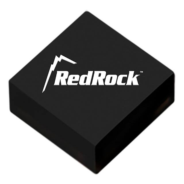

® REDROCK® RR132-1B12-551/552 REDROCK® RR132-1B13-551/552 TMR DIGITAL OPEN-DRAIN MAGNETIC SENSOR 1 Description 2 Features The RedRock® RR132-1B12-551/552 and RR132-1B13-551/552 are digital magnetic sensors ideal for use in medical, industrial, automotive, and consumer applications. It is based on patented Tunneling Magnetoresistance (TMR) technology with seamless CMOS integration. u Operate sensitivity of 30 G Lowest Average Current < 50 nA u Wide Supply Voltage range of 1.7V – 5.5V u Omnipolar Open-Drain Response u Operating Frequency of 2 Hz u Temperature Rated up to +125°C u RoHS & REACH Compliant u The RR132-1B12-551/552 and RR132-1B13-551/552 feature an operate sensitivity of 30 G (3 mT), with an omnipolar magnetic field response. They offer a wide supply voltage range from 1.7 up to 5.5 V, ideal for applications ranging from small battery-powered electronics to industrial machinery. They have the world’s lowest average current drain (50nA) for an active magnetic sensor, operating at 2 Hz and high operating temperature range from -40°C up to +125°C. 3 Applications Proximity Detection Rotary Sensing u Fluid Level Detection u Door & Lid Closure Detection u Utility Meters u Portable Medical Devices u Motor Controllers u Consumer Electronics u Wake-Up mProcessor u u Device Packages Device Information Part Series Package RR132-1B12-551 RR132-1B12-552 RR132-1B13-551 RR132-1B13-552 SOT-23-3 LGA-4 SOT-23-3 LGA-4 Body Size (mm) Temp Rating ºC 2.9 x 1.6 x 1.2 1.45 x 1.45 x 0.44 2.9 x 1.6 x 1.2 1.45 x 1.45 x 0.44 - 40 to +85 - 40 to +85 - 40 to +125 - 40 to +125 SO T-2 3-3 LG A -4 Device Nomenclature Ordering Information Functional Block Diagram for Digital Open-Drain Output RR132-X X X X-Y Y Y Series Magnetic Polarity Response 1 = Omnipolar 3 = Bipolar/Latch 2 = Unipolar VDD CURRENT SOURCE DUTY CYCLE CONTROL TMR SENSOR Bop /Brp Comparators VREF OUTPUT LOGIC & LATCH GND redrock@cotorelay.com | www.cotorelay.com DIGITAL OPENDRAIN OUTPUT Magnetic Sensitivity (G) A: Op 9, Rel 5 E: Op 15, Rel 10 B: Op 30, Rel 20 F: Op 70, Rel 50 C: Op 10, Rel -10 Clock Frequency (Hz) 1: 2 5: 250 9: 10000 2: 10 6: 500 U: 100+Turbo (10000) 3: 20 7: 2500 Package 1: SOT-23-3 2: LGA-4 5: SOT-23-5 Output Response 5: Open Drain Supply Voltage (V) 5: 1.7 -- 5.5 Temp Rating (ºC) 2: - 40 -- + 85 3: - 40 -- + 125 © Coto Technology 2022. All rights reserved. | rev. 09272022 | page 1 REDROCK® RR132-1B12-551/552 REDROCK® RR132-1B13-551/552 TMR DIGITAL OPEN-DRAIN MAGNETIC SENSOR ® 4 Specifications 4.1 Absolute Environmental Ratings1,2 Parameters Units Min Typ Operating Temperature (TOP) (RR132-1B12-551/552) ºC -40 +85 Operating Temperature (TOP) (RR132-1B13-551/552) ºC -40 +125 Storage Temperature (TSTG) ºC -65 +150 Junction Temperature (TJ) ºC +150 Soldering Temperature (3 cycles, 1 min.) (TSOL) ºC +260 ESD Level Human Body Model per JESD22-A114 V ±4000 ESD Level Charged Device Model (CDM) per JESD22-C101 V ±500 Junction-to-Ambient Thermal Resistance (LGA-4) ºC/W 165 Junction-to-Ambient Thermal Resistance (SOT-23-3) ºC/W 215 Maximum Magnetic Field Exposure (BMAX) G Max ±2000 4.2 Absolute Electrical Ratings1,2 Parameters Units Min V -0.3 6.0 V -0.3 6.0 mA -20 20 Supply Voltage (VDD) Open-Drain Output Voltage (Active Low)(VOUT-OD) Input and Output Current (IIN/IOUT) Typ Max 4.3 Operating Electrical Characteristics for RR132-1B12-551/552 and RR132-1B13-551/5523 Parameters Units Min Typ Max Supply Voltage (VDD) V 1.7 3.0 5.5 Power-On Time (tON)(VDD > 1.7 V) ms 50 75 Peak Power-On Current mA Output Voltage (High) (VOUTH) V Output Voltage (Low) (VOUTL) V Under Voltage Lockout Threshold Rising VDD (VUVLO-RISE) V Under Voltage Lockout Threshold Falling VDD (VUVLO-FALL) V 1.4 90% VDD 10% VDD 1.60 1.44 1.64 1.53 Under Voltage Lockout Hysteresis (VUV-HYST) mV 70 Average Supply Current @ VDD=1.7 V, fSW=2 Hz (IddAVG) nA 50 Average Supply Current @ VDD=3.0 V, fSW=2 Hz (IddAVG) nA 70 Notes: 1. Exceeding Absolute Ratings may cause permanent damage to the device. 2. Unless otherwise specified, all characteristics are measured at 25ºC. 3. Unless otherwise specified, VDD = 1.7 V to 5.5 V, TA = -40ºC to +85ºC (1B12), -40ºC to +125ºC (1B13). Typical values are VDD = 3.0 V and TA = +25ºC. ESD Note: This product uses semiconductors that can be damaged by electrostatic discharge (ESD). When handling, proper ESD precautions should be taken to avoid performance degradation or loss of functionality. Damage due to inappropriate handling is not covered under warranty. page 2 | © Coto Technology 2022. All rights reserved. | rev. 09272022 redrock@cotorelay.com | www.cotorelay.com REDROCK® RR132-1B12-551/552 REDROCK® RR132-1B13-551/552 TMR DIGITAL OPEN-DRAIN MAGNETIC SENSOR ® 4 Specifications (cont.) 4.4 Operating Characteristics for RR132-1B12-551/552 and RR132-1B13-551/5521 Parameters Units Min Typ Max Switching Frequency (fSW) Hz 1 2 4 Active Mode Time (tACT) ms Idle Mode Time @fSW =2 Hz (tIDLE) ms 250 500 1000 Operate Point (BOPN) G 23 30 38 Operate Point (BOPS) G -38 -30 -23 Release Point (BRPN) G 14 20 27 Release Point (BRPS) G -27 -20 -14 Hysteresis (BHYST) G 5 10 2 2.6 Notes: 1. Unless otherwise specified, VDD = 1.7 V to 5.5 V, TA = -40ºC to +85ºC (1B12), -40ºC to +125ºC (1B13). Typical values are VDD = 3.0 V and TA = +25ºC. 2. Conditions: BHYST = | BOP - BRP | ESD Note: This product uses semiconductors that can be damaged by electrostatic discharge (ESD). When handling, proper ESD precautions should be taken to avoid performance degradation or loss of functionality. Damage due to inappropriate handling is not covered under warranty. 5 Magnetic Response For more information please contact Coto Technology at RedRock@cotorelay.com. 5.1 Axis of Sensitivity Sensor Axis of Sensitivity (SOT-23-3 package) Sensor Axis of Sensitivity (LGA-4 package) Note: The most straightforward way of aligning a magnet with a TMR sensor is by lining up the magnet’s magnetization axis with the sensor’s Axis of Sensitivity (as shown above). However, there are many other alignments and orientations that will also achieve proper operation. For any questions, or to learn more, please contact Coto Technology. redrock@cotorelay.com | www.cotorelay.com © Coto Technology 2022. All rights reserved. | rev. 09272022 | page 3 REDROCK® RR132-1B12-551/552 REDROCK® RR132-1B13-551/552 TMR DIGITAL OPEN-DRAIN MAGNETIC SENSOR ® 5 Magnetic Response (cont.) 5.2 Magnetic Response Table (SOT-23-3 package) Step 1: Step 2: Step 3: Step 4: Step 5: Sensor is powered without magnetic field. Magnet applied, polarity North. Magnet removed. Magnet applied, polarity South. Magnet removed. N SS N S N N S Scenario OR OR N S OMNIPOLAR SENSOR OUTPUT N SS N LOW HIGH S N LOW HIGH (Activated) HIGH (Activated) 5.3 Magnetic Response Table (LGA-4 package) Step 1: Step 2: Step 3: Step 4: Step 5: Sensor is powered without magnetic field. Magnet applied, polarity North. Magnet removed. Magnet applied, polarity South. Magnet removed. N S NS N S S N Scenario OR OR NS N S N S OMNIPOLAR SENSOR OUTPUT LOW HIGH S N LOW HIGH (Activated) (Activated) 5.4 Magnetic Response Output Diagram VOUT Output HIGH BOPS BOPN Output LOW BRPN BRPS S - Pole page 4 | © Coto Technology 2022. All rights reserved. | rev. 09272022 0 N - Pole redrock@cotorelay.com | www.cotorelay.com HIGH REDROCK® RR132-1B12-551/552 REDROCK® RR132-1B13-551/552 TMR DIGITAL OPEN-DRAIN MAGNETIC SENSOR ® 6 Application Information RR132 Application Circuit The output voltage of the RR132 is active low, meaning that while a sufficiently strong magnetic field is present, the output voltage is low. With the open-drain output, the system voltage can range from (Vdd + 0.3V) up to absolute max of 6.0Vdc. A decoupling capacitor between the supply voltage and ground is required with placement close to the magnetic sensor. A capacitor with a value of 1.0mF, placed not more than 10 mm from the sensor, is required. 6.1 Application Circuit (SOT-23-3) Vdd 6.2 Application Circuit (LGA-4) VSYS VDD VSYS RPULLUP 1 1.0mF 1.0mF 2 RR132 RPULLUP 2 RR132 VOUT 1 VOUT 3 4 GND GND 6.3 Package Pinout (SOT-23-3) 6.4 Package Pinout (LGA-4) GND GND 3 3 GND 4 DNC 1 1 2 1 2 VDD OUT VDD OUT 3GND OUT 4 3 DNC 2 OUT VDD 1 2 VDD 7 Dimensions Millimeters (Inches) 7.1 SOT-23-3 Package Top View End View 2.90 ± 0.15 (0.114 ± .006) 1.45 ± 0.20 (0.057 ± .008) 1.20 ± 0.20 (.047 ± .008) 3 2.80 ± 0.25 (.110± .010) 0.10 ± 0.10 (.004 ± .004) 0.44 ± 0.15 (.017 ± .006) 0.6 (0.024) 1.60 ± 0.15 (0.063 ± .006) 1 Side View 2 0.40 ± 0.15 (.016 ± .006) 1.90 (0.075) redrock@cotorelay.com | www.cotorelay.com 1.10 ± 0.15 (.043± .006) © Coto Technology 2022. All rights reserved. | rev. 09272022 | page 5 REDROCK® RR132-1B12-551/552 REDROCK® RR132-1B13-551/552 TMR DIGITAL OPEN-DRAIN MAGNETIC SENSOR ® 7 Dimensions Millimeters (Inches) 7.2 LGA-4 Package Top View Side View 1.45 ± .05 (0.055 ± .002) 1.45 ± .05 (0.055 ± .002) 1 Bottom View 0.436 ± .05 (0.017±.002) PIN1 0.65 (0.026) PIN 1 4 0.35 ± .05 (0.014 ± .002) 0.65 (0.026) 2 3 0.225 ± .05 (0.008± .002) 0.225 ± .05 (0.008 ± .002) 0.14 (0.005) 0.35 ± .05 (0.014 ± .002) 8 TMR Sensor Location 8.2 LGA-4 Package 8.1 SOT-23-3 Package 1.45 mm 3 1.45 mm 1.60 mm 2 0.80 mm 1 2 3 0.84 mm 1 0.84 mm 4 1.45 mm 2.90 mm 8.3 SOT Package - Side View 0.76 mm page 6 | © Coto Technology 2022. All rights reserved. | rev.09272022 8.4 LGA Package - Side View 0.20 mm redrock@cotorelay.com | www.cotorelay.com REDROCK® RR132-1B12-551/552 REDROCK® RR132-1B13-551/552 TMR DIGITAL OPEN-DRAIN MAGNETIC SENSOR ® 9 TMR Sensor & Switch Packaging 9.1 SOT-23-3 Tape & Reel Packaging Standard packaging is Tape & Reel containing 3,000 pieces. MSL Rating is 1. 4.0 ± 0.01 Ø1.5 +0.1 -0 2.0 ± 0.05 1.75 ± 0.1 1 4.0 ± 0.01 see Fig. B below see Fig. A below Fig. A DIRECTION OF FEED 2.55 ± 0.1 0.6 5º MAX. .3 .3 Bo3.2 ± 0.1 1.1 ± 0.1 5º MAX.(2X) 3 0. R R0 .3 2 Ø1.1 ± 0.1 5º MAX.(2X) R0 R0 1 2.75 2 Fig. B 0.20 ± 0.05 Ao3.3 ± 0.1 5º MAX.(2X) 8.0 ± 0.2 3.5 ± 0.05 3 3 Ko1.47 ± 0.1 0.2 0.4 0.6 0.8 Ø178.0±1 60.3±0.5 EIAJ-RRM0BB 16 18 19 20 15 0.8 0.6 0.4 0.2 17 9.30±0.5 (measured at hub) 17.40±0.20 1.50±0.10 1.50±0.10 Ø13.20±0.20 2.20±0.30 redrock@cotorelay.com | www.cotorelay.com © Coto Technology 2022. All rights reserved. | rev. 09272022 | page 7 REDROCK® RR132-1B12-551/552 REDROCK® RR132-1B13-551/552 TMR DIGITAL OPEN-DRAIN MAGNETIC SENSOR ® 9 TMR Sensor & Switch Packaging 9.2 LGA-4 Tape & Reel Packaging Standard packaging is Tape & Reel containing 3,000 pieces. MSL Rating is 3. 1.5 +0.1 +0 2.0 ± 0.05 4.0 ± 0.10 3.5 ± 0.05 see Fig. A below see Fig. B below DIRECTION OF FEED 4.0 ± 0.10 8.0 ± 0.2 1.75 ± 0.1 Fig. A Fig. B 0.25±0.02 1.65±0.5 1.65±0.05 5º MAX. 5º MAX. .5 ±0 .00 9.0 +1.5 0.00 Ø1 Ø1 78 0.5 .00 1.4 78 ±0 .5 5.00 ± 0 0 0.65±0.05 0.8 0.6 0.4 ±0 0.2 0.4 0.6 0.8 page 8 | © Coto Technology 2022. All rights reserved. | rev.09272022 redrock@cotorelay.com | www.cotorelay.com PC PC Ø60.0±0.05 .50 Ø178.0±0.05 3.0 Ø5 Ø1 6.0 0.2 REDROCK® RR132-1B12-551/552 REDROCK® RR132-1B13-551/552 TMR DIGITAL OPEN-DRAIN MAGNETIC SENSOR ® 9 TMR Sensor & Switch Packaging 9.3 RedRock Package Codes RR132-1B12-511 / RR132-1B13-511 (SOT-23-3) 3 Part Code Year Year Week # Seq # JD # # # # 1 RR132-1B12-512 / RR132-1B13-512 (LGA-4) 2 L ## Part Code Lot Code 9.4 RedRock TMR Packaging Box Dimensions – 14x10x6 inches Box Dimensions – 18x14x12 inches • Fits 1 to 3 reels = 3000 to 9000 pcs • Weight for 3000 pcs = 0.90 kilos • Weight for 9000 pcs = 1.00 kilos • Fits 4 to 24 reels = 12000 to 72000 pcs • Weight for 12000 pcs = 1.50 kilos • Weight for 72000 pcs = 4.90 kilos redrock@cotorelay.com | www.cotorelay.com © Coto Technology 2022. All rights reserved. | rev. 09272022 | page 9 REDROCK® RR132-1B12-551/552 REDROCK® RR132-1B13-551/552 TMR DIGITAL OPEN-DRAIN MAGNETIC SENSOR ® 10 Suggested Pb-Free Reflow Profile Notes: 1. Fully compatible with standard no-lead solder profile, 260ºC for 30 seconds max (3 cycles max). 2. Profile shown as example. Users are advised to develop their own board-level profile. 3. Suggested Pb-free reflow profile derived from IPC/JEDEC J-STD-020E. 4. Temperature tolerance: +0ºC, as measured at any point on the package or leads 5. MSL rating of 1 (SOT-23-3 only) compatible with J-STD-020 or equivalent. 6. MSL rating of 3 (LGA-4 and Leaded LGA-4) compatible with J-STD-020 or equivalent. 7. All temperatures refer to the center of the package, measured on the package body surface that is facing up during assembly reflow (e.g., livebug). If parts are reflowed in other than the normal live bug assembly reflow orientation (i.e., dead-bug), Tp shall be within ± 2°C of the live bug Tp and still meet the Tc requirements, otherwise, the profile shall be adjusted to achieve the latter. To accurately measure actual peak package body temperatures, refer to JEP140 for recommended thermocouple use. 8. Reflow profiles in this document are for classification/preconditioning and are not meant to specify board assembly profiles. Actual board assembly profiles should be developed based on specific process needs and board designs and should not exceed the parameters in this table. 260ºC Max. Ramp Up Rate = 3ºC/s Max. Ramp Down Rate = 6ºC/s 217ºC Preheat Area Temperature 200ºC 255ºC 30 seconds max. 60-150 seconds 150ºC 60-120 seconds 25 Time 25ºC to Peak Time 11 Suggested Solder Pad Layout Dimensions in mm (inches) 11.1 SOT-23-3 Solder Pad Layout 11.2 LGA-4 Solder Pad Layout 0.76 (.030) 0.65 (0.026) 1.12 (.044) 1.58 (0.062) 0.38 (0.015) 0.65 (0.026) 3.16 (.124) 0.38 (0.015) 0.94 (.037) 1.90 (.075) page 10 | © Coto Technology 2022. All rights reserved. | rev.09272022 redrock@cotorelay.com | www.cotorelay.com REDROCK® RR132-1B12-551/552 REDROCK® RR132-1B13-551/552 TMR DIGITAL OPEN-DRAIN MAGNETIC SENSOR ® 12 Graphs - Typical Electrical Characteristics CDD = 1.0 µF (unless otherwise specified) 12.1 RR132-1B12-551 / 552 Average Supply Current vs. Supply Voltage vs. Temperature 12.2 RR132-1B12-551 / 552 Average Supply Current vs. Temperature vs. Supply Voltage 700 700 VDD = 1.8 V -40ºC +25ºC +85ºC +125ºC 500 700 400 -40ºC 600 +25ºC +85ºC 300 +125ºC 500 200 400 100 300 0 200 1.5 2.1 2.7 3.3 3.9 4.5 5.1 5.7 Supply Voltage (V) 100 VDD = 3.0 V VDD = 3.3 V 500 VDD = 3.6 V 700 VDD = 5.0 V 400 VDD = 1.8 V 600 VDD = 2.7 V VDD = 3.0 V 300 VDD = 3.3 V 500 VDD = 3.6 V 200 VDD = 5.0 V 400 100 300 0 200 -50 -20 10 40 70 100 130 160 130 160 Ambient Temperature (ºC) 100 Average Supply Current vs. Supply Voltage vs. Temperature Average Supply Current vs. Temperature vs. Supply Voltage 0 0 1.5 2.1 2.7 3.3 3.9 4.5 5.1 5.7 -50 -20 10 40 70 100 Supply Voltage (V) Ambient Temperature (ºC) Average Supply Current vs. Supply Voltage vs. Temperature Average Supply Current vs. Temperature vs. Supply Voltage 12.3 RR132-1B12-551 / 552 Sampling Frequency vs. Supply Voltage vs. Temperature 3.0 2.5 Sampling Frequency Sampling (Hz) Frequency (Hz) VDD = 2.7 V 600 Average Supply Current Average (nA)Supply Current (nA) Average Supply Current Average (nA)Supply Current (nA) 600 2.0 3.0 1.5 2.5 1.0 2.0 -40ºC +25ºC 0.5 1.5 +85ºC +125ºC 0.0 1.0 1.5 2.1 2.7 -40ºC +25ºC 0.5 +85ºC +125ºC 3.3 3.9 4.5 5.1 5.7 5.1 5.7 Supply Voltage (V) Sampling Frequency vs. Supply Voltage vs. Temperature 0.0 1.5 2.1 2.7 3.3 3.9 4.5 Supply Voltage (V) Sampling Frequency vs. Supply Voltage vs. Temperature redrock@cotorelay.com | www.cotorelay.com © Coto Technology 2022. All rights reserved. | rev. 09272022 | page 11 REDROCK® RR132-1B12-551/552 REDROCK® RR132-1B13-551/552 TMR DIGITAL OPEN-DRAIN MAGNETIC SENSOR ® 12 Graphs - Typical Magnetic Characteristics CDD = 1.0 µF (unless otherwise specified) 12.4 RR132-1B12-551 / 552 BOPN (Blue) and BOPS (Red) vs. Supply Voltage at +25ºC 12.5 RR132-1B12-551 / 552 BRPN (Blue) and BRPS (Red) vs. Supply Voltage at +25ºC 40 30 30 20 20 10 30 30 0 BRP (G) BOP (G) 40 10 BOPN BOPS BRPN 0 20 BRPS 20 10 -10 10 0 -30 BRP (G) BOP (G) 10 -20 BOPN BOPS 10 -40 1.5 2.0 2.5 3.0 -20 3.5 4.0 4.5 5.0 5.5 -30 -10 6.0 20 2.5 3.0 3.5 4.0 4.5 5.0 5.5 3.0 3.5 4.0 4.5 5.0 5.5 6.0 5.0 5.5 6.0 BRPN (Blue) and BRPS (Red) vs. Supply Voltage at +25ºC 1.5 6.0 2.0 2.5 3.0 3.5 4.0 4.5 Supply Voltage (V) Supply Voltage (V) BOPN (Blue) and BOPS (Red) vs. Supply Voltage at +25ºC BRPN (Blue) and BRPS (Red) vs. Supply Voltage at +25ºC 30 12.7 RR132-1B12-551 / 552 BRPN (Blue) and BRPS (Red) vs. Operating Temperature at VDD =3.0 V 20 10 30 BRP (G) BOP (G) 2.5 -30 2.0 40 10 BOPN 30 0 BOPS 20 10 BRPN 0 20 BRPS -10 10 BRP (G) 10 -20 BOP (G) 2.0 -20 BOPN (Blue) and BOPS (Red) vs. Supply Voltage at +25ºC 12.6 RR132-1B12-551 / 552 BOPN (Blue) and BOPS (Red) vs. Operating Temperature at VDD =3.0 V 30 1.5 Supply Voltage (V) -40 40 BRPS Supply Voltage (V) -30 1.5 BRPN -20 0 BOPN 0 -30 BOPS 10 -40 -50 -20 10 40 70 -20 Operating Temperature (ºC) -30 BOPN (Blue) and BOPS (Red) vs. Operating Temperature at VDD=3.0 V 100 130 BRPN -20 0 -30 -10 BRPS -50 -20 10 40 70 100 130 100 130 Operating Temperature (ºC) -20 -40 BRPN (Blue) and BRPS (Red) vs. Operating Temperature at VDD=3.0 V -30 -50 -20 10 40 70 100 Operating Temperature (ºC) BOPN (Blue) and BOPS (Red) vs. Operating Temperature at VDD=3.0 V page 12 | © Coto Technology 2022. All rights reserved. | rev.09272022 130 -50 -20 10 40 70 Operating Temperature (ºC) BRPN (Blue) and BRPS (Red) vs. Operating Temperature at VDD=3.0 V redrock@cotorelay.com | www.cotorelay.com ® REDROCK® RR132-1B12-551/552 REDROCK® RR132-1B13-551/552 TMR DIGITAL OPEN-DRAIN MAGNETIC SENSOR Revision History Date Description 1 09/14/2021 Modified Axis of Sensitivity on LGA-4 Package (Section 7.2) 2 10/29/2021 Modified Bottom View Dimensions (Section 8.2 LGA-4 Package) 3 12/14/2021 Corrected Misleading Elements in Table 4.3 4 02/28/2022 Revised/expanded Magnetic Response Section (Section 5) 5 02/28/2022 Removed sections 7 and 10, consolidating information within new Section 5 6 02/28/2022 Modified packaging drawings (9.1 and 9.2) 7 02/28/2022 Modified LGA Sensor Location package drawings (8.2 and 8.4) 8 02/28/2022 Added RedRock Package Code section (9.3) 9 03/04/2022 Added Package Pinouts (Section 6) 10 03/04/2022 Modified Power On Time (Table 4.3) 11 03/08/2022 Added ESD Level Charged Device Model (Table 4.1) 12 03/08/2022 Modified Under Voltage Lockout Hysteresis (Table 4.3) 13 09/27/2022 Modified LGA Package Pinout (6.4) redrock@cotorelay.com | www.cotorelay.com © Coto Technology 2022. All rights reserved. | rev. 09272022 | page 13
