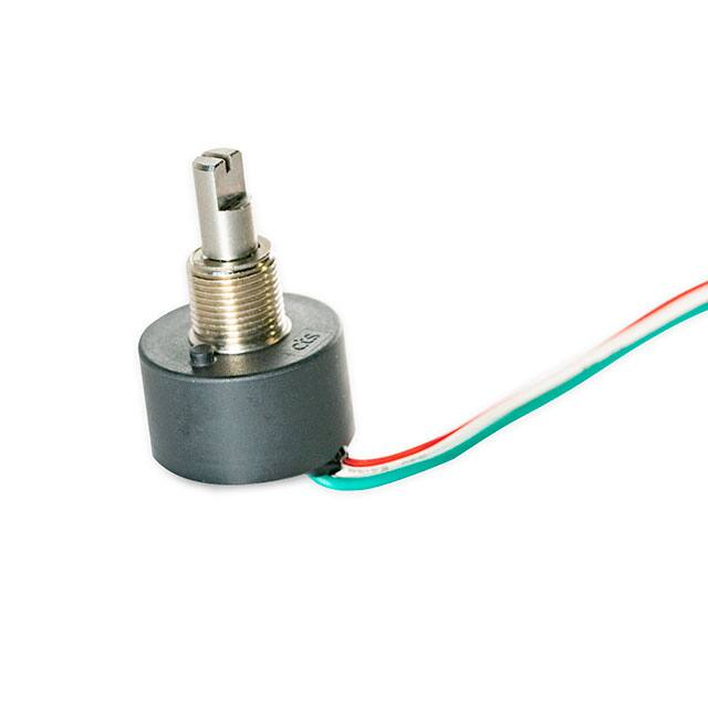

285CCCRSAAB4C1 数据手册
Series 285 Non-Contacting Position Sensor § § § § § Compact 22 mm size Extended rota!onal life (10 Million cycles) Wide temperature range (-40°C to +125°C) Precision linearity (± 0.5% and ± 0.25% op!ons) Dust & water protec!on (IP50, 54 and 67 op!ons) Applications § § § § § Pa!ent pla orm posi!on feedback Pneuma!c control valve posi!on feedback Draw wire posi!on sensors Actuator motor posi!on feedback Foot pedal, twist thro!le, steering, and li" & shu!le Ordering Information Series Code Spec. Bushing Sha" Termina!on A ± 0.5% Length Length B 285 C ± 0.25% Sha" Trim 2 3 Bearing Style P Output Type S A A Code Spec. Code C 250 mm wires A B 4 B Spec. Code ± 0.5% ± 0.25% * 4 5 6 *Consult factory Code Spec. Code Spec. 3 C 3/8” L x 3/8” D, 32 UNEF 9 mm L, M10 x 0,75 A B Analog output, CW Analog output, CCW Code C D 2 3 Code F L R P 2021-11-25 Rev. G Code Spec. S Sleeve bearing Spec. Fla!ed (6 mm dia.) Fla!ed (1/4” dia.) Round (6 mm dia.) Round (1/4” dia.) Rota!on Angle C RRRTTT T Loca!ng Lug T T 1 Spec. IP50 IP54 IP67 Code Total EEA Stops A B C Spec. 20 mm 25 mm 3/4" 7/8” IP Ra!ng Linearity Opera!ng Voltage 270° 320° 360° 260° 310° 360° Code Spec. Code A B 3.3V 5.0V 0 1 270° 320° N/A Spec. No lug Le" 7,4 mm Page 1 of 4 ©2021 CTS® Corpora!on. Informa!on/product(s) subject to change. No warranty that product(s) will meet the stated specifica!ons for customer specific applica!ons or test equipment. Visit www.ctscorp.com for list of applicable patent(s), more informa!on, or to request a quote. Series 285 Non-Contac�ng Posi�on Sensor Electrical Specifications Sensor Function Output Independent Linearity Hysteresis Output Voltage Output Overvoltage Limits Output Current Output Load Input Voltage Supply Voltage Absolute Limits Supply Current Resolution Dielectric Strength Insulation Resistance Electrostatic Discharge (ESD) Min Typical Max Unit Analog -0.5% 5% -6 -8 5 -10% -18 12 BIT at 360° 1 minute at 500 VDC HBM 1 10 5 10 1000 -4 +0.5% 0.2% 95% +18 +8 Vsup Vsup VDC mA kΩ VDC VDC mA +10% +18 15 750 VDC MegΩ kV +4 Mechanical and Environmental Soldering Total Mechanical Travel Without Stops With End Stops Static Stop Strength Push and Pull Shaft Strength Rotational Life Sleeve Bearing Operating Speed Vibration Rotational Torque Panel Nut tightening Torque IP Rating Marking Packaging Operating Temperature Range Storage Temperature Range Weight Maximum manual temperature, 350°C for 5 seconds 360° con�nuous 270° or 320° 40 in-oz. min. 13.6 kgf min. 10 Million cycles 120 RPM max. 30 Gs, 50 to 500 Hz 72 gf-cm 25 in-lb 50, 54 or 67 CTS logo, part number, date code Standard an�-sta�c bulk packaging -40°C to +125°C -40°C to +140°C 21 gm All tes�ng is performed at room ambient condi�ons except as noted. Users should verify device actual performance in their specific applica�ons. This product is compliant to RoHS3 Direc�ve 2011/65/EU & 2015/863 Amendments of Annex II on 31 March 2015. Custom and value-added op�ons available on request. Please contact your sales representa�ve for addi�onal informa�on. 2021-11-25 Rev. G Page 2 of 4 ©2021 CTS® Corpora�on. Informa�on/product(s) subject to change. No warranty that product(s) will meet the stated specifica�ons for customer specific applica�ons or test equipment. Visit www.ctscorp.com for list of applicable patent(s), more informa�on, or to request a quote. Series 285 Non-Contacng Posion Sensor Mechanical Specifications Series 285 w/Slo!ed Sha" 2021-11-25 Rev. G Page 3 of 4 ©2021 CTS® Corporaon. Informaon/product(s) subject to change. No warranty that product(s) will meet the stated specificaons for customer specific applicaons or test equipment. Visit www.ctscorp.com for list of applicable patent(s), more informaon, or to request a quote. Series 285 Non-Contacng Posion Sensor Mechanical Specification Series 285 w/Fla!ed Sha" Electrical Specification Series 285 Output Graph 2021-11-25 Rev. G Page 4 of 4 ©2021 CTS® Corporaon. Informaon/product(s) subject to change. No warranty that product(s) will meet the stated specificaons for customer specific applicaons or test equipment. Visit www.ctscorp.com for list of applicable patent(s), more informaon, or to request a quote.
