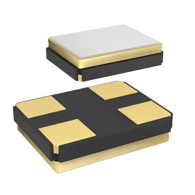

Model 402 402 SubSub-Miniature Surface Mount Crystal Features        Hermetic Ceramic Surface Mount Package Fundamental Crystal Design Frequency Range 16 – 80MHz Frequency Tolerance, ±30ppm Standard Frequency Stability, ±30ppm Standard Operating Temperature Range to -40°C to +105°C Tape and Reel Packaging, EIA-481 Part Dimensions: 2.0 × 1.6 × 0.55mm • 3.9mg Standard Frequencies – see Page 5 for common frequencies. * Check with factory for availability of frequencies not listed. Applications  IoT and IIoT Applications  Wireless Communications  FPGA/Microcontrollers  USB Interfaces  Computer Peripherals  Portable Equipment  Test and Measurement  M2M Communications  Wearables Description CTS Model 402 incorporates a high Q quartz resonator and is ideal for supporting a wide range of commercial and industrial applications. Ordering Information Model 402 Mode of Os ci l l a ti on F F requency Code [ MHz ] XXX Mode Code Fundamental F Code 1 X 2 Y 3 Code Frequency Product Frequency Code Notes: 1] 2] 3] 4] Tol era nce @ +25°C 3 1 T em pera ture Sta bi l i ty 3 Tolerance ±10ppm ±15ppm ±20ppm ±25ppm ±30ppm Code 1 X 2 Tem pera ture Ra ng e C Loa d Ca pa ci ta nce A Temp. Range Code 2 A -10°C to +60°C 2 C -20°C to +70°C 2 D -30°C to +85°C 3 I -40°C to +85°C G -40°C to +105°C 4 Stability ±10ppm ±15ppm ±20ppm Code Y 3 5 Stability ±25ppm ±30ppm ±50ppm Code W T V K J A Capacitance 5pF 6pF 7pF 8pF 9pF 10pF Pa cka g i ng R Code R Packing 3k pcs./reel Code L B C D E S Capacitance 12pF 13pF 16pF 18pF 20pF Series Refer to document 016-1454-0, Frequency Code Tables. 3-digits for frequencies

物料型号:CTS Model 402
器件简介:CTS Model 402是一款小型表面贴装晶体,具有高Q石英谐振器,适用于支持广泛的商业和工业应用。
引脚分配:文档中没有提供具体的引脚分配图,但提到了JEDEC终止代码(e4),以及2、4号引脚和金属盖在内部是连接的。
参数特性: - 频率范围:16 – 80MHz - 频率容差:±30ppm标准 - 工作温度范围:-40°C 至 +105°C - 封装:2.0 × 1.6 × 0.55mm,重量3.9mg - 标准频率稳定性:±30ppm - 老化率:典型每年±3ppm
功能详解:晶体振荡器用于提供稳定频率,适用于物联网、无线通信、FPGA/微控制器、USB接口、便携设备、测试和测量、机器对机器通信、可穿戴设备等应用。
应用信息:适用于商业和工业应用,包括物联网、无线通信、便携设备等。
封装信息:表面贴装封装,尺寸为2.0 × 1.6 × 0.55mm,采用胶带和卷轴包装,符合EIA-481标准。
订购信息:提供了详细的订购代码和温度容差、频率稳定性、电容值等参数的选择指南。
注意事项:产品仅适用于标准商业应用,供应商不承担任何超出规格条件使用的责任。
