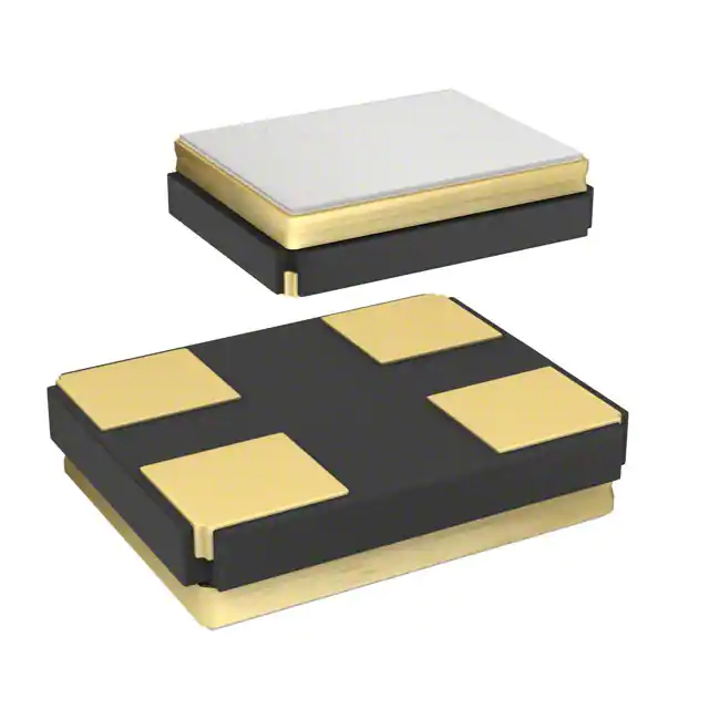

Model 41 416 UltraUltra-Miniature Surface Mount Crystal Features        Hermetic Ceramic Surface Mount Package Fundamental Crystal Design Frequency Range 24 – 80MHz Frequency Tolerance, ±30ppm Standard Frequency Stability, ±30ppm Standard Operating Temperature Range to -40°C to +105°C Tape and Reel Packaging, EIA-481 Part Dimensions: 1.6 × 1.2 × 0.45mm • 2.51054mg Standard Frequencies – see Page 5 for common frequencies. * Check with factory for availability of frequencies not listed. Applications  IoT and IIoT Applications  Wireless Communications  FPGA/Microcontrollers  USB Interfaces  Computer Peripherals  Portable Equipment  Test and Measurement  M2M Communications  Wearables Description CTS Model 416 incorporates a high Q quartz resonator and is ideal for supporting a wide range of commercial and industrial applications. Ordering Information Model 416 Mode of Os ci l l a ti on F F requency Code [ MHz ] XXX Mode Code Fundamental F Code 1 X 2 Y 3 Code Frequency Product Frequency Code Notes: 1] 2] 3] 4] Tol era nce @ +25°C 3 1 T em pera ture Sta bi l i ty 3 Tolerance ±10ppm ±15ppm ±20ppm ±25ppm ±30ppm Code 1 X 2 Tem pera ture Ra ng e C Loa d Ca pa ci ta nce K Temp. Range Code 2 A -10°C to +60°C 2 C -20°C to +70°C 2 D -30°C to +85°C 3 I -40°C to +85°C G -40°C to +105°C 4 Stability ±10ppm ±15ppm ±20ppm Code Y 3 5 Stability ±25ppm ±30ppm ±50ppm Code W T V K J A Capacitance 5pF 6pF 7pF 8pF 9pF 10pF Pa cka g i ng R Code R Packing 3k pcs./reel Code L B C D E S Capacitance 12pF 13pF 16pF 18pF 20pF Series Refer to document 016-1454-0, Frequency Code Tables. 3-digits for frequencies

物料型号: CTS Model 416
器件简介: 该型号是一款超小型表面贴装晶体,具有高Q石英谐振器,适用于广泛的商业和工业应用。
引脚分配: 文档中未明确提供引脚分配图,但提到了内部连接,其中终止#2、#4和金属盖在内部连接。
参数特性: - 工作温度范围:-40°C 至 +105°C - 存储温度:-40°C 至 +125°C - 频率范围:24MHz 至 80MHz - 频率容差:±10ppm 至 ±30ppm - 频率稳定性:±10ppm 至 ±50ppm - 负载电容:参见订购信息 - 串联电阻:0Ω - 绝缘电阻:500MΩ
功能详解: - 该晶体振荡器适用于物联网(IoT)、无线通信、FPGA/微控制器、USB接口、便携设备、测试和测量、机器对机器通信(M2M)、可穿戴设备等应用。
应用信息: 适用于商业和工业应用,不适用于非商业应用或可能使产品暴露在规格之外条件的应用。
封装信息: 尺寸为1.6 × 1.2 × 0.45mm,采用EIA-481标准的带式和卷轴包装。
