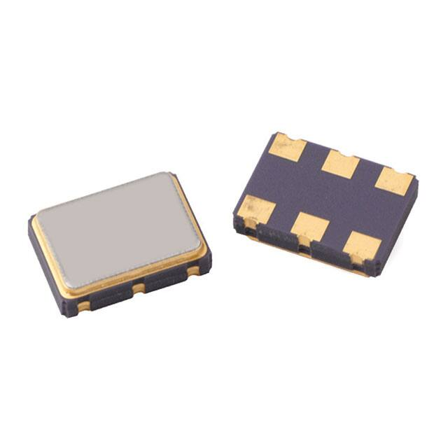

Model 637 Very Low Jitter LVPECL or LVDS Clock Features        Ceramic Surface Mount Package Very Low Phase Jitter Performance, 500fs Maximum Fundamental or 3rd Overtone Crystal Design Frequency Range 10 – 320MHz * +2.5V or +3.3V Operation [+1.8V LVDS only] Output Enable Standard Tape and Reel Packaging, EIA-418 Applications     SerDes Storage Area Networking Broadband Access SONET/SDH/DWDM     PON Ethernet/GbE/SyncE Fiber Channel Test and Measurement Part Dimensions: 7.0 × 5.0 × 2.0mm • 178.462mg Standard Frequencies - 25.00MHz - 125.00MHz - 50.00MHz - 150.00MHz - 74.1758MHz - 155.52MHz - 74.25MHz - 156.25MHz - 100.00MHz - 161.1328MHz - 187.50MHz - 200.00MHz - 212.50MHz - 250.00MHz - 312.50MHz * See Page 9 for additional developed frequencies. Check with factory for availability of frequencies not listed. Description CTS Model 637 is a low cost, high performance clock oscillator supporting differential LVPECL or LVDS outputs. Employing the latest IC technology, M637 has excellent stability and low jitter/phase noise performance. Ordering Information Output Type P Model 637 Code P L E V [MHz] XXX or XXXX Output LVPECL - Pin 1 Enable LVDS - Pin 1 Enable LVPECL - Pin 2 Enable LVDS - Pin 2 Enable Code 6 5 4 3 2 Code Frequency Product Frequency Code 1 Notes: 1] 2] 3] 4] Frequency Stability 3 Frequency Code Temperature Range I Stability ±20ppm 2 ±25ppm ±30ppm ±50ppm ±100ppm Supply Voltage 3 Code M 2 3 Code Temp. Range -10°C to +60°C A -20°C to +70°C C -40°C to +85°C I G -40°C to +105°C 3 Packaging T Voltage +1.8Vdc 4 +2.5Vdc +3.3Vdc Packing Code 1k pcs./reel T Refer to document 016-1454-0, Frequency Code Tables. 3-digits for frequencies
637P16006C2T
物料型号:CTS Model 637
器件简介:CTS Model 637是一款低成本、高性能的时钟振荡器,支持差分LVPECL或LVDS输出。采用最新的IC技术,具有出色的稳定性和低抖动/相位噪声性能。
引脚分配: - 1: EOH或N.C.(标准使能或无连接) - 2: N.C.或EOH(无连接或可选使能) - 3: GND(电路和封装地) - 4: 输出(RF输出) - 5: 输出(互补RF输出) - 6: Vcc(供电电压)
参数特性: - 工作频率范围:10 - 320MHz - 供电电压:+2.5V或+3.3V(LVDS仅+1.8V) - 相位抖动性能:最大500fs - 封装类型:陶瓷表面贴装 - 温度范围:-40°C至+105°C
功能详解: - 该器件提供了非常低的相位抖动性能,适用于SerDes、PON、存储区域网络、宽带接入等多种应用。
应用信息: - 适用于以太网/千兆以太网/同步以太网、光纤通道、SONET/SDH/DWDM、测试和测量等应用。
封装信息: - 封装尺寸:7.0 × 5.0 × 2.0mm - 重量:178.462mg - 标准频率列表和额外开发的频率见文档第9页。
