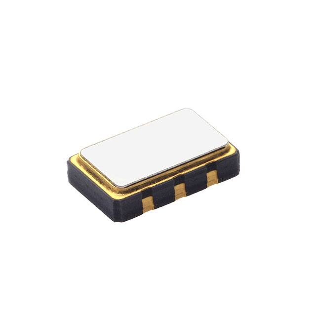

Model 645H Very Low Jitter HCSL Clock Features         High Speed Current Steering Logic [HCSL] Output Ceramic Surface Mount Package Low Phase Jitter Performance, 500fs Typical Fundamental or 3rd Overtone Crystal Design Frequency Range 13.5MHz – 160MHz * +2.5V or +3.3V Operation Output Enable Standard Tape and Reel Packaging, EIA-418 Part Dimensions: 5.0 × 3.2 × 1.4mm • 58.1mg Applications     PCI Express [PCIe] Data Storage Systems Ethernet Line Cards Serial ATA Express [SATAe]     Intel Chipsets Network Servers Switches and Routers Set-Top Boxes/DVRs Standard Frequencies - 25MHz - 100MHz - 27MHz - 106.25MHz - 50MHz - 125MHz - 155.52MHz - 156.25MHz * Check with factory for availability of frequencies not listed. Description CTS Model 645H is a low cost, high performance clock oscillator supporting HCSL output. Employing the latest IC technology, M645H has excellent stability and low phase jitter performance. Ordering Information Output Type H Model 645 Code H Frequency Stability 3 Frequency Code [MHz] XXX or XXXX Output HCSL - Pin 1 Enable Code 5 4 3 2 Code Frequency Product Frequency Code 1 Temperature Range I Stability ±25ppm ±30ppm ±50ppm ±100ppm Supply Voltage 3 Code 2 3 Code Temp. Range -20°C to +70°C C -40°C to +85°C I G -40°C to +105°C 2 Packaging T Voltage +2.5Vdc +3.3Vdc Packing Code 1k pcs./reel T Notes: 1] Refer to document 016-1454-0, Frequency Code Tables. 3-digits for frequencies

物料型号:CiS Model 645H
器件简介:CiS Model 645H是一款低成本、高性能的时钟振荡器,支持高速电流驱动逻辑[HCSL]输出。采用最新的IC技术,具有出色的稳定性和低相位抖动性能。
引脚分配: - Pin 1: Enable(使能) - Pin 2: No Connect(无连接) - Pin 3: GND(电路和封装地) - Pin 4: Output(RF输出) - Pin 5: Output(互补RF输出) - Pin 6: Vcc(供电电压)
参数特性: - 工作频率范围:13.5MHz至160MHz - 相位抖动性能:典型值为500fs - 供电电压:+2.5V或+3.3V - 频率稳定性:±25ppm至±100ppm - 工作温度范围:-40°C至+105°C - 存储温度:-50°C至+125°C
功能详解: - 该器件支持基本频率或三次谐波晶体设计。 - 输出使能功能,通过Pin 1控制。 - 差分输出电压和占空比在特定的供电电压下有特定的典型值。
应用信息: - 适用于PCI Express、数据存储系统、以太网线路卡、SATA Express、Intel芯片组、网络服务器、交换机和路由器、机顶盒/DVR等。
封装信息: - 封装类型:陶瓷表面贴装封装 - 尺寸:5.0 × 3.2 × 1.4mm - 重量:58.1mg - 胶带和卷轴包装,符合EIA-418标准。
