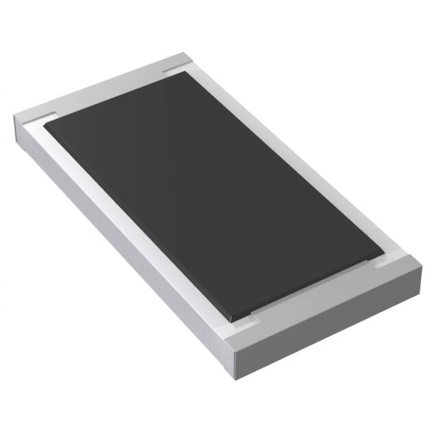

Series 73Mx Current Sensing Resistors – Metal Plate FEATURES Very Low Resistance Suitable for Current Limiting, Current Detection, Motor Control, Power Supply and Hard Disk Drives High Precision and Excellent Accuracy for Current Detection Good Electrical Characteristics Surface Mount Package Nickel Barrier Solder-Coated Pads [e3] Reflow capable per JEDEC J-STD-020, 260°C maximum Tape and Reel Packaging RoHS/Green Compliant (6/6) ORDERING INFORMATION 73M R TOLERANCE TYPE 1 = 1 Watt Rating 2 = 2 Watt Rating G = ±2% F = ±1% RESISTOR CODE Notes: 1. No dashes or spaces to appear in part number. 4-Digit Resistor Code "R" indicates decimal point. 2. Example Part Numbers: 73M1R005F [5m Ohms, ±1%] 73M1R100G [100m Ohms, ±2%] Ex. R005 = 5m Ohms R100 = 100m Ohms 73M2R015F [15m Ohms, ±1%] Not all performance combinations and resistor values may be available. Contact your local CTS Representative or CTS Customer Service for availability. STANDARD RESISTOR VALUES 73M1 Standard Resistance Values (Based on EIA E24 Sequence) 4-Digit Code Resistor Resistor Resistor Resistor Resistor Value Code Value Code Value R003 0.016 R016 0.047 0.003 R004 0.018 R018 0.050 0.004 R005 0.020 R020 0.051 0.005 R006 0.022 R022 0.056 0.006 0.007 R007 0.024 R024 0.062 R008 0.027 R027 0.067 0.008 0.009 R009 0.030 R030 0.068 R010 0.033 R033 0.075 0.010 0.011 R011 0.036 R036 0.082 R012 0.039 R039 0.091 0.012 0.013 R013 0.040 R040 0.100 R015 0.043 R043 0.015 Document No. 008-0336-0 Resistor Code R047 R050 R051 R056 R062 R067 R068 R075 R082 R091 R100 73M2 Standard Resistance Values (Based on EIA E24 Sequence) 4-Digit Code Resistor Resistor Resistor Resistor Value Code Value Code R005 0.018 R018 0.005 0.006 R006 0.020 R020 R007 0.022 R022 0.007 R008 0.024 R024 0.008 0.009 R009 0.027 R027 R010 0.030 R030 0.010 R011 0.033 R033 0.011 0.012 R012 0.036 R036 R013 0.039 R039 0.013 R015 0.040 R040 0.015 0.016 R016 Page 1 - 3 www.ctscorp.com Rev. A Series 73Mx Current Sensing Resistor – Metal Plate ELECTRICAL CHARACTERISTICS Type Rated Wattage (Watts) 73M1 1 73M2 2 Resistance (Ohms) Tolerance (%) 0.003 - 0.009 ±1, ±2 0.010 - 0.100 0.005 - 0.009 0.010 - 0.040 ±1 ±1, ±2 ±1 T.C.R (ppm/°C) 0.003 0.005 0.010 R< R R < 0.005 : ±300 R < 0.010 : ±180 R 0.100 : ±100 0.010 : ±200 0.010 : ±100 Rated Ambient Temperature Operating Temperature Range +70°C -55°C to +180°C +70°C -55°C to +180°C MECHANICAL SPECIFICATION PACKAGE DRAWING Dimensions (mm) 73M1 73M2 L W T a b c 6.2 ±0.3 6.4 ±0.3 3.1 ±0.2 3.5 ±0.2 1.0 ±0.2 1.2 Max. 2.5 ±0.2 3.2 ±0.2 0.8 ±0.2 --- 1.2 ±0.3 1.0 ±0.2 W T b 73M1 c c a L L W T b 73M2 c c a RECOMMENDED LAND PATTERN A Type Dimensions (mm) A C B C 73M1 2.90 8.10 3.60 73M2 3.50 8.30 4.00 B Document No. 008-0336-0 Page 2 - 3 Rev. A Series 73Mx Current Sensing Resistor – Metal Plate PACKAGING INFORMATION EMBOSSED TAPE [mm] REEL [mm] Type A B F J 73M1 3.5 ±0.1 6.6 ±0.1 8.0 ±0.10 1.5 ±0.2 73M2 4.0 ±0.1 6.9 ±0.1 8.0 ±0.10 1.5 +0.1 -0.0 L M 1.3 ±0.1 0.3 ±0.05 1.4 ±0.1 0.25 ±0.05 Type Quantity Per Reel A (mm) 73M1 73M2 1,000 1,000 15.4 ±1.0 15.4 ±1.0 M J L F Document No. 008-0336-0 Page 3 - 3 Rev. A

物料型号:73Mx
器件简介: - 这些电阻具有非常低的电阻值,适合用于电流限制、电流检测、电机控制、电源供应和硬盘驱动器。 - 它们具有高精度和出色的电流检测准确性。 - 具有良好的电气特性和表面安装封装。 - 镍障碍焊锡涂层垫[E3],可按照JEDEC J-STD-020标准进行再流,最高温度260°C。 - 胶带和卷轴包装。 - 符合RoHS/绿色合规性(6/6)。
引脚分配:文档中没有提供具体的引脚分配信息,因为它是关于电阻的文档,通常电阻不需要引脚分配
参数特性: - 额定瓦特数:73M1为1瓦特,73M2为2瓦特。 - 电阻值范围:73M1为0.003至0.100欧姆,73M2为0.005至0.040欧姆。 - 公差:±1%或±2%。 - 温度系数:对于0.003至0.005欧姆的电阻,每摄氏度300ppm;对于0.005至0.010欧姆的电阻,每摄氏度+180ppm;对于0.010至0.100欧姆的电阻,每摄氏度±100ppm。
功能详解: - 这些电阻用于电流感应,可以用于检测和限制电流,适用于多种电子设备和系统。
应用信息: - 适用于电流限制、电流检测、电机控制、电源供应和硬盘驱动器等应用。
封装信息: - 提供了73M1和73M2两种尺寸的机械规格,包括长度、宽度、厚度等。 - 推荐焊盘图案的尺寸信息。
订购信息: - 电阻值和公差通过4位数字代码表示,例如73M1R005F表示5毫欧姆,±1%公差。 - 订购时需注意电阻值和公差,以及是否所有性能组合和电阻值都可用。
包装信息: - 提供了73M1和73M2的卷轴包装信息,包括卷轴尺寸和每卷的数量。
