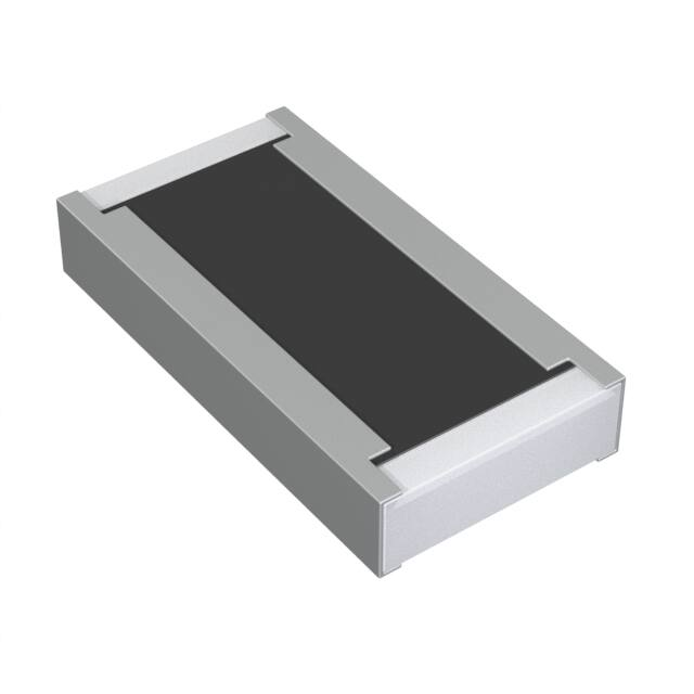

    厚膜电阻 680mΩ ±1% 750mW
73WL4R680F 数据手册
Series 73WLx & 73WEx Current Sensing Resistors Wide Terminal Chip Type FEATURES           Thick Film Construction – Wide Terminal Configuration Power Rating @ +70°C, Options 0.75 – 2 Watts Resistance Range, 5 – 910 milliohms Operating Temperature to +155°C EIA Standard Package Sizes Terminal Finish – Tin (e3) Reflow capable per JEDEC J-STD-020, 260°C maximum Tape and Reel Packaging Lead-Free Design – 73WEx RoHS Compliant in Accordance with EU Directive 2011/65/EU – 73WLx - Lead-Free Termination Finish - Exemption 7(c)-I, Electrical and electronic components containing lead [Pb] in glass APPLICATIONS Ideal for applications such as current detection and limiting, regulated battery circuits, motor control, power supply, hard disk drives, inverter/converter, industrial equipment and automotive. ORDERING INFORMATION 73 R TYPE TOLERANCE WL = 4-Digit Resistor Code WE = 4-Digit Resistor Code J = ±5% F = ±1% PACKAGE CODE 4 = 1206 [3216] 6 = 2010 [5025] 7 = 2512 [6432] Notes: 1. No dashes or spaces to appear in part number. 2. Example Part Numbers: 73WL4R100F [1206 pkg., 0.100 Ohms, ±1%] 73WL6R024J [2010 pkg., 0.024 Ohms, ±5%] 4-Digit Resistor Codes 73WL7R750J [2512 pkg., 0.750 Ohms, ±5%] "R" indicates decimal point. 73WE4R016F [1206 pkg., 0.016 Ohms, ±1%] Ex. R470 = 0.47 Ohms R020 = 0.020 Ohms 73WE6R007J [2010 pkg., 0.007 Ohms, ±5%] 73WE7R091F [2512 pkg., 0.091 Ohms, ±1%] RESISTOR CODE Not all performance combinations and resistor values may be available. Contact your local CTS Representative or CTS Customer Service for availability. Document No. 008-0543-0 Page 1 - 4 www.ctscorp.com Rev. B Series 73WLx & 73WEx Current Sensing Resistor – Wide Terminal ORDERING INFORMATION STANDARD RESISTOR VALUES 73WLx 73WEx Standard Resistance Values [Based on EIA E-24 Sequence] 4-Digit Code Resistor Resistor Resistor Resistor Resistor Value Code Value Code Value 0.010Ω R010 0.030Ω R030 0.082Ω 0.011Ω R011 0.033Ω R033 0.091Ω 0.012Ω R012 0.036Ω R036 0.100Ω 0.013Ω R013 0.039Ω R039 0.110Ω 0.015Ω R015 0.043Ω R043 0.120Ω 0.016Ω R016 0.047Ω R047 0.130Ω 0.018Ω R018 0.051Ω R051 0.150Ω 0.020Ω R020 0.056Ω R056 0.160Ω 0.022Ω R022 0.062Ω R062 0.180Ω 0.024Ω R024 0.068Ω R068 0.200Ω 0.027Ω R027 0.075Ω R075 0.220Ω Resistor Code R082 R091 R100 R110 R120 R130 R150 R160 R180 R200 R220 Resistor Value 0.240Ω 0.270Ω 0.300Ω 0.330Ω 0.360Ω 0.390Ω 0.430Ω 0.470Ω 0.510Ω 0.560Ω 0.620Ω Resistor Code R240 R270 R300 R330 R360 R390 R430 R470 R510 R560 R620 Resistor Value 0.680Ω 0.750Ω 0.820Ω 0.910Ω Resistor Code R680 R750 R820 R910 Standard Resistance Values [Based on EIA E-24 Sequence] 4-Digit Code Resistor Resistor Resistor Resistor Resistor Value Code Value Code Value 0.005Ω R005 0.011Ω R011 0.020Ω 0.006Ω R006 0.012Ω R012 0.022Ω 0.007Ω R007 0.013Ω R013 0.024Ω 0.008Ω R008 0.015Ω R015 0.027Ω 0.009Ω R009 0.016Ω R016 0.030Ω 0.010Ω R010 0.018Ω R018 0.033Ω Resistor Code R020 R022 R024 R027 R030 R033 Resistor Value 0.036Ω 0.039Ω 0.043Ω 0.056Ω 0.062Ω 0.068Ω Resistor Code R036 R039 R043 R056 R062 R068 Resistor Value 0.075Ω 0.082Ω 0.091Ω Resistor Code R075 R082 R091 ELECTRICAL CHARACTERISTICS Type 73WL4 Package Code Inch [mm] 1206 [3216] Rated Wattage * [Watts] 0.75 Tolerance Resistance E-24 T.C.R [%] [mΩ] [ppm/°C] F = ±1 100 - 910 ±200 10 - 33 ±500 36 - 91 ±350 100 - 910 ±200 J = ±5 F = ±1 73WL6 2010 [5025] 1.0 J = ±5 F = ±1 73WL7 2512 [6432] 2.0 J = ±5 100 - 910 ±200 10 - 33 ±500 36 - 91 ±350 100 - 910 ±200 100 - 910 ±200 10 - 33 ±500 36 - 91 ±350 100 - 910 ±200 Resistance E-24 T.C.R [ppm/°C] Operating Temperature Range Working Voltage [max V] Overload Voltage [max V] 200 400 -55°C to +155°C -55°C to +155°C -55°C to +155°C * @ +70°C. Type Package Code Inch [mm] Rated Wattage * [Watts] 73WE4 1206 [3216] 0.75 73WE6 2010 [5025] 1.0 73WE7 2512 [6432] 2.0 Tolerance [%] [mΩ] F = ±1 10 - 91 J = ±5 5 - 91 F = ±1 10 - 91 J = ±5 5 - 91 F = ±1 10 - 91 J = ±5 5 - 91 Operating Temperature Range ±100 -55°C to +155°C ±100 -55°C to +155°C ±100 -55°C to +155°C * @ +70°C. Document No. 008-0543-0 Page 2 - 4 Rev. B Series 73WLx & 73WEx Current Sensing Resistor – Wide Terminal MECHANICAL SPECIFICATION PACKAGE DRAWING Type 73WL4 73WE4 73WL6 73WE6 73WL7 73WE7 Package Code Inch [mm] L W Dimensions [mm] t +0.15 0.55 -0.05 c 1206 [3216] 3.2 ±0.15 1.6 ±0.15 0.30 ±0.20 2010 [5025] 5.00 ±0.20 2.50 ±0.20 0.56 ±0.15 0.50 ±0.20 2512 [6432] 6.30 ±0.20 3.20 ±0.20 0.56 ±0.15 0.50 ±0.20 0.60 ±0.20 0.50 0.30 0.60 0.50 0.90 0.60 d ±0.20 ±0.20 ±0.20 ±0.20 ±0.20 ±0.20 NOTES 1. Terminal: Base Metal – Silver [Ag] or Copper [Cu] plate. Barrier Plating - Nickel [Ni]. Finish Plating – Matte Tin [Sn]. RECOMMENDED LAND PATTERN Type 73WL4 73WE4 73WL6 73WE6 73WL7 73WE7 Dimensions [mm] C L W 0.65 3.20 2.65 MARKING Type Part Marking 73WL4 Rxxx = "R" is the decimal point and 3 digits [E24] are significant values. See resistor tables for codes. 73WL6 1.30 5.00 4.00 73WL7 1.45 6.40 4.85 73WE4 73WE6 73WE7 Document No. 008-0543-0 Page 3 - 4 None Rev. B Series 73WLx & 73WEx Current Sensing Resistor – Wide Terminal PACKAGING INFORMATION PAPER TAPE EMBOSSED TAPE [mm] [mm] A Type 73WL4 73WE4 2.00 B +0.10 -0.15 3.57 Type t +0.10 -0.15 73WL6 73WE6 73WL7 73WE7 0.80 ±0.20 A B t 2.90 ±0.10 5.30 ±0.10 1.00 ±0.10 3.40 ±0.10 6.60 ±0.10 1.00 ±0.10 REEL [mm] Type 73WL4 73WE4 73WL6 73WE6 73WL7 73WE7 Quantity Per Reel W 5,000 13.0 ±1.4 4,000 17.0 ±1.4 4,000 17.0 ±1.4 Document No. 008-0543-0 M A B C D 180 2.5 ±0.6 13.5 ±0.6 21.9 ±0.6 60 Page 4 - 4 Rev. B
73WL4R680F
物料型号:73WLx和73WEx系列电流感应电阻器。
器件简介: - 采用厚膜构造和宽端子配置。 - 功率范围从0.75到2瓦特,电阻范围从5毫欧到910毫欧。 - 工作温度可达+155°C。 - 符合EIA标准封装尺寸。 - 端子表面处理为锡(e3),可进行JEDEC J-STD-020标准的260°C最大回流。 - 73WEx系列为无铅设计,符合欧盟RoHS指令2011/65/EU。
引脚分配:文档中未明确提供引脚分配信息,但提供了封装尺寸和推荐焊盘图案。
参数特性: - 电阻公差:±5%(J)和±1%(F)。 - 工作电压和过载电压根据型号不同而有所差异。
功能详解: - 适用于电流检测和限制、调节电池电路、电机控制、电源、硬盘驱动器、逆变器/转换器、工业设备和汽车应用。
应用信息:适用于电流检测和限制、电池电路、电机控制等。
封装信息: - 提供EIA标准封装尺寸,如1206[3216]、2010[5025]和2512[6432]。 - 封装类型包括73WL4、73WL6、73WL7、73WE4、73WE6和73WE7。
订购信息: - 电阻代码为4位数字,表示电阻值,如"R470"表示0.47欧姆。 - 订购时需指定电阻类型、公差、封装代码。
电气特性:包括额定功率、公差、电阻值、温度系数等。
机械规格:提供了封装尺寸和推荐焊盘图案。
