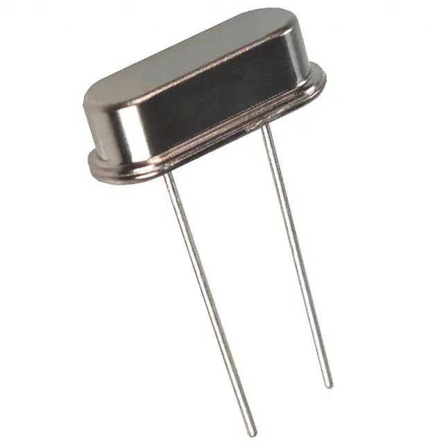

ATS/ATS-SM Series Quartz Crystal Features        Standard HC-49/US & HC-49/US-SM Metal Packages Fundamental and 3rd Overtone Crystal Design Frequency Range 3.2 – 64MHz Frequency Tolerance, ±30ppm Standard Frequency Stability, ±50ppm Standard Operating Temperature Range -20°C to +70°C or -40°C to +85°C Tape and Reel Packaging, EIA-481 Part Dimensions: ATS – 10.85 × 4.5 × 3.66mm • 562.81mg ATS-SM – 11.1 × 4.83 × 4.3mm • 587.84mg Applications     Wireless Communications Broadband Access FPGA/Microcontrollers Computer Peripherals     Microprocessors Test and Measurement Consumer Electronics Portable Equipment Description CTS ATS and ATS-SM incorporates a high Q quartz resonator in a proven resistance-weld metal package. They are ideal for supporting a wide range of commercial and industrial applications. Ordering Information ATS ATS-SM Frequency/Load Code XXX or XXXX Model ATS Code Packaging Product Options - Frequency/Load Code SMXXX or XXXX Model ATS Frequency Frequency/Load Code Temperature Range Code Temp. Range Blank -20°C to +70°C -40°C to +85°C E 1 Packing Code Blank Bulk 2 Radial Taping 1 Notes: 1] Refer to Standard Product Part Numbers tables on Page 2 and 3. 2] Standard packaging is bulk in a bag. Code Packaging 1 Frequency Frequency/Load Code Option Code Blank No Option INS Insulation Spacer Temperature Range Code Temp. Range Blank -20°C to +70°C -40°C to +85°C E 1 Packing Code Blank Bulk 1 Tape & Reel 2 Notes: 1] Refer to Standard Product Part Numbers tables on Page 3 and 4. 2] Standard packaging is tape and reel. CTS Distributors may use -T for tape and reel indicator. 3] For tighter stabilities or frequencies not shown in Page 3 and 4 tables, use ATSSMTS data sheet to build CTS part number. Not all performance combinations and frequencies may be available. Contact your local CTS Representative or CTS Customer Service for availability. This product is specified for use only in standard commercial applications.  Supplier disclaims all express and implied warranties and liability in connection with any use of this product in any non-commercial applications or in any application that may expose the product to conditions that are outside of the tolerances provided in its specification. DOC# 008-0309-0 Rev. N Page 1 of 9 ©2017 CTS® Corporation. Information/product(s) subject to change. No warranty that product(s) will meet the stated specifications for customer specific applications or test equipment. Visit www.ctscorp.com for list of applicable patent(s), more information, or to request a quote. ATS/ATS-SM Series Quartz Crystal ATS – Standard Product Part Numbers Part numbers in BO LD are commonly stock items through CTS authorized distributors. Non-bold numbers may be stocked or are available for order. FREQ UENCY [MHz] 3.579545 P ART P ART LO AD O P ERATING NUMBER NUMBER CAP ACITANCE MO DE [-2 0 °C/+7 0 °C] [-4 0 °C/+8 5 °C] ATS036B-E ATS036B Series Fundamental FREQ UENCY [MHz] 12.000000 P ART P ART LO AD O P ERATING NUMBER NUMBER CAP ACITANCE MO DE [-2 0 °C/+7 0 °C] [-4 0 °C/+8 5 °C] Fundamental ATS120-E Series ATS1 2 0 3.579545 ATS0 3 6 ATS036-E 18pF Fundamental 12.000000 ATS12A ATS12A-E 20pF Fundamental 3.686400 ATS037A ATS037A-E Series Fundamental 12.000000 ATS1 2 0 B ATS1 2 0 B-E 18pF Fundamental 3.686400 ATS0 3 7 ATS037-E 20pF Fundamental 12.000000 ATS120C ATS120C-E 32pF Fundamental 3.686400 ATS0 3 7 B ATS0 3 7 B-E 18pF Fundamental 12.288000 ATS125 ATS125-E Series Fundamental 4.000000 ATS04A ATS04A-E Series Fundamental 12.288000 ATS1 2 2 ATS122-E 20pF Fundamental 4.000000 ATS0 4 0 ATS040-E 20pF Fundamental 12.288000 ATS1 2 2 B ATS122B-E 18pF Fundamental 4.000000 ATS0 4 0 B ATS0 4 0 B-E 18pF Fundamental 12.296000 ATS124 ATS124-E Series Fundamental 4.096000 ATS042A ATS042A-E 20pF Fundamental 12.296000 ATS123 ATS123-E 20pF Fundamental 4.096000 ATS042B ATS042B-E 18pF Fundamental 12.296000 ATS123B ATS123B-E 18pF Fundamental 4.194304 ATS041C ATS041C-E 12pF Fundamental 12.352000 ATS126 ATS126-E Series Fundamental 4.915200 ATS049A ATS049A-E Series Fundamental 12.352000 ATS127 ATS127-E 20pF Fundamental 4.915200 ATS0 4 2 ATS042-E 20pF Fundamental 13.500000 ATS135 ATS135-E 20pF Fundamental 4.915200 ATS0 4 9 B ATS0 4 9 B-E 18pF Fundamental 13.560000 ATS13CA ATS13CA-E 20pF Fundamental 5.000000 ATS050C ATS050C-E Series Fundamental 14.318180 ATS1 4 3 ATS143-E Series Fundamental 5.000000 ATS050A ATS050A-E 20pF Fundamental 14.318180 ATS14A ATS14A-E 20pF Fundamental 5.000000 ATS050B ATS050B-E 18pF Fundamental 14.318180 ATS1 4 3 B ATS1 4 3 B-E 18pF Fundamental 5.068800 ATS051 ATS051-E Series Fundamental 14.745600 ATS147 ATS147-E Series Fundamental 5.068800 ATS0 5 0 ATS050-E 20pF Fundamental 14.745600 ATS1 4 7 A ATS1 4 7 A-E 20pF Fundamental 6.000000 ATS060A ATS060A-E Series Fundamental 14.745600 ATS1 4 7 B ATS1 4 7 B-E 18pF Fundamental 6.000000 ATS0 6 0 ATS060-E 20pF Fundamental 15.000000 ATS1 5 0 ATS150-E Series Fundamental 6.000000 ATS0 6 0 B ATS0 6 0 B-E 18pF Fundamental 15.360000 ATS1 5 A ATS15A-E 20pF Fundamental 6.000000 ATS060C ATS060C-E 32pF Fundamental 16.000000 ATS1 6 0 ATS160-E Series Fundamental 6.144000 ATS061 ATS061-E 20pF Fundamental 16.000000 ATS16A ATS16A-E 20pF Fundamental 6.144000 ATS0 6 1 B ATS0 6 1 B-E 18pF Fundamental 16.000000 ATS16B ATS16B-E 18pF Fundamental 6.144000 ATS061C ATS061C-E 32pF Fundamental 16.384000 ATS164B ATS164B-E 18pF Fundamental 7.372800 ATS073A ATS073A-E Series Fundamental 16.934400 ATS169 ATS169-E 20pF Fundamental 7.372800 ATS073 ATS073-E 20pF Fundamental 18.000000 ATS180A ATS180A-E 20pF Fundamental 7.372800 ATS073B ATS073B-E 18pF Fundamental 18.432000 ATS1 8 4 ATS1 8 4 -E Series Fundamental 7.500000 ATS075 ATS075-E Series Fundamental 18.432000 ATS1 8 A ATS18A-E 20pF Fundamental 7.500000 ATS075A ATS075A-E 20pF Fundamental 18.432000 ATS1 8 4 B ATS1 8 4 B-E 18pF Fundamental 7.500000 ATS075B ATS075B-E 18pF Fundamental 19.660800 ATS196 ATS196-E Series Fundamental 8.000000 ATS080 ATS080-E Series Fundamental 19.660800 ATS19A ATS19A-E 20pF Fundamental 8.000000 ATS0 8 A ATS08A-E 20pF Fundamental 19.660800 ATS196B ATS196B-E 18pF Fundamental 8.000000 ATS0 8 0 B ATS0 8 0 B-E 18pF Fundamental 20.000000 ATS2 0 0 ATS200-E Series Fundamental 8.000000 ATS080C ATS080C-E 32pF Fundamental 20.000000 ATS20A ATS20A-E 20pF Fundamental 8.192000 ATS081B ATS081B-E 18pF Fundamental 20.000000 ATS2 0 0 C ATS2 0 0 C-E 18pF Fundamental 9.830400 ATS099 ATS099-E Series Fundamental 20.000000 ATS20B ATS20B-E 50pF Fundamental 9.830400 ATS0 9 8 ATS098-E 20pF Fundamental 20.480000 ATS2 0 4 ATS204-E 20pF Fundamental 9.830400 ATS0 9 8 B ATS0 9 8 B-E 18pF Fundamental 22.118400 ATS2 2 A ATS22A-E 20pF Fundamental 10.000000 ATS1 0 0 ATS100-E Series Fundamental 22.118400 ATS221B ATS221B-E 18pF Fundamental 10.000000 ATS10A ATS10A-E 20pF Fundamental 24.000000 ATS240 ATS240-E Series Fundamental 10.000000 ATS1 0 0 B ATS1 0 0 B-E 18pF Fundamental 24.000000 ATS24A ATS24A-E 20pF Fundamental 11.059200 ATS111A ATS111A-E Series Fundamental 24.000000 ATS240B ATS240B-E 18pF Fundamental 11.059200 ATS1 1 1 ATS111-E 20pF Fundamental 24.000000 ATS240C ATS240C-E 12pF Fundamental 11.059200 ATS1 1 1 B ATS1 1 1 B-E 18pF Fundamental 11.059200 ATS111C ATS111C-E 32pF Fundamental DOC# 008-0309-0 Rev. N Page 2 of 9 ©2017 CTS® Corporation. Information/product(s) subject to change. No warranty that product(s) will meet the stated specifications for customer specific applications or test equipment. Visit www.ctscorp.com for list of applicable patent(s), more information, or to request a quote. ATS/ATS-SM Series Quartz Crystal ATS – Standard Product Part Numbers Continued Part numbers in BO LD are commonly stock items through CTS authorized distributors. Non-bold numbers may be stocked or are available for order. FREQ UENCY [MHz] 24.576000 P ART P ART LO AD O P ERATING NUMBER NUMBER CAP ACITANCE MO DE [-2 0 °C/ +7 0 °C] [-4 0 °C/ +8 5 °C] ATS245-E Series Fundamental ATS2 4 5 FREQ UENCY [MHz] 40.000000 P ART P ART LO AD O P ERATING NUMBER NUMBER CAP ACITANCE MO DE [-2 0 °C/ +7 0 °C] [-4 0 °C/ +8 5 °C] Series 3rd Overtone ATS400-E ATS400 24.576000 ATS24B ATS24B-E 20pF Fundamental 40.000000 ATS40A ATS40A-E 20pF 3rd Overtone 24.576000 ATS2 4 5 A ATS245A-E 18pF Fundamental 40.000000 ATS400B ATS400B-E 18pF 3rd Overtone 25.000000 ATS2 5 0 ATS2 5 0 -E Series Fundamental 48.000000 ATS480A ATS480A-E 20pF 3rd Overtone 25.000000 ATS2 5 A ATS25A-E 20pF Fundamental 48.000000 ATS480B ATS480B-E 18pF 3rd Overtone 25.000000 ATS2 5 0 B ATS2 5 0 B-E 18pF Fundamental 60.000000 ATS600A ATS600A-E 20pF 3rd Overtone 27.000000 ATS270A ATS270A-E 20pF Fundamental 60.000000 ATS600B ATS600B-E 18pF 3rd Overtone 27.000000 ATS270B ATS270B-E 18pF Fundamental 64.000000 ATS640A ATS640A-E 20pF 3rd Overtone 30.000000 ATS300B ATS300B-E 18pF 3rd Overtone 64.000000 ATS640B ATS640B-E 18pF 3rd Overtone 32.000000 ATS320 ATS320-E Series 3rd Overtone 32.000000 ATS32A ATS32A-E 20pF 3rd Overtone 32.000000 ATS320B ATS320B-E 18pF 3rd Overtone ATS-SM – Standard Product Part Numbers Part numbers in BO LD are commonly stock items through CTS authorized distributors. Non-bold numbers may be stocked or are available for order. For tighter stabilities, additional load options or frequencies not shown in table; use ATSSMTS data sheet to order. FREQ UENCY [MHz] 3.579545 P ART P ART O P ERATING LO AD NUMBER NUMBER MO DE CAP ACITANCE [-2 0 °C/ +7 0 °C] [-4 0 °C/ +8 5 °C] ATS036BSM-1 ATS036BSM-1E Series Fundamental FREQ UENCY [MHz] 7.372800 P ART P ART LO AD O P ERATING NUMBER NUMBER CAP ACITANCE MO DE [-2 0 °C/ +7 0 °C] [-4 0 °C/ +8 5 °C] ATS073ASM-1 ATS073ASM-1E Series Fundamental 3.579545 ATS0 3 6 SM-1 ATS036SM-1E 18pF Fundamental 7.372800 ATS073SM-1 ATS073SM-1E 20pF Fundamental 3.686400 ATS037ASM-1 ATS037ASM-1E Series Fundamental 7.372800 ATS073BSM-1 ATS073BSM-1E 18pF Fundamental ATS0 3 7 SM-1 ATS037SM-1E 3.686400 3.686400 ATS0 3 7 BSM-1 ATS037BSM-1E 20pF Fundamental 8.000000 ATS080SM-1 ATS080SM-1E Series Fundamental 18pF Fundamental 8.000000 ATS0 8 ASM-1 ATS08ASM-1E 20pF Fundamental 4.000000 ATS04ASM-1 ATS04ASM-1E Series Fundamental 8.000000 4.000000 ATS0 4 0 SM-1 ATS040SM-1E 20pF Fundamental 8.000000 ATS080CSM-1 ATS080CSM-1E 4.000000 4.096000 ATS0 4 0 BSM-1 ATS040BSM-1E ATS042ASM-1 ATS042ASM-1E ATS0 8 0 BSM-1 ATS080BSM-1E 18pF Fundamental 32pF Fundamental 18pF Fundamental 8.192000 ATS081BSM-1 ATS081BSM-1E 18pF Fundamental 20pF Fundamental 9.830400 ATS099SM-1 ATS099SM-1E Series Fundamental 4.096000 ATS042BSM-1 ATS042BSM-1E 18pF Fundamental 9.830400 ATS0 9 8 SM-1 ATS098SM-1E 20pF Fundamental 4.194304 ATS041BSM-1 ATS041BSM-1E 18pF Fundamental 9.830400 ATS098BSM-1 ATS098BSM-1E 18pF Fundamental ATS041CSM-1 ATS041CSM-1E Fundamental 4.194304 4.915200 4.915200 4.915200 5.000000 5.000000 5.000000 ATS0 4 9 ASM-1 ATS0 4 9 ASM-1 E ATS0 4 2 SM-1 ATS042SM-1E ATS0 4 9 BSM-1 ATS049BSM-1E 12pF Fundamental 10.000000 ATS1 0 0 SM-1 ATS100SM-1E Series Series Fundamental 10.000000 ATS1 0 ASM-1 ATS10ASM-1E 20pF Fundamental 20pF Fundamental 10.000000 18pF Fundamental ATS1 0 0 BSM-1 ATS100BSM-1E 18pF Fundamental 11.059200 ATS111ASM-1 ATS111ASM-1E Series Fundamental ATS050CSM-1 ATS050CSM-1E Series Fundamental 11.059200 ATS1 1 1 SM-1 ATS111SM-1E 20pF Fundamental ATS050ASM-1 ATS050ASM-1E 20pF Fundamental 11.059200 18pF Fundamental ATS0 5 0 BSM-1 ATS050BSM-1E 18pF Fundamental 11.059200 ATS111CSM-1 ATS111CSM-1E 32pF Fundamental Series Fundamental 12.000000 ATS1 2 0 SM-1 ATS1 2 0 SM-1 E Series Fundamental ATS12ASM-1 ATS12ASM-1E 5.068800 ATS051SM-1 5.068800 ATS0 5 0 SM-1 ATS050SM-1E 20pF Fundamental 12.000000 6.000000 ATS060ASM-1 ATS060ASM-1E Series Fundamental 12.000000 ATS0 6 0 SM-1 ATS060SM-1E 20pF Fundamental 12.000000 ATS120CSM-1 18pF Fundamental 12.288000 ATS125SM-1 ATS1 2 2 SM-1 6.000000 6.000000 ATS051SM-1E ATS1 1 1 BSM-1 ATS111BSM-1E ATS0 6 0 BSM-1 ATS060BSM-1E 20pF Fundamental 18pF Fundamental ATS120CSM-1E 32pF Fundamental ATS125SM-1E Series Fundamental ATS122SM-1E 20pF Fundamental 18pF Fundamental ATS1 2 0 BSM-1 ATS1 2 0 BSM-1 E 6.000000 ATS060CSM-1 ATS060CSM-1E 32pF Fundamental 12.288000 6.144000 ATS061SM-1 ATS061SM-1E 20pF Fundamental 12.288000 18pF Fundamental 12.296000 ATS123SM-1 ATS123SM-1E Series Fundamental 32pF Fundamental 12.296000 ATS124SM-1 ATS124SM-1E 20pF Fundamental 6.144000 6.144000 ATS0 6 1 BSM-1 ATS061BSM-1E ATS061CSM-1 ATS061CSM-1E DOC# 008-0309-0 Rev. N ATS1 2 2 BSM-1 ATS122BSM-1E Page 3 of 9 ©2017 CTS® Corporation. Information/product(s) subject to change. No warranty that product(s) will meet the stated specifications for customer specific applications or test equipment. Visit www.ctscorp.com for list of applicable patent(s), more information, or to request a quote. ATS/ATS-SM Series Quartz Crystal ATS-SM – Standard Product Part Numbers Continued Part numbers in BO LD are commonly stock items through CTS authorized distributors. Non-bold numbers may be stocked or are available for order. For tighter stabilities, additional load options or frequencies not shown in table; use ATSSMTS data sheet to order. FREQ UENCY [MHz] 12.352000 P ART P ART LO AD O P ERATING NUMBER NUMBER CAP ACITANCE MO DE [-2 0 °C/ +7 0 °C] [-4 0 °C/ +8 5 °C] ATS127SM-1 ATS127SM-1E Series Fundamental FREQ UENCY [MHz] 22.579200 P ART P ART LO AD O P ERATING NUMBER NUMBER CAP ACITANCE MO DE [-2 0 °C/ +7 0 °C] [-4 0 °C/ +8 5 °C] ATS225BSM-1 ATS225BSM-1E 18pF Fundamental 12.352000 ATS126SM-1 ATS126SM-1E 20pF Fundamental 24.000000 ATS240SM-1 ATS240SM-1E Series Fundamental 12.500000 ATS125BSM-1 ATS125BSM-1E 18pF Fundamental 24.000000 ATS24ASM-1 ATS24ASM-1E 20pF Fundamental 13.000000 ATS130SM-1 ATS130SM-1E 20pF Fundamental 24.000000 ATS240BSM-1 ATS2 4 0 BSM-1 E 18pF Fundamental 13.500000 ATS135SM-1 ATS135SM-1E 20pF Fundamental 24.000000 ATS240CSM-1 ATS240CSM-1E 12pF Fundamental 13.500000 ATS135BSM-1 ATS135BSM-1E 18pF Fundamental 24.576000 ATS2 4 5 SM-1 ATS245SM-1E Series Fundamental 14.000000 ATS140BSM-1 ATS140BSM-1E 18pF Fundamental 24.576000 ATS24BSM-1 ATS24BSM-1E 20pF Fundamental 14.318180 ATS143SM-1 ATS143SM-1E Series Fundamental 24.576000 18pF Fundamental 14.318180 ATS14ASM-1 ATS14ASM-1E 20pF Fundamental 25.000000 ATS250SM-1 ATS2 5 0 SM-1 E Series Fundamental 18pF Fundamental 25.000000 ATS2 5 ASM-1 ATS2 5 ASM-1 E 20pF Fundamental Series Fundamental 25.000000 18pF Fundamental 14.318180 14.745600 ATS1 4 3 BSM-1 ATS143BSM-1E ATS147SM-1 ATS147SM-1E ATS2 4 5 ASM-1 ATS245ASM-1E ATS2 5 0 BSM-1 ATS2 5 0 BSM-1 E 14.745600 ATS1 4 7 ASM-1 ATS147ASM-1E 20pF Fundamental 26.000000 ATS260ASM-1 ATS260ASM-1E 20pF Fundamental 14.745600 ATS1 4 7 BSM-1 ATS147BSM-1E 18pF Fundamental 26.000000 ATS260BSM-1 ATS260BSM-1E 18pF Fundamental 15.000000 ATS150SM-1 ATS150SM-1E Series Fundamental 27.000000 ATS270ASM-1 ATS2 7 0 ASM-1 E 20pF Fundamental 15.000000 ATS150BSM-1 ATS150BSM-1E 18pF Fundamental 27.000000 ATS270BSM-1 ATS2 7 0 BSM-1 E 18pF Fundamental 15.360000 ATS1 5 ASM-1 ATS15ASM-1E 20pF Fundamental 28.636360 ATS286ASM-1 ATS286ASM-1E 20pF Fundamental 16.000000 ATS1 6 0 SM-1 ATS160SM-1E Series Fundamental 30.000000 ATS300ASM-1 ATS300ASM-1E 20pF Fundamental 16.000000 ATS16ASM-1 ATS16ASM-1E 20pF Fundamental 30.000000 ATS300BSM-1 ATS300BSM-1E 18pF Fundamental 16.000000 ATS16BSM-1 ATS16BSM-1E 18pF Fundamental 32.000000 ATS320SM-1 ATS320SM-1E Series 3rd Overtone 16.384000 ATS164BSM-1 ATS1 6 4 BSM-1 E 18pF Fundamental 32.000000 ATS32ASM-1 ATS32ASM-1E 20pF 3rd Overtone 16.934400 ATS169SM-1 ATS169SM-1E 20pF Fundamental 32.000000 ATS320BSM-1 ATS320BSM-1E 18pF 3rd Overtone 18.432000 ATS184SM-1 ATS184SM-1E Series Fundamental 33.000000 ATS330ASM-1 ATS330ASM-1E 20pF 3rd Overtone ATS1 8 ASM-1 ATS18ASM-1E 20pF Fundamental 33.000000 ATS330BSM-1 ATS330BSM-1E 18pF 3rd Overtone 18pF Fundamental 36.000000 ATS360ASM-1 ATS360ASM-1E 20pF 3rd Overtone 18.432000 18.432000 ATS1 8 4 BSM-1 ATS1 8 4 BSM-1 E 19.660800 ATS196SM-1 ATS196SM-1E Series Fundamental 36.000000 ATS360BSM-1 ATS360BSM-1E 18pF 3rd Overtone 19.660800 ATS19ASM-1 ATS19ASM-1E 20pF Fundamental 40.000000 ATS400SM-1 ATS400SM-1E Series 3rd Overtone 19.660800 ATS196BSM-1 ATS196BSM-1E 18pF Fundamental 40.000000 ATS40ASM-1 ATS40ASM-1E 20pF 3rd Overtone 20.000000 ATS2 0 0 SM-1 ATS200SM-1E Series Fundamental 40.000000 ATS400BSM-1 ATS400BSM-1E 18pF 3rd Overtone ATS20ASM-1 ATS20ASM-1E 20pF Fundamental 48.000000 ATS480ASM-1 ATS480ASM-1E 20pF 3rd Overtone 18pF Fundamental 48.000000 ATS480BSM-1 ATS480BSM-1E 18pF 3rd Overtone 50pF Fundamental 60.000000 ATS600ASM-1 ATS600ASM-1E 20pF 3rd Overtone 20.000000 20.000000 ATS2 0 0 CSM-1 ATS200CSM-1E 20.000000 ATS20BSM-1 ATS20BSM-1E 20.480000 ATS2 0 4 SM-1 ATS204SM-1E 20pF Fundamental 60.000000 ATS600BSM-1 ATS600BSM-1E 18pF 3rd Overtone 22.118400 ATS22ASM-1 ATS2 2 ASM-1 E 20pF Fundamental 64.000000 ATS640ASM-1 ATS640ASM-1E 20pF 3rd Overtone 22.118400 ATS221BSM-1 ATS221BSM-1E 18pF Fundamental 64.000000 ATS640BSM-1 ATS640BSM-1E 18pF 3rd Overtone DOC# 008-0309-0 Rev. N Page 4 of 9 ©2017 CTS® Corporation. Information/product(s) subject to change. No warranty that product(s) will meet the stated specifications for customer specific applications or test equipment. Visit www.ctscorp.com for list of applicable patent(s), more information, or to request a quote. ATS/ATS-SM Series Quartz Crystal Electrical Specifications Operating Conditions P ARAMETER O perating Temperature Storage Temperature SYMBO L CO NDITIO NS MIN TA - TSTG - -40 - +125 °C SYMBO L CO NDITIO NS MIN TYP MAX UNIT fO - -20 -40 TYP +25 MAX +70 +85 UNIT °C Frequency Stability P ARAMETER Frequenc y Range Fundamental 3.2 - 40 MHz 24 - 64 3 rd O vertone Frequenc y Toleranc e Δf/fO @ +25°C -30 - 30 ppm Frequenc y Stability Δf/f25 Referenced to +25°C reading Aging Δf/f0 Typical per year @ +25°C -50 - 50 ppm -5 ±3 5 ppm SYMBO L CO NDITIO NS MIN TYP MAX UNIT O perating Mode - - Fundamental or 3rd Overtone - Crystal Cut - - AT-Cut - Load Capac itanc e CL - Note 1 pF Shunt Capac itanc e C0 - - - 7.0 3.2MHz -

物料型号: - ATS/ATS-SM系列石英晶体
器件简介: - CTS ATS和ATS-SM系列晶体振荡器采用高Q石英谐振器,封装在经过验证的电阻焊接金属封装中。它们非常适合支持广泛的商业和工业应用。
引脚分配: - 文档中未明确提供引脚分配图,但提到了HC-49/US和HC-49/US-SM金属封装。
参数特性: - 工作温度范围:-20°C至+70°C或-40°C至+85°C - 频率范围:3.2MHz至64MHz - 频率容差:标准±30ppm - 频率稳定性:标准±50ppm - 封装:EIA-481胶带和卷轴包装
功能详解: - 提供基本和第三泛音晶体设计。 - 适用于无线通信、宽带接入、微处理器、测试测量、消费电子、便携设备、FPGA/微控制器和计算机外围设备。
应用信息: - 广泛应用于商业和工业应用。
封装信息: - ATS系列:10.85 × 4.5 × 3.66mm,重量562.81mg - ATS-SM系列:11.1 × 4.83 × 4.3mm,重量587.84mg
订购信息: - 提供了详细的订购代码和选项,包括频率/负载代码、温度范围、包装选项等。
