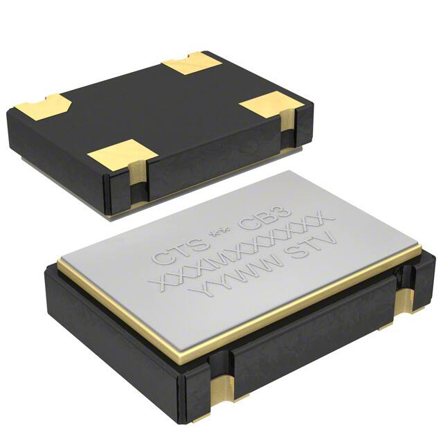

Model CB3 & CB3LV HCMOS/TTL Clock Oscillator FEATURES • • • • • • • • • • Standard 7.0mm x 5.0mm 4-Pad Surface Mount Package HCMOS/TTL Compatible Output Fundamental and 3rd Overtone Crystal Designs Frequency Range 1 – 200 MHz Frequency Stability ±50 ppm Standard, ±25 ppm and ±20 ppm Available Operating Voltages +5.0Vdc or +3.3Vdc Operating Temperature to -40°C to +85°C Output Enable Standard Tape & Reel Packaging RoHS/Green Compliant (6/6) APPLICATIONS Applications for Model CB3 and CB3LV include digital video, networking equipment, wireless communications, broadband access, Ethernet/Gigabit Ethernet, microprocessors/DSP/FPGA, storage area networks, fiber channel, computers and peripherals, test and measurement, SONET/SDH/DWDM, base stations and Pico cells. ORDERING INFORMATION CB3 - - M SUPPLY VOLTAGE FREQUENCY IN MHz LV = +3.3Vdc Blank = +5.0Vdc M - indicates MHz and decimal point. FREQUENCY STABILITY 1 6 = ± 20 ppm 5 = ± 25 ppm 3 = ± 50 ppm [std] 7 = ± 32 ppm OPERATING TEMPERATURE RANGE C = -20°C to +70°C [standard] I = -40°C to +85°C 1 2 2 = ± 100 ppm 3 2 1] 6I Stability/Temperature combination is not available. 2] These stabilities are not recommended for new designs. 3] Frequency is recorded with only leading significant digits before the ‘M’ and 4 - 6 significant digits after the ‘M’ (including zeros). [Ex. 3.579545 MHz, code as 3M579545; 14.31818 MHz, code as 14M31818; 125 MHz, code as 125M0000] 4] CTS Distributors may add a -T or -1 at the end of the part number to indicate Tape and Reel packaging. Not all performance combinations and frequencies may be available. Contact your local CTS Representative or CTS Customer Service for availability. PACKAGING INFORMATION [reference] Device quantity is 1,000 pieces maximum per reel. Document No. 008-0256-0 Page 1- 3 www.ctscorp.com Rev. G Model CB3 & CB3LV 7.0mm x 5.0mm Low Cost HCMOS/TTL Clock Oscillator ELECTRICAL CHARACTERISTICS PARAMETER Maximum Supply Voltage Storage Temperature SYMBOL VCC CONDITIONS - MIN -0.5 TYP - MAX +7.0 UNIT V TSTG - -40 - +100 °C fO - 1.5 - 107 MHz - 1.5 - 200 Frequency Range CB3 CB3LV Frequency Stability Aging Operating Temperature Commercial Industrial Supply Voltage CB3 CB3LV Supply Current Δf/fO Δf VCC ELECTRICAL PARAMETERS 20,25,50 or 100 ± ppm 3 5 ± ppm -20 -40 25 +70 +85 °C 4.5 3.0 5.0 3.3 5.5 3.6 V - 10 30 40 7 20 30 - 25 50 80 12 40 60 50 30 15 90%VCC VCC-0.6V - - - - 10%VCC 0.4 - - -16/-8 - - +16/+8 45 - 55 - 8 5 2.5 6 3 1.5 - 10 8 5 8 5 3 10 ms - V - ±10% Frequency Range ICC Logic '0' Level - - Tested load condition noted for typical values. CB3LV Output Voltage Levels Logic '1' Level - First year TA CB3 Output Load See Note 1 and Ordering Information CL VOH VOL 1.5MHz to 20MHz 20.001MHz to 80MHz 80.001MHz to 107MHz 1.5MHz to 20MHz 20.001MHz to 80MHz 80.001MHz to 200MHz 1.5MHz to 50MHz 50.001MHz to 80MHz 80.001MHz to 200MHz CL=50pF CL=50pF CL=15pF CL=15pF CL=15pF CL=15pF CMOS Load 10 TTL LOAD CMOS TTL Load mA pF V Output Current Logic '1' Level IOH VOH = 3.9V/2.2V Logic '0' Level IOL VOL = 0.4V Output Duty Cycle Rise and Fall Time SYM VCC = 4.5V/3.0V VCC = 4.5V/3.0V @ 50% Level @ 10% - 90% Levels mA % Tested load condition noted for typical values. CB3 CL=50pF CL=50pF CL=15pF CL=15pF CL=15pF CL=15pF TS 1.5MHz to 20MHz 20.001MHz to 80MHz 80.001MHz to 200MHz 1.5MHz to 20MHz 20.001MHz to 80MHz 80.001MHz to 200MHz Application of VCC Enable Input Voltage VIH Pin 1 Logic '1', Output Enabled 2.0 - Disable Input Voltage VIL Pin 1 Logic '0', Output Disabled - - 0.8 Enable Time TPLZ Pin 1 Logic '1' - - 200 ns Standby Current IST Pin 1 Logic '0', Output Disabled - - 10 µA Period Jitter, Pk-Pk - - - - 50 Period Jitter, RMS - - - - TR, TF CB3LV Start Up Time ns Enable Function Bandwidth 12kHz - 20MHz Phase Jitter, RMS Notes: 1. Inclusive of initial tolerance at time of shipment, changes in supply voltage, load, temperature and 1st year aging. Document No. 008-0256-0 Page 2 - 3 5 ps 1 Rev. G Model CB3 & CB3LV 7.0mm x 5.0mm Low Cost HCMOS/TTL Clock Oscillator ELECTRICAL CHARACTERISTICS LVCMOS OUTPUT WAVEFORM TEST CIRCUIT, CMOS LOAD ENABLE TRUTH TABLE D.U.T. PIN ASSIGNMENTS PIN SYMBOL PIN 1 Logic ‘1’ Open Logic ‘0’ PIN 3 Output Output High Imp. DESCRIPTION 1 EOH Enable 2 GND Circuit & Package Ground 3 Output 4 VCC RF Output Supply Voltage MECHANICAL SPECIFICATIONS MARKING INFORMATION 1. ** – Manufacturing Site Code. PACKAGE DRAWING [Note a dash may follow the site code and is acceptable.] 2. XXXMXXXXXX – Frequency is marked with only leading significant digits before the ‘M’ and 4 – 6 digits after the ‘M’ (including zeros). CTS**CB3 XXXMXXXXXX ● YYWWSTV Ex. XMXXXXXX [3M579545] XXMXXXXX [14M31818] XXXMXXXX [125M0000] 3. YYWW – Date code, YY – year, WW – week. 4. ST – Frequency stability/temperature code. [Refer to Ordering Information.] 5. V – Voltage code. 3 = 3.3V, 5 = 5.0V. NOTES 1. Termination pads [e4]. Barrier-plating is nickel [Ni] with gold [Au] flash plate. 2. Reflow conditions per JEDEC J-STD-020, 260°C maximum. 3. Moisture Sensitivity Level 1 per JEDEC J-STD-020. SUGGESTED SOLDER PAD GEOMETRY CBYPASS should be ≥ 0.01 uF. Document No. 008-0256-0 Page 3 - 3 Rev. G
CB3LV-3I-52M000000
物料型号:CB3 & CB3LV
器件简介: - 标准7.0mm x 5.0mm 4-Pad表面贴装封装 - HCMOS/TTL兼容输出 - 基频和3次谐波晶体设计 - 频率范围1 – 200 MHz - 频率稳定性±50 ppm标准,±25 ppm和±20 ppm可选 - 工作电压+5.0Vdc或+3.3Vdc - 工作温度范围-40°C至+85°C - 标准输出使能 - 胶带和卷轴包装 - 符合RoHS/绿色合规性(6/6)
引脚分配: - 1号引脚:使能(EOH) - 2号引脚:地(GND) - 3号引脚:输出(RF Output) - 4号引脚:供电电压(Vcc)
参数特性: - 最大供电电压:+7.0V - 存储温度频率范围:+100°C - 基频(f0):1.5 MHz至200 MHz - 频率稳定性(Af/fo):20, 25, 50或100 ±ppm - 老化:商业/工业温度下±3至±5 ±ppm/℃ - 供电电压(CB3):4.5V至5.5V - CB3LV供电电流:1.5MHz至20MHz时为3.0至3.6 mA,20.001MHz至80MHz时为10至25 mA,80.001MHz至107MHz时为40至80 mA - 输出负载:30至15 pF - 输出电压电平:Logic'1'Level (VOH)为90%Vcc或Vac-0.6V,Logic'0'Level (Vol)为10%Vcc或0.4V - 输出电流:Logic'1'Level(IOH)为-16/-8 mA,Logic'0'Level(IoL)为+16/+8 mA - 输出占空比:45%至55% - 上升和下降时间(TRTF):1.5MHz至20MHz时为10 ns,20.001MHz至80MHz时为5 ns,80.001MHz至200MHz时为2.5至6 ns - 启动时间(Ts):10 ms - 使能输入电压(VBH):2.0V - 禁用输入电压(VI):0.8V - 使能时间(Tpz):200 ns - 待机电流(IsT):10 µA
功能详解: - 提供了详细的电气特性表,包括最大供电电压、存储温度频率范围、频率稳定性、老化、供电电压、供电电流、输出负载、输出电压电平、输出电流、输出占空比、上升和下降时间、启动时间、使能功能等参数。 - 使能功能的真值表说明了当使能引脚逻辑为'1'时输出使能,逻辑为'0'时输出禁用。
应用信息: - 数字视频、网络设备、无线通信、宽带接入、以太网/千兆以太网、微处理器/DSP/FPGA、存储区域网络、光纤通道、计算机和外围设备、测试和测量、SONET/SDH/DWDM、基站和皮蜂窝等应用。
封装信息: - 设备数量每卷最多1,000件。 - 提供了封装的尺寸信息和方向进给的详细图纸。
订购信息: - 提供了详细的订购指南,包括频率稳定性、操作温度范围和供电电压的编码方式。
机械规格: - 提供了封装的物理尺寸和标记信息。
建议的焊盘几何形状: - 建议的旁路电容应≥0.01 uF。
