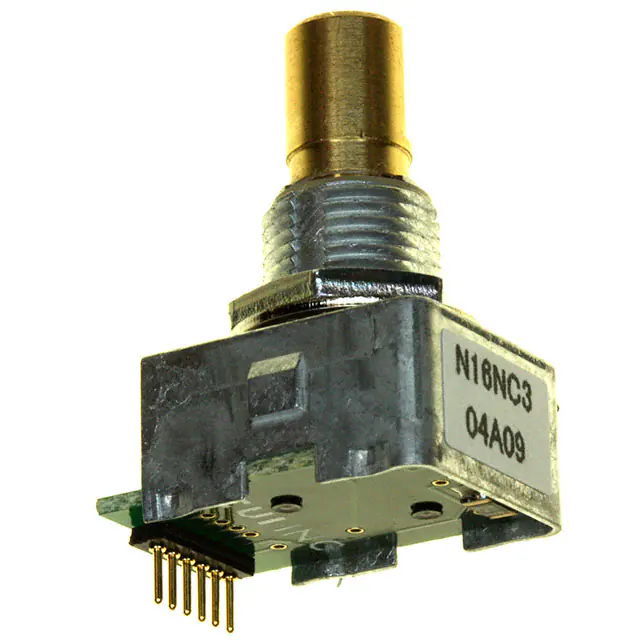

C14N16N-C3 数据手册
rev. page date 1 of 5 02/2010 PART NUMBER: C14 DESCRIPTION: panel mount optical encoder ELECTRICAL SPECIFICATIONS supply voltage supply current output code power consumption angle of throw 5 V dc ±5% (optional: 3.3 V dc ±10%) 20 mA max. (open collector) 2-bit Quadature, Channel A leads Channel B by 90° with clockwise rotation 100 mW 22.5° for code change and 16 detent positions 11.25° for code change and 32 detent positions MECHANICAL SPECIFICATIONS operational torque without detent 16 position w/detent 32 position w/detent radial thrust 0.2 N·cm (20.4 gf·cm max.) 0.4 ±0.2 N·cm (40.8 ±20.4 gf·cm) 0.4 ±0.2 N·cm (40.8 ±20.4 gf·cm) 100 N·cm (10.2 kgf·cm) 10 N (1.02 kgf) 15 N (1.53 kgf) 1,000,000 cycles 11 g mounting torque shaft strength rotational life weight (approx) PUSH SWITCH SPECIFICATIONS rated voltage contact resistance insulation resistance voltage proof operating force travel bounce life 12 V dc, 50 mA 200 mΩ max. 100 mΩ min. 250 V ac for 1 minute 4.5 ± 1 N (459 ±102 g·f) 0.5 ±0.3 mm 10 msec. 1,000,000 ENVIRONMENTAL SPECIFICATIONS operating temp. range storage temp. range vibration shock cold proof heat proof change to temp. humidity 0° to +60° C -20 ~ 80°C frequency range: 10 ~ 55 Hz, peak to peak amplitude: 1.5 mm 50 G for 11 ms, half sine wave -20°C for 96 hours 80°C for 96 hours -10 ~ 70°C for 30 minutes each 90 ~ 95% for 96 hours at 40°C 20050 SW 112th Ave. Tualatin, Oregon 97062 phone 503.612.2300 fax 503.612.2383 phone fax rev. page date 2 of 5 02/2010 PART NUMBER: C14 DESCRIPTION: panel mount optical encoder ORDERING INSTRUCTIONS C14 X XX X - X X X X Detent: D = with detent N = without detent Angle of throw: 16 = 22.5° for code change and 16 detent positions 32 = 11.25° for code change and 32 detent positions Input voltage: “blank” = 5 V input 3 = 3.3 V input Waterproof: “blank” = standard A = IP65 Push switch: P = with push switch N = without push switch Termination: A = ø 0.5 mm holes B = 130 mm cable with connector C = with header I D = with header II E = horizontal PCB F = vertical PCB Shaft diameter: 1 = 3.175 mm (1/8”) 2 = 6 mm 3 = 6.35 mm (1/4”) CIRCUIT CONNECTION WATER PROOF MOUNTING Protects against ingress of water from mounting panel side only. (3.3 V optional) OUTPUT WAVEFORM 20050 SW 112th Ave. Tualatin, Oregon 97062 phone 503.612.2300 fax 503.612.2383 phone fax rev. page date 3 of 5 02/2010 PART NUMBER: C14 DESCRIPTION: panel mount optical encoder OPTIONS CUIINC Mounting Hole Dimensions (for A, B, and C) CUIINC Mounting panel thickness: 3.5 mm max. CUIINC Mounting Hole dimensions and Footprint for D (±0.5 mm) Mounting panel thickness: 3.5 mm max. CUIINC 20050 SW 112th Ave. Tualatin, Oregon 97062 phone 503.612.2300 fax 503.612.2383 phone fax rev. page date 4 of 5 02/2010 PART NUMBER: C14 DESCRIPTION: panel mount optical encoder OPTIONS CONTINUED CUIINC Mounting Hole Dimensions (for E and F) Mounting panel thickness: 3.5 mm max. CUIINC 20050 SW 112th Ave. Tualatin, Oregon 97062 phone 503.612.2300 fax 503.612.2383 phone fax rev. page date 5 of 5 02/2010 PART NUMBER: C14 DESCRIPTION: panel mount optical encoder MECHANICAL DRAWING 3.175 mm CUIINC CUIINC 6.0 mm CUIINC CUIINC 6.35 mm CUIINC CUIINC 20050 SW 112th Ave. Tualatin, Oregon 97062 phone 503.612.2300 fax 503.612.2383 phone fax
