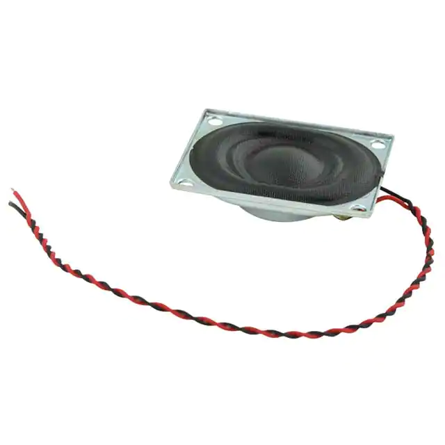

CDS-27204-L100 数据手册
Additional Resources: Product Page | 3D Model date 08/05/2022 page 1 of 3 SERIES: CDS-27204-L100 | DESCRIPTION: SPEAKER FEATURES • micro-speaker • high SPL • 4 ohm impedance • wire leads SPECIFICATIONS parameter conditions/description min typ max units input power maximum power: IEC-60268-5, filter 60s on/120s off, 10 cycles at room temp 2.0 2.5 W impedance at 1.5 kHz, 1.0 V 3.4 4 4.6 Ω resonant frequency (Fo) at 1.0 V frequency response output SPL 10 ±dB 680 Fo 850 sound pressure level at 1.0 W, 0.1 m ave, at 0.8, 1.0, 1.2, 1.5 kHz 90 distortion at 1.0 kHz, 2.0 W buzz, rattle, etc. must be normal at sine wave between Fo ~ 20 kHz polarity cone will move forward with positive dc current to “+” terminal dimensions 27.0 x 20.0 x 5.9 magnet Nd-Fe-B material ABS cone material cloth terminal wire leads 93 1,020 Hz 20,000 Hz 96 dB 10 % 2.83 V mm weight 9.6 g operating temperature -20 55 °C storage temperature -30 70 °C RoHS Notes: yes 1. All specifications measured at 5~35°C, humidity at 45~85%, under 86~106kPa pressure, unless otherwise noted. PART NUMBER KEY CDS-27204-L100 X Base Number Notes: *Discontinued JST housing PHR-4 option. cuidevices.com Termination Style: “blank” = wire leads, no connector 1 = JST housing SHR-2V-S-B 2 = JST housing ZHR-2 3 = JST housing PHR-2 4 = JST housing HER-2 5* = JST housing PHR-4 6 = Molex housing 51021-0200 Additional Resources: Product Page | 3D Model CUI DEVICES | SERIES: CDS-27204-L100 | DESCRIPTION: SPEAKER MECHANICAL DRAWING units: mm tolerance: ±0.3 mm wire: UL3302 HF 32 AWG RESPONSE CURVES Frequency Response Curve Total Harmonic Distortion Curve cuidevices.com date 08/05/2022 | page 2 of 3 Additional Resources: Product Page | 3D Model CUI DEVICES | SERIES: CDS-27204-L100 | DESCRIPTION: SPEAKER date 08/05/2022 | page 3 of 3 REVISION HISTORY rev. description date 1.0 initial release 03/25/2015 1.01 added connector options 07/15/2016 1.02 discontinued JST housing PHR-4 option 07/01/2019 1.03 brand update 01/22/2020 1.04 logo, datasheet style update 08/05/2022 The revision history provided is for informational purposes only and is believed to be accurate. CUI Devices offers a one (1) year limited warranty. Complete warranty information is listed on our website. CUI Devices reserves the right to make changes to the product at any time without notice. Information provided by CUI Devices is believed to be accurate and reliable. However, no responsibility is assumed by CUI Devices for its use, nor for any infringements of patents or other rights of third parties which may result from its use. CUI Devices products are not authorized or warranted for use as critical components in equipment that requires an extremely high level of reliability. A critical component is any component of a life support device or system whose failure to perform can be reasonably expected to cause the failure of the life support device or system, or to affect its safety or effectiveness. cuidevices.com
