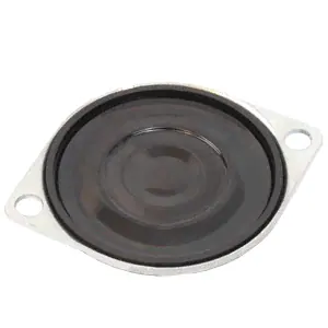

    SPEAKER 8OHMS .1W 25MM PC MNT
CLF0251MP 数据手册
Additional Resources: Product Page Date: 7/2/2007 Part No: CLF0251MP Unit: mm Description: speaker ED Specifications 25mm 8 Ohm ± 15% at 1.2 KHz 1 V 650 Hz ± 130 Hz at 1V 70dB/w ± 3 dB 0.1 w 50 cm ave. at 1K, 1.2K, 1.5K, 2K Hz Fo Hz ~ 5 KHz max 10 dB Nominal 0.1 W Handling capacity 0.2 W must be normal at program source 0.1 W must be normal at sine wave 0.9 V Size: 18 x 7 x 2.5 mm White noise 0.1 W for 24 hours 70 ± 2° C 20-50% R.H. 24 hours 40 ± 2° C 90-95% R.H. 24 hours Frequency Response Curve TI N U Nominal Size Impedance Resonant frequency Sound pressure level Response Input power Operation Buzz, rattle, etc. Magnet Load test Heat test Humidity test N 50 dB RMS 20 Hz 100 mm/sec D IS C O Potentiometer range Rectifier Lower limit frequency Wr. speed Page No: 1 of 2 Zero level 50 dB Phone: 800.275.4899 Fax: 503.612.2383 www.cui.com 20050 SW 112th Ave. Tualatin, OR 97062 Additional Resources: Product Page DESCRIPTION NEW DRAWING DATE 7/3/2007 4.6 13.00 0.2 TI N 5.6 U ED REV. A 3.0 3.8 N 0.65 (TYP) 17.8 16.0 IS C 25.0 O (+) PC FILE NAME: CLF0251MP 5 (-) TOLERANCE: ±0.5mm UNLESS OTHERWISE SPECIFIED 2.5 (TYP) 20050 SW 112th Ave. Tualatin, OR 97062 Phone: 503-612-2300 800-275-4899 Fax: 503-612-2383 Website: www.cui.com TITLE: REV: LOW PROFILE SPEAKER PART NO. ZRJ A UNITS: CLF0251MP DRAWN BY: COPYRIGHT 2007 BY CUI INC. RoHS 7.3 MM [INCHES] APPROVED BY: SCALE: 2:1
