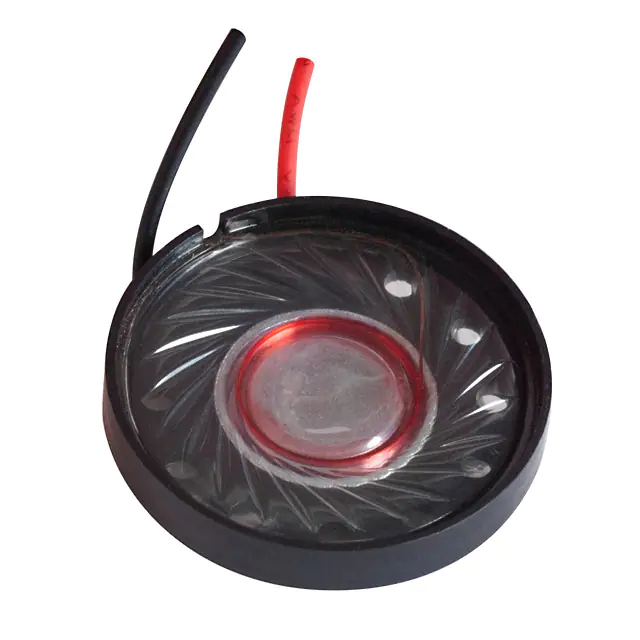

CLS0271M-L152 数据手册
Additional Resources: Product Page | 3D Model date 08/05/2022 page 1 of 3 MODEL: CLS0271M-L152 | DESCRIPTION: SPEAKER FEATURES • 27 mm • round frame • 0.1 W •8Ω • neodymium magnet • PET cone • wire leads SPECIFICATIONS parameter conditions/description min impedance at 1.0 kHz, 1.0 V 6.8 resonant frequency (Fo) at 1.0 V 424 sound pressure level at 1.0 W, 50 cm, avg at 0.8, 1.0, 1.2, 1.5 kHz 86 buzz, rattle, etc. must be normal at sine wave dimensions Ø27 x 5.8 magnet Nd-Fe-B cone material PET terminal wire leads input power frequency response typ max units 0.1 0.2 W 8 9.2 Ω 530 636 Hz Fo 89 20,000 Hz 92 dB 0.89 weight 4.3 operating temperature -25 hand soldering for maximum 3 seconds RoHS yes V mm 340 cuidevices.com 350 g 60 °C 360 °C Additional Resources: Product Page CUI DEVICES | MODEL: CLS0271M-L152 | DESCRIPTION: SPEAKER MECHANICAL DRAWING units: mm wire: UL1007 28 AWG length: 152 mm FREQUENCY RESPONSE CURVE parameter conditions/description potentiometer range 50 dB rectifier RMS lower limit frequency 20 Hz wr. speed 100 mm/sec zero level 60 dB cuidevices.com | 3D Model date 08/05/2022 | page 2 of 3 Additional Resources: Product Page | 3D Model CUI DEVICES | MODEL: CLS0271M-L152 | DESCRIPTION: SPEAKER date 08/05/2022 | page 3 of 3 REVISION HISTORY rev. description date 1.0 initial release 07/03/2007 1.01 brand update 06/26/2020 logo, datasheet style update 08/05/2022 1.02 The revision history provided is for informational purposes only and is believed to be accurate. CUI Devices offers a one (1) year limited warranty. Complete warranty information is listed on our website. CUI Devices reserves the right to make changes to the product at any time without notice. Information provided by CUI Devices is believed to be accurate and reliable. However, no responsibility is assumed by CUI Devices for its use, nor for any infringements of patents or other rights of third parties which may result from its use. CUI Devices products are not authorized or warranted for use as critical components in equipment that requires an extremely high level of reliability. A critical component is any component of a life support device or system whose failure to perform can be reasonably expected to cause the failure of the life support device or system, or to affect its safety or effectiveness. cuidevices.com
