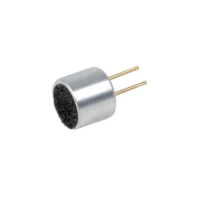

Additional Resources: Product Page | 3D Model | PCB Footprint date 08/05/2022 page 1 of 4 MODEL: CMC-5044PF-A | DESCRIPTION: ELECTRET CONDENSER MICROPHONE FEATURES • ominidirectional • 6.0 mm diameter • solder pins SPECIFICATIONS parameter conditions/description directivity omnidirectional sensitivity (S) f = 1 kHz, 1 Pa, 0 dB = 1 V/Pa min typ max -47 -44 -41 standard operating voltage (Vs) 2 max operating voltage f = 1 kHz, 1 Pa sensitivity reduction (∆S-Vs) f = 1 kHz, 1 Pa, Vs = 2.0 ~ 1.5 Vdc 2.2 100 current consumption (IDSS) Vs = 2.0 Vdc, RL = 2.2 kΩ signal to noise ratio (S/N) f = 1 kHz, 1 Pa, A-weighted dimensions Ø6.0 x 5.0 material AL terminal solder pins (gold plating) Vdc kΩ -3 frequency (f) dB Vdc 10 output impedance (Zout) units dB 20,000 0.5 56 Hz mA dBA mm weight 0.30 g operating temperature -20 70 °C storage temperature -20 70 °C RoHS Notes: yes 1. We use the “Pascal (Pa)” indication of sensitivity as per the recomendation of I.E.C. (International Electrotechnical Commission). The sensitivity of “Pa” will increase 20 dB compared to the “ubar” indication. Example: -60 dB (0 dB = 1 V/ubar) = -40 dB ( 1V/Pa) 2. All specifications measured at 5~35°C, humidity at 45~85%, under 86~106 kPa pressure, unless otherwise noted. SOLDERABILITY parameter conditions/description min typ max units hand soldering for 2 ± 0.5 seconds 270 280 290 °C cuidevices.com Additional Resources: Product Page | 3D Model | PCB Footprint CUI DEVICES | MODEL: CMC-5044PF-A | DESCRIPTION: ELECTRET CONDENSER MICROPHONE MECHANICAL DRAWING units: mm FREQUENCY RESPONSE CURVE APPLICATION CIRCUIT RL = 2.2 kΩ C = 1 µF cuidevices.com date 08/05/2022 | page 2 of 4 Additional Resources: Product Page | 3D Model | PCB Footprint CUI DEVICES | MODEL: CMC-5044PF-A | DESCRIPTION: ELECTRET CONDENSER MICROPHONE PACKAGING units: mm Inner Box Size: 100 x 100 x 11 mm Outer Box Size: 236 x 236 x 270 mm Inner Box QTY: 80 pcs per box Outer Box QTY: 4,800 pcs per box cuidevices.com date 08/05/2022 | page 3 of 4 Additional Resources: Product Page | 3D Model | PCB Footprint CUI DEVICES | MODEL: CMC-5044PF-A | DESCRIPTION: ELECTRET CONDENSER MICROPHONE date 08/05/2022 | page 4 of 4 REVISION HISTORY rev. description date 1.0 initial release 06/01/2008 1.01 brand update 04/27/2020 1.02 shortened pin length, added capacitors 10/15/2021 logo, datasheet style update 08/05/2022 1.03 The revision history provided is for informational purposes only and is believed to be accurate. CUI Devices offers a one (1) year limited warranty. Complete warranty information is listed on our website. CUI Devices reserves the right to make changes to the product at any time without notice. Information provided by CUI Devices is believed to be accurate and reliable. However, no responsibility is assumed by CUI Devices for its use, nor for any infringements of patents or other rights of third parties which may result from its use. CUI Devices products are not authorized or warranted for use as critical components in equipment that requires an extremely high level of reliability. A critical component is any component of a life support device or system whose failure to perform can be reasonably expected to cause the failure of the life support device or system, or to affect its safety or effectiveness. cuidevices.com
