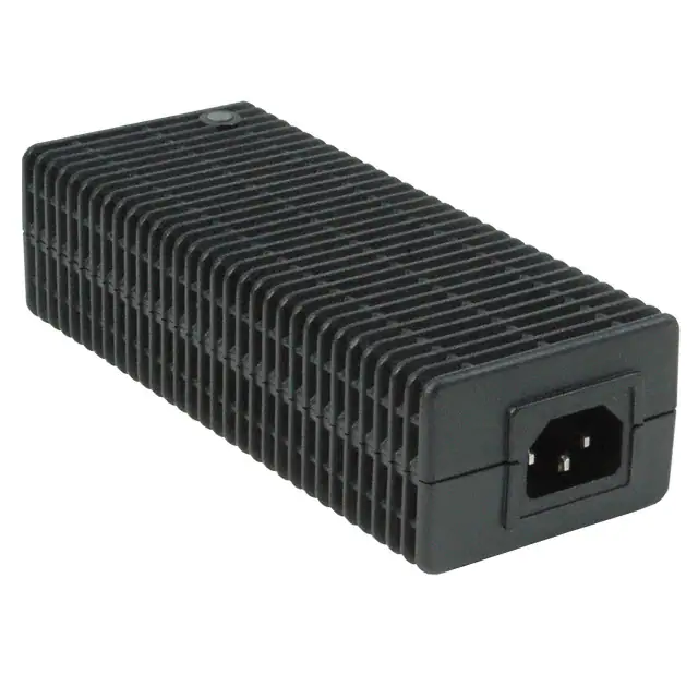

For more information, please visit the product page. date 11/26/2014 page 1 of 5 SERIES: ETS 150W U │ DESCRIPTION: AC-DC POWER SUPPLY up to 150 W power universal input (90~264 Vac) single regulated output from 12~24 V over load and short circuit protections UL/cUL and TUV safety approvals level V efficiency custom designs available U • • • • • • • ED FEATURES ETS1201000U output voltage output current (Vdc) max (A) 12 10 ETS135890U 13.5 ETS150830U 15 output power ripple1 max (W) max (mVp-p) 120 200 TI MODEL N RoHS efficiency level V 8.9 120.2 200 V 8.3 124.5 200 V 8.1 16 129.6 200 V 18 7.5 135 250 V ETS190750U 19 7.5 142.5 250 V N ETS160810U ETS180750U 20 7.1 142 250 V 24 6.25 150 250 V Notes: O ETS200710U ETS240625U 1. At full load, 100 ~ 240 Vac input, 20 MHz bandwidth oscilloscope, each output terminated with 10 µF aluminum electrolytic and 0.1 µF ceramic capacitors. D IS C PART NUMBER KEY ETS135890U X C - P51 - ET - CXX Base Number example of 13.5 Vdc, 8.9 A AC Input Plug: blank = IEC 320 C14 plug T = IEC 3210 C6 plug Input Cable: C = included blank = no cable cui.com 4 position “Power DIN” Reserved for Custom Configurations Factory Designation For more information, please visit the product page. CUI Inc │ SERIES: ETS 150W U │ DESCRIPTION: AC-DC POWER SUPPLY date 11/26/2014 │ page 2 of 5 INPUT conditions/description min 90 frequency 47 current typ max units 264 Vac 63 Hz ED parameter voltage 2.5 inrush current at 230 Vac, cool start no load power consumption power factor correction complies with IEC 61000-3-2 class D, at 100 Vac harmonic standard, input power > 75W, at 240 Vac 0.95 0.9 conditions/description min parameter load regulation conditions/description over voltage protection short circuit protection auto restart SAFETY & COMPLIANCE parameter TI over current protection N PROTECTIONS parameter typ U OUTPUT conditions/description min A 100 A 0.5 W max units ±5 % 140 % 140 % typ max units 1,800 Vac input to output at 10 mA for 1 second UL/cUL (60950-1), EN 60950-1/IEC 60950-1, CSA C22 60950-1-03 EMI/EMC FCC Part 15 Class B, CE, CNS 13438 class B, CISPR 22 class B, EN 55022; EN 55024; EN 61000-(2, 3); IEC 61000-4-(2, 3, 4, 5, 6, 8, 11) RoHS compliant yes O MTBF N isolation voltage safety approvals 40,000 hours ENVIRONMENTAL parameter operating temperature min IS C storage temperature conditions/description operating humidity D storage humidity cui.com max units 0 typ 40 °C -20 85 °C 20 80 % 0 90 % For more information, please visit the product page. CUI Inc │ SERIES: ETS 150W U │ DESCRIPTION: AC-DC POWER SUPPLY date 11/26/2014 │ page 3 of 5 MECHANICAL conditions/description 160 x 65 x 49.5 (6.3 x 2.56 x 1.95 inch) min input plug IEC320/C14 or IEC320/C6 typ max units mm ED parameter dimensions MECHANICAL DRAWING IS C O N TI N U units: mm Optional: IEC 320 C6 input plug D Standard: IEC 320 C14 input plug cui.com For more information, please visit the product page. CUI Inc │ SERIES: ETS 150W U │ DESCRIPTION: AC-DC POWER SUPPLY date 11/26/2014 │ page 4 of 5 N TI N O IS C D cui.com C14 U C6 ED AC CORD For more information, please visit the product page. CUI Inc │ SERIES: ETS 150W U │ DESCRIPTION: AC-DC POWER SUPPLY date 11/26/2014 │ page 5 of 5 REVISION HISTORY rev. description date 10/22/2010 initial release V-Infinity branding removed, safety and EMI/EMC data updated 08/13/2012 1.02 updated datasheet 11/26/2014 ED 1.0 1.01 D IS C O N TI N U The revision history provided is for informational purposes only and is believed to be accurate. Headquarters 20050 SW 112th Ave. Tualatin, OR 97062 800.275.4899 Fax 503.612.2383 cui.com techsupport@cui.com This device complies with part 15 of the FCC Rules. Operation is subject to the following two conditions: (1) This device may not cause harmful interference, and (2) this device must accept any interference received, including interference that may cause undesired operation. CUI offers a one (1) year limited warranty. Complete warranty information is listed on our website. CUI reserves the right to make changes to the product at any time without notice. Information provided by CUI is believed to be accurate and reliable. However, no responsibility is assumed by CUI for its use, nor for any infringements of patents or other rights of third parties which may result from its use. CUI products are not authorized or warranted for use as critical components in equipment that requires an extremely high level of reliability. A critical component is any component of a life support device or system whose failure to perform can be reasonably expected to cause the failure of the life support device or system, or to affect its safety or effectiveness.
